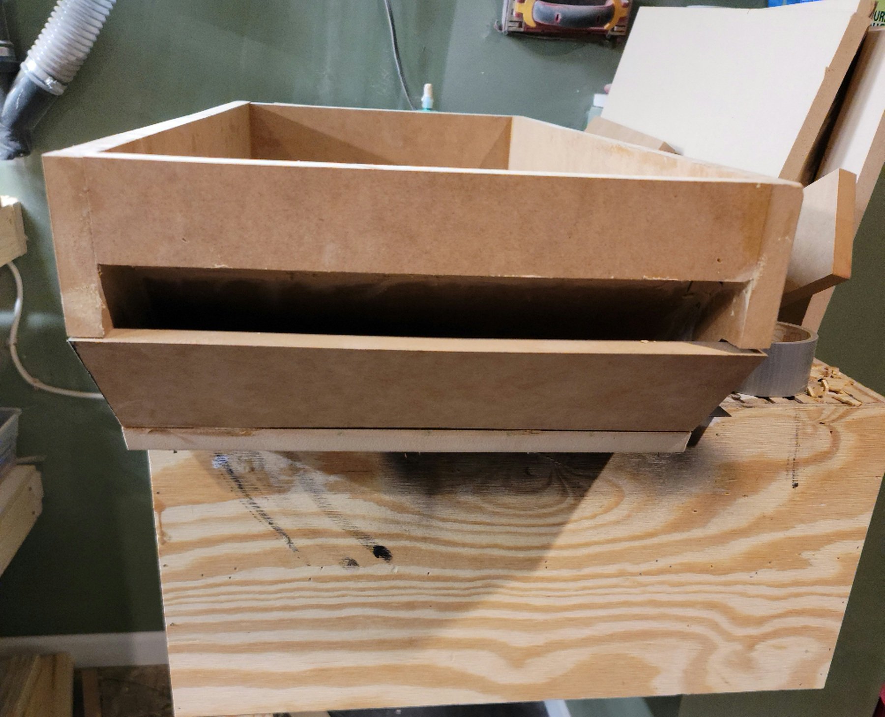

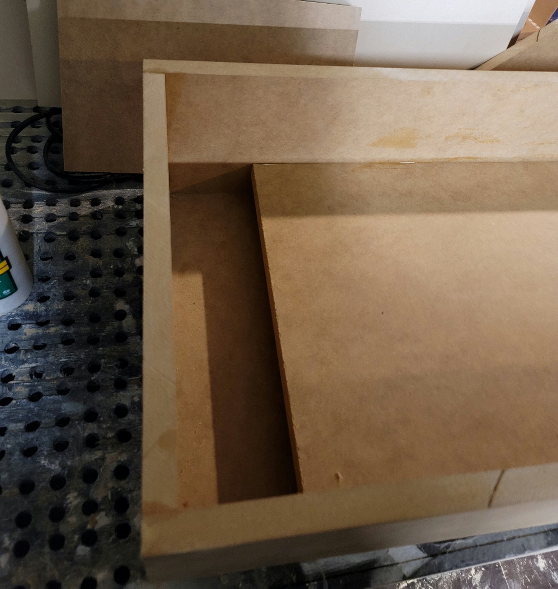

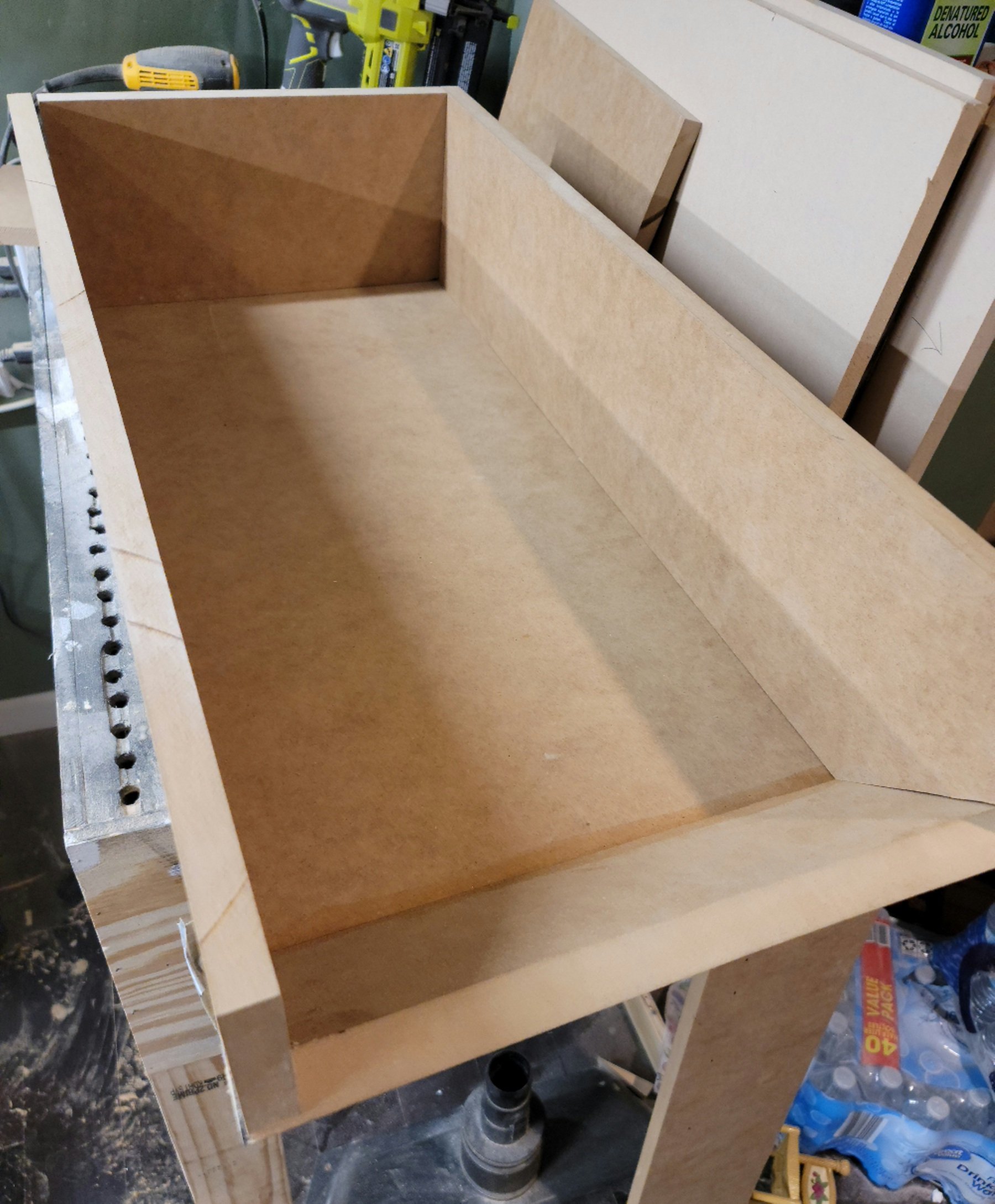

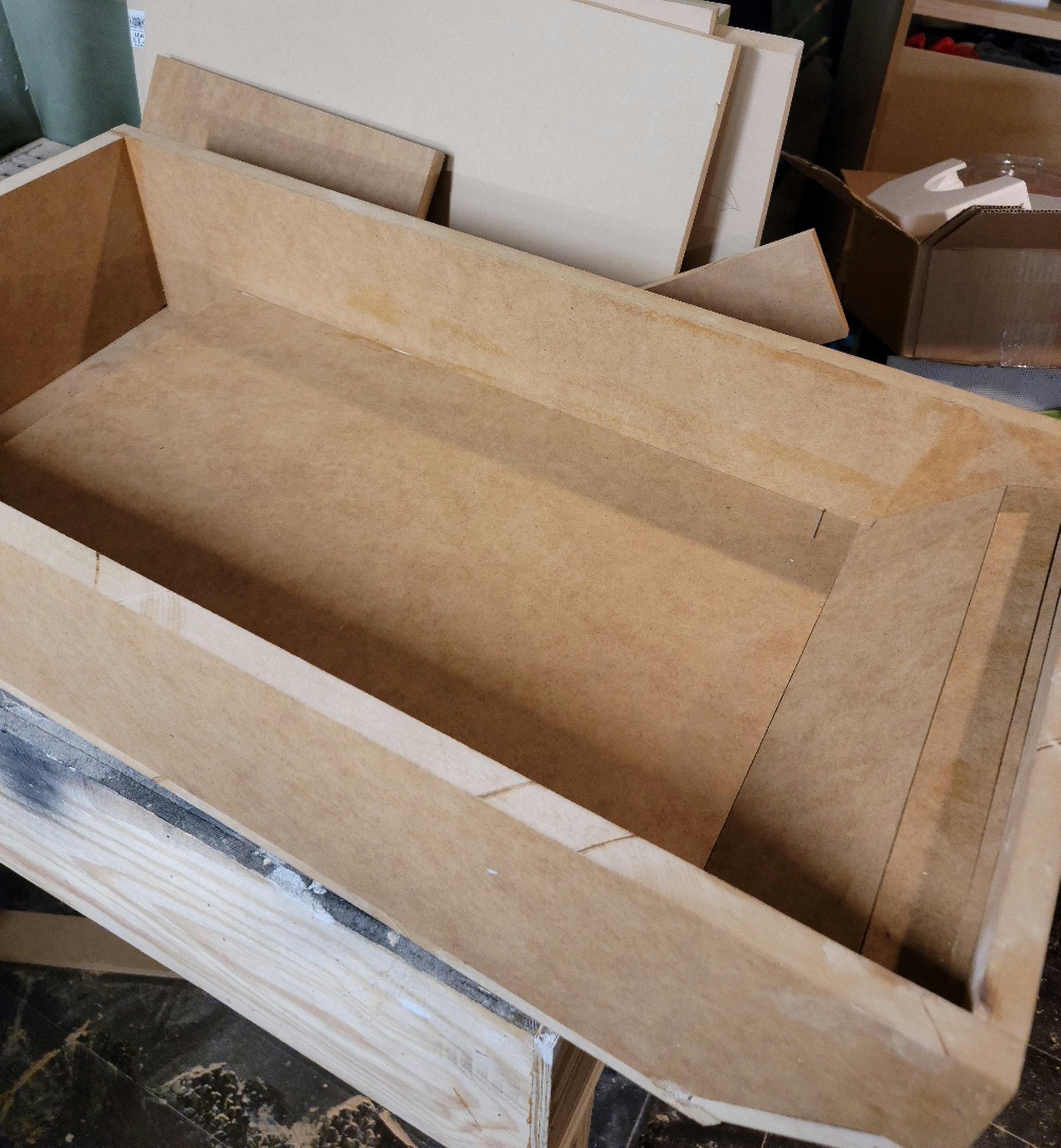

Started on the new box for 2 JL 10TW3's. This box will mount on the rear tailgate, subs forward port to the side. I designed this box myself, 1.2 cubes net volume slot ported to 35 HZ.

Note that the gap seen between the side panels and back panel (back panel faces down in these photos) is simple because I haven't attached the back panel yet, it's jutlst sitting on top. It's actually almost perfect once clamped up and glued.
