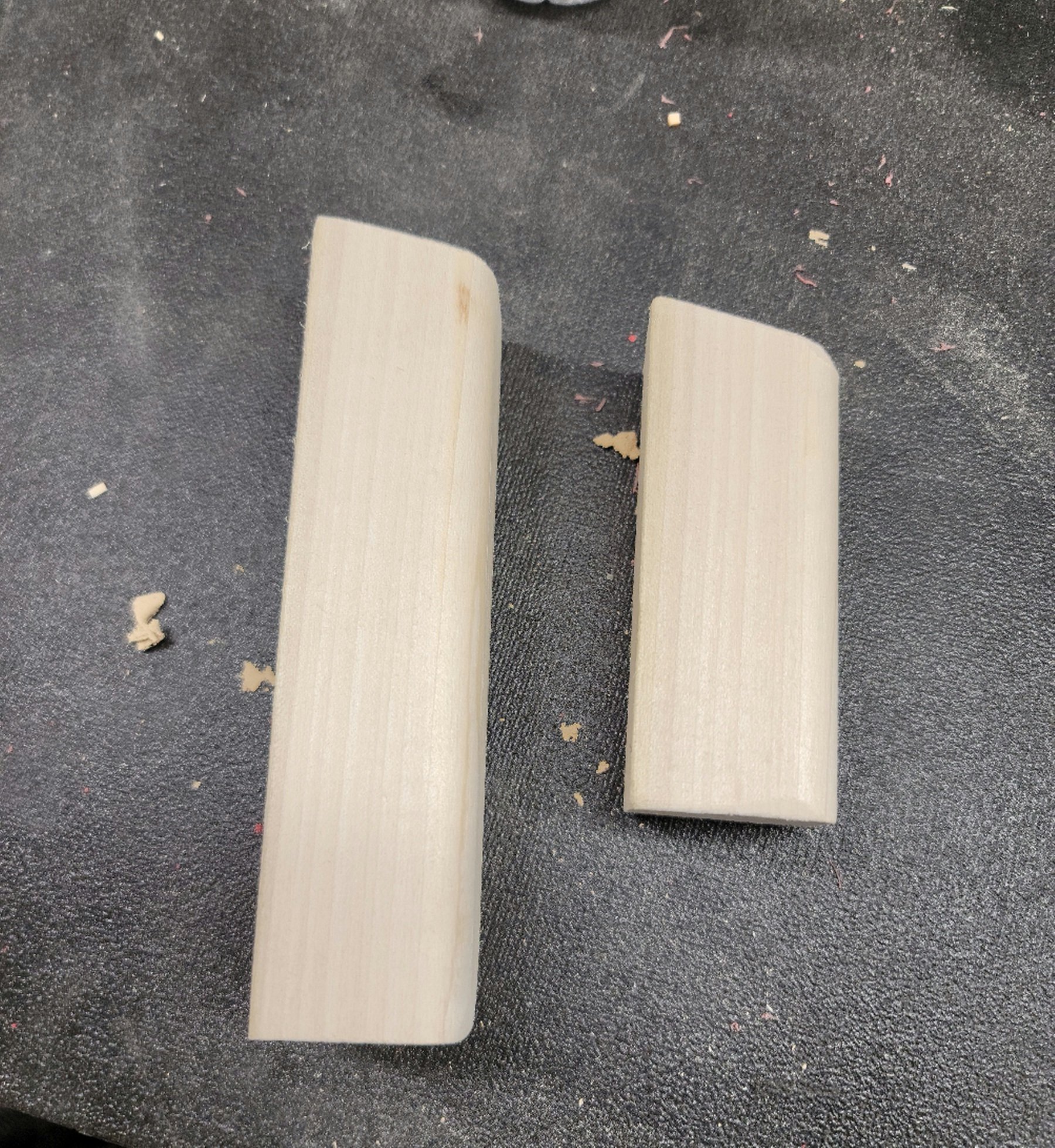

Started by making the wood braces that go under the steel to support it.

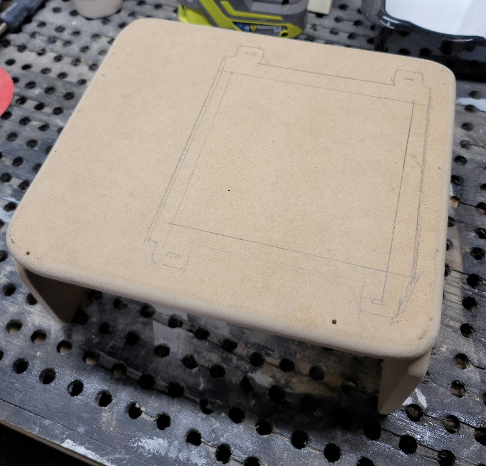

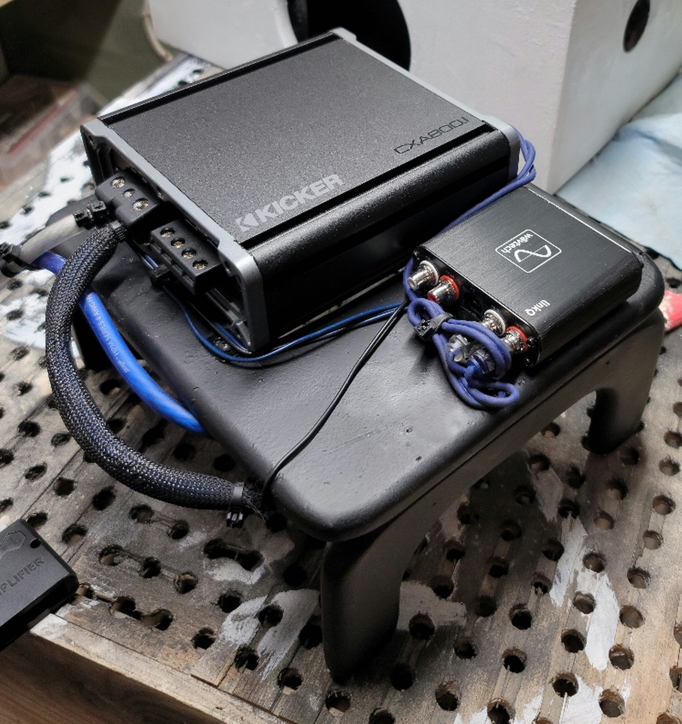

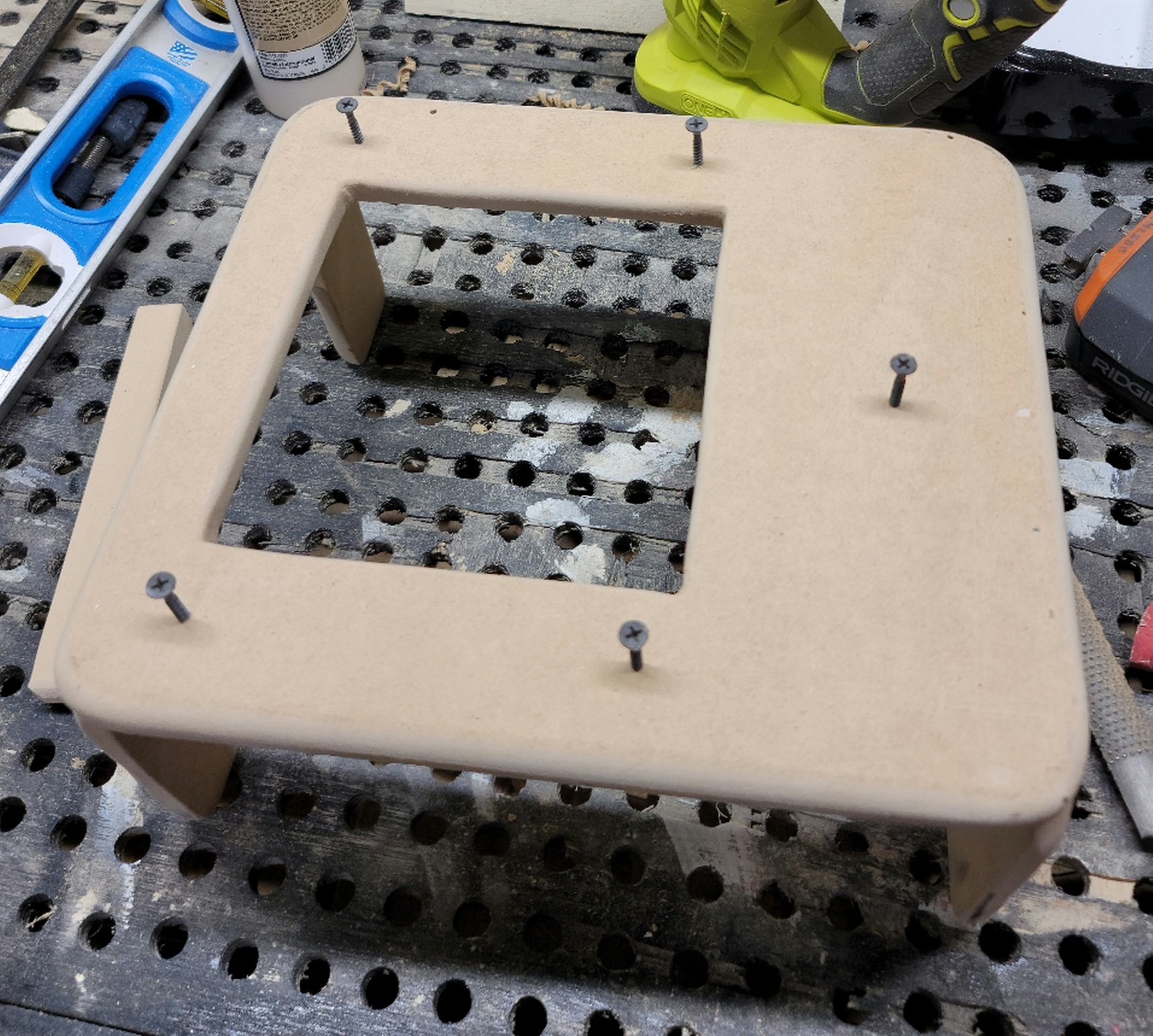

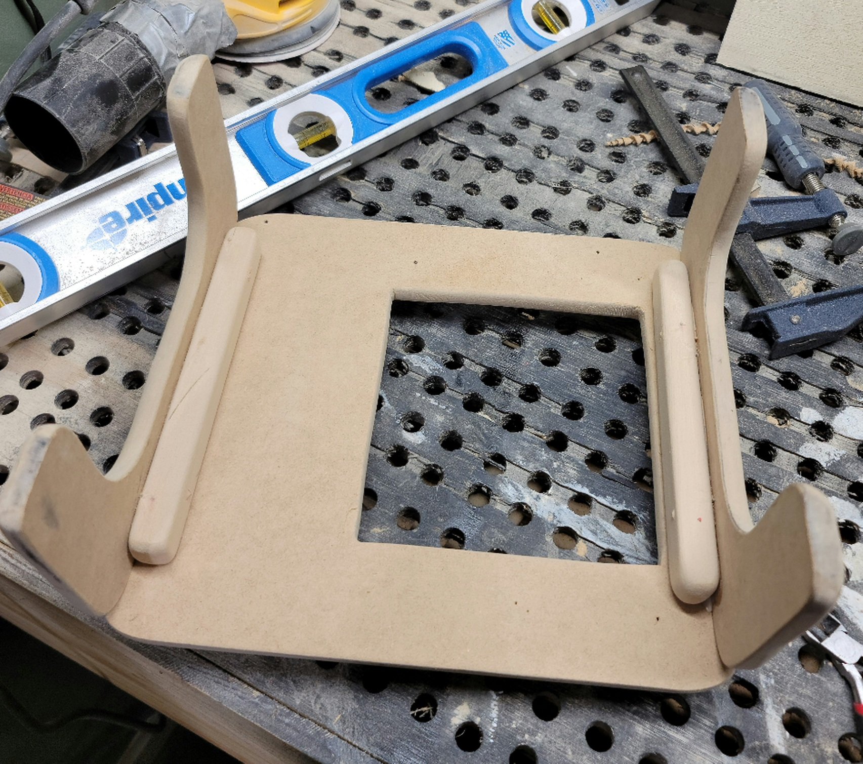

I then glued them in and sealed the box with caulk, and waited for it to dry. While waiting I figured I'd tackle swapping out the sub amp. Pulled everything out, and as the kicker is much much smaller than the Pioneer, I decided to cut my amo rack down.
26082

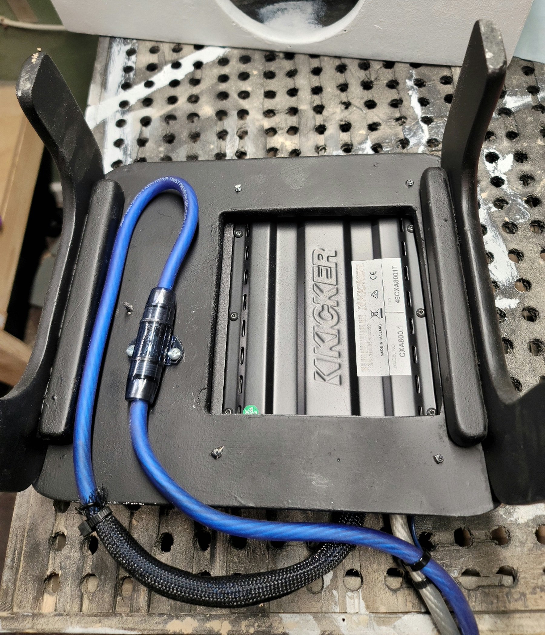

I also decided to cut the bottom of the rack out below the amp to allow heat to dissipate more easily.
26083
I also felt the legs were a bit weak, so I installed a couple of braces for it and then painted it.
26084

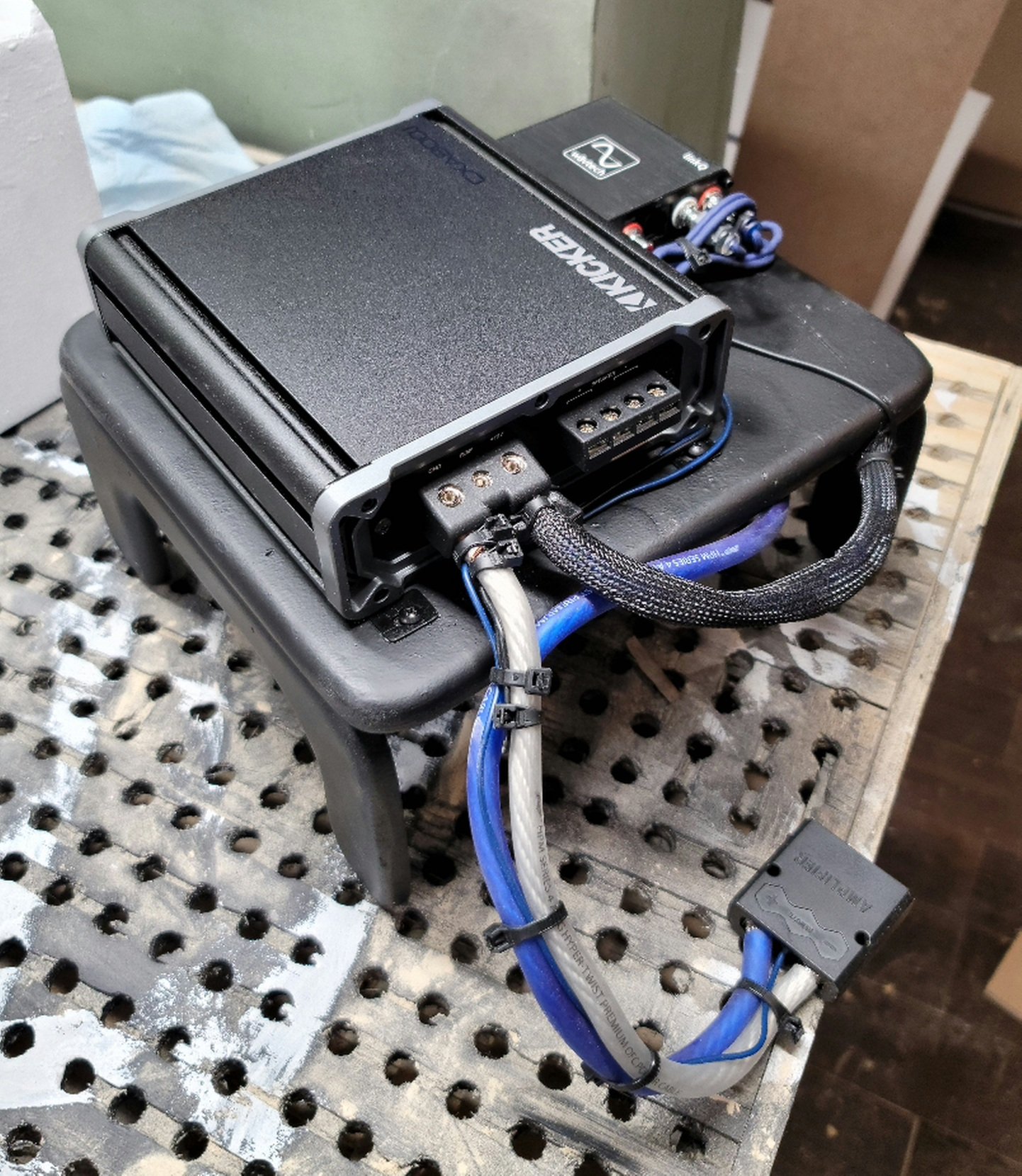

I then mounted the amp and LOC, and wired in my quick disconnect with the new 4 gauge. I had to drill the plug out to accept the 4 gauge, but after it went in fine.

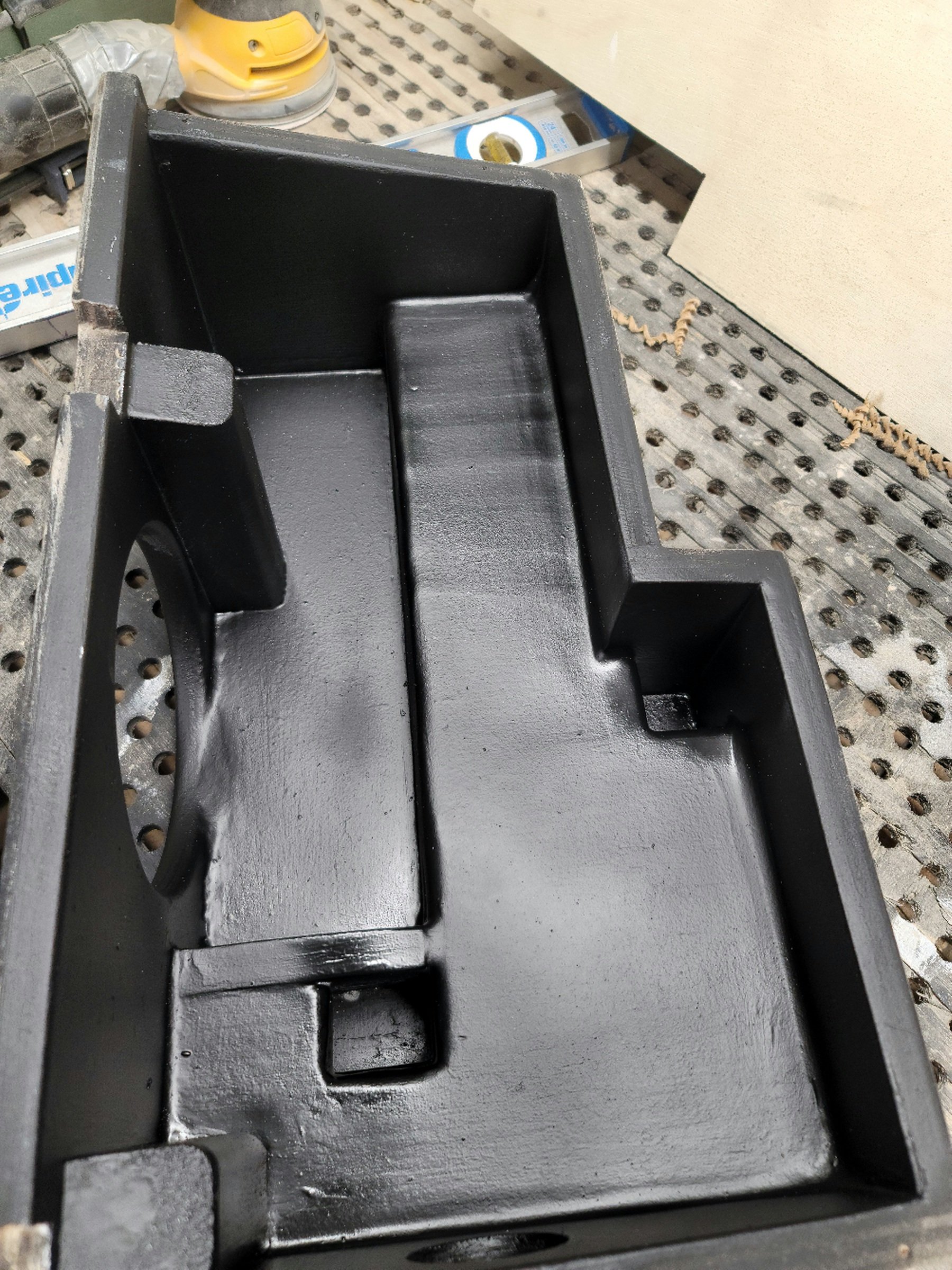

I then water sealed and painted the inside of the sub box.

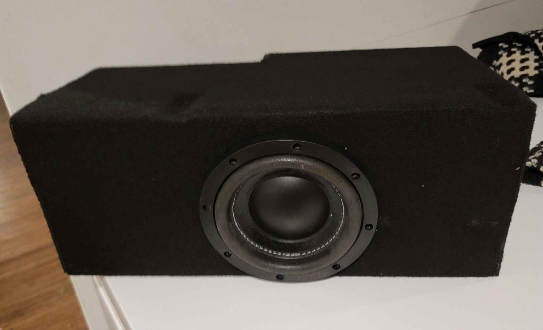

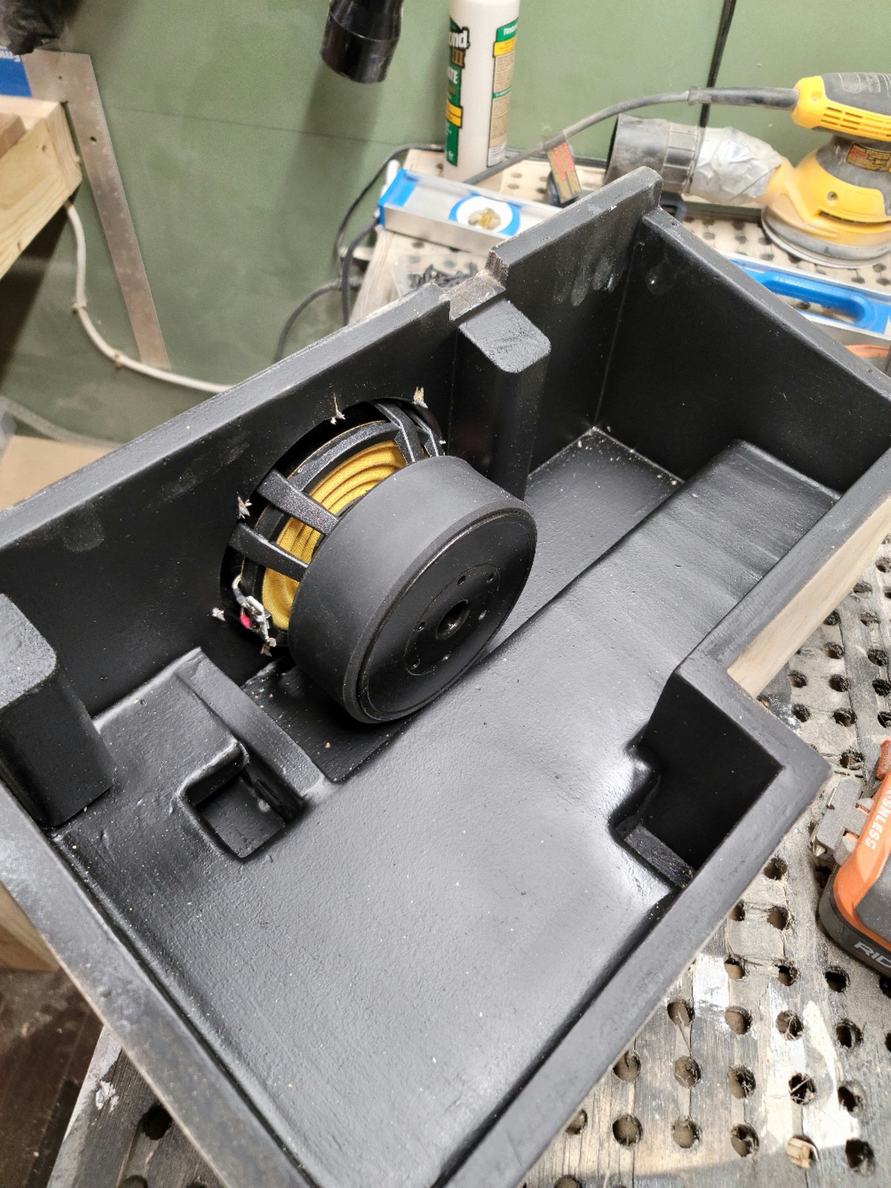

Second sub installed. Unfortunately, I did not grab enough 4 gauge wire, so the install is crazy ugly right now. Tomorrow I'll try to grab some more 4 and run it properly, and grab some installed pics. Even without the facia, it looks awesome. And these little subs hit way harder than I need on this new amp.

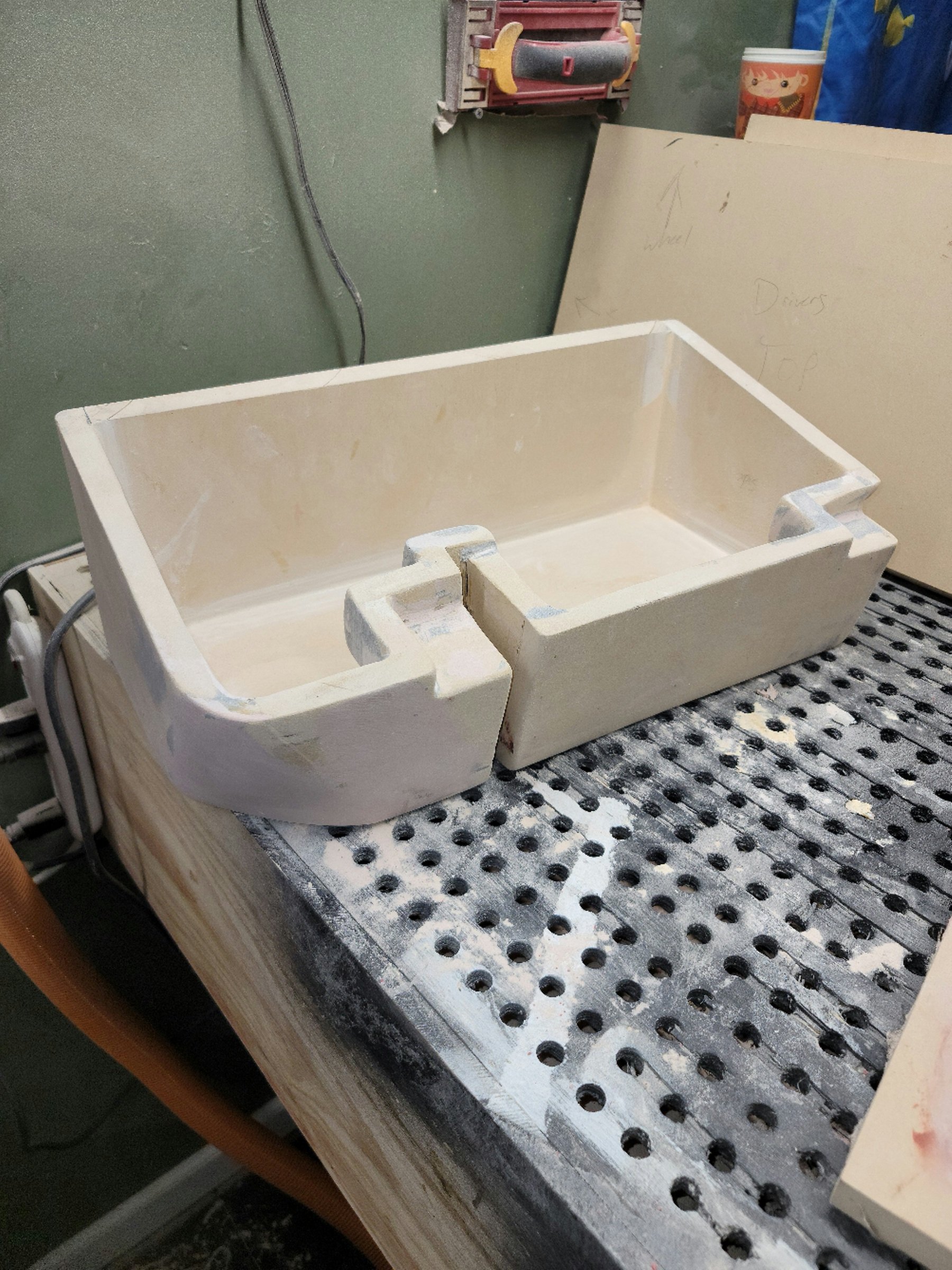

Small update tonight. I planned to build one of the sealed boxes today since I had the day off work finally. I did not anticipate how much of a pain in the *** this box would be though. Measuring and cutting panels one at a time, then recutting said pain after I make the next one and suddenly this one needs modified. But, I got the enclosure basically finished.
26557
Still a bit ugly yet though. The rear of the enclosure tilts backwards, the top drops heigh front to back. This made doing that radius to match the seat curve very difficult. The mdf corner looked like some twisted pyramid when finished, and still didn't sit exactly perfect. So, I ended up glassing the radius. I also glassed the hinge cutouts you see on the rear there, as building them required many pieces and I was concerned with strength and sealing issues. Overall, it's coming along well. Just need to finish sand and primer, then I can check volume and determine if it is achievable to run 2 subs in one box here. Physically they'll fit great, but I really need to net about .7 cubes here ideally.
