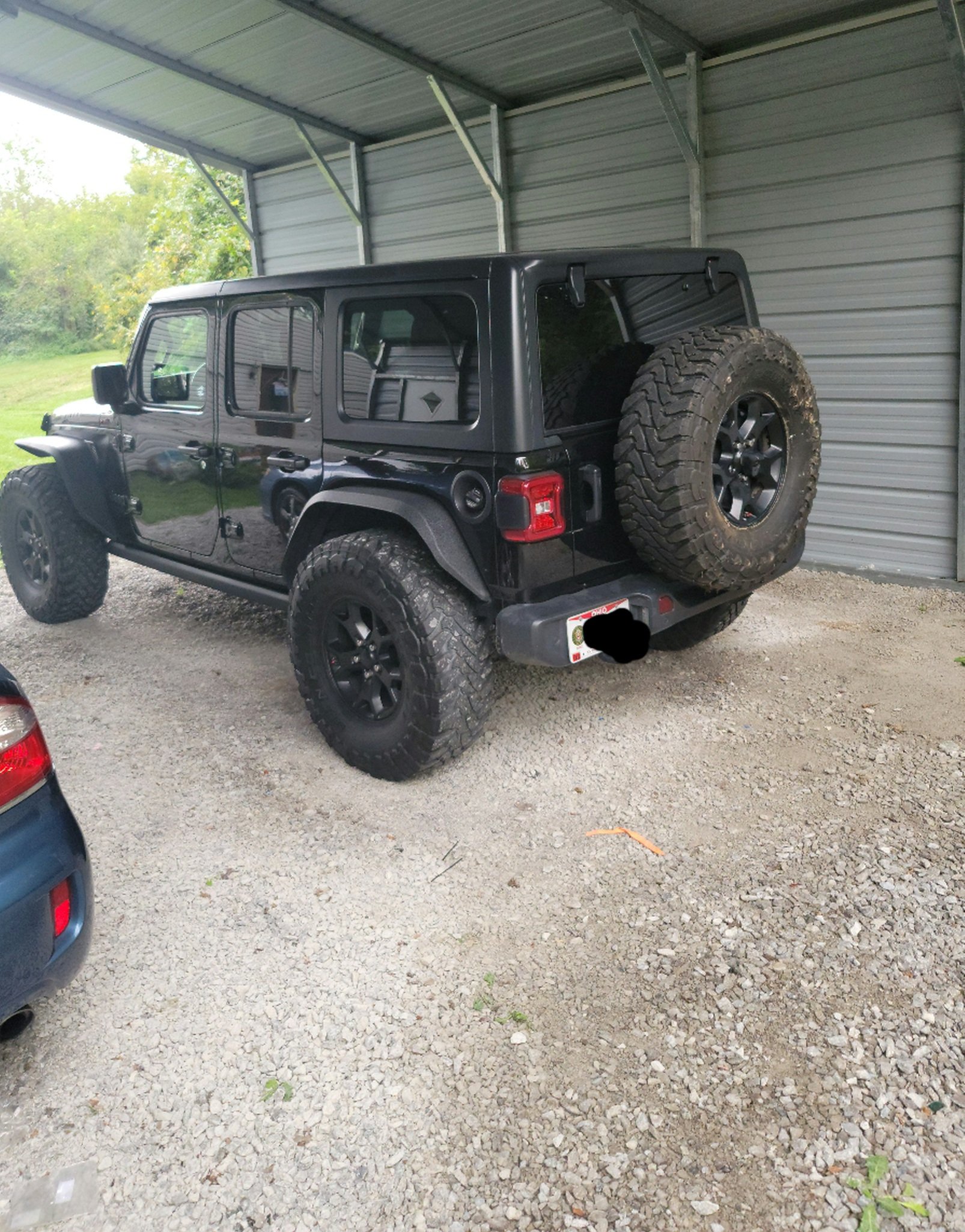

May want to consider upgrading the tailgate hinges to the Mopar/Teraflex HD model. ??
This thread hasn't been updated in some time and I'm not sure if OP is still active here but I do wonder how those hinges are holding up to that weight. I've seen door hinges start getting a lot of play in them when dudes do big door buildouts.
LS is around, he refered me to this post cause I asked about his build in another post. Thanks for looking out though.
Hinges were upgraded, but not posted here because I did them when I put the jeep on 37s. Toyo open countries, 100 lbs for just the tire. Definitely had to upgrade the hinges lol
Also, this hasn't been updated in a while because nothings changed, I'm not 100% satisfied with it, but not dissatisfied enough to actually work on it lol. And I'm currently tied up in my Subaru build
Sorry, I know this is a car audio site, but have you had any drive line issues resulting from the 37's? I was sure to order the max tow package so I could get 4.10s withouth the rubi cost just so I could run the 37's!
Nah no driveline issues, I have around 20k miles on the 37s, and I have either 3.43 or 3.73s. I have the Dayna 40 rear but the smaller front axle, I haven't beaten it too hard until I get the front upgraded. I've considered regearing, but honestly I may not even do that now, it drives fine

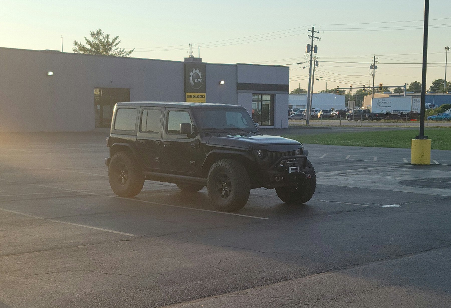

37s no lift, 2021 willys
