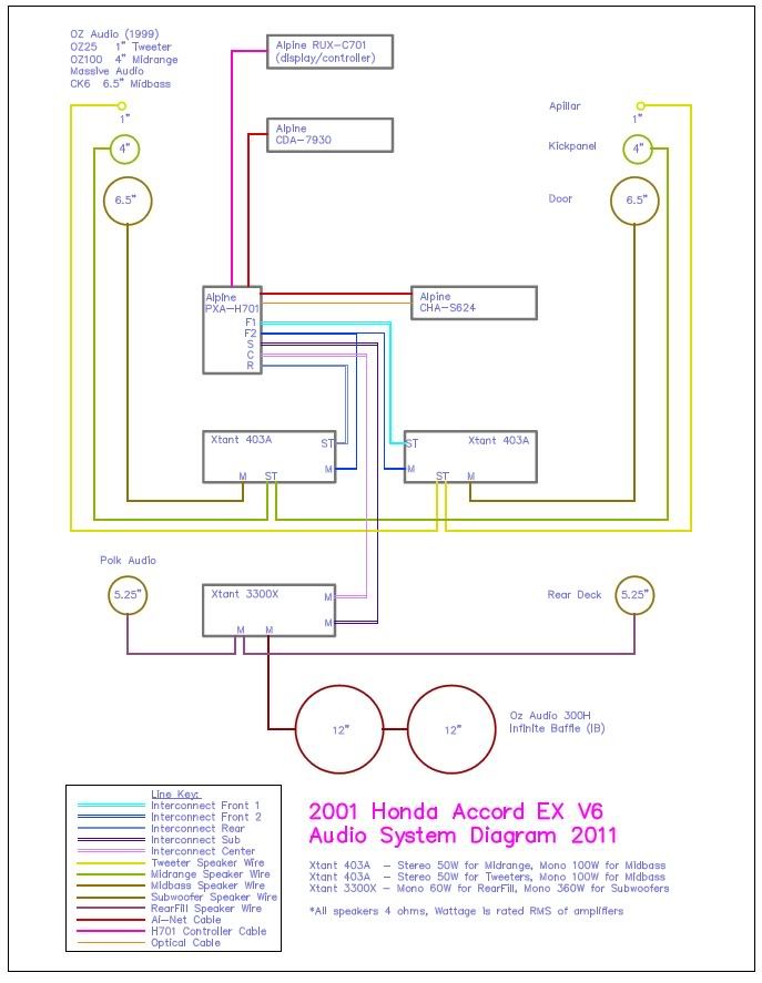

final setup pics
Gangsta

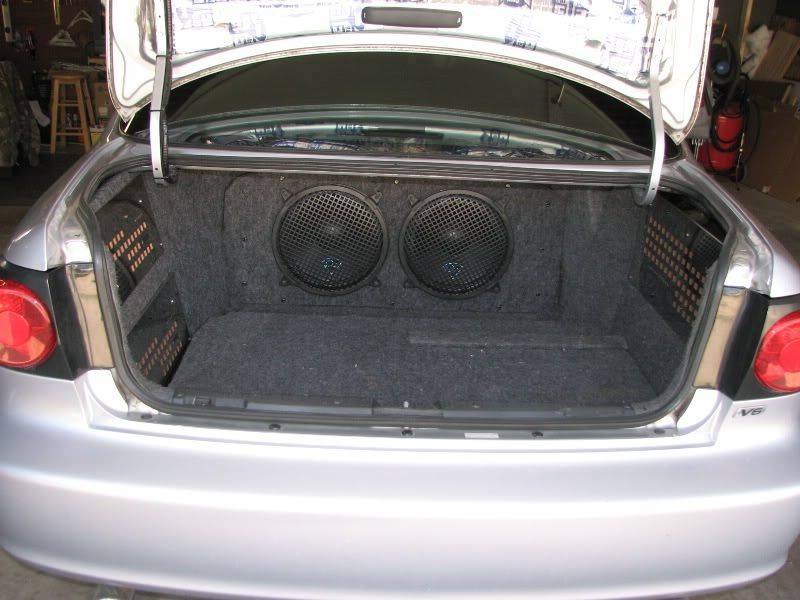

trunk before the spare tire - notice how well it fit
sub IB wall from inside
left and right headrest 1/3rd octave - front stage only (no sub)
1/24th octave
front doors
kick midrange (replaced 6.5" midbass) - side mid is not in use anymore
kicks with carpeting
front - HU is different now a 9887
DP
i'm always changing. i like my front stage a lot. time to finish some cosmetics in the kicks.

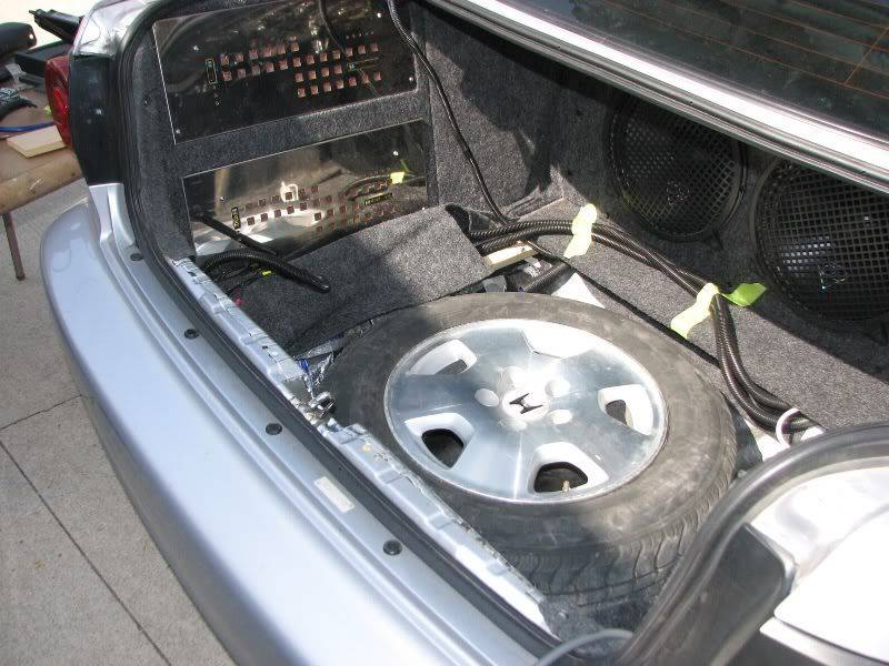

i like the trunk layout, i need new beauty panels for a finished look again. my trunk did look like this at one time:
behind the panels was a Type-R aperiodic sub enclosure, and Alpine ERA-G320, CHA-1204, and that is an old school active crossover Alpine 3672

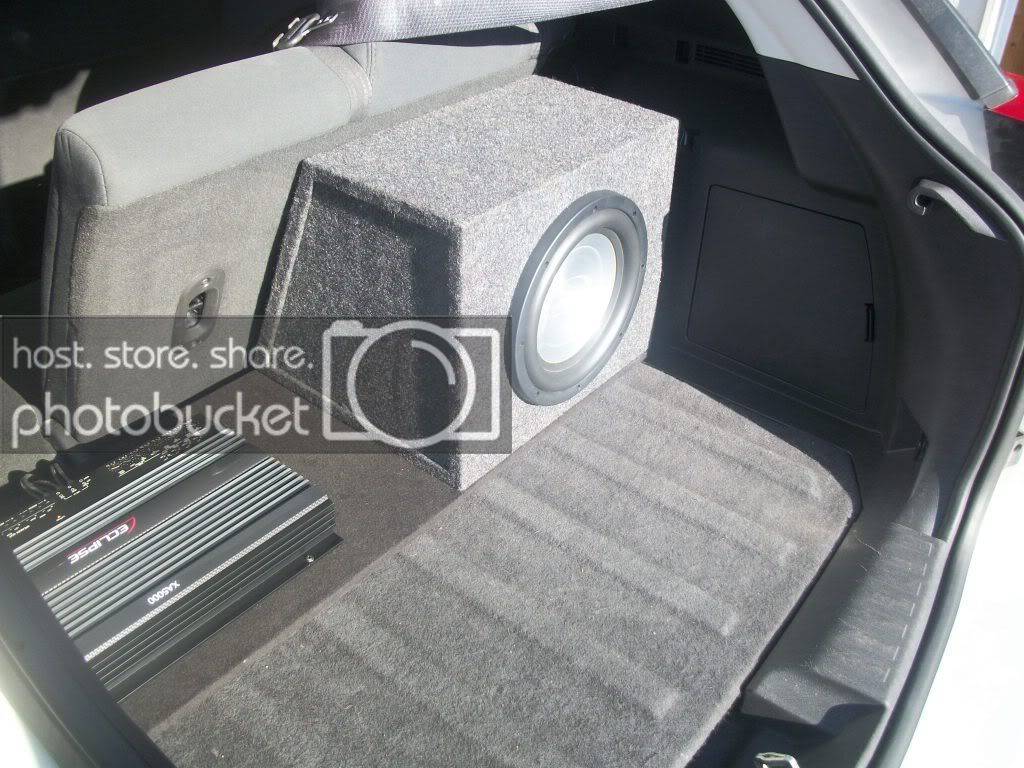

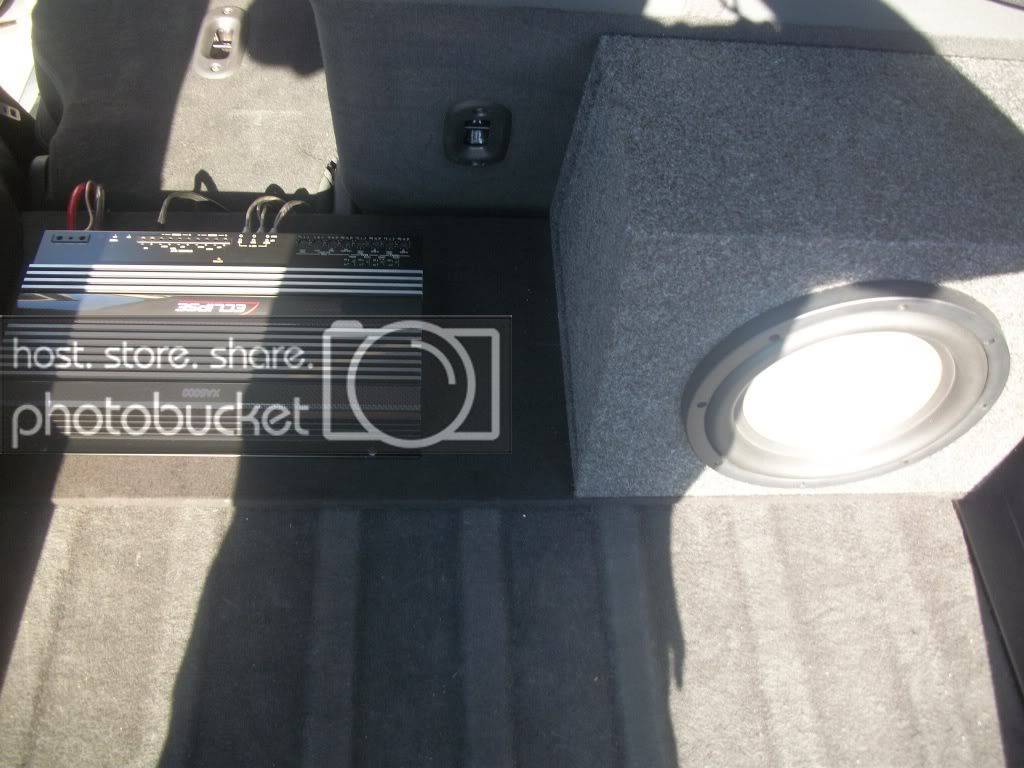

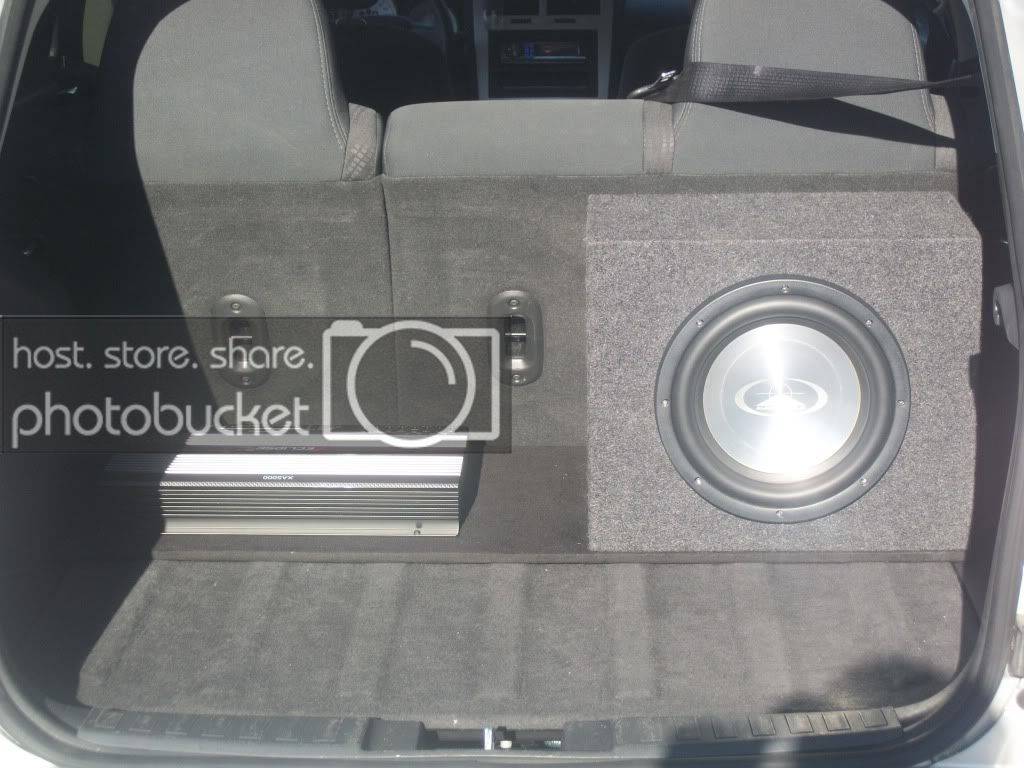

That box looks really big for that sub. Specs?
they are in my sig, 3.2 cu ft, tuned to 33hz...ram designed it. i think the pic might make it look bigger, plus the car is tiny so its prob just optical illusion lol..its not reall that big..its actually right where recommends for the sub. sounds good, gets loud couldnt be happier but i want to change up to 2 12"s with about 2-3x the power soon... 4000watts or so to 2 12's...something around there..trying to figure out where to go i want something like my xxx but louder lol. was recommend ascendant mayhems so i've been lookin into them ..
