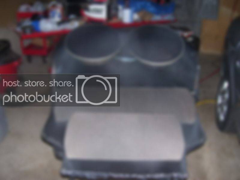

fleece, soaked in resin or not, gives you no structural integrity. it is only used to make the shape of the enclosure being built. the strength of the enclosure comes from the glass mat/cloth and resin. fleece actually makes things harder to work with in the end. the best thing to use is a super thin stretchy material, like the stuff gymnastics uniforms and swimsuits are made from. (it's not actually lycra but it is very similar to that). this will give you the smoothest possible surface to begin laying glass on which will save you hours of sanding later.

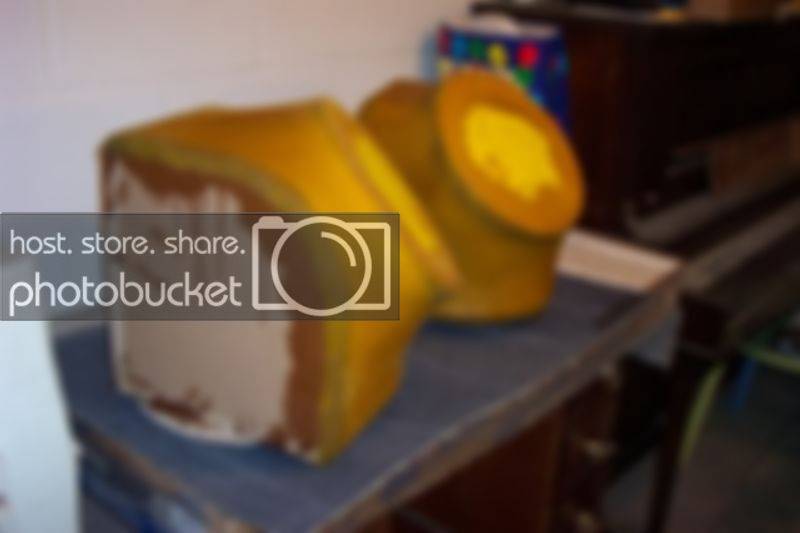

this isn't the best pic but here is an enclosure i made using fleece. once it hardened the surface was anything but smooth. it required tons of sanding before i laid down the glass to keep out air bubbles.

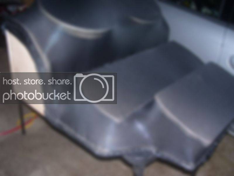

conversely here is another enclosure where i used the gymnastics material. you can see how the surface is like glass.

i agree that when doing a sub box you must glass it for strength, but for door pods and such, use a thick fleece that you wet all the way thru, when dry it is strong. using a Da and 40 grit the bumps come off fast, in a couple minutes it is good enough to skim coat it with bondo (yes use rage gold, it speads smoother and easier to sand,, but it does cost more (ppg brand is rage gold relabled and cheaper)) normally 2 coats and it is good to cover with swead or vinyl.

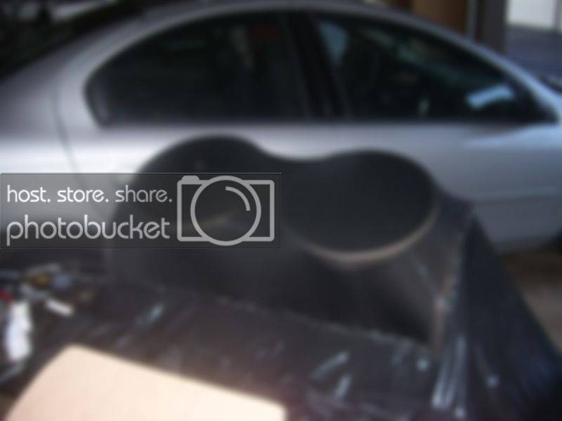

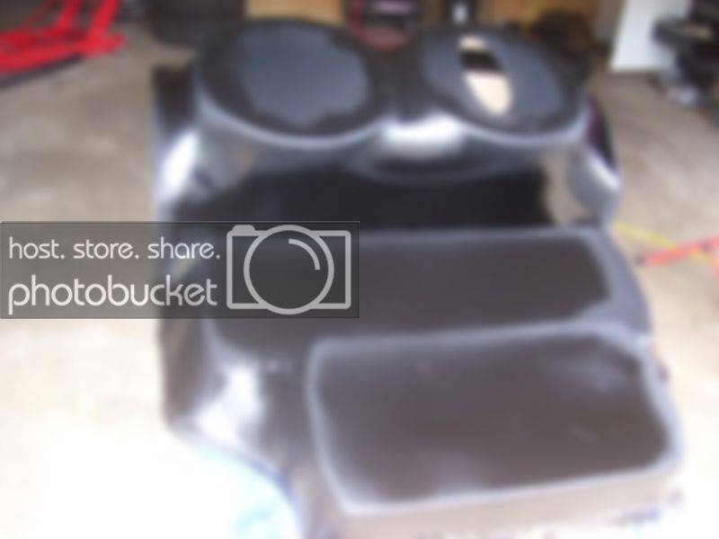

for the life of me i can't remember what it is called but i got it at joanne fabrics. the stuff is amazing. it stretches in every direction super easy and seems to be really snag/tear resistant. it is not cheap either. if memory serves it cost about $7-8 per yard but i don't mind spending a little more to get the best that i can to work with. same thing applies to rage and the b440 resin i use.
here are a few more pics of it in action. you can see that when it is not stretched it has a sheen to it.
and when it is stretched it is practically see through.
