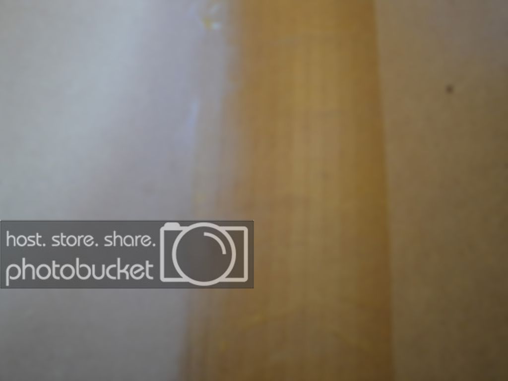

I didn't get any pictures during the process (camera was down and decided to not come on until it was all done). But the box is 3.3 cubic feet with 48 sq in of port tuned to 32 hz. This is also the first time i've ever done a kerf port, and i thought it turned out pretty good.
Questions? Comments?
I love bare wood boxes, and this one looks cool. I was just wondering about the second picture, was there a problem with sealing along the kerf or something?
Thanks. And no i just wanted to take a close up of the bottom of the kerf. Haha. It's all completely sealed from the inside with clear silicone.
