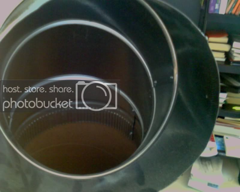

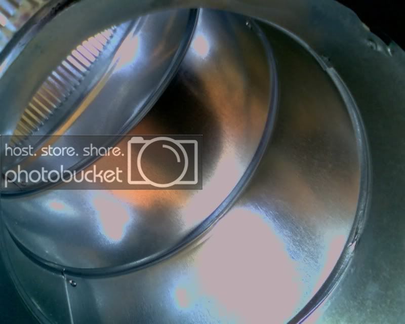

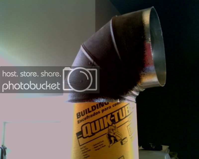

Regarding the 8", I would be using sono tube of course, but I would have to put a 90* bend in it.. The only 90*s I can find in that size are AC duct bends, but they're made out of sheet metal... So you think If I formed it all together and bondo'ed out the bumps and glassed the outside of the bend would there be a problem with and reverberations from it being thin? Here are a few pics of what I would be dealing with.
Thanks again
You have to bondo it up nice. Those aluminum sheets are weak as hell. You have to make sure it's solid.
But I'd kick the 8" idea out of the window, and get 4". You can just get PVC, and PVC elbows and the like, and would be much easier and a lot cleaner looking.
