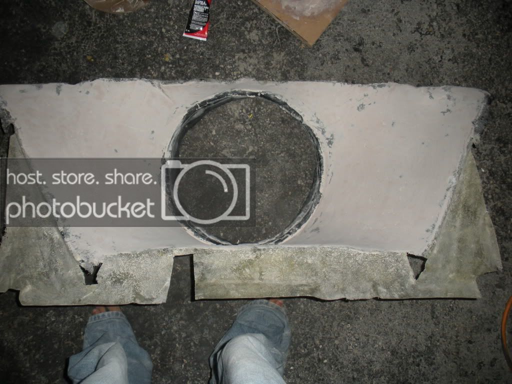

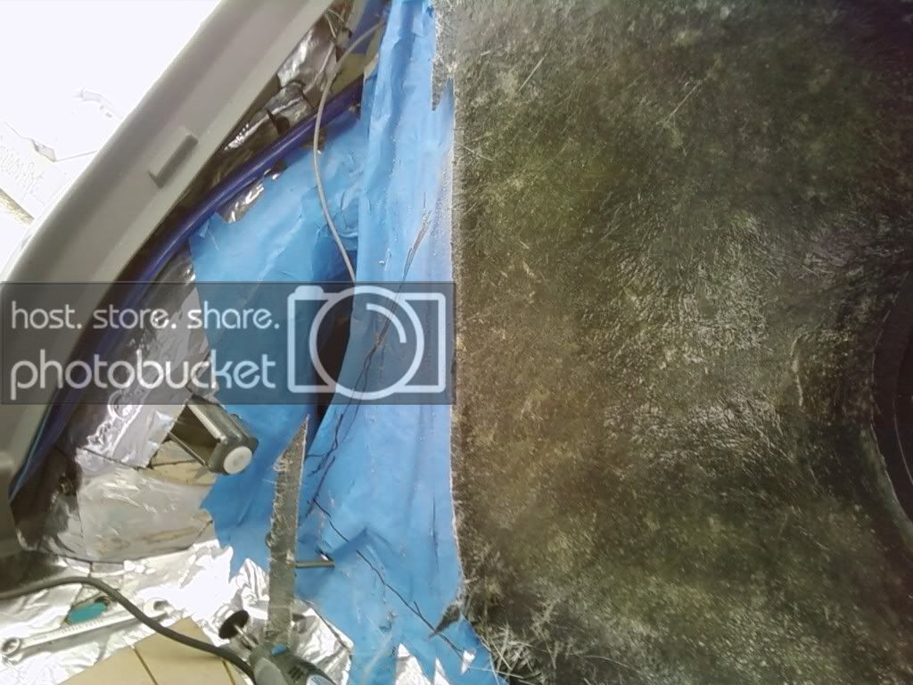

fbi90909's TC LMS 5400 15 + Saz3000D rebuild + fiberglass
wiped off the glass dust

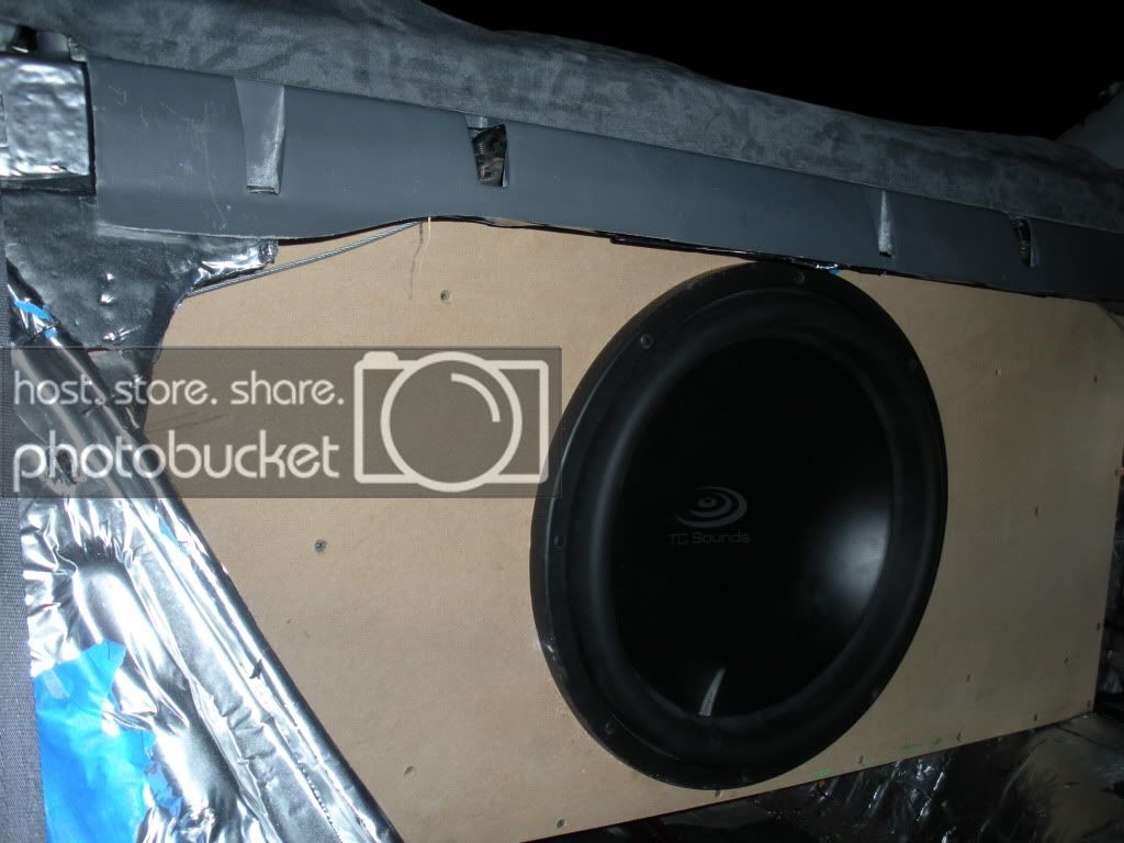

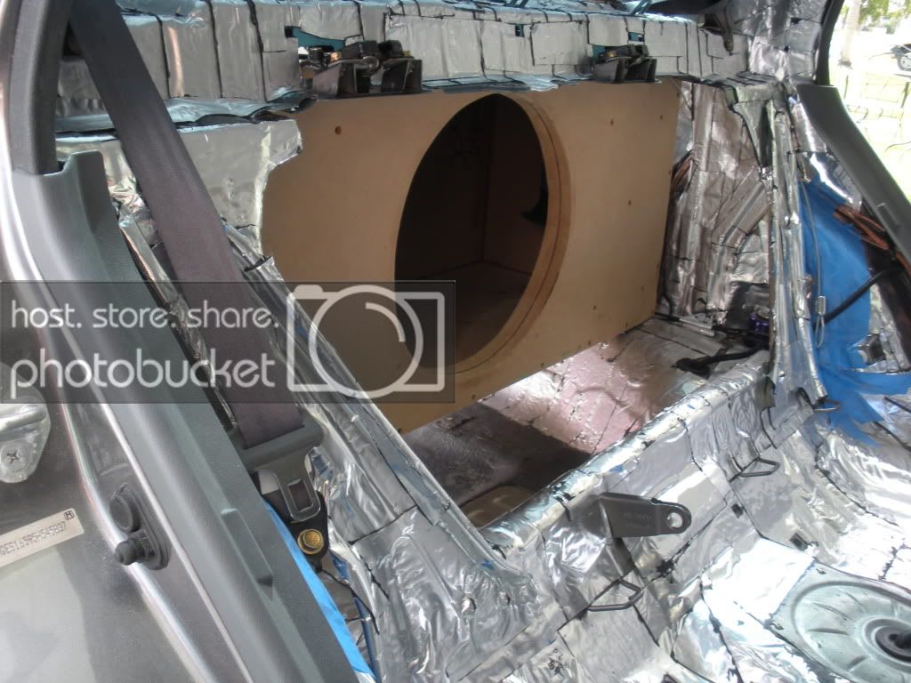

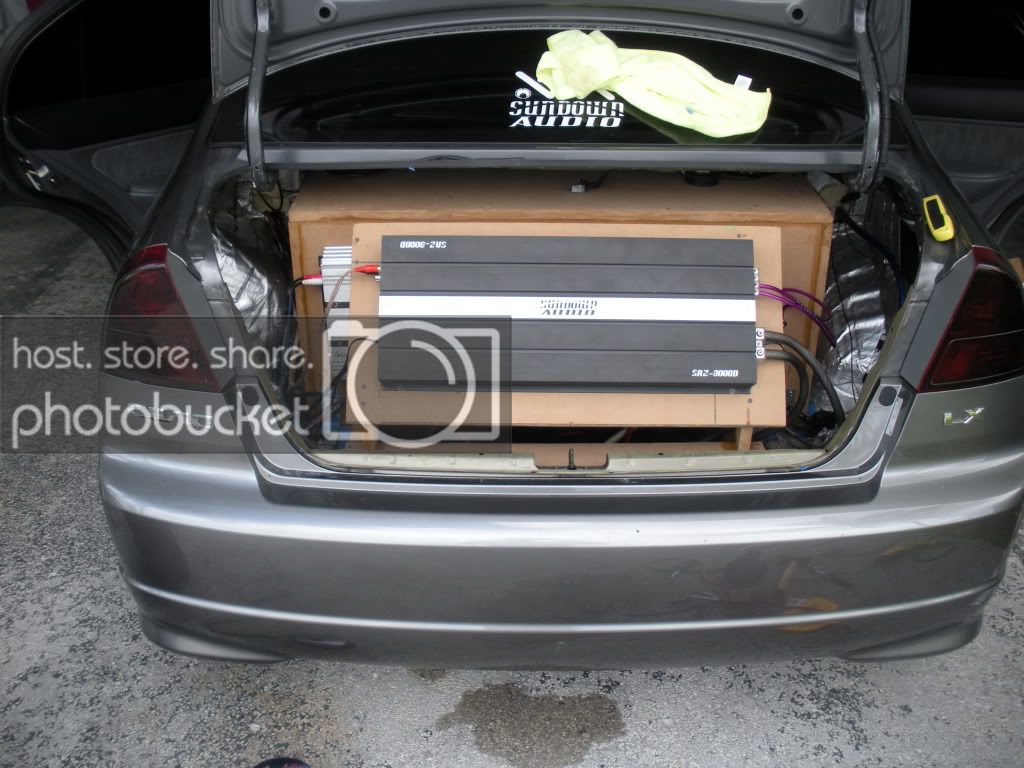

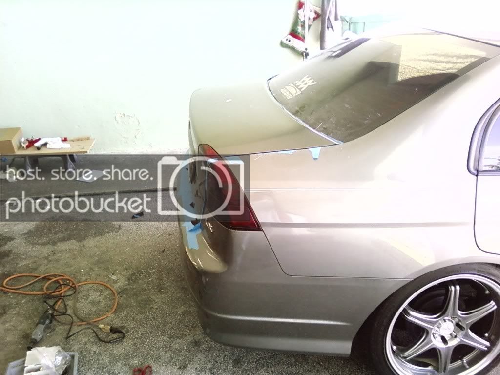

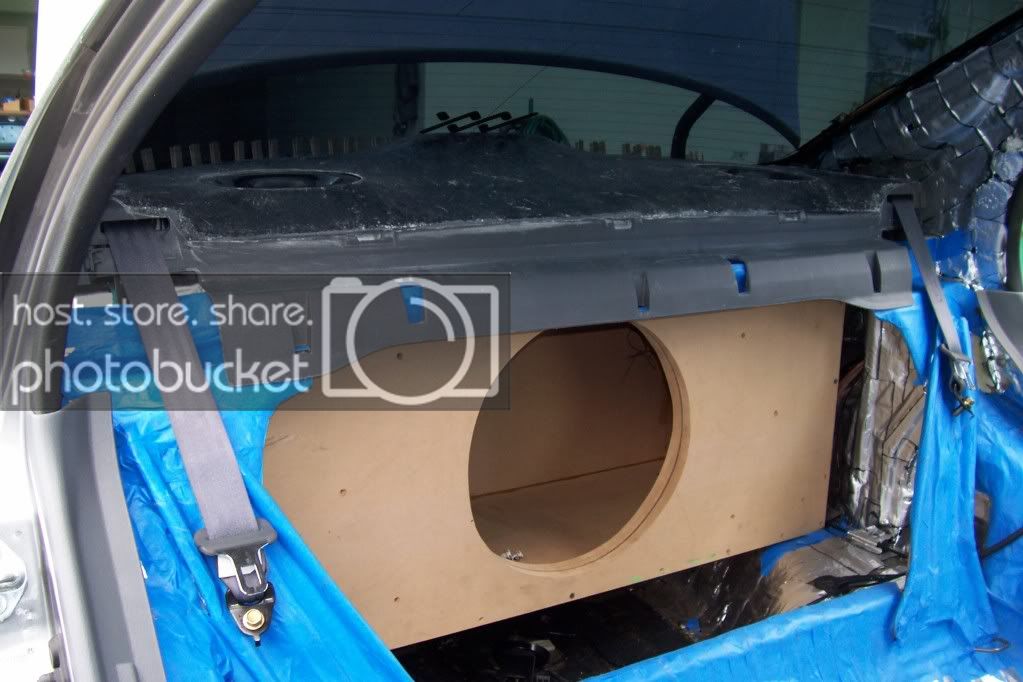

then i decided to get a peek at how it looked mounted inside the car
nom nom nom!
looks promising

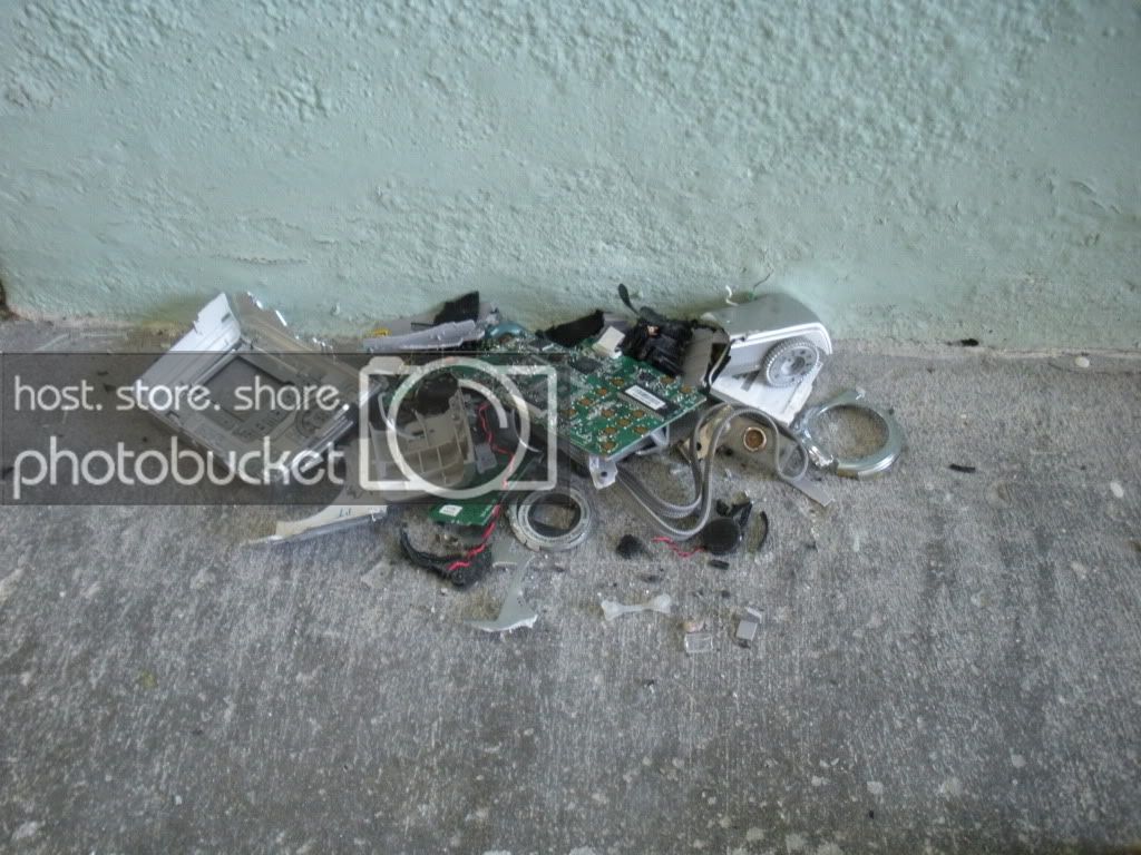

well this is the point of the day where my camera decided to take a shit. it's a kodak easyshare c330. won it from a work party and it lasted me a good 4 years. not bad for a free camera. now i have to take all my pics with my phone until i can get a hold of a good camera.

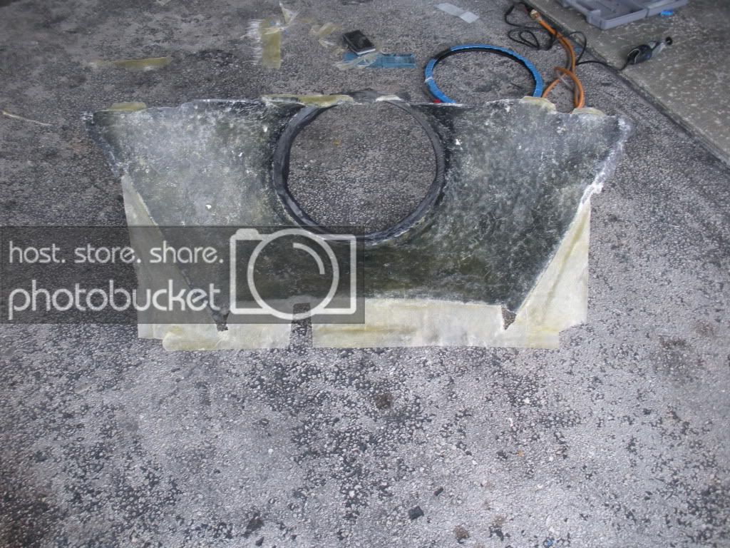

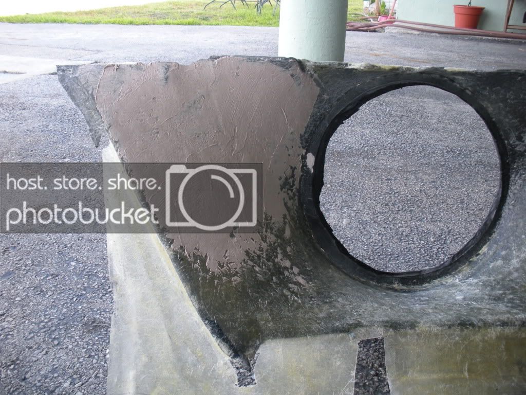

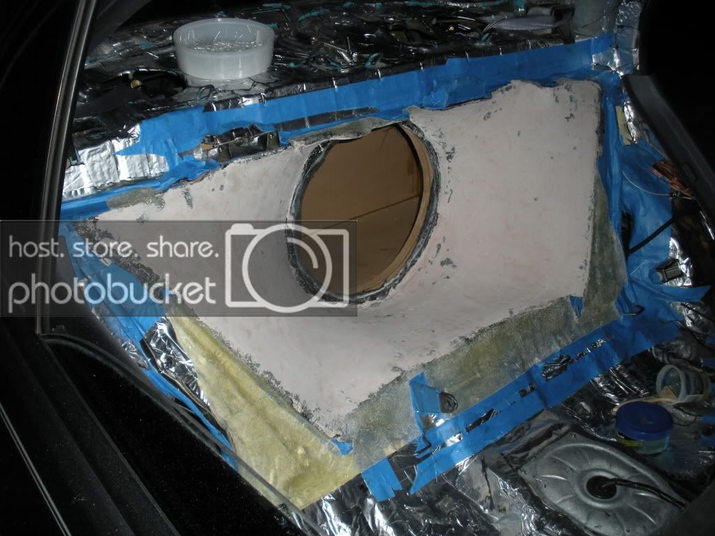

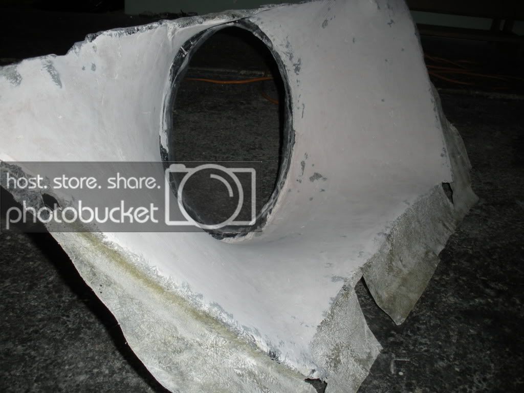

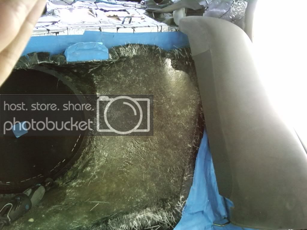

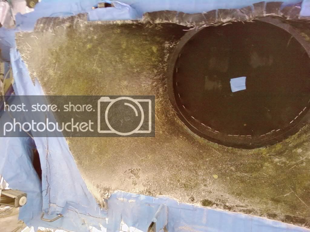

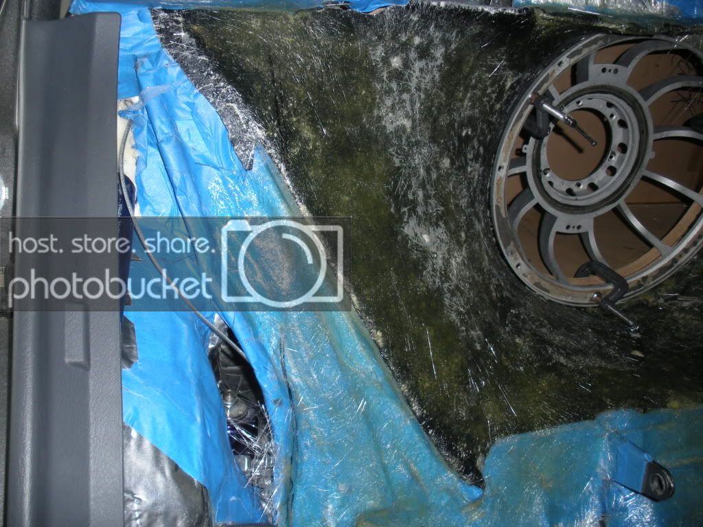

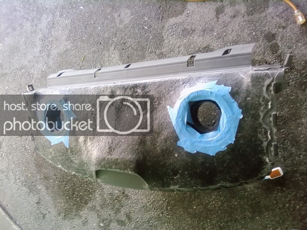

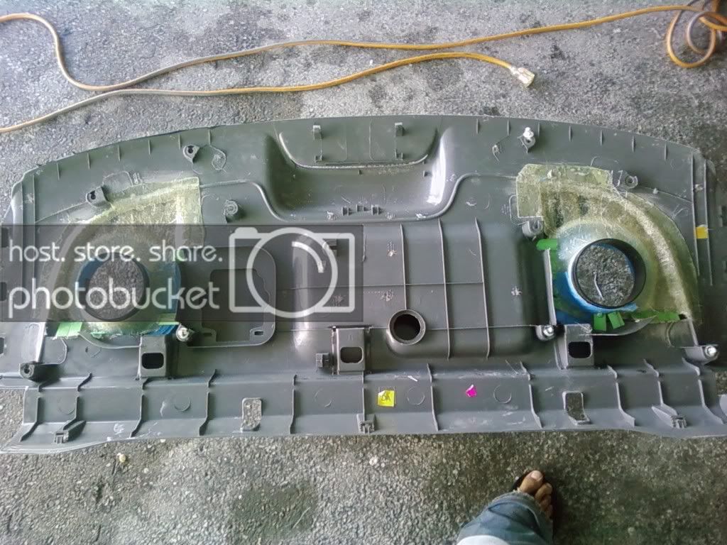

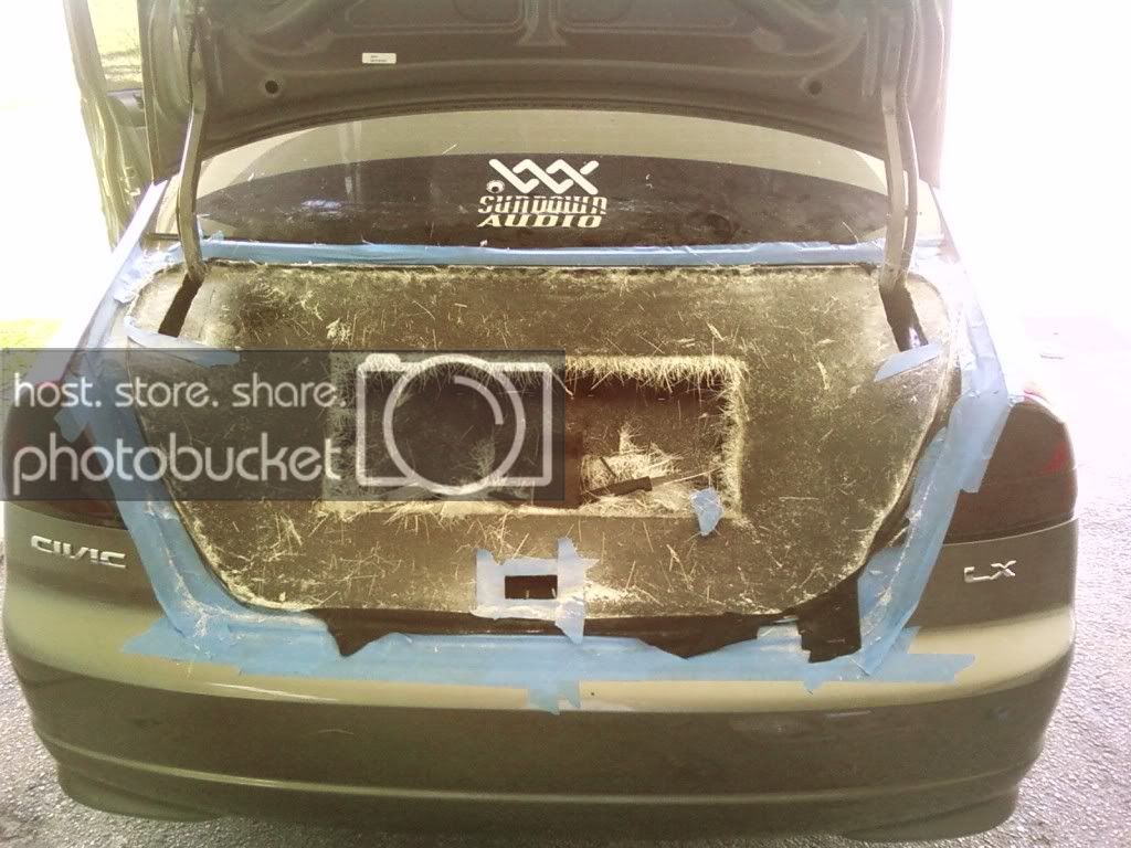

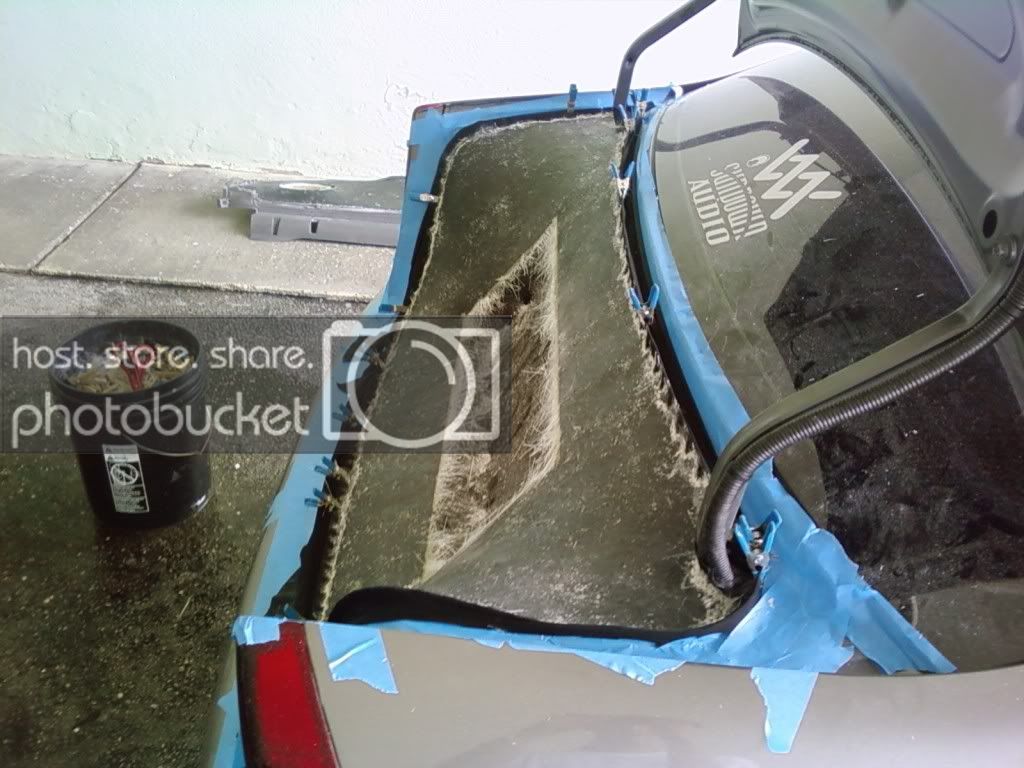

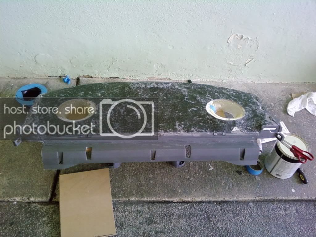

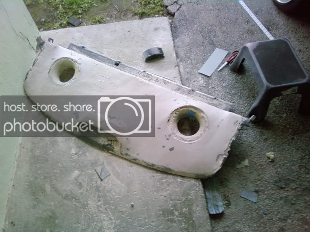

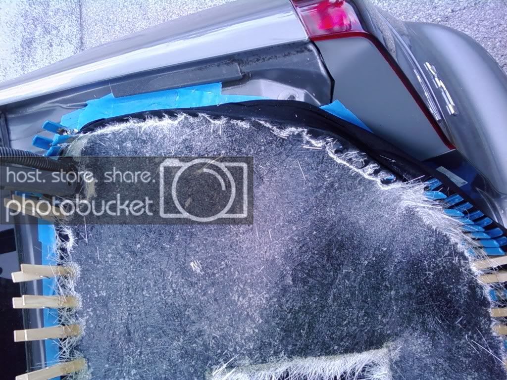

after i sanded off the ports i had to set it aside until i went and picked up some expanding foam and some body filler. so i started working on getting the trim area of the amp panel stiffer so it would have a pretty good trim line to hook up into the weather stripping

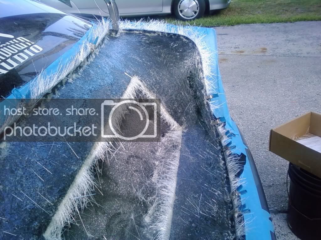

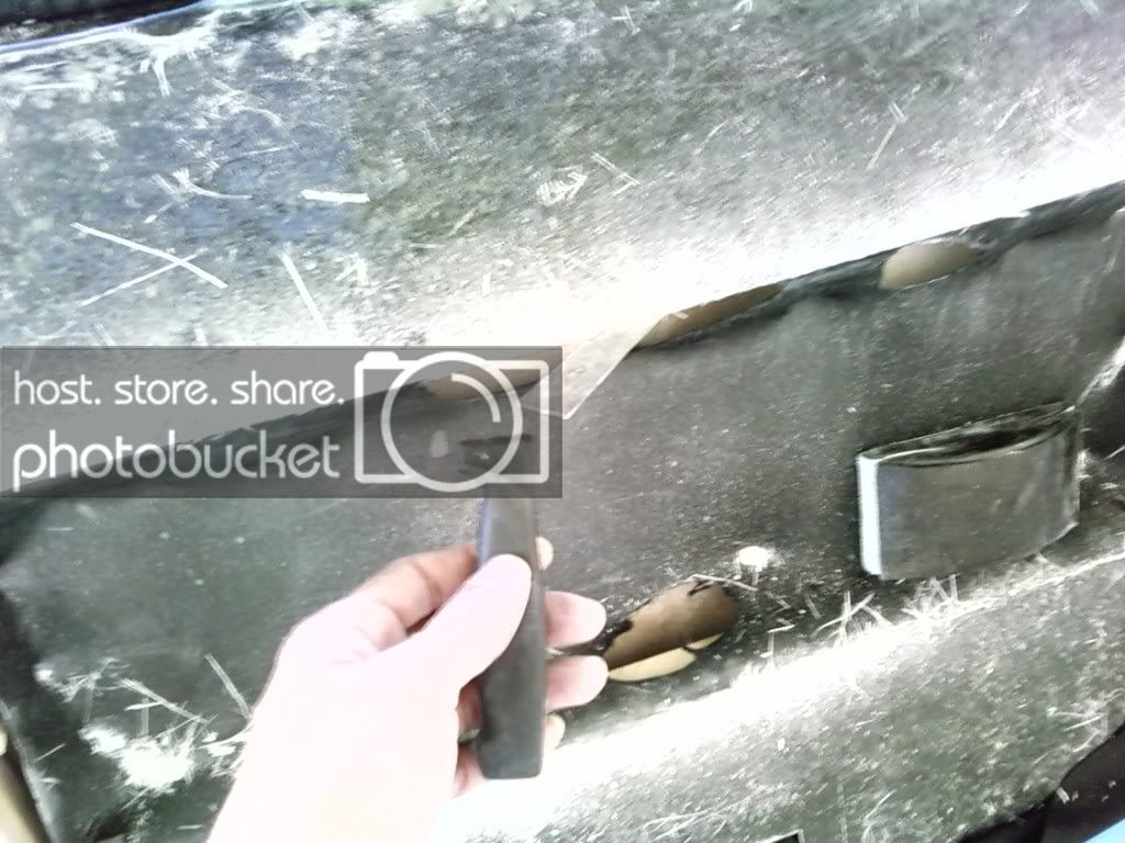

anyways i started to remove each clip and sand down the exess fiberglass that wasn't attached to the trim but to the clips
then i glassed all of the trim to stiffen it

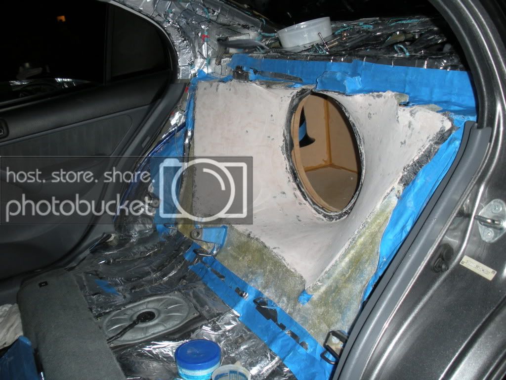

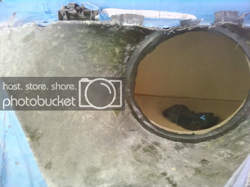

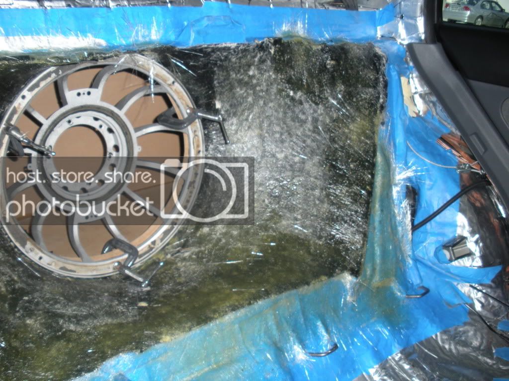

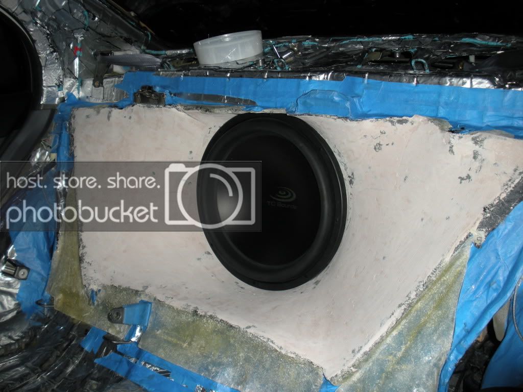

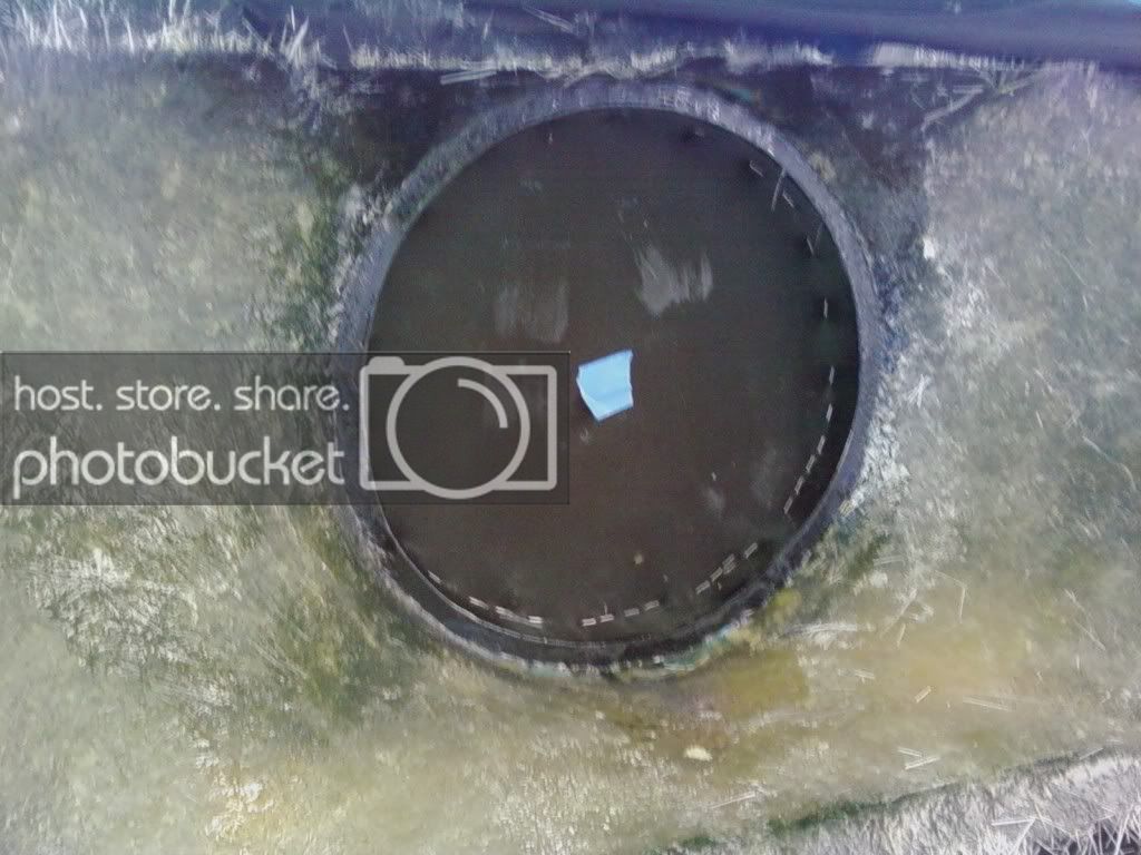

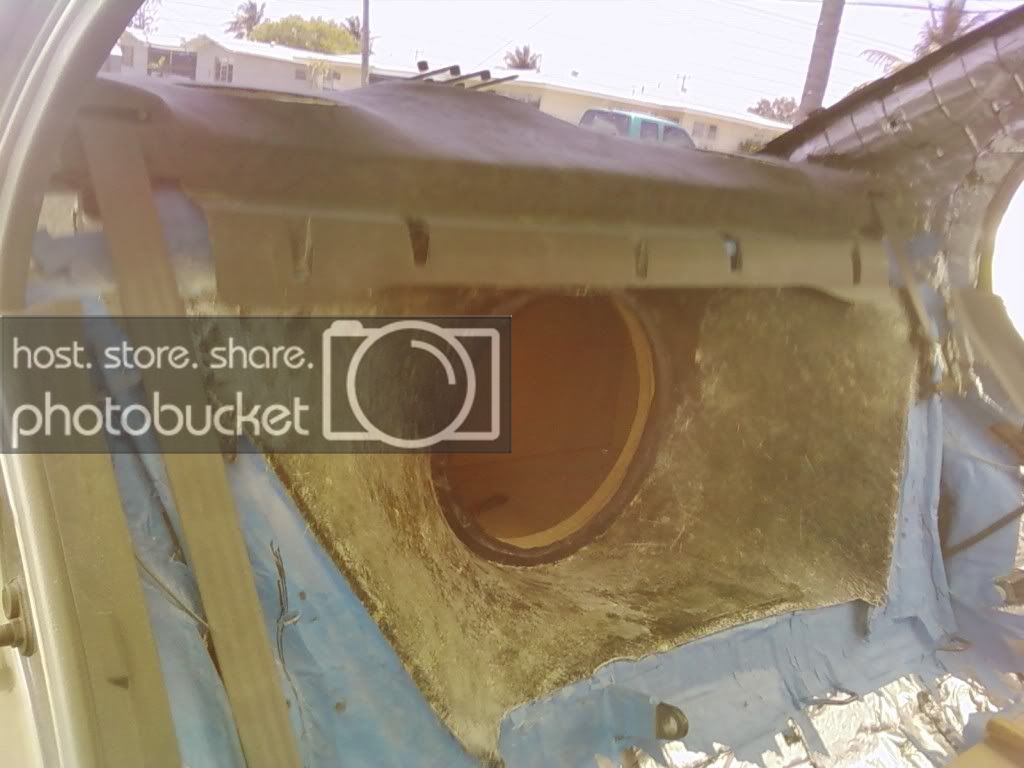

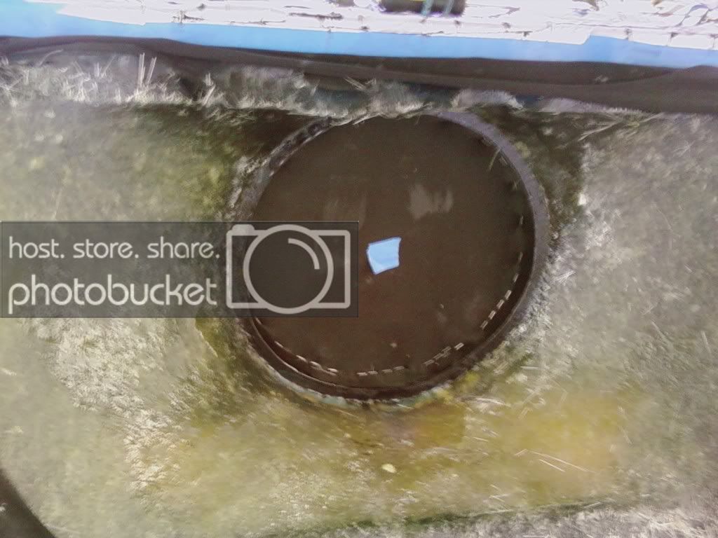

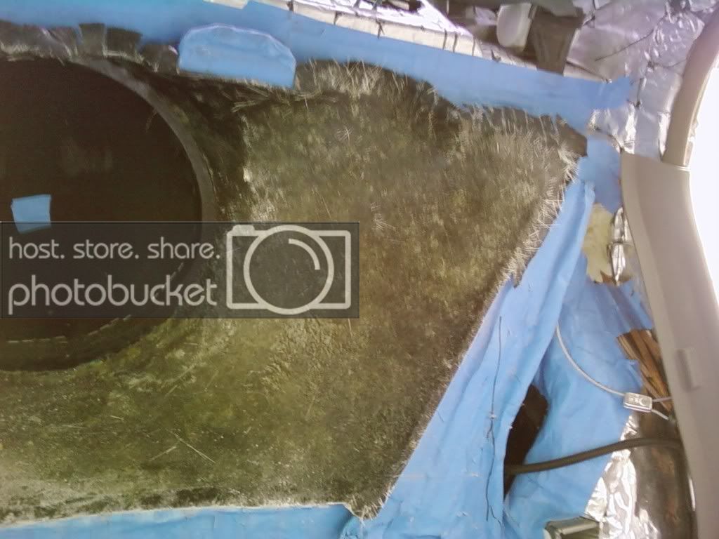

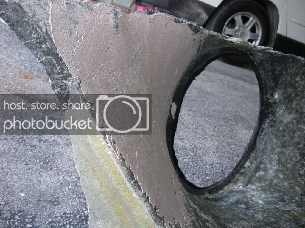

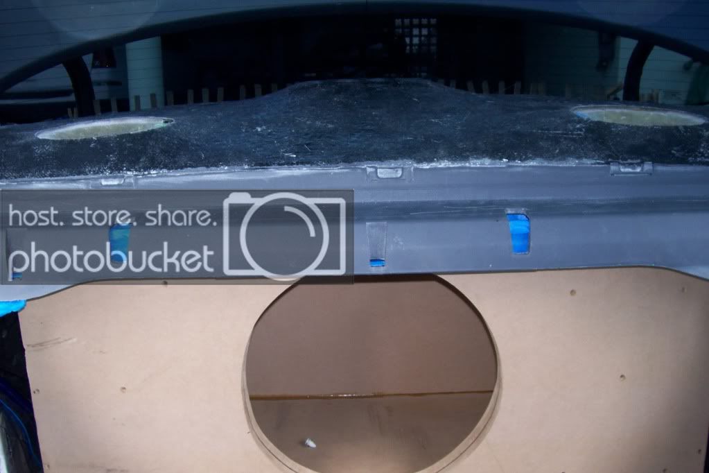

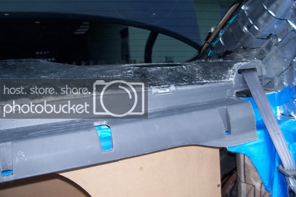

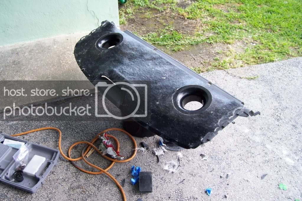

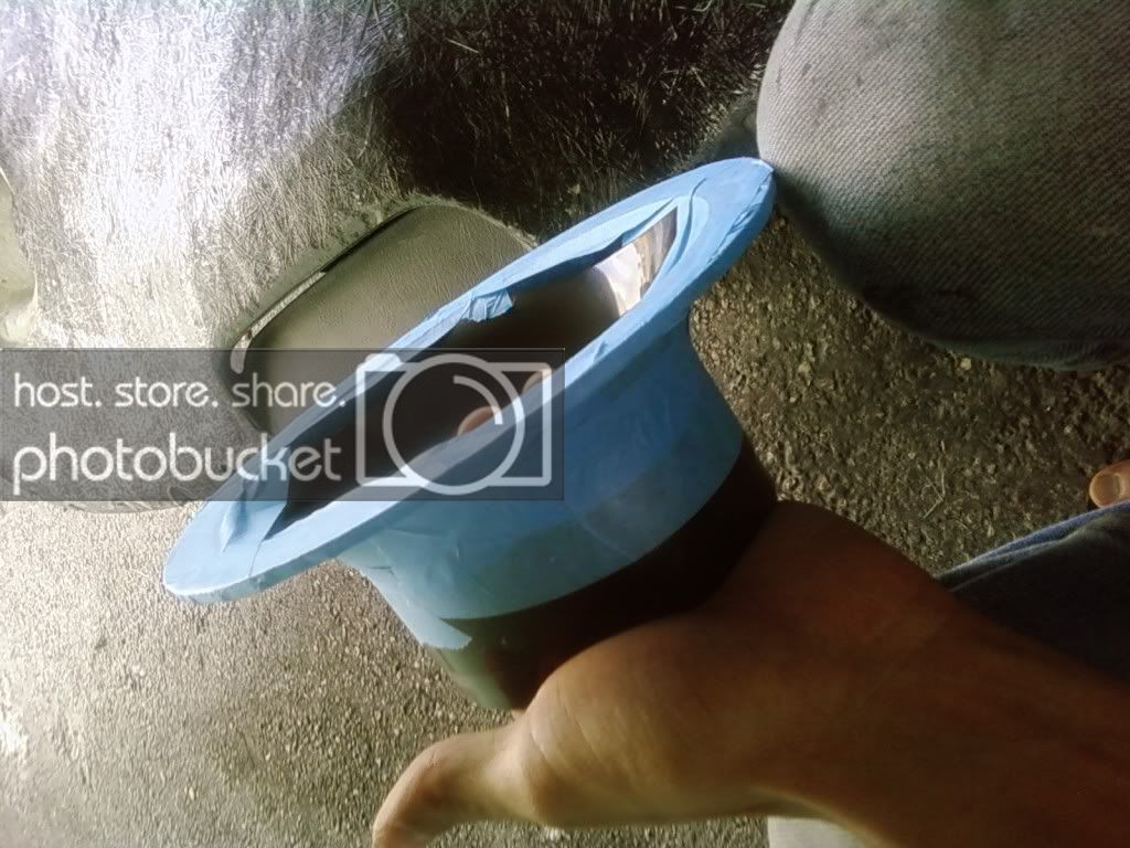

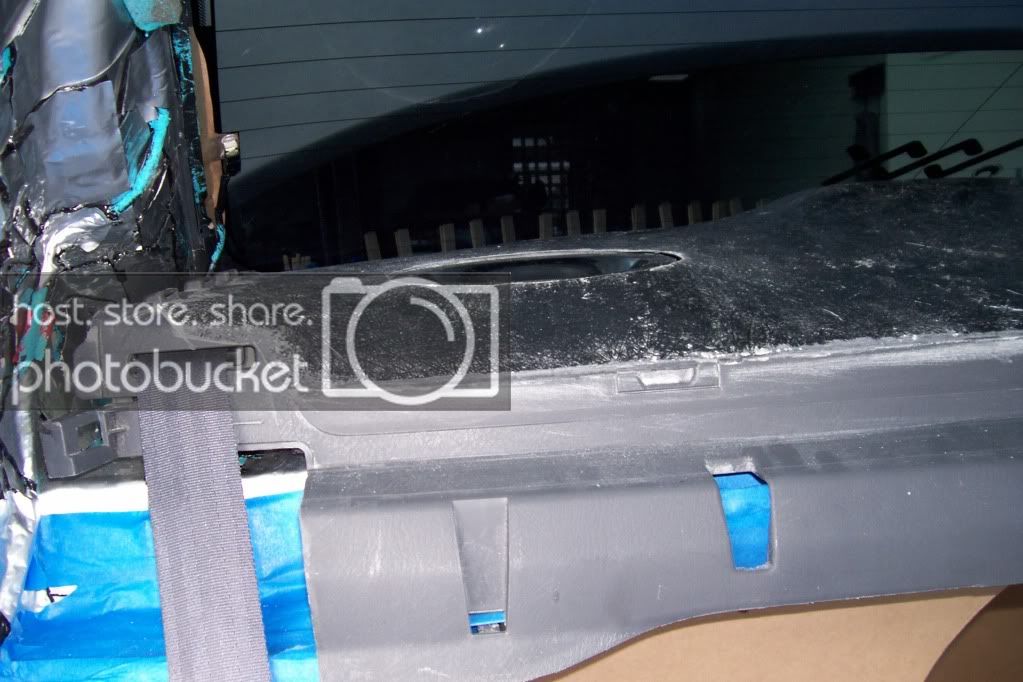

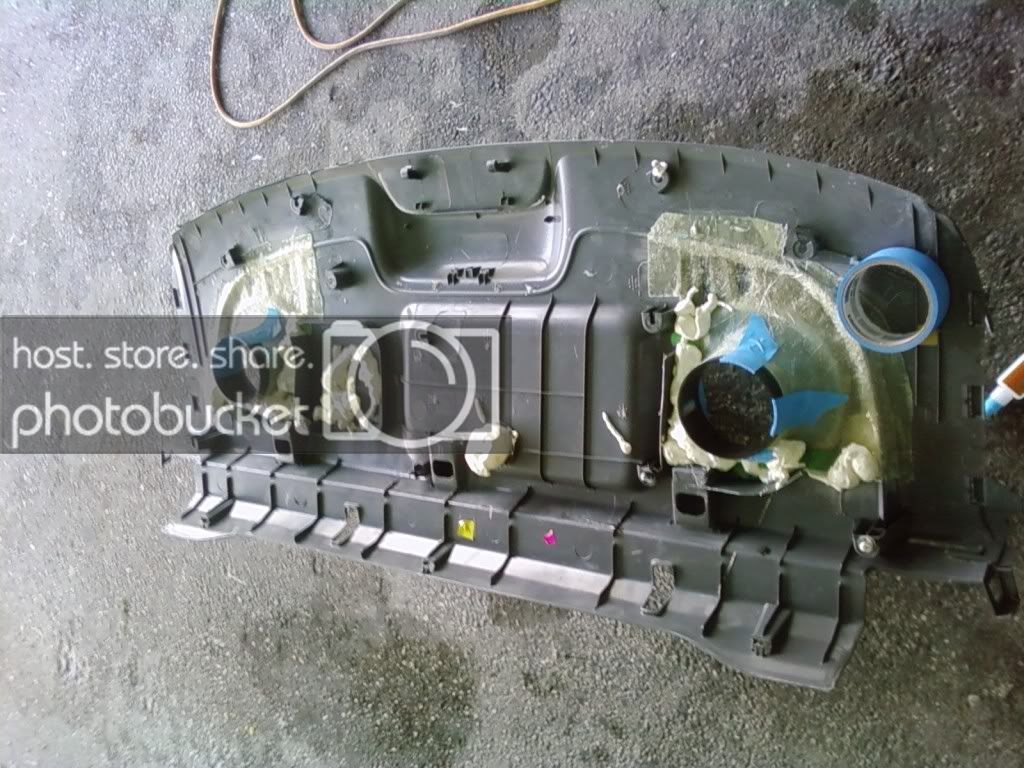

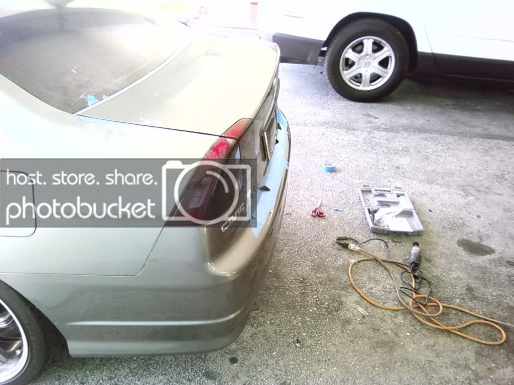

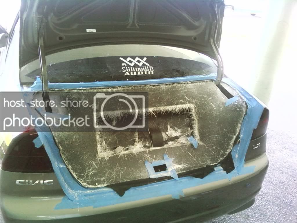

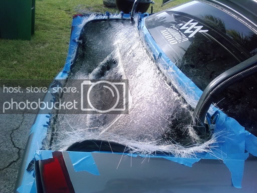

let the car bake in the sun again and began back with the rear dash panel. i started with taping the flares for like the 4th time.
sealed up and taped down

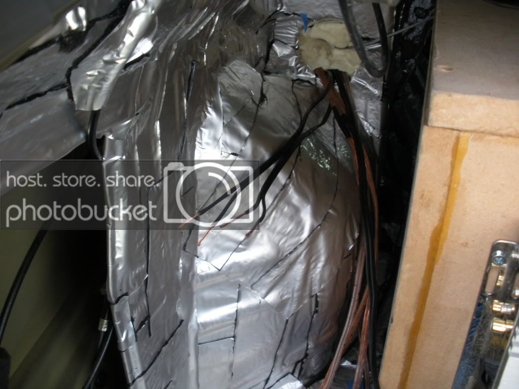

under shot

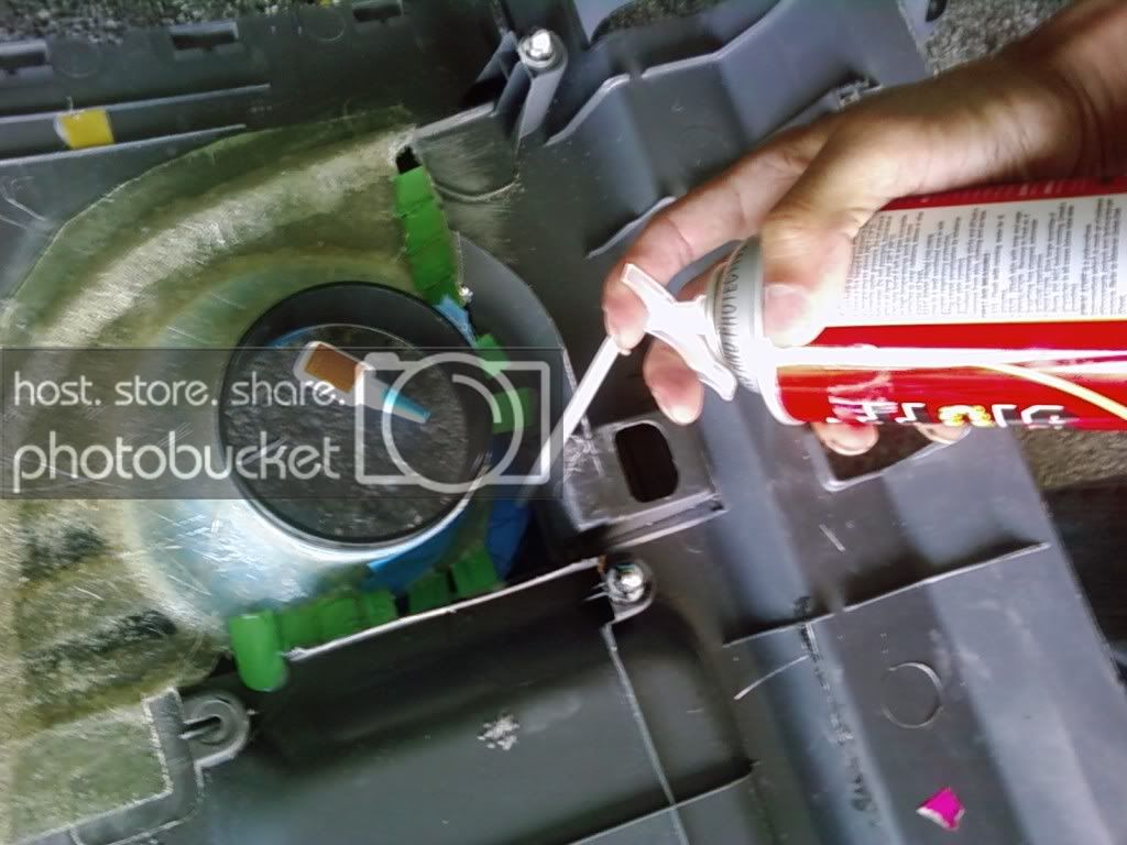

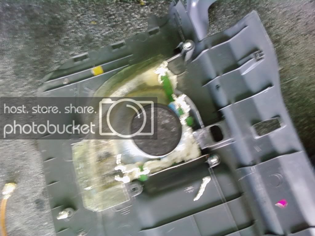

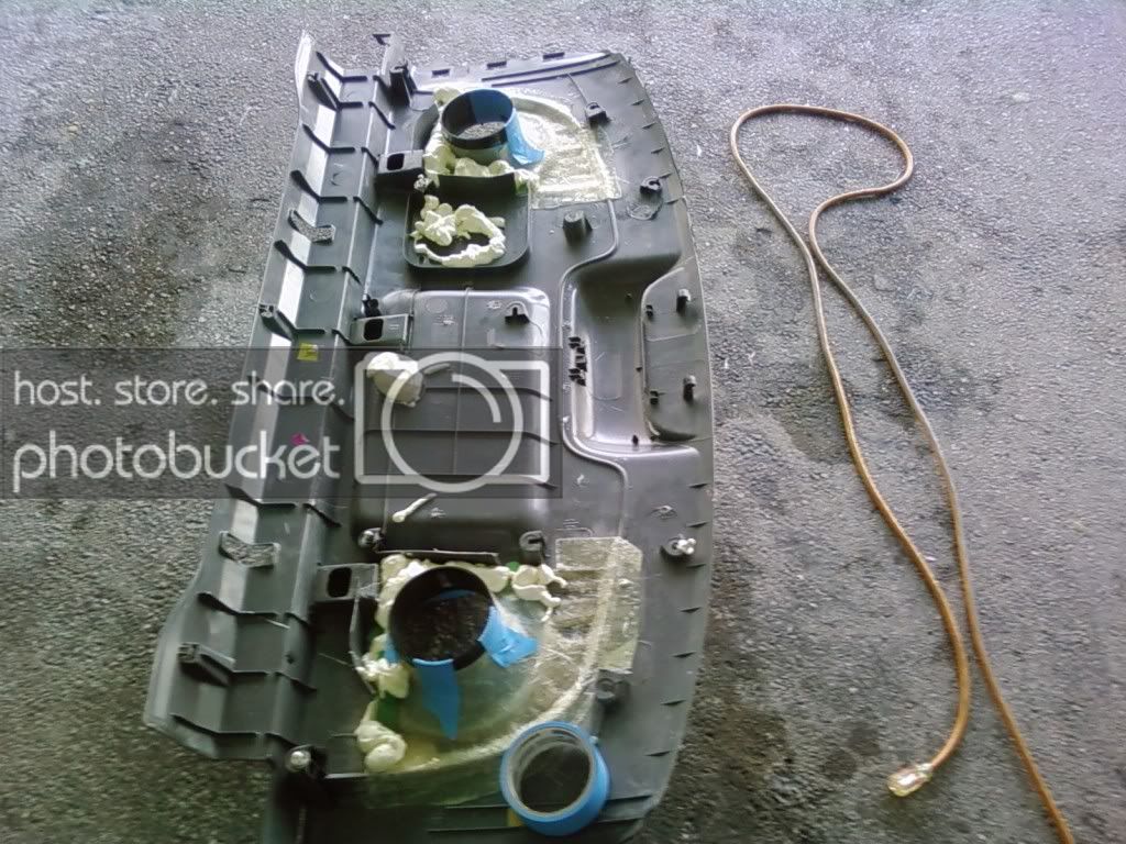

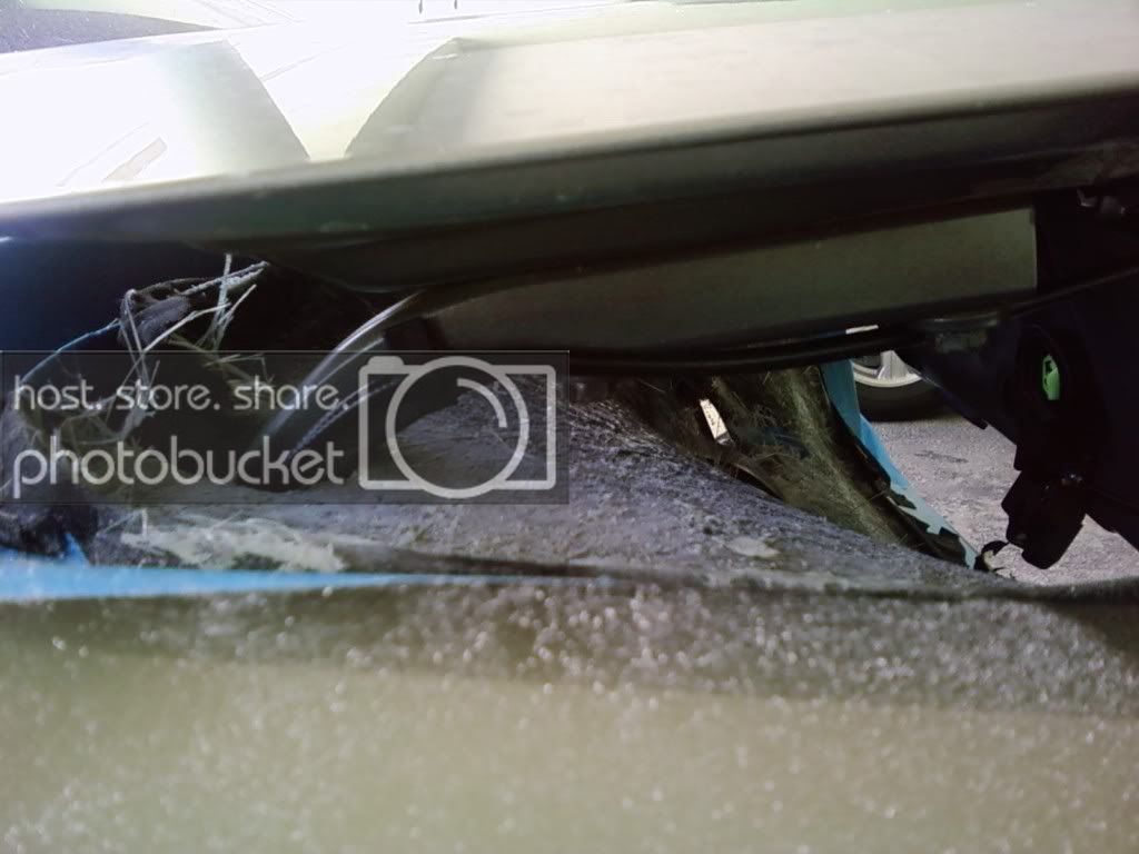

the cavity that needs to get foamed
foamed
and that's where is sits.

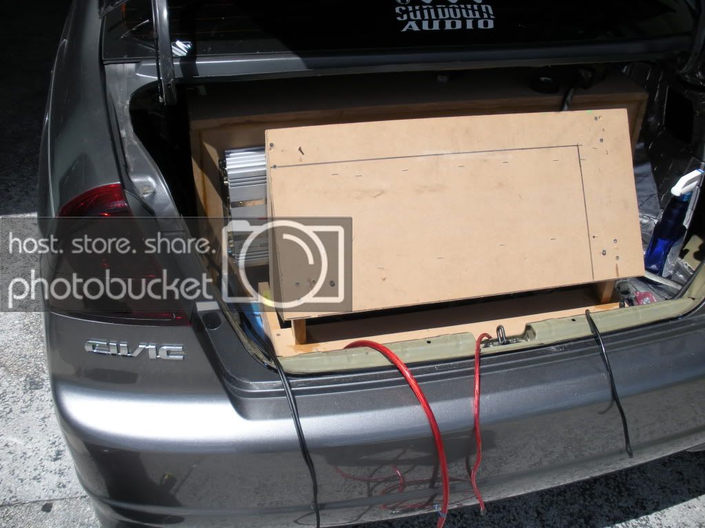

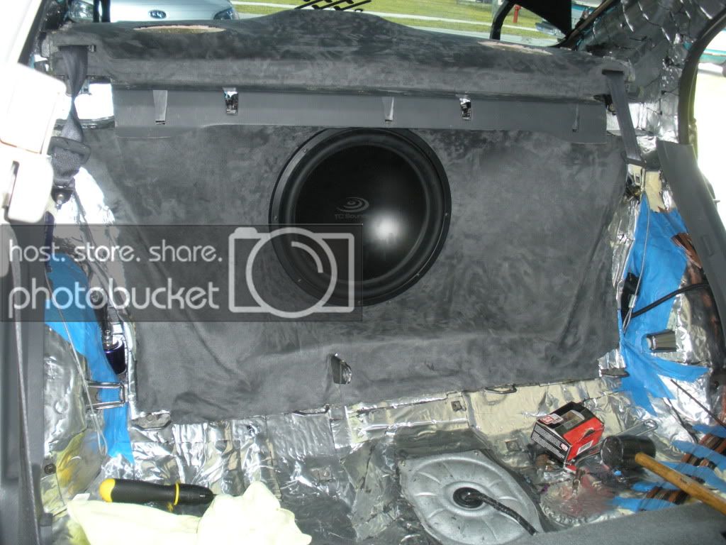

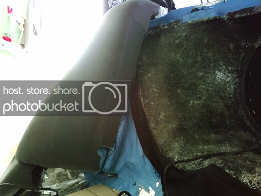

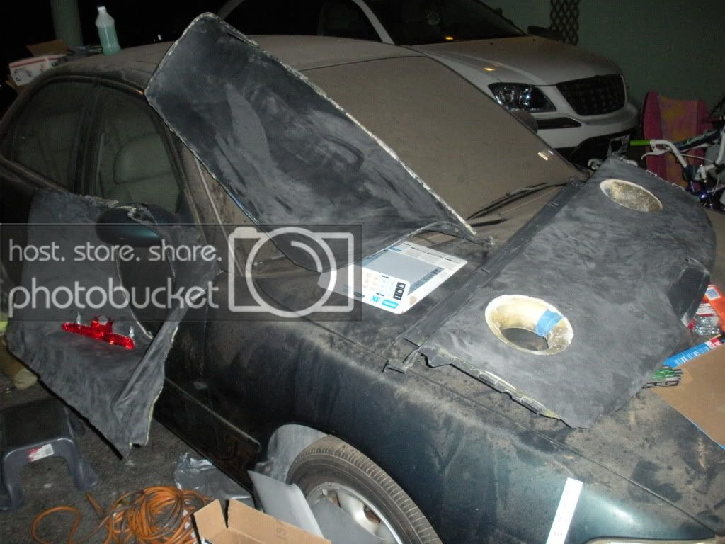

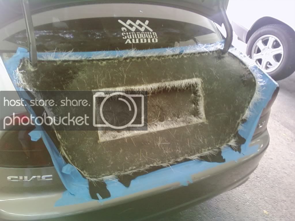

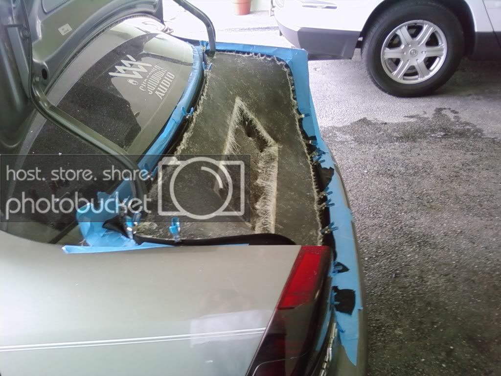

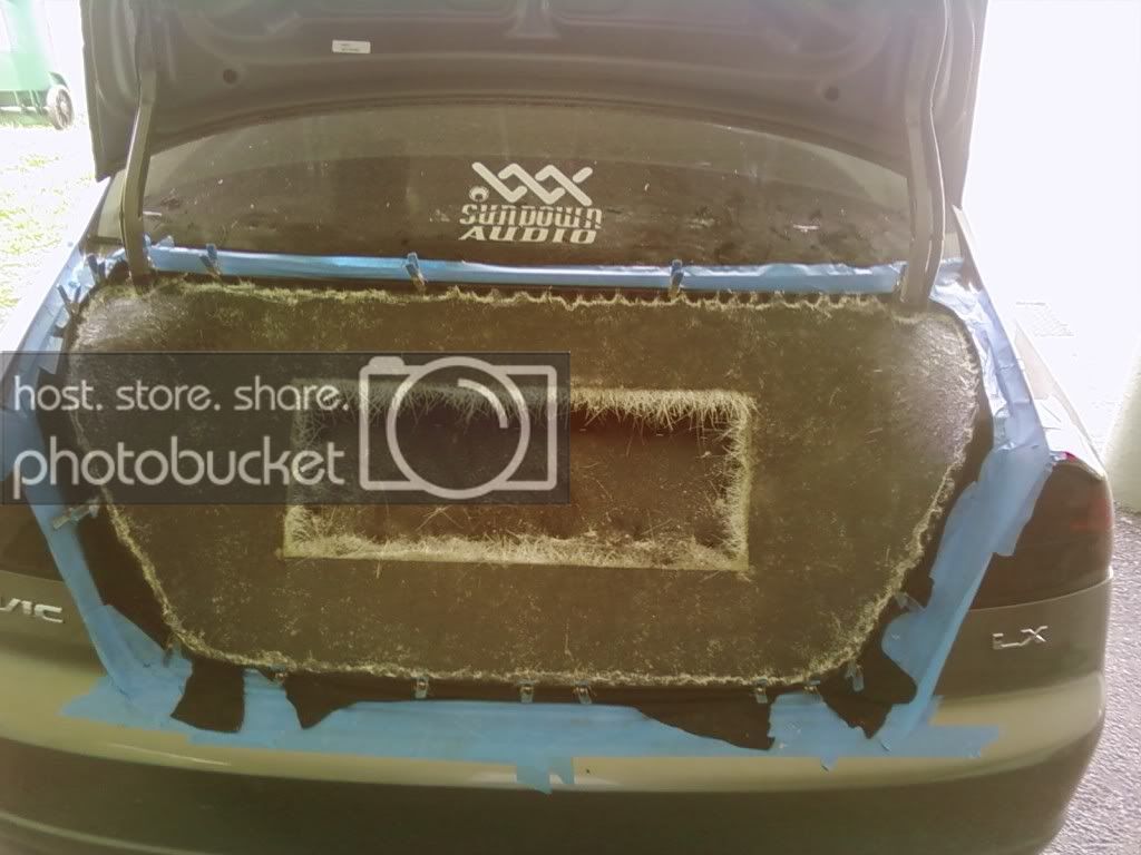

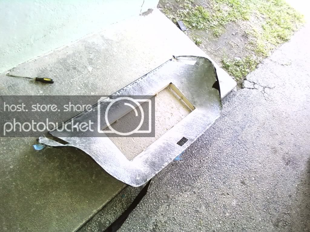

i started out with my mission of pulling the amp beauty panel. first i trimmed off some of the excess fleece and excess fiberglass. then i cut out the holes for the trunk door support bars. initially i though they were going to be small. little did i know that wasn't going to happen. //content.invisioncic.com/y282845/emoticons/frown.gif.a3531fa0534503350665a1e957861287.gif
they turned out a little longer than what i had hoped and now i feel it kind of sticks out like a sore thumb. i'll have to figure something out when fleecing. maybe have a flap like thing underneath it and cover it with suede. i dono.. i'll figure that out some how.

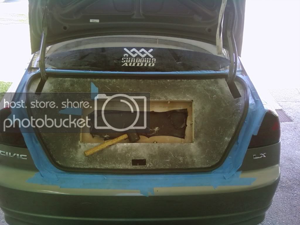

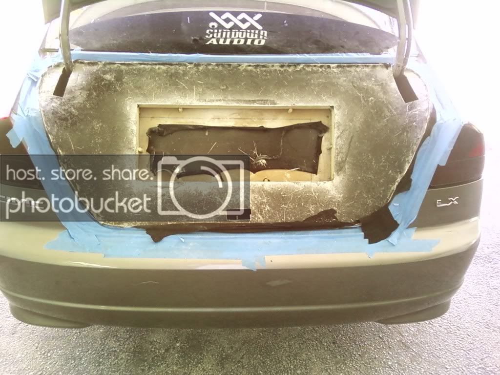

after that i managed to finally close the trunk. i haven't been able to close it for the past 4 days lols.

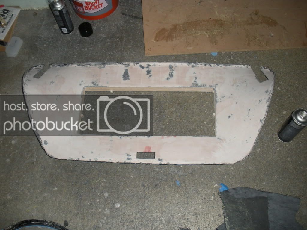

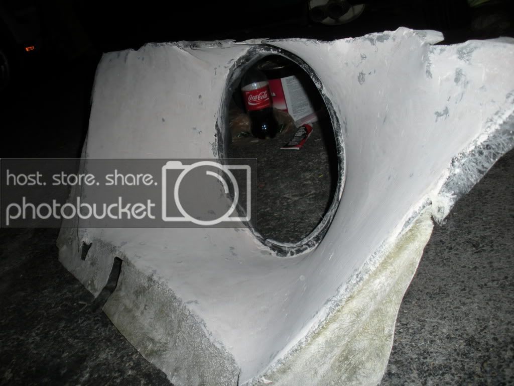

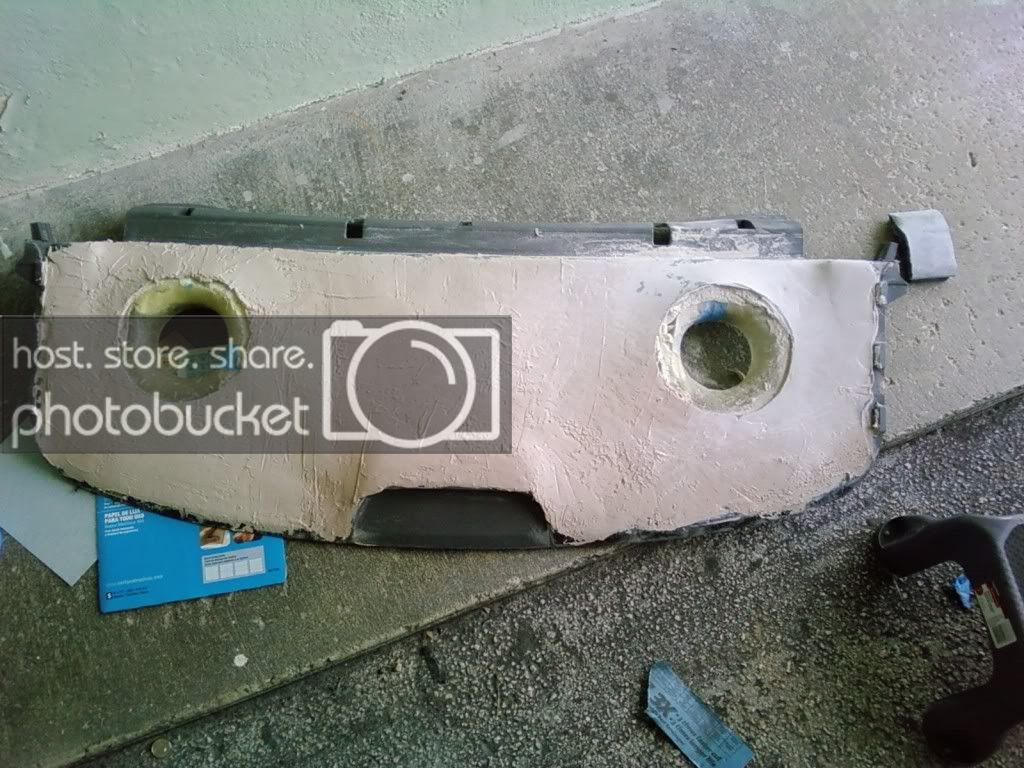

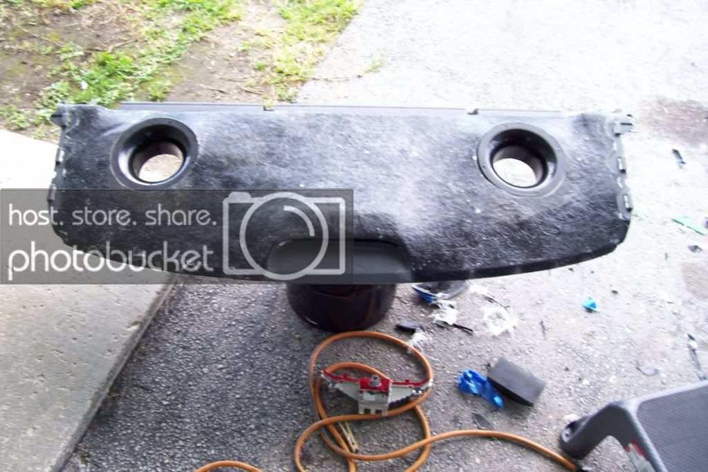

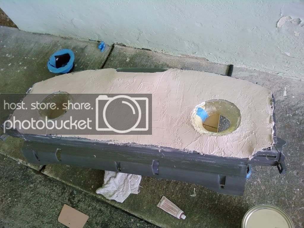

after that i decided to add the weather stripping for a test. success at that. and the stripping really pins the panel in place. though i smashed my thumb with a rubber mallet while doing it. after i felt happy with the results i pulled the panel out and began to prep sand both panels for body filler.did some fine tweaking and onto the filler. i really hate using bondo filler. i would have used rage gold but i wasn't thinking and didn't order it ahead of time(not found locally). i started out with sanding the rear dash panel i did the majority of it today. now i'm not looking for paint worthy sanding. i just need to get all my curves settled and flats flattened and smooth enough to be covered with the suede. that's pretty much where it ended today. a lot of sanding and still much more to come. i'm going to hate doing that amp panel.

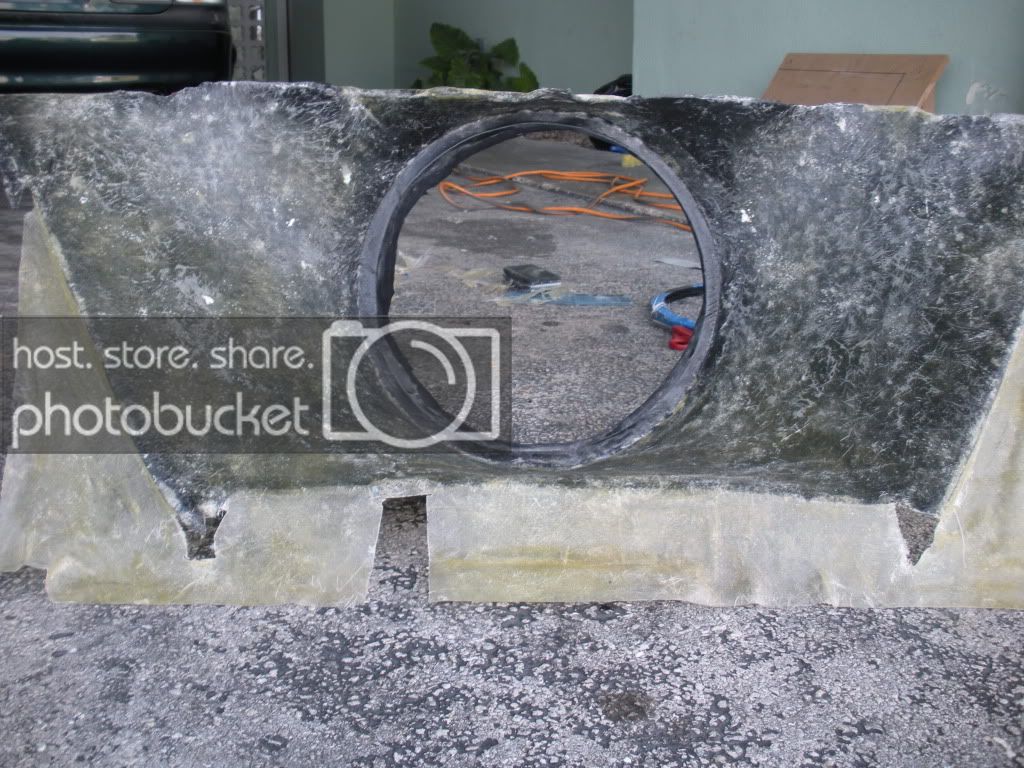

clips removed
trimmed edge
short hole for sway bar clearance. no bueno :/
more cutting. :/
sweeeeeeeeeeeet. closed trunk!

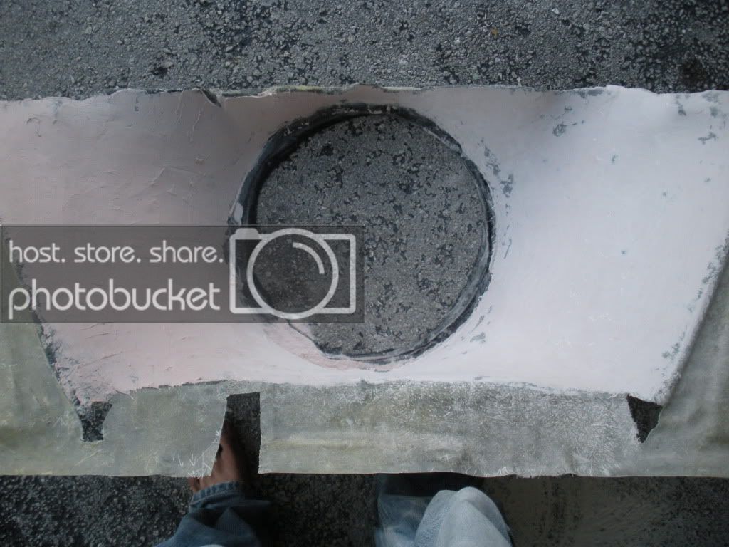

i broke a kitchen nife trying to trim off some of the excess glass in order to save time from rough sanding.

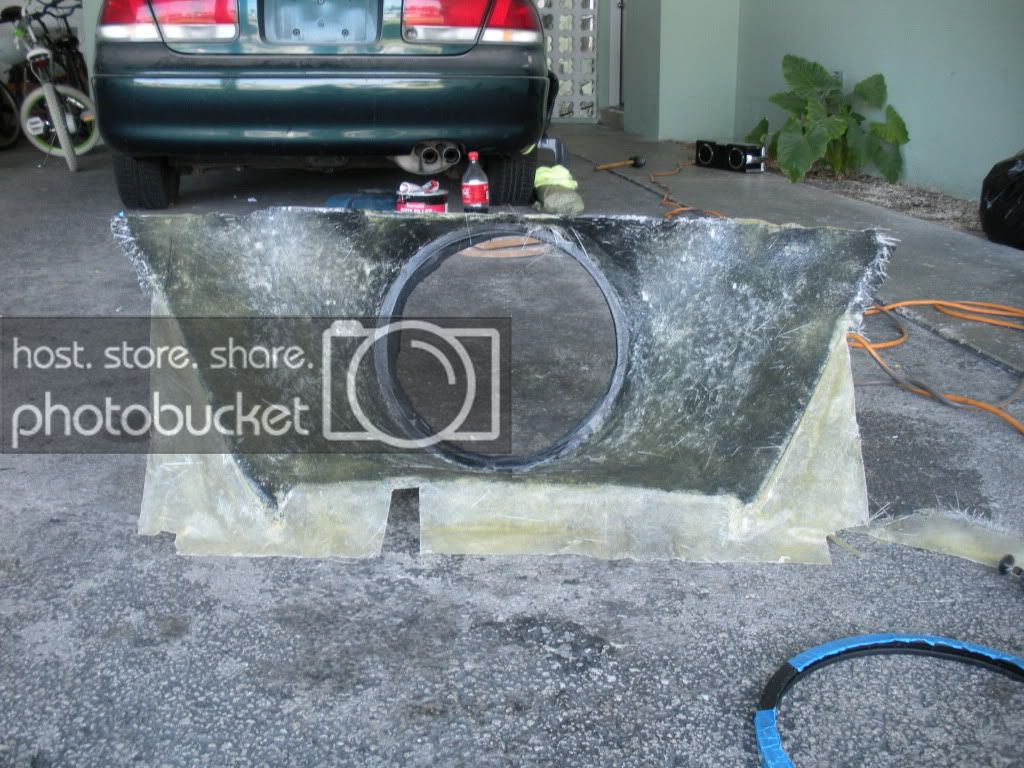

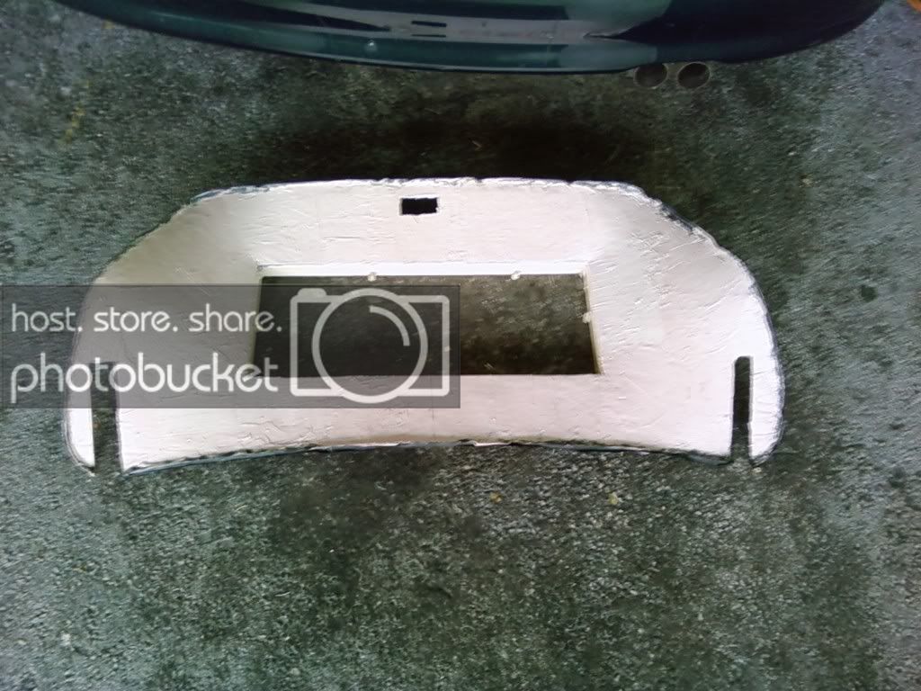

amp square timmed and sanded smooth

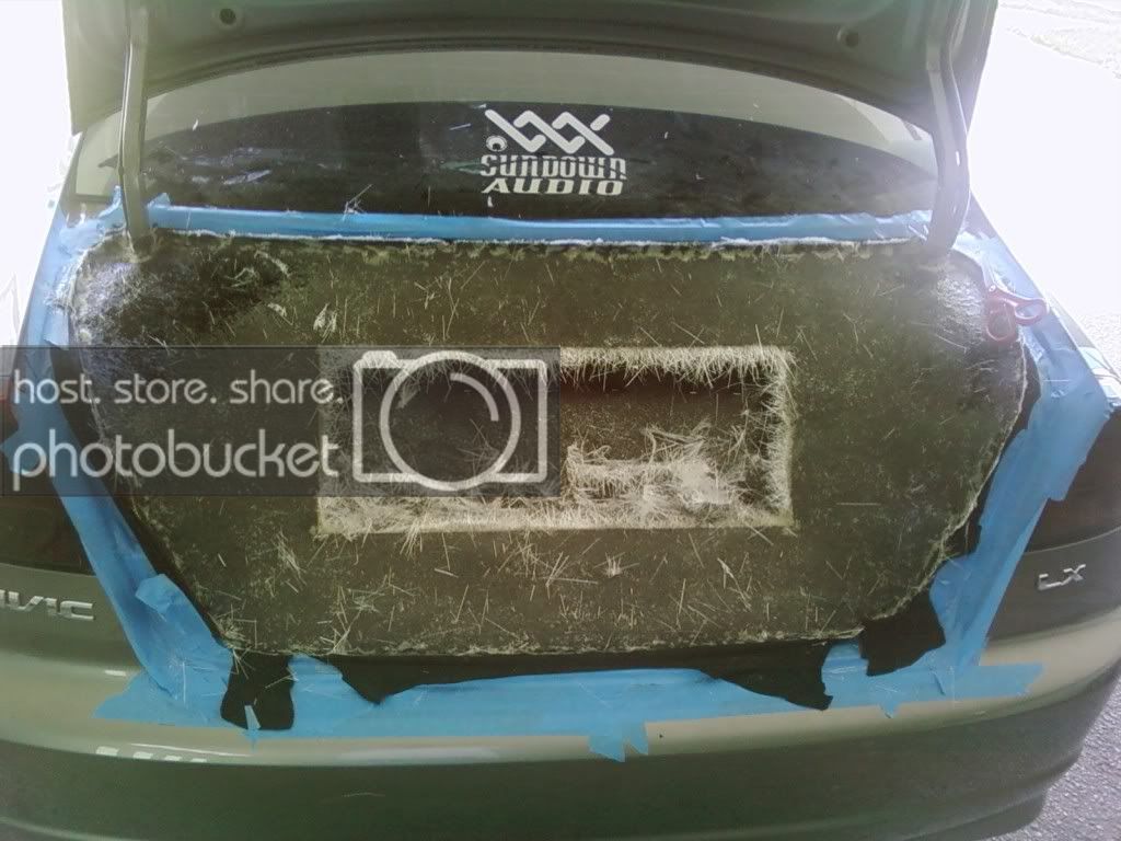

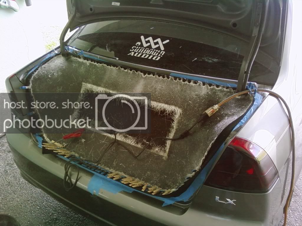

panel pulled from the trunk and outer edge trimmed for proper mounting
panel back in trunk with weather stripping test. thumbs up!

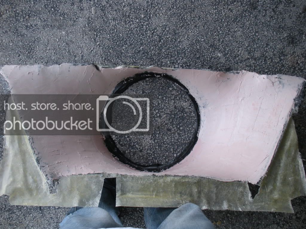

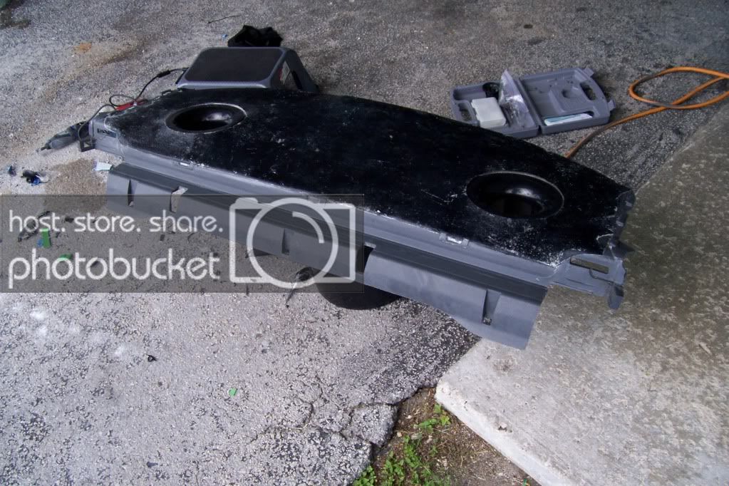

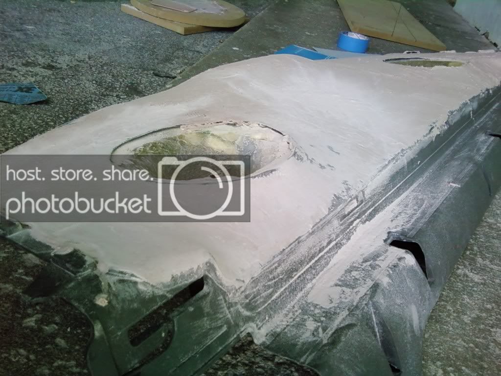

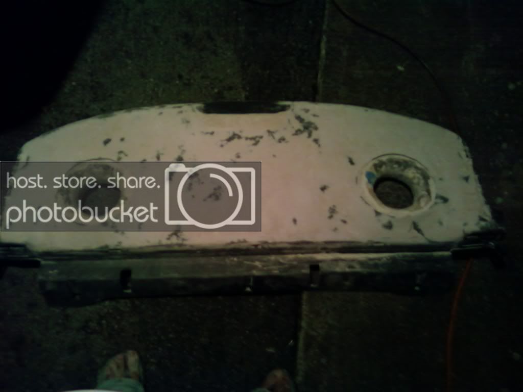

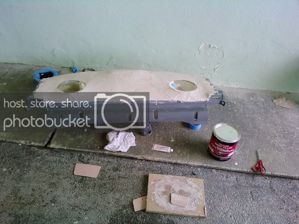

sanding for rear dash panel prep for body filler
dash panel covered in body filler
amp panel covered in body filler
the beginning of my sanding adventure. i started out with the right side and getting tthe curves first
some progess
and where i ended for the night. almost all done

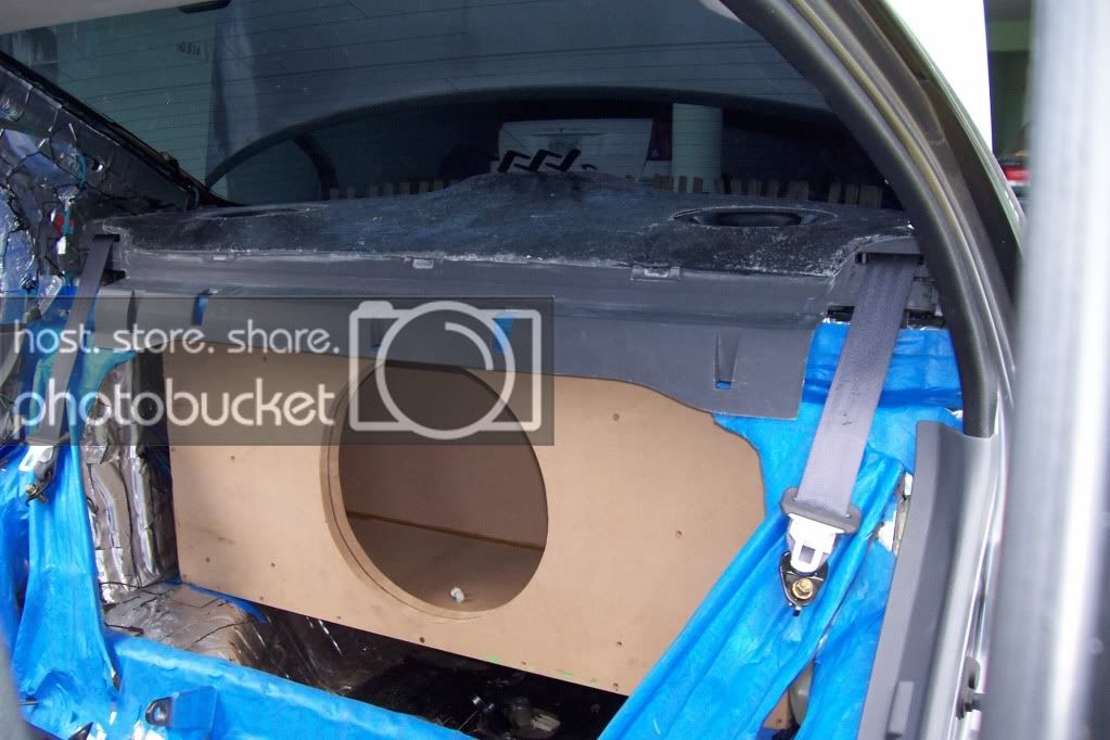

well tomorrow i'll start with finishing the rear dash panel. then i'll start sanding the amp beauty panel when that's done if i have the time tomorroe i'll them pull the amp rack out of the car, insert the rear dash panel. line up the ports. and glue the enclosure side of the port to the enclosure. after the ports are glued in place i can then glue the baffles on. after the baffles are on, then i could star glassing the subs beauty panel.
