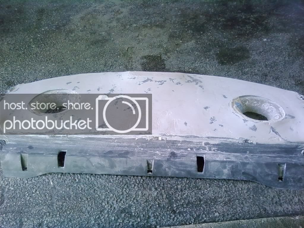

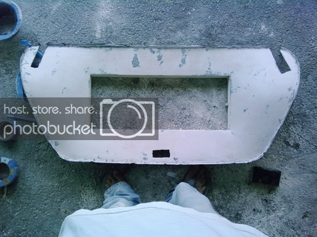

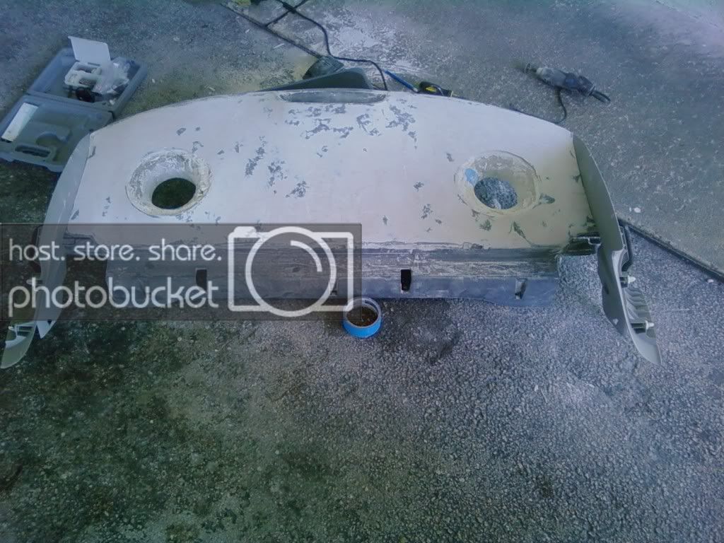

first a better pic of what the rear dash panel looked liek when i was done with it last night

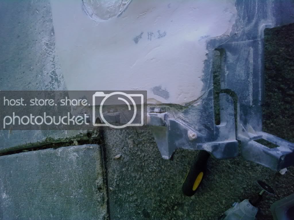

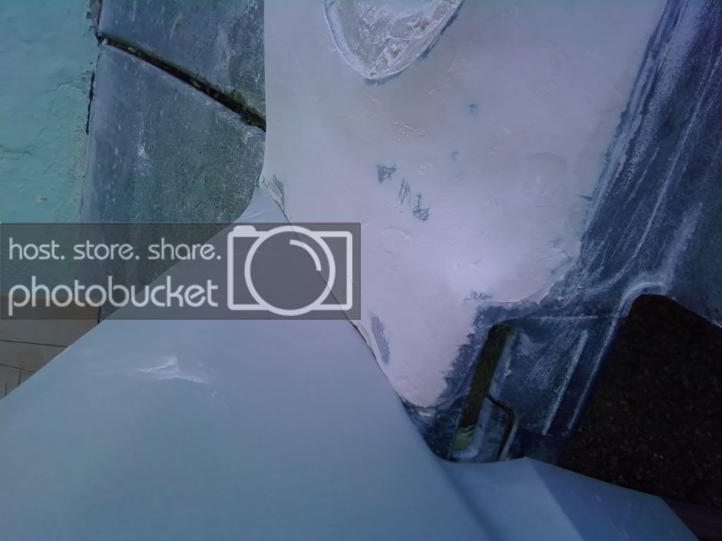

worked on the side of the panel to reassure the proper fitment for the side sail panel.
nice fitment!
both sails
workin the amp panel
at this point i was sick of sanding and glad i was done. time to move foward

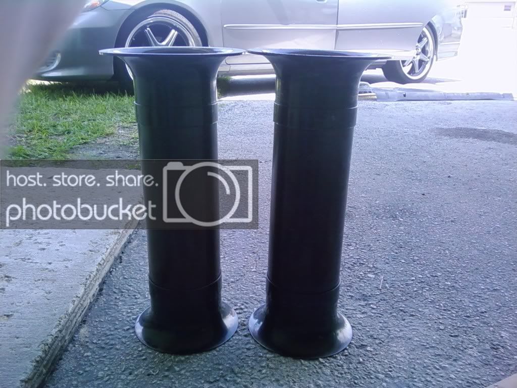

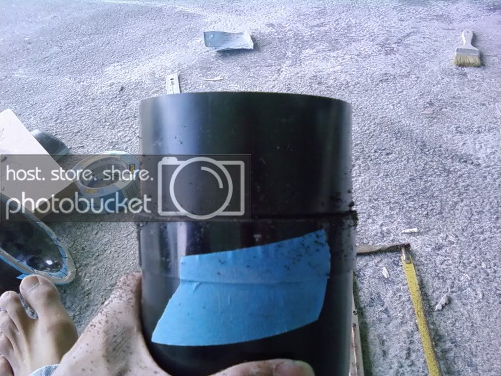

cut the ports to length.

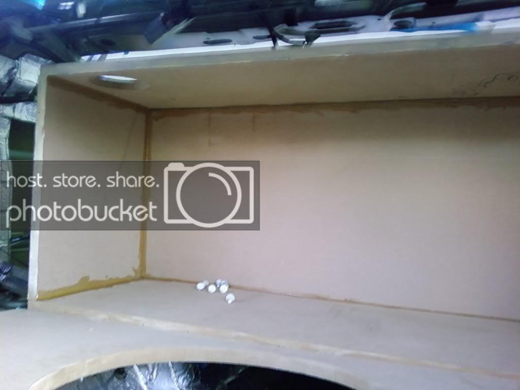

next i glued the baffles on(had to have the amp panel and amp rack in order to move the enclosure back to remove and mount the baffle)

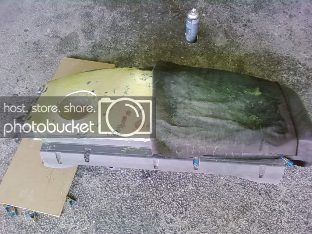

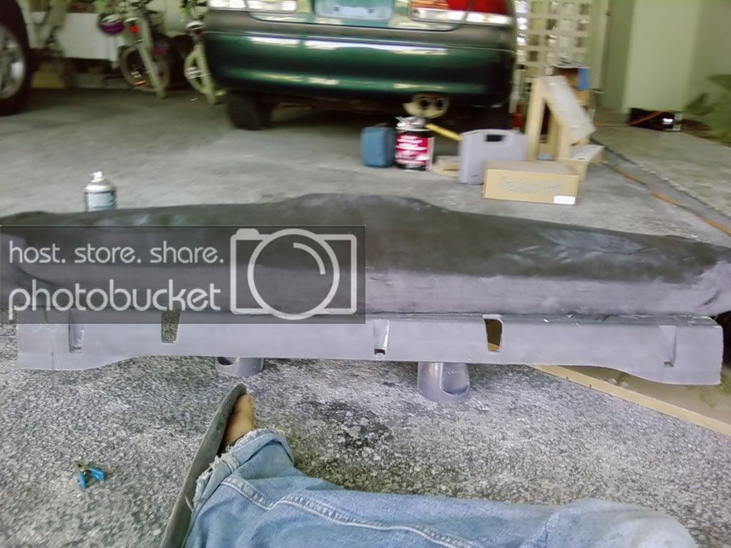

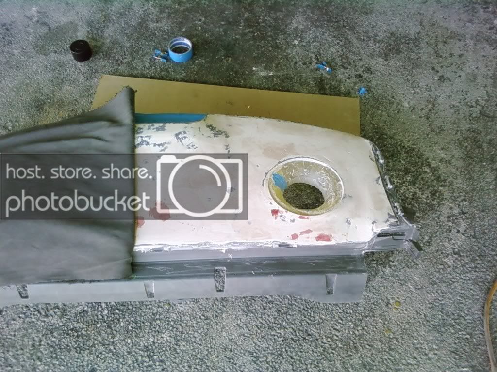

time to suede up the rear dash panel. i needed the rear dash panel sueded before i secure the fitment of the ports.
so i began with a nice cut of suede. here it's just laying on the panel for size verification
glued 1 half
suede applied and pressed
prep for second half
glued applied
suede applied

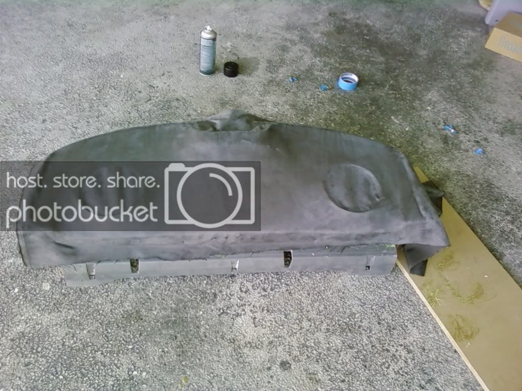

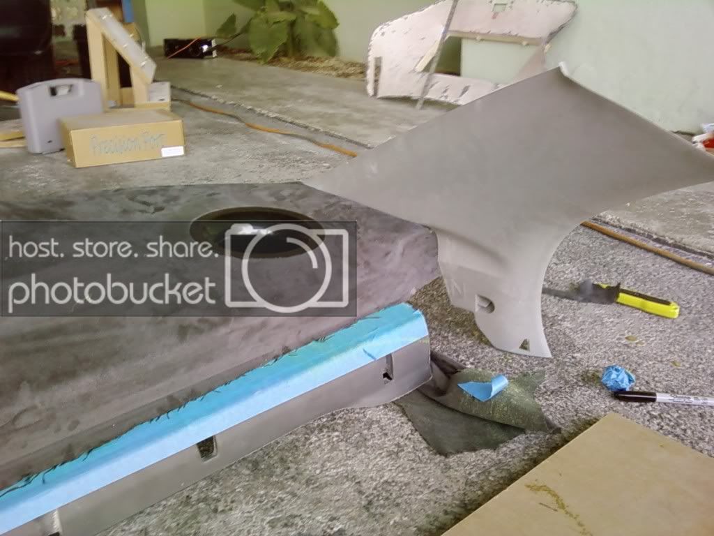

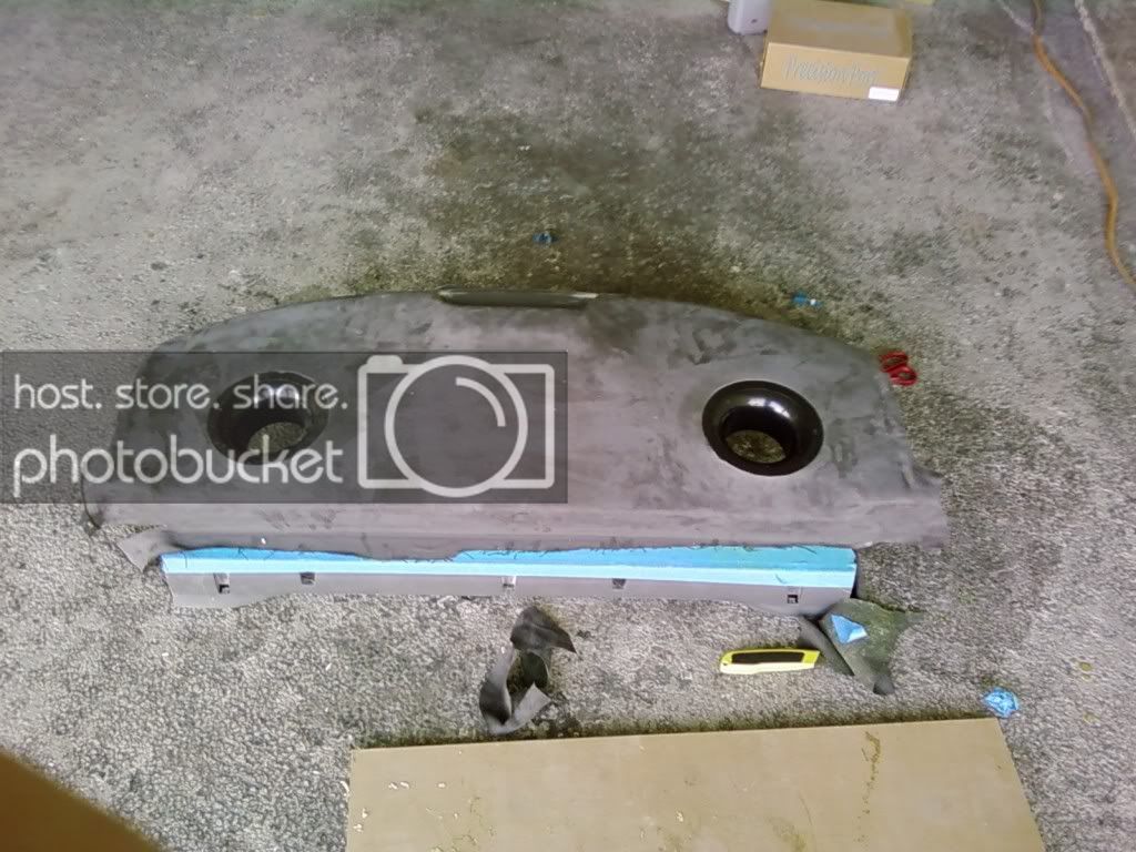

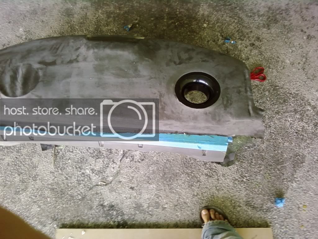

edge trimmed and port hole opened for one side
port set for other side
trimmed sections for sails and seat belt opening

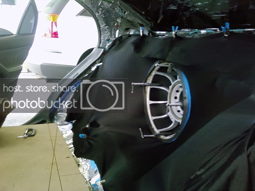

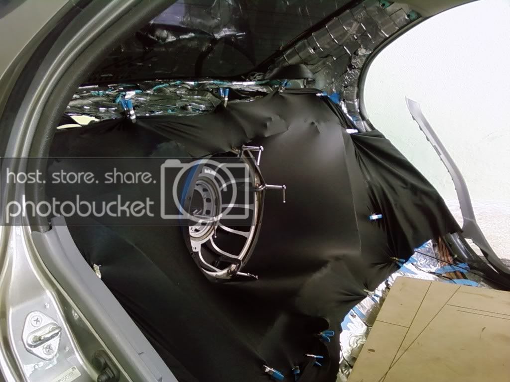

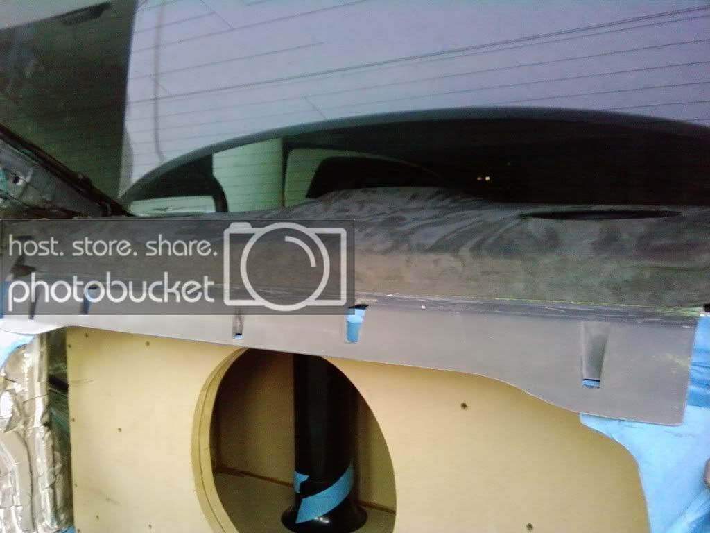

and test fitting in the car
flares in place

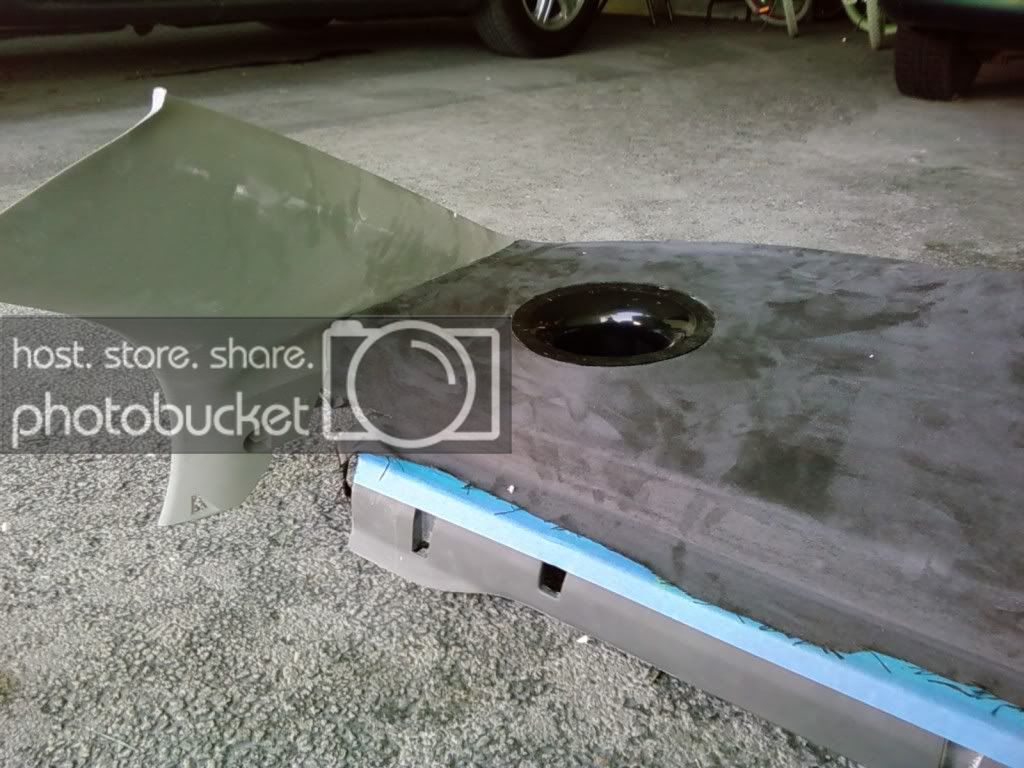

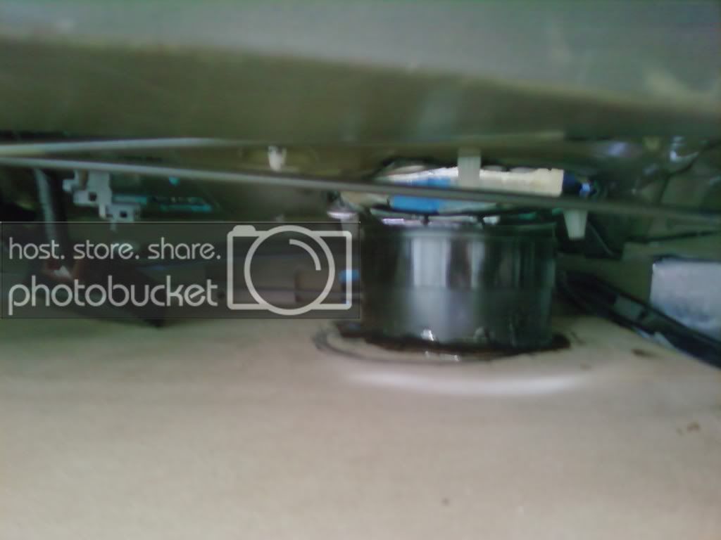

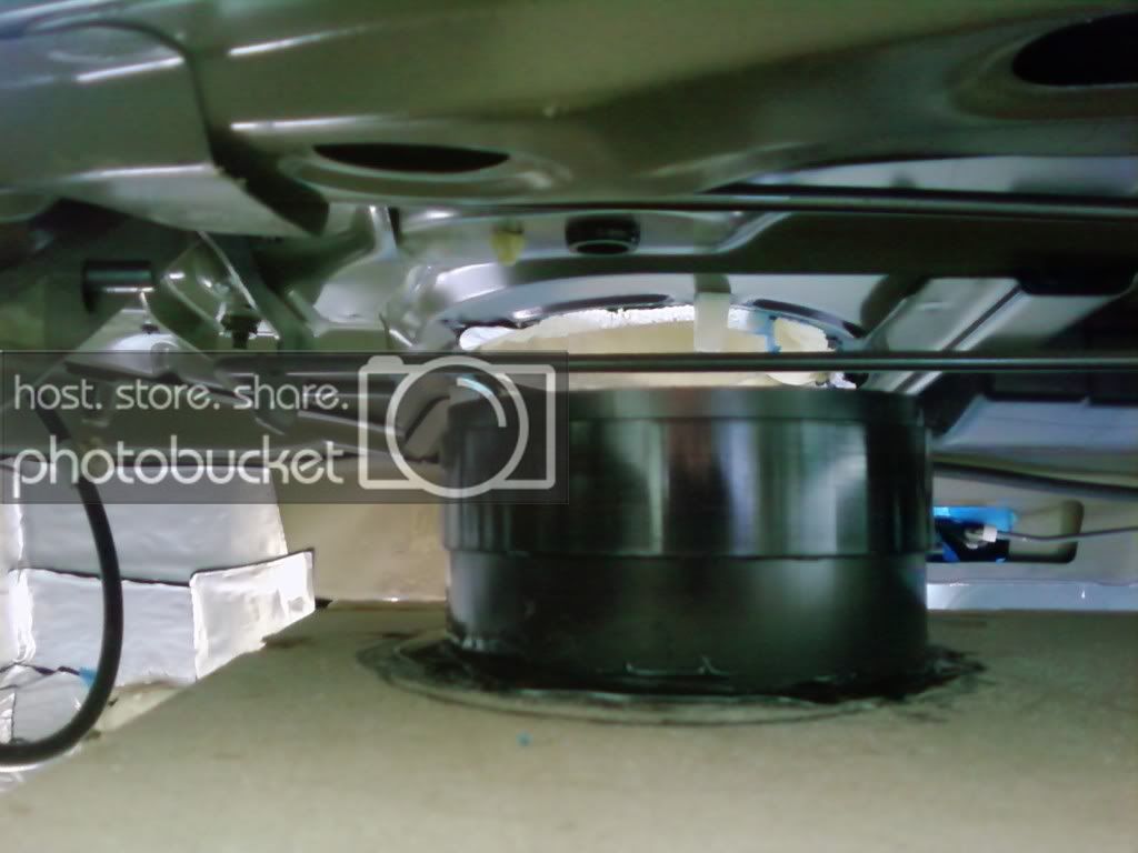

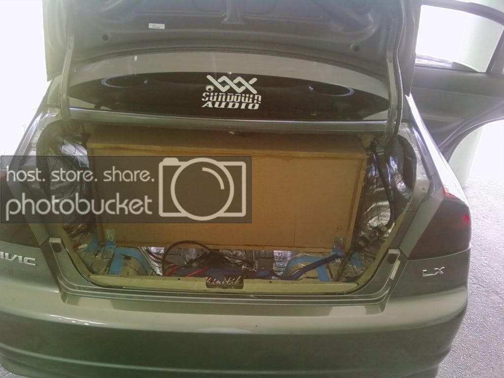

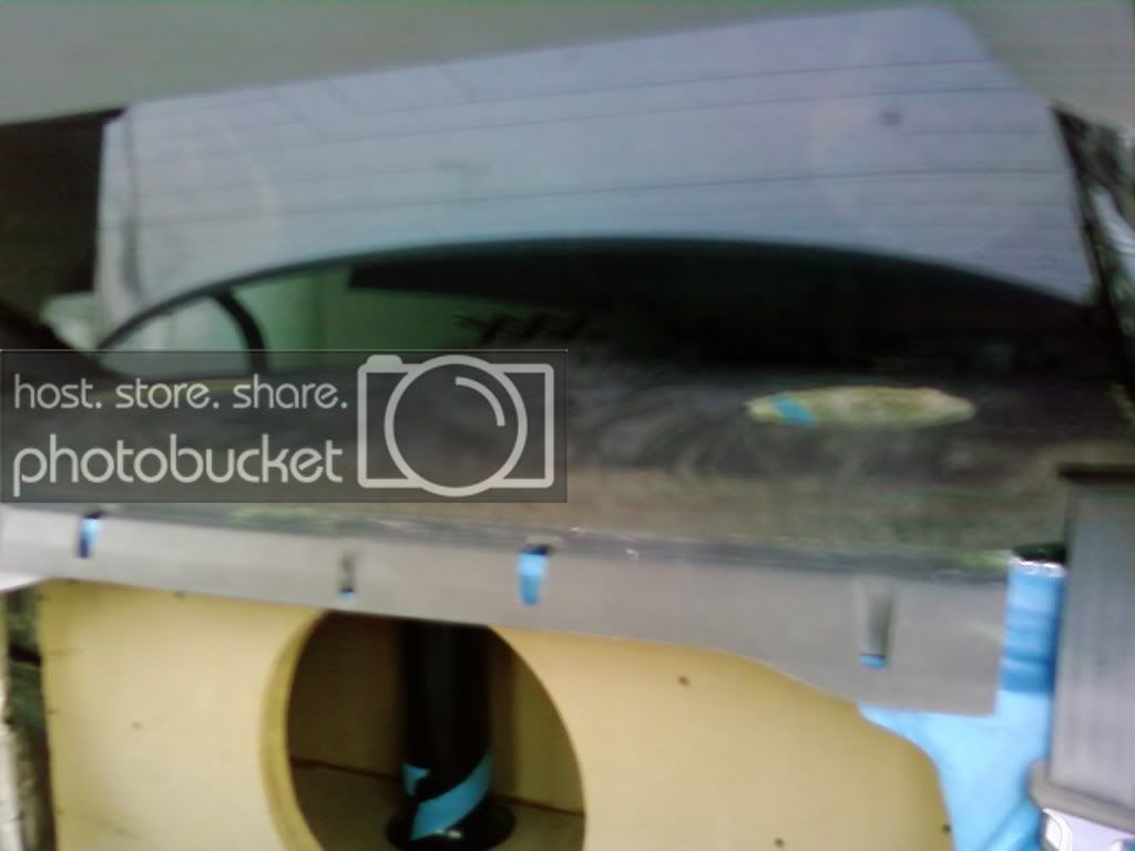

trunk partially secured being pulled out to finish applying the sillicon on the front side of the enclosure for the ports.
port clareance between the trunk tie rod

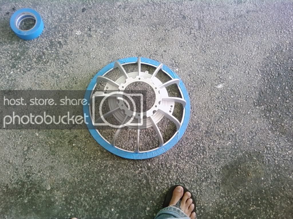

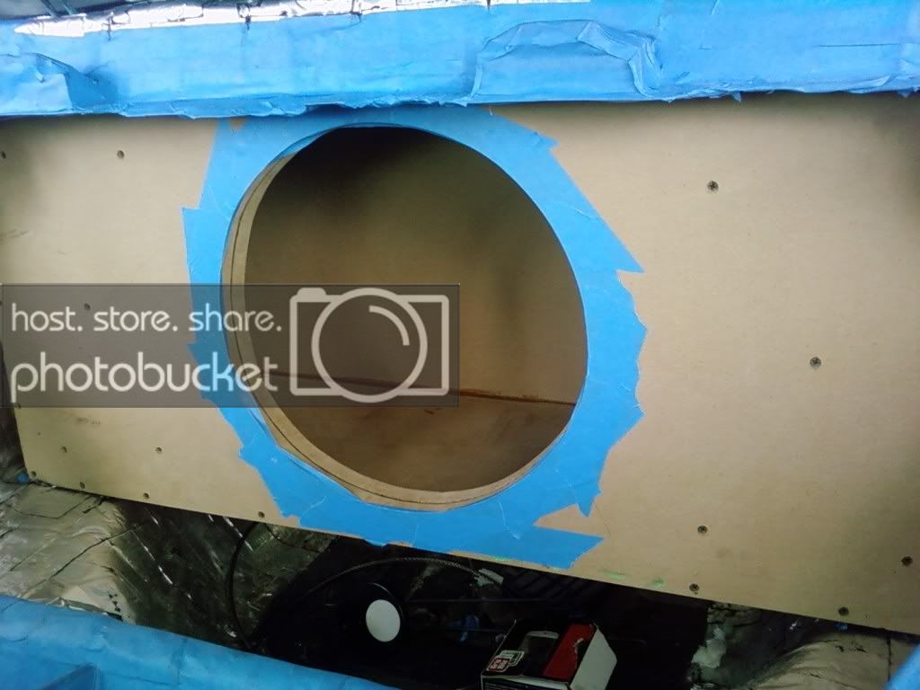

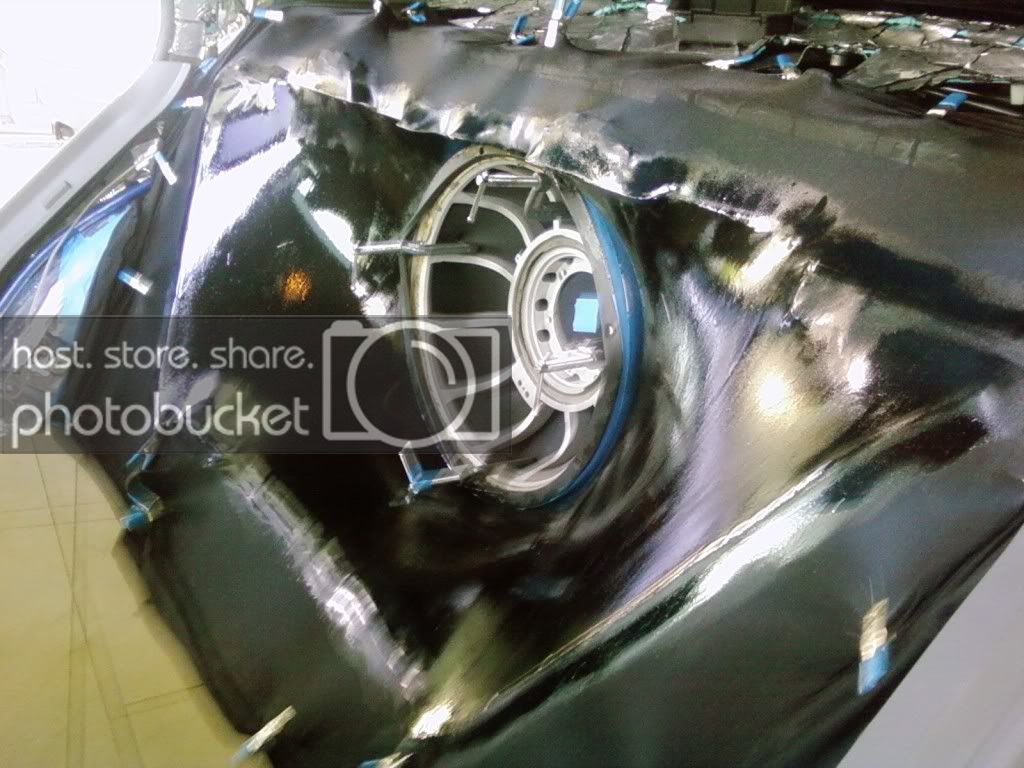

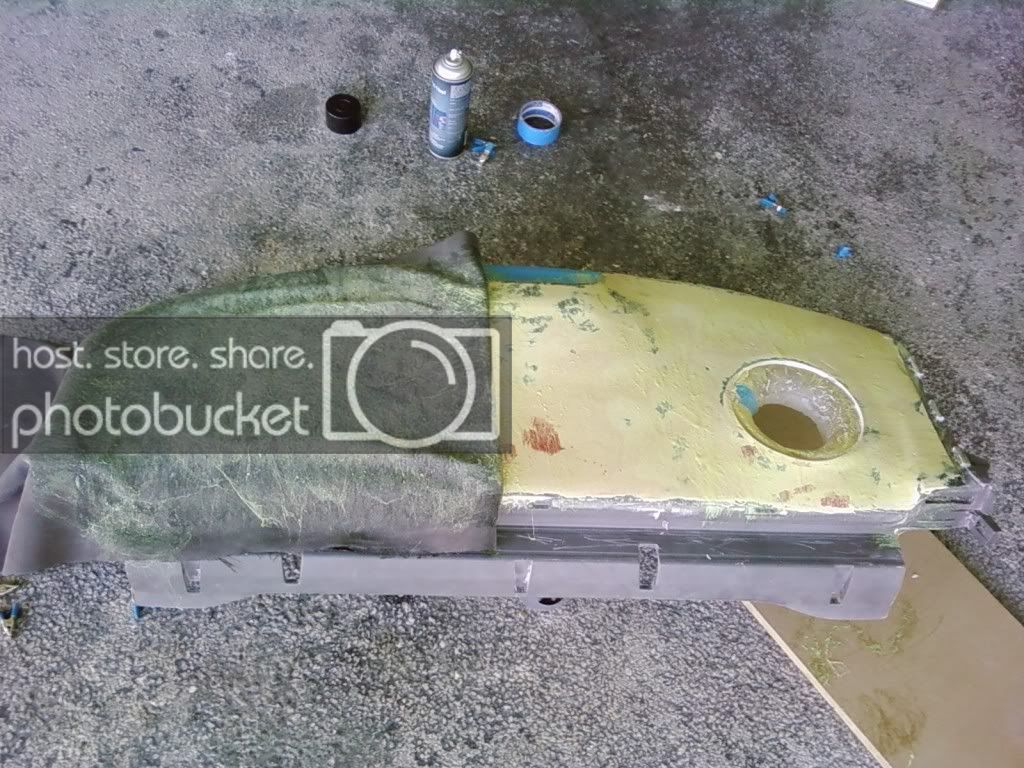

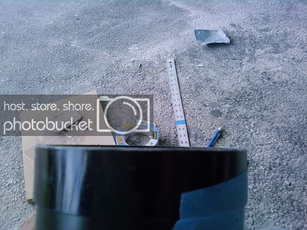

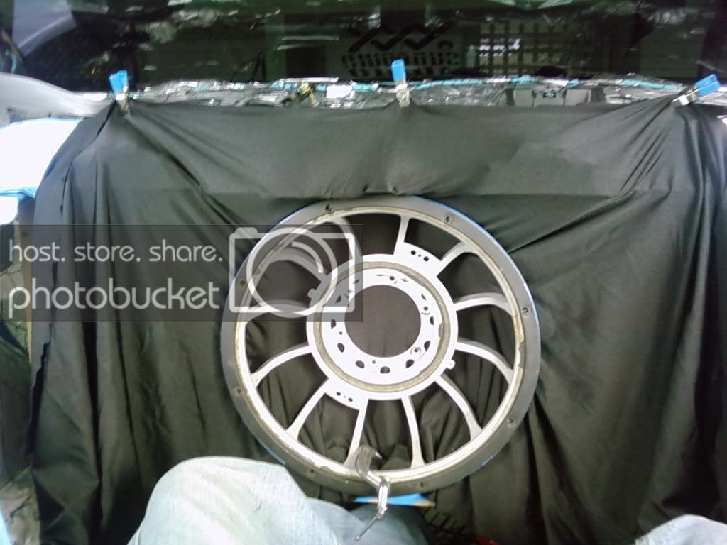

after the glue was applied i then began prep work for the sub beauty panel. i started out with grabbing a 15" basket and gasket and taped up the underside so it wouldn't get stuck to the resin
taped up the mounting hole

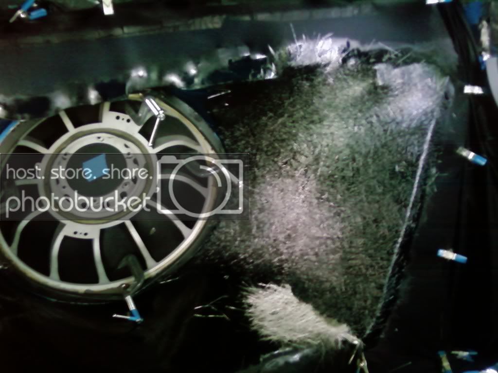

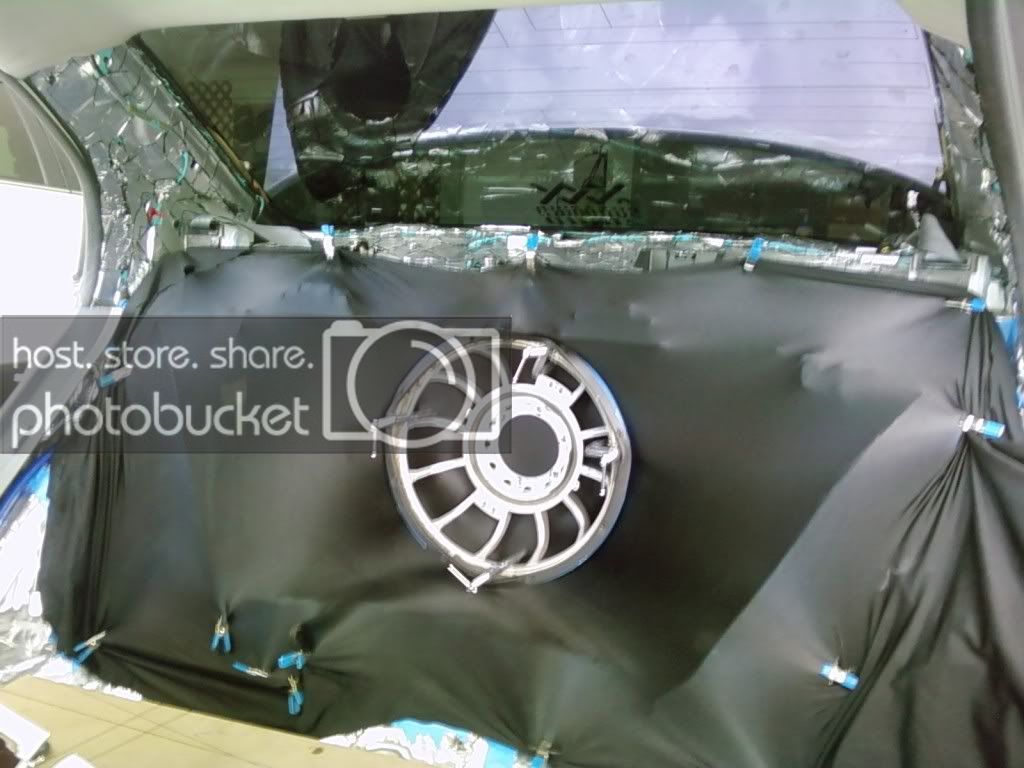

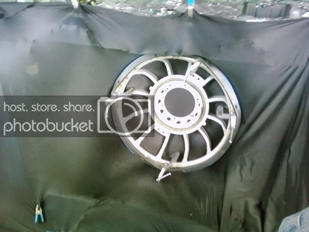

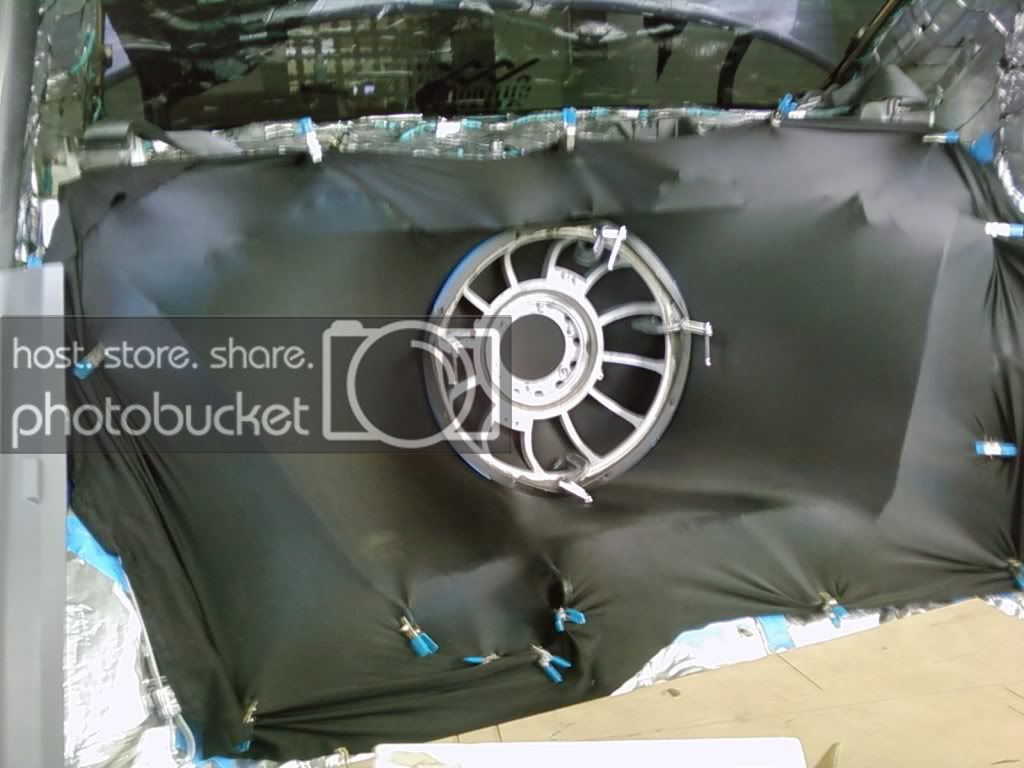

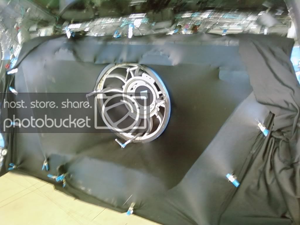

the beginning of the fleece stretching
more
just needs some fine tuning
done!

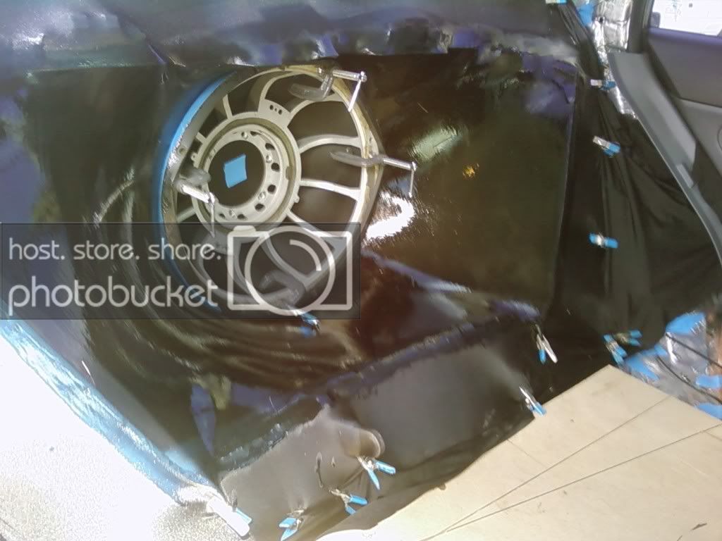

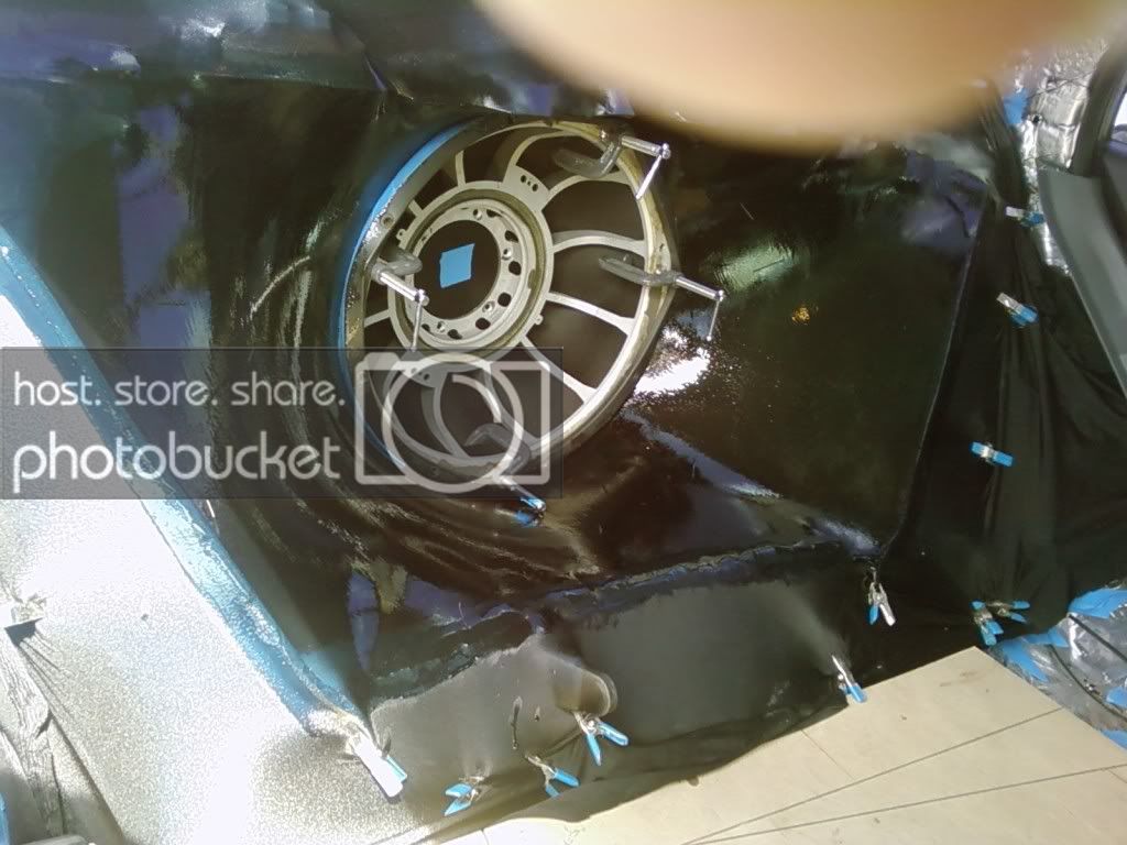

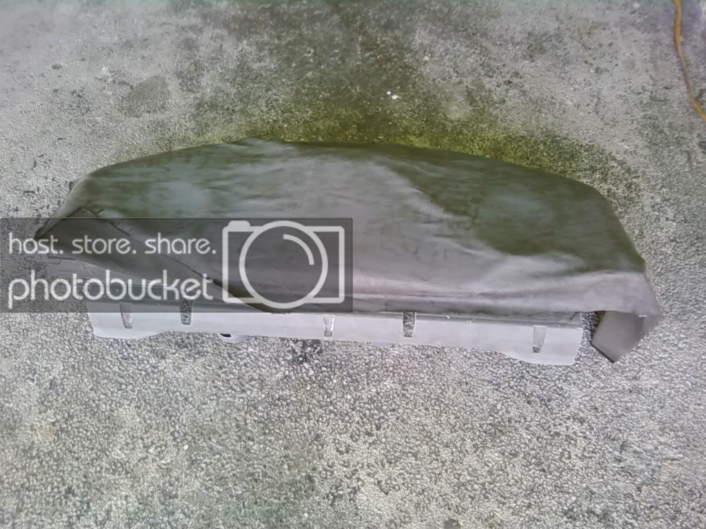

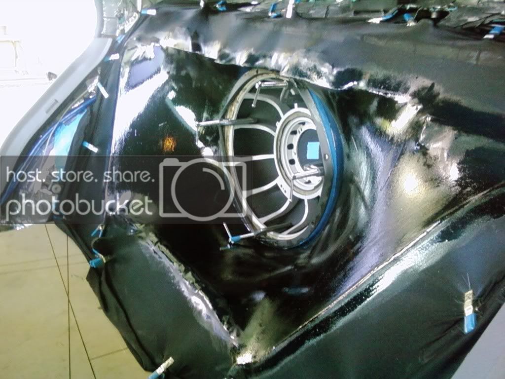

time to resin it up.
after 2 coats
that's when i had to stop to work on the guys car. ****! if only i hadn't i most deffinetly would have had all the layers needed put on today by the end of the night. GRRRRRRRRRR

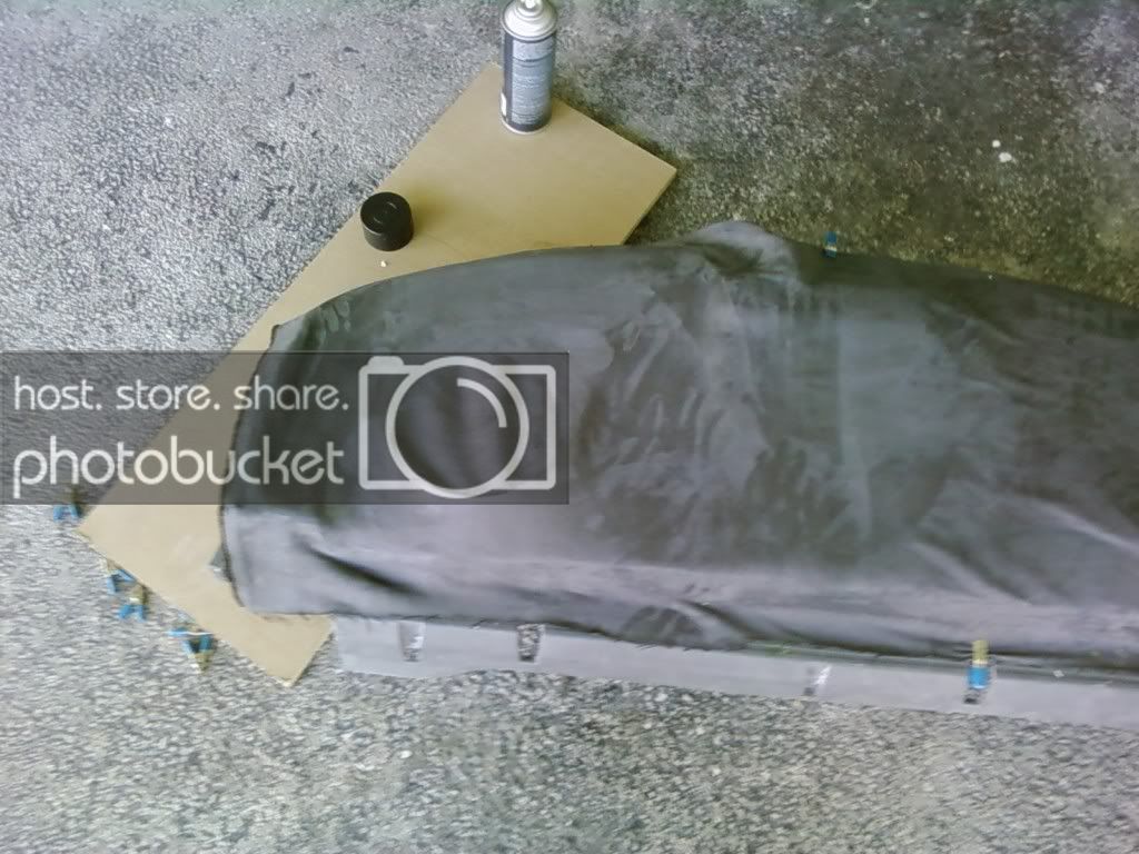

anyways the start of the first layer
it got dark so i can't take anymore pics(no good flash on camera phone) but i stopped at 10 with the completion of 2 layers. in about an hour i think i'll go back outside and add another 2 layers i wanna get this done!! i'm wasting my vacation time!
