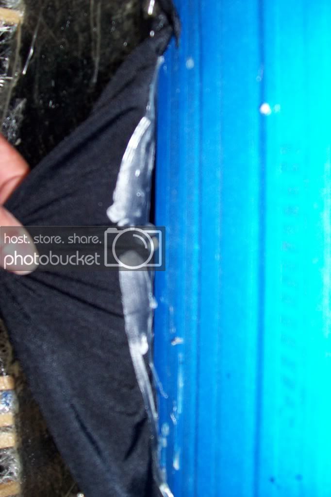

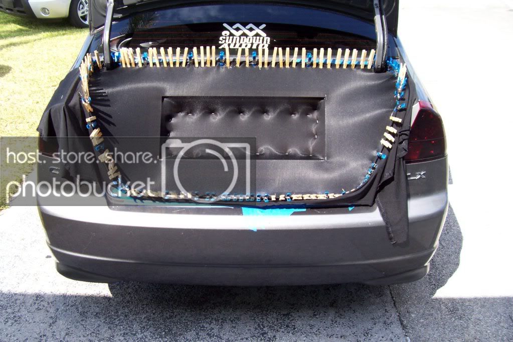

well yesterday i ended up having to scrap the original amp beauty panel. i cut the center of the panel so i could re-attach the lifted area of the panel. but, that was a no good as lots of areas lifted. fucking hot glue.

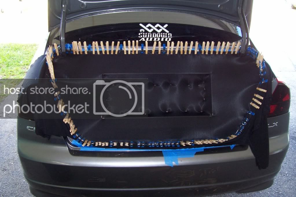

so it was a set back and a complete waste of time but a learning lesson. i ended up creating a wooden frame of the amp and a 2-part epoxy gluing it to the amp rack. that way, i was **** sure that shit wasn't going to lift up again.

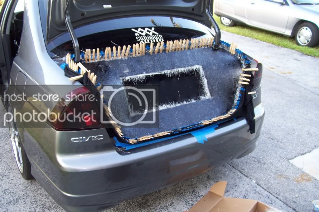

so most of my work ended up retracing my steps with the **** amp panel and getting the final layers done onto the rear dash panel. i had a friend helping me and i have to say. it was a load off my back. i got a lot of layers done in one day.
hell, we managed to get 3 layers alone onto the redone amp panel.

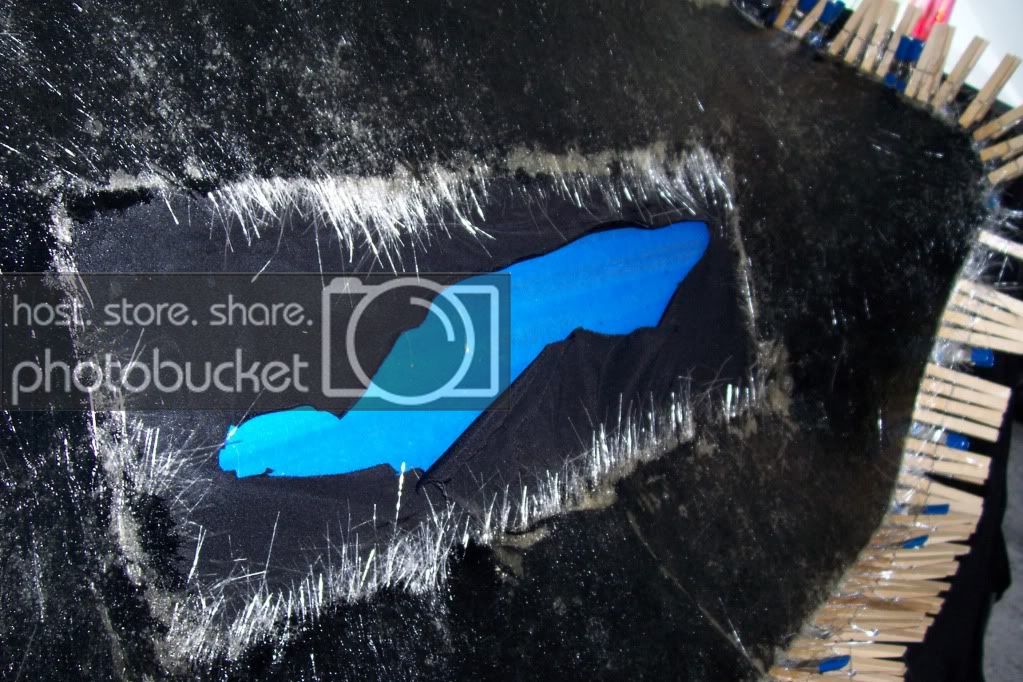

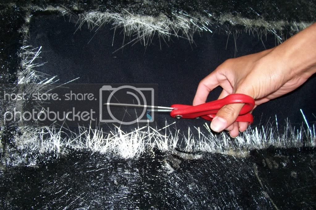

cutting to access the center
lifted corner

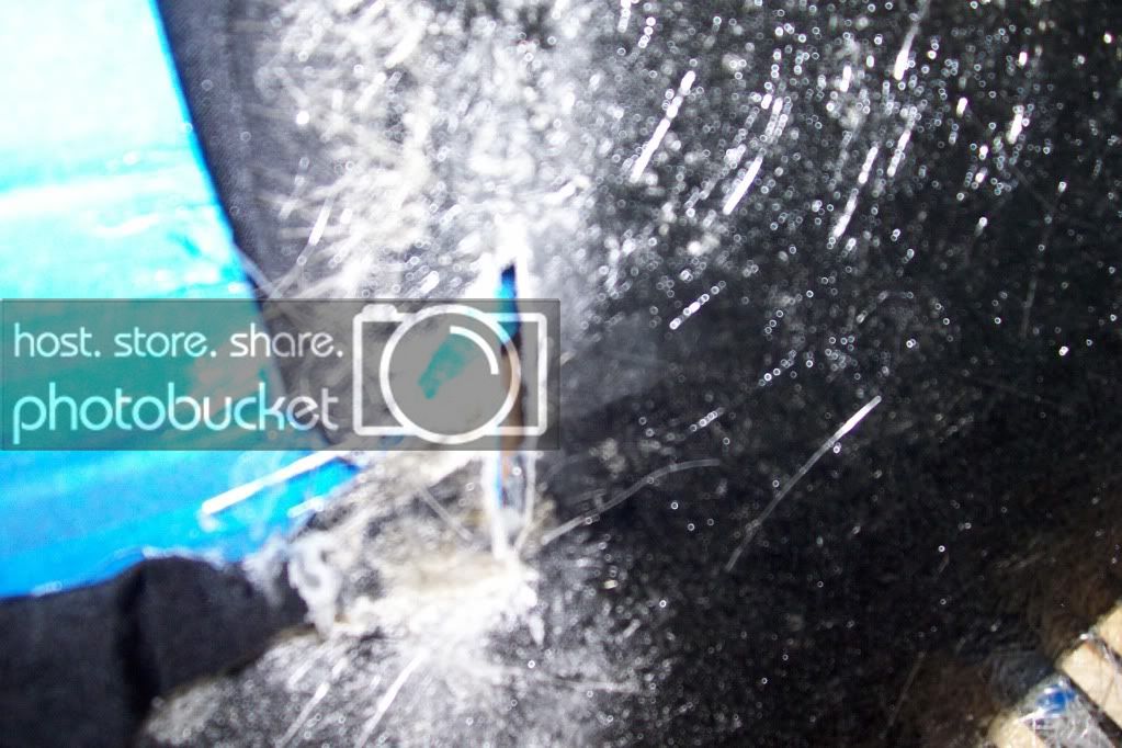

lifted center
fuck it..
start it all over. and much better

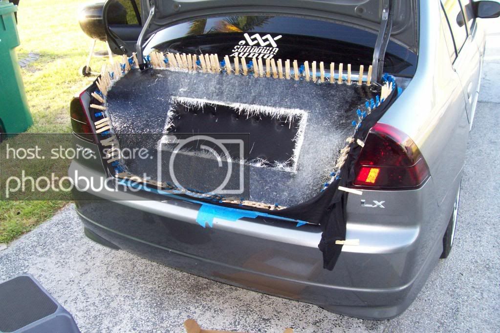

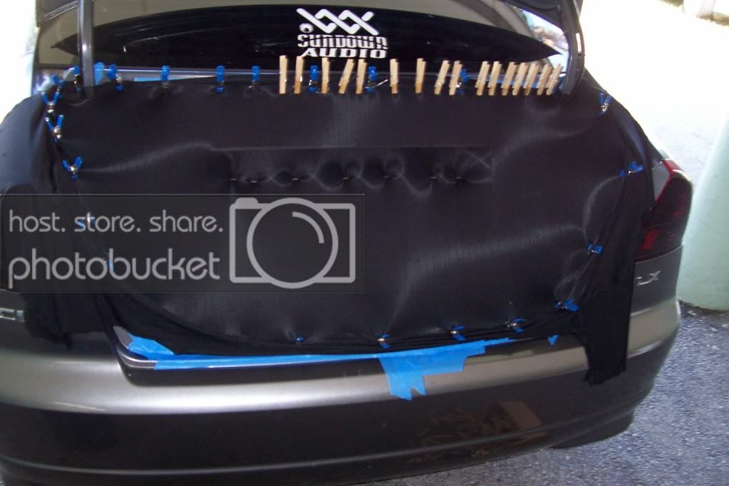

alright today i started out with laying more layers onto the rear amp panel.
no pics of that.

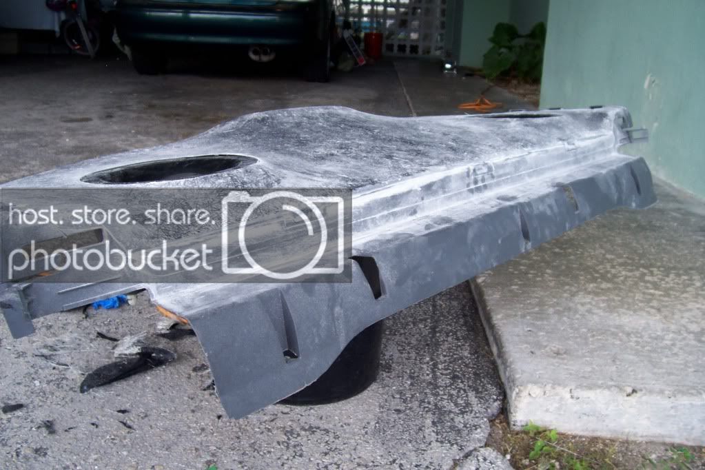

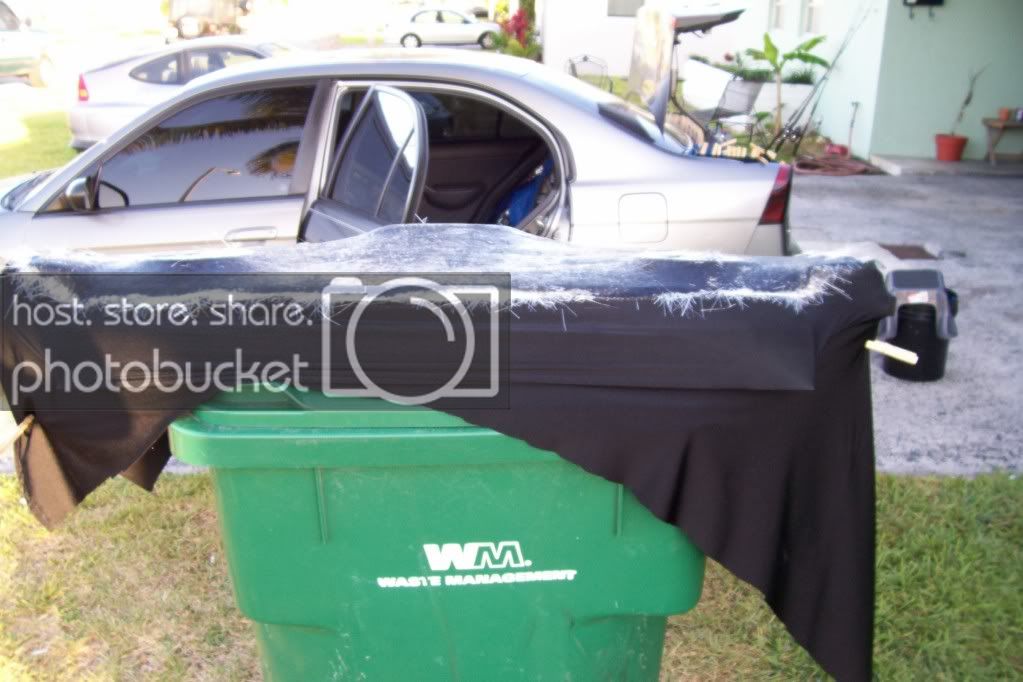

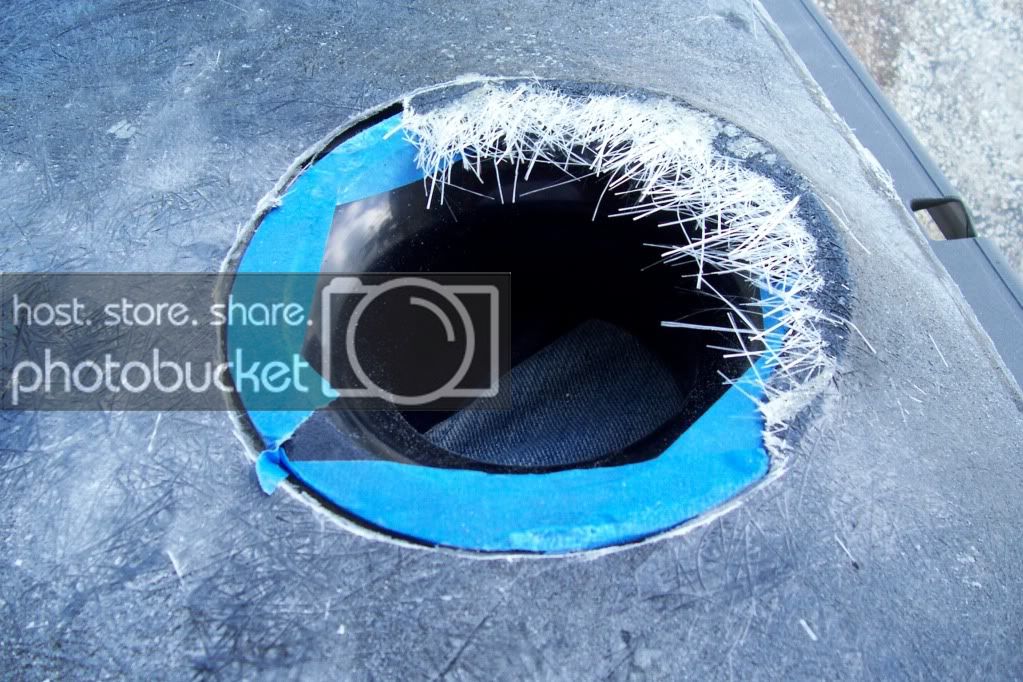

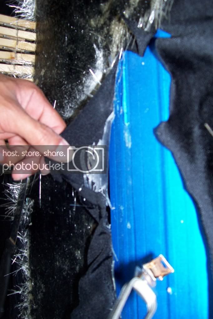

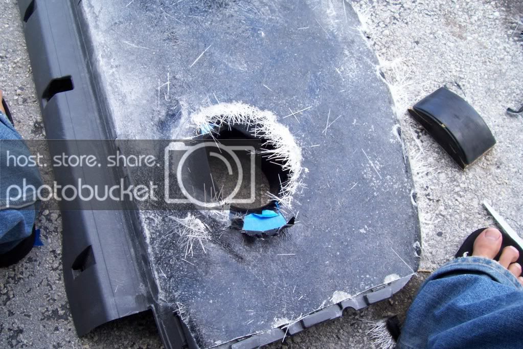

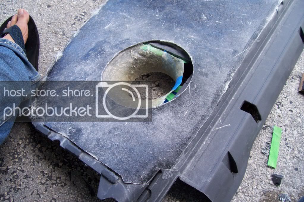

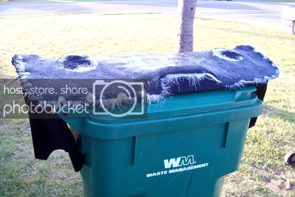

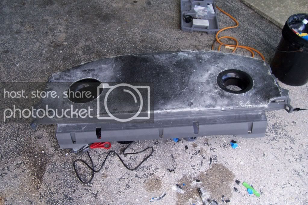

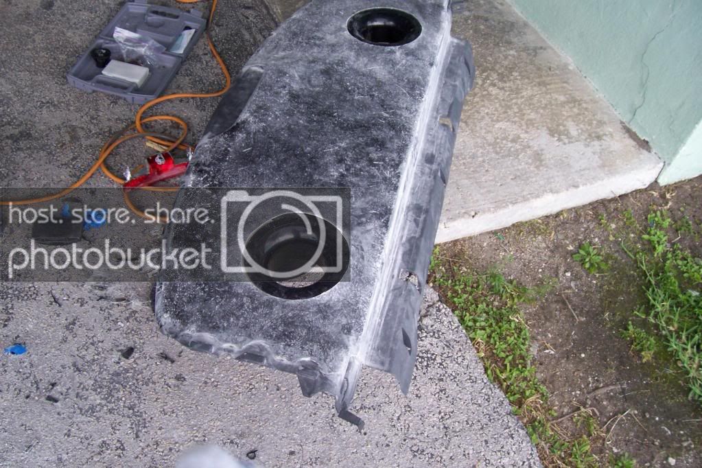

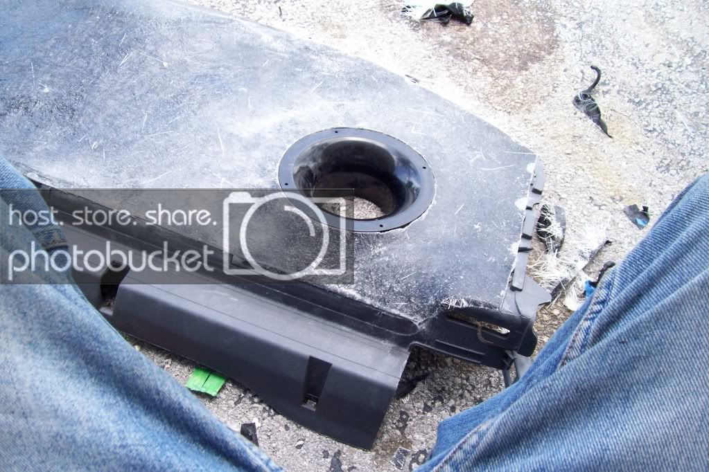

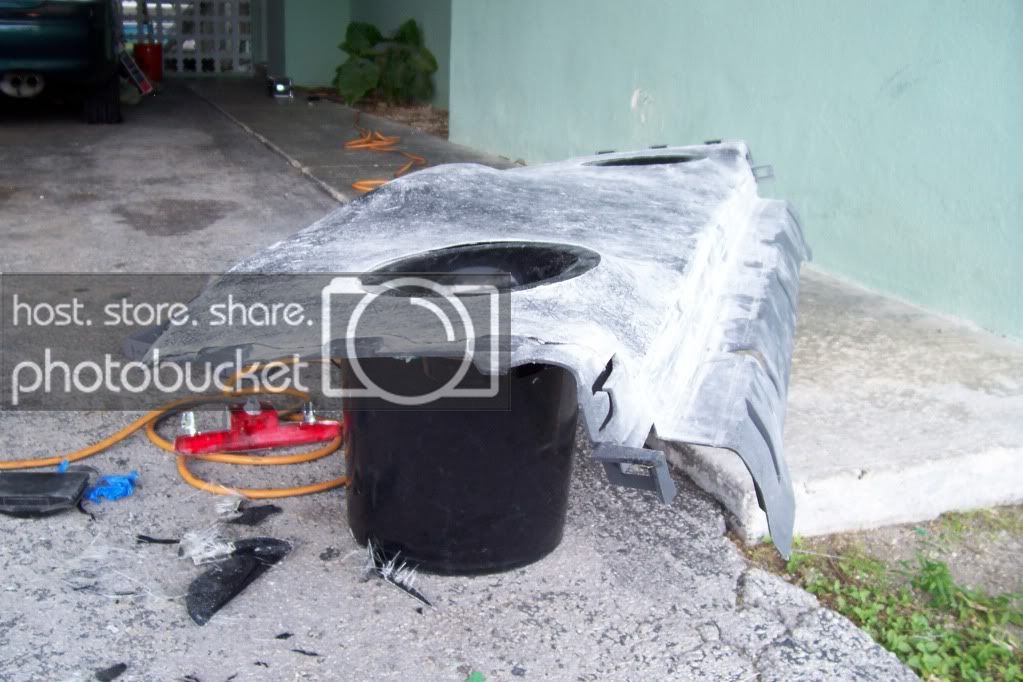

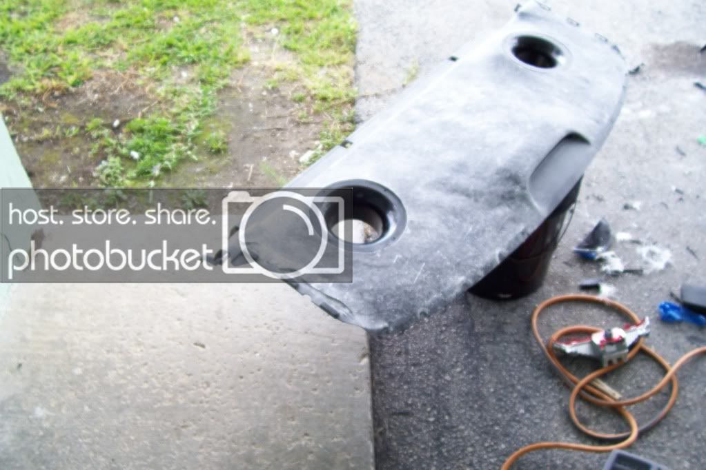

after that i set the car in the sun and started to remove all the excess fiberglass that was on the rear dash panel and remove the poirt flares, first port out
working the second
second out
both cut out and sitting in place. all of the panel was sanded
