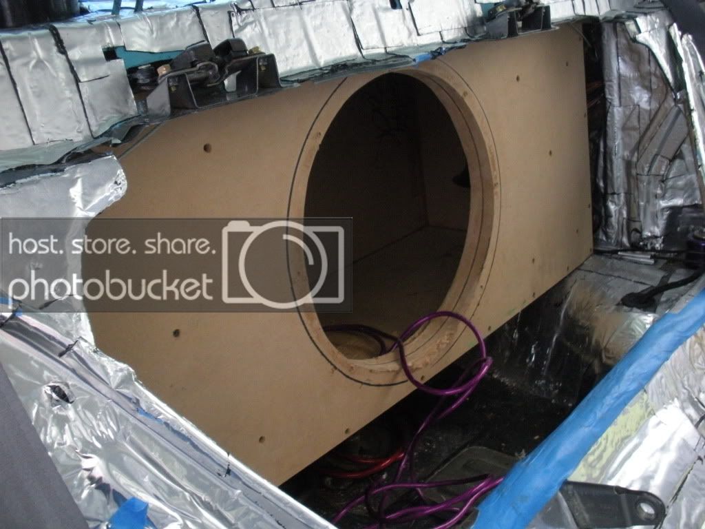

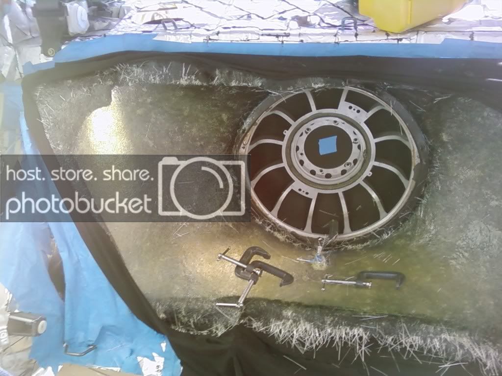

started with trimming a little bit of off and removing the basket. c-clamps first
clamps off

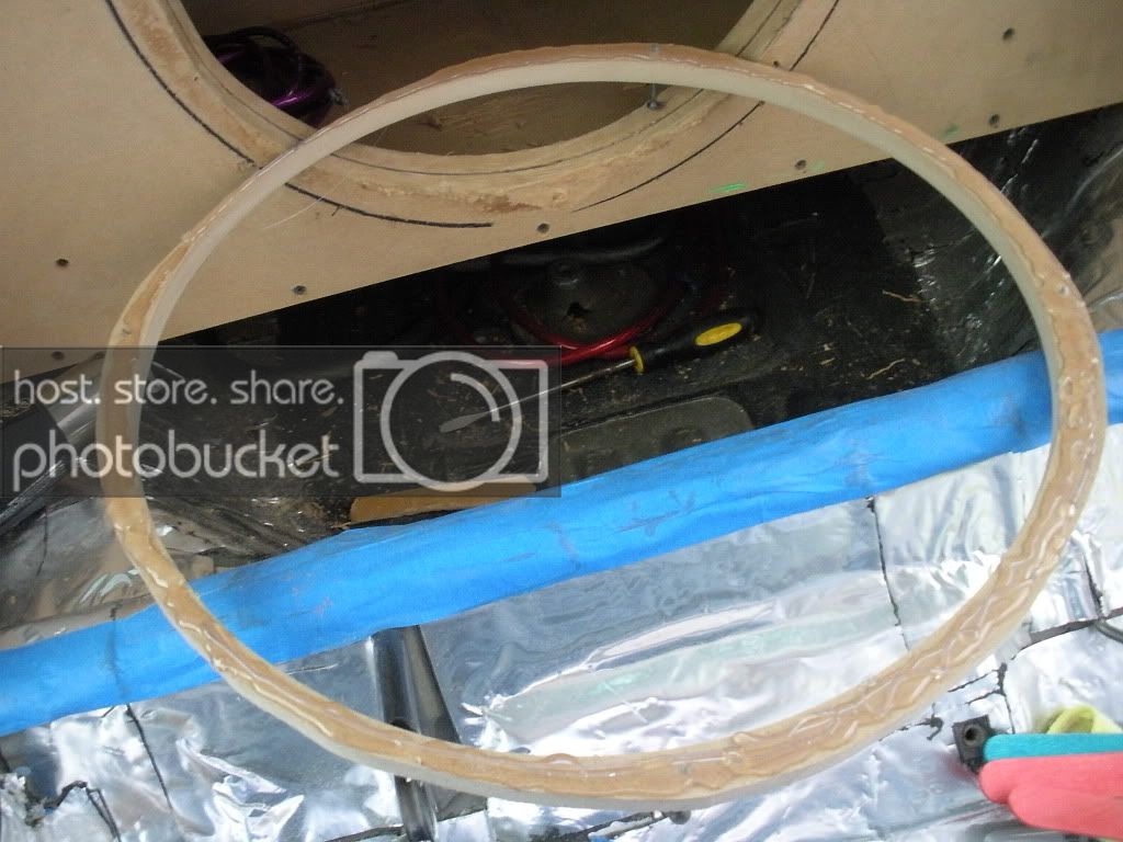

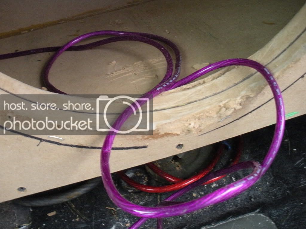

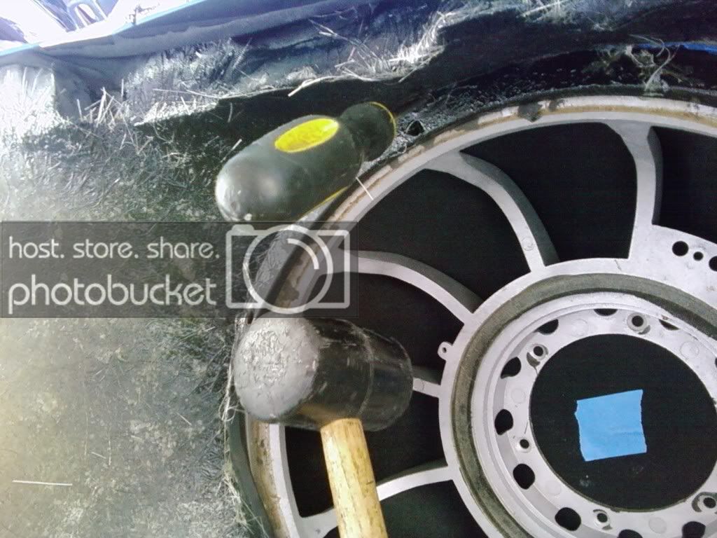

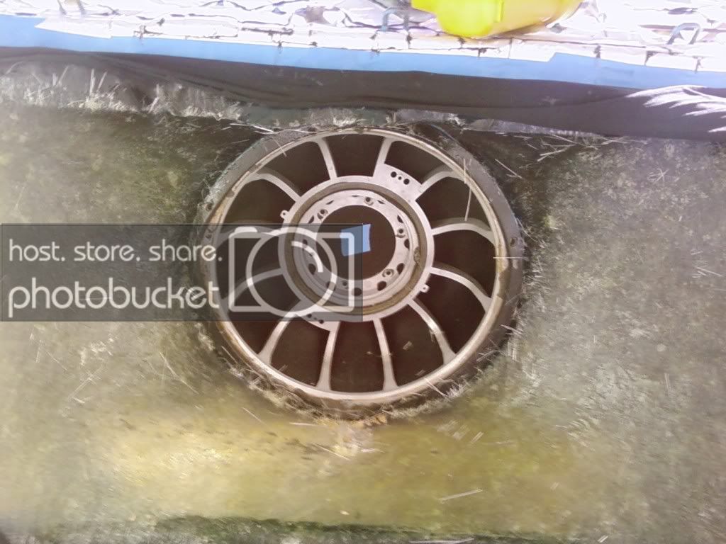

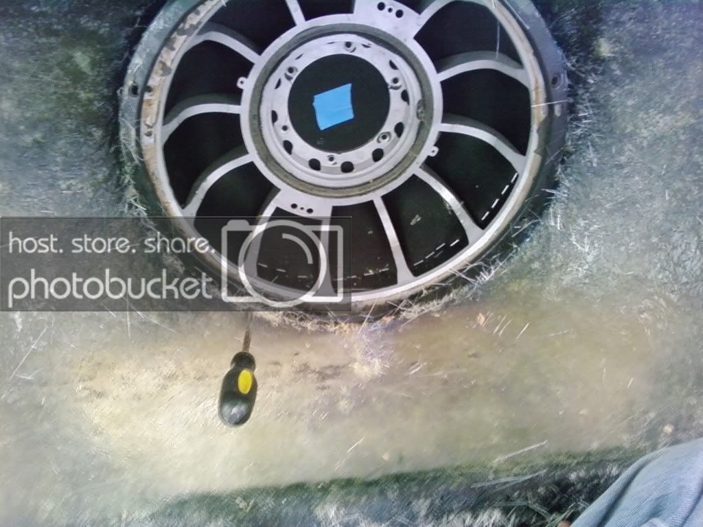

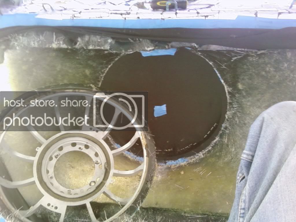

the basket managed to get glassed in place lol, so i have to "chisel" it out;
basket out

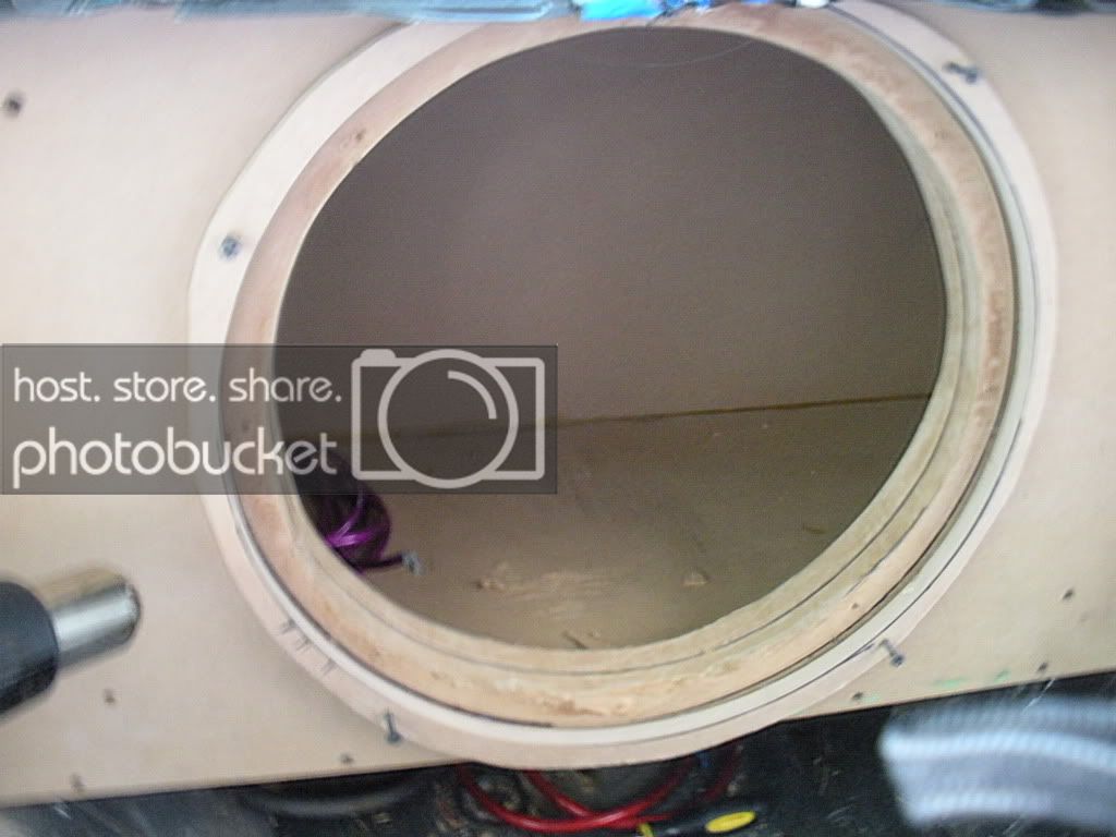

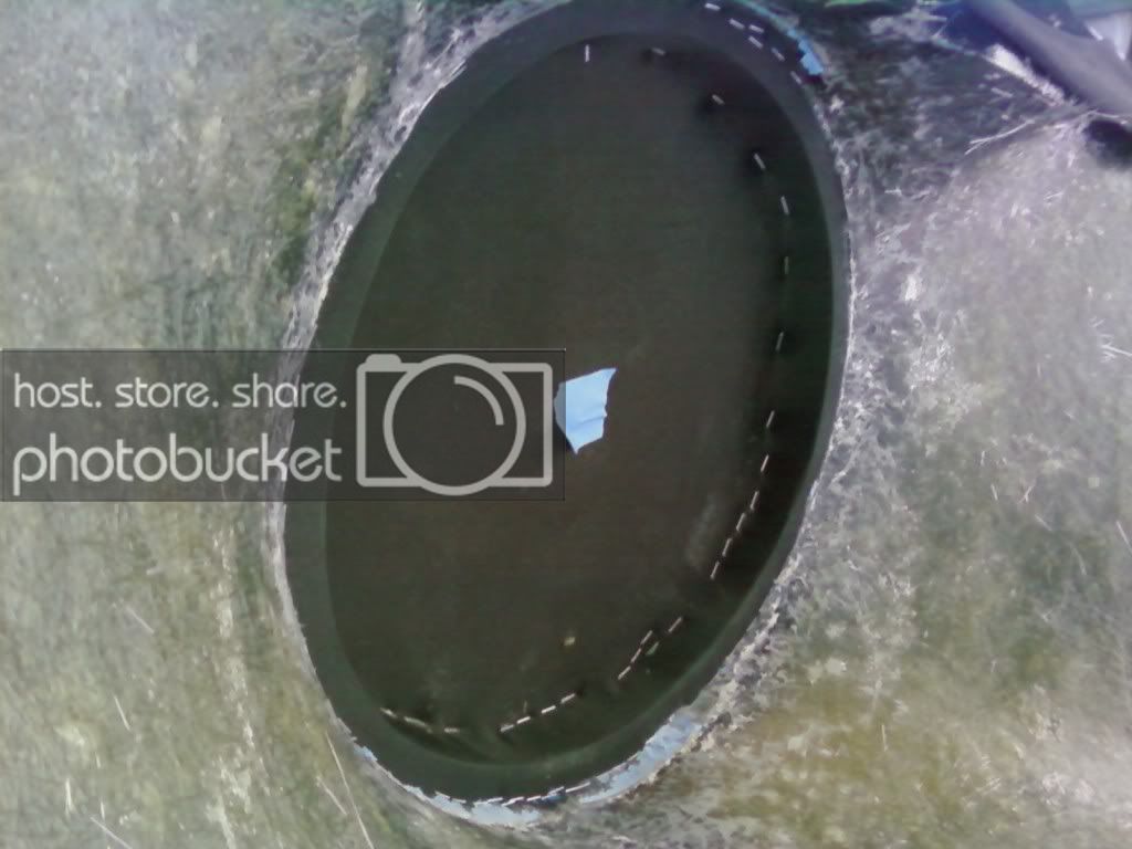

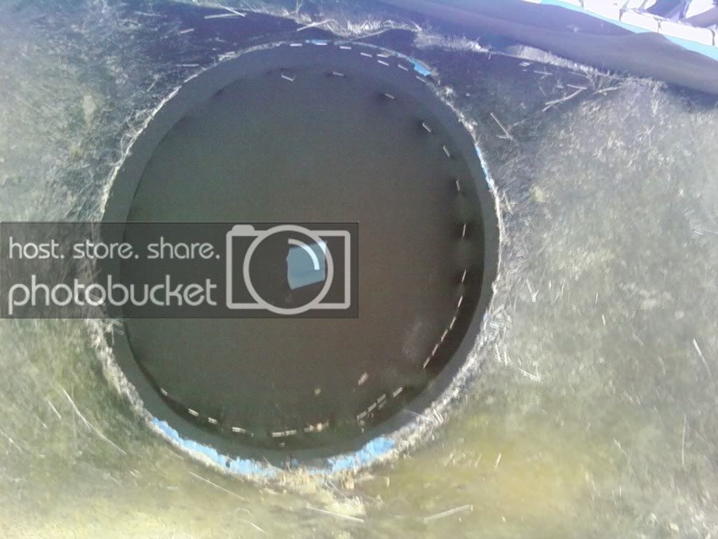

well i had to "harden" the underside lip of the fleece for the basket so i had to staple it back down to the box
resined the area and added a few patches of glass on the bottom and top section where i couldn't get to when the clamps where in.

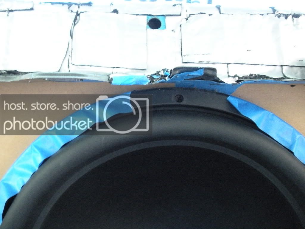

after that was done i started out with taking the side seat sails and test fitting them in place so i could extend the glass panel to ensure me the panel will cover all areas
marked my areas

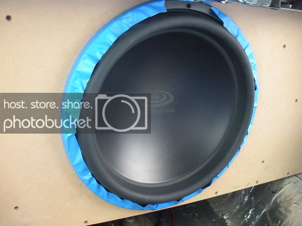

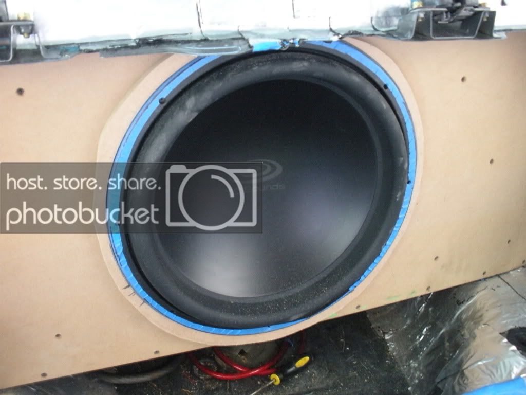

i put the panel back in place and wanted to get a test fit with the top peice. nom nom nom
i then clamped the panel back in place with the basket so i could now work on the extention

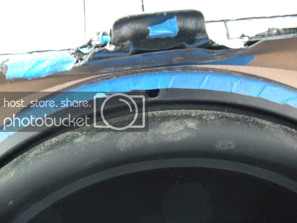

at this point i had to work on the guys car again. after that my panel was ready to be taken out
out and trimmed
