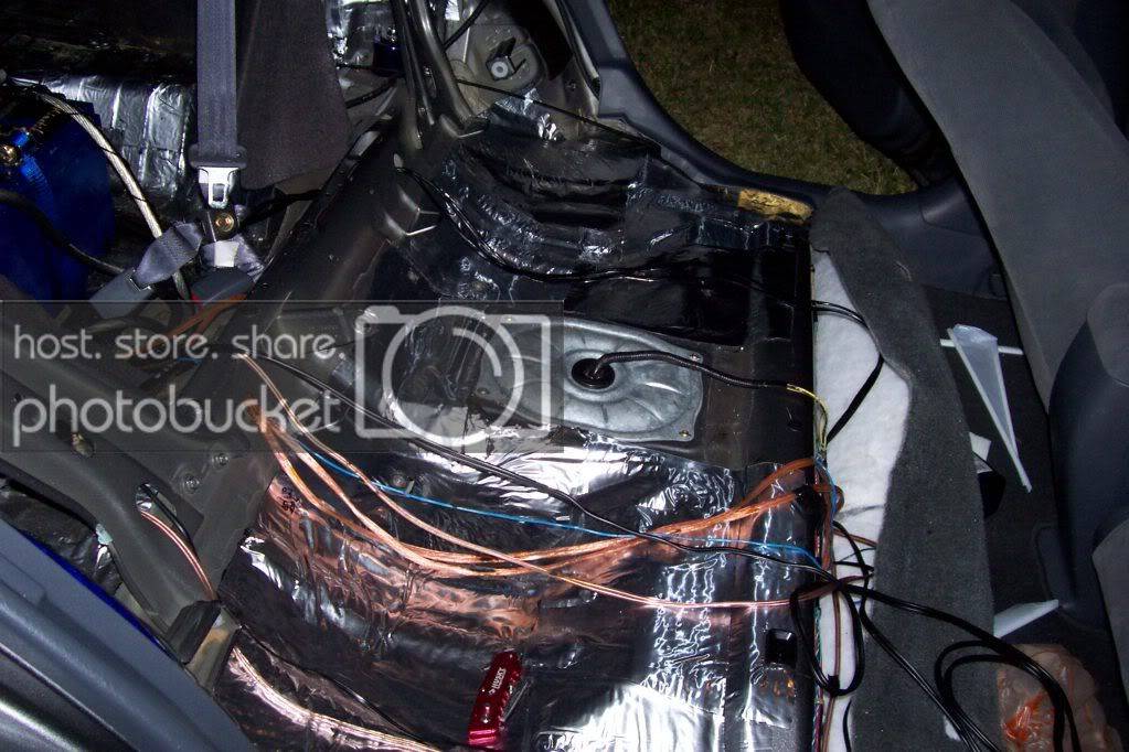

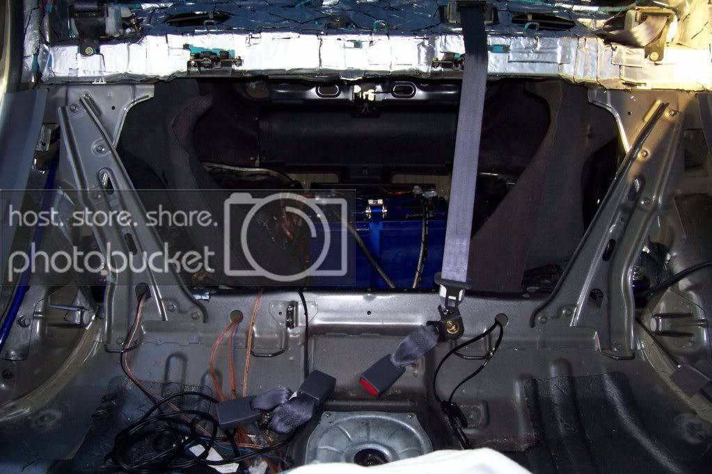

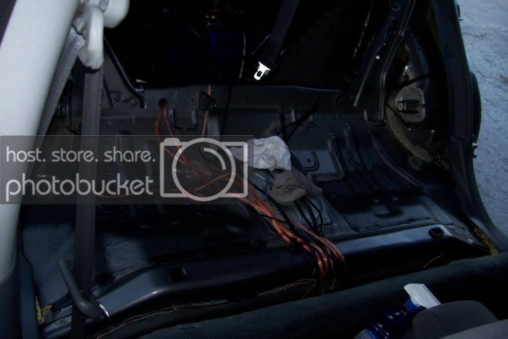

anyways. tonight i started out with stripping out the back seat and rear dash panels. i began by laying 1 layer of edead. i stopped after 1 unfinished layer cause i'm having back pains from work. i'll finish adding more and start multi layering, though i need to work on the back side of the brace.

rear of car stripped before cleaning
used a "new" thing of Simple green that comes in a blue bottle. says it's a stronger degreaser or something. worked pretty good in cleaning that shit. notice the colors of the rags.
and then after my first layer.
