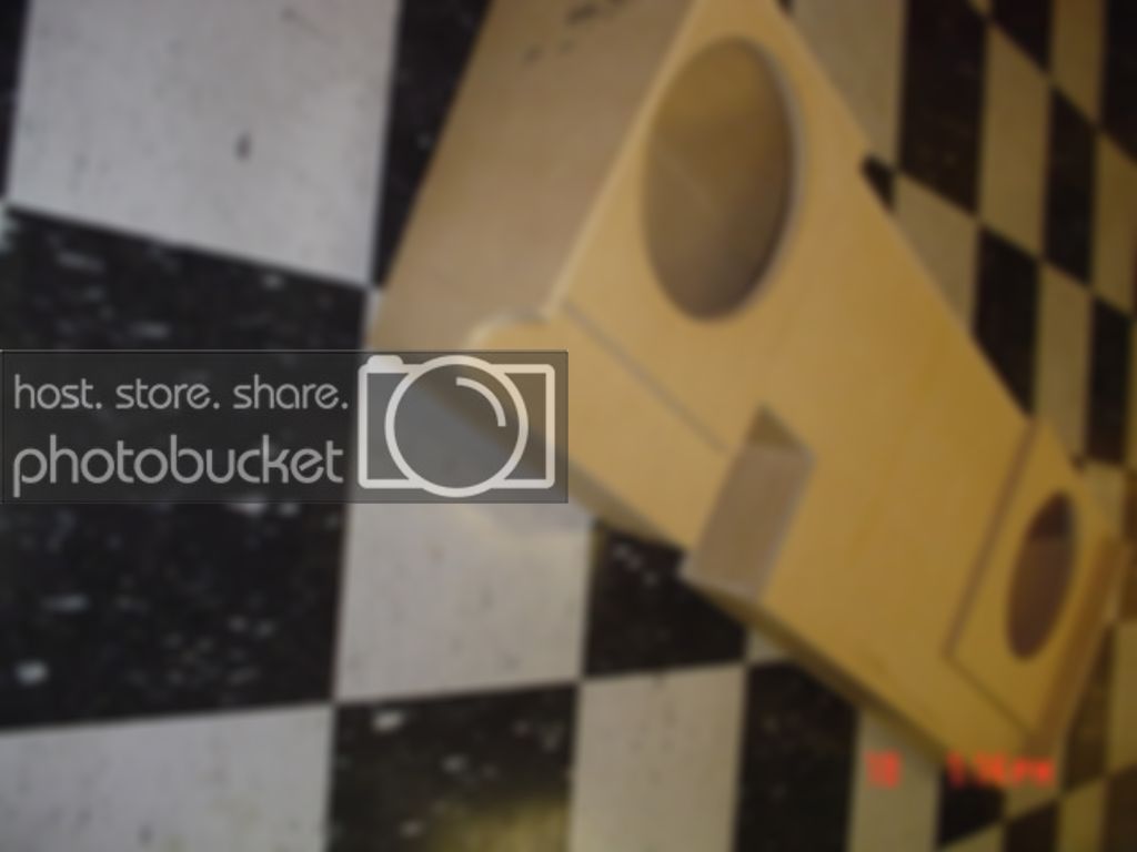

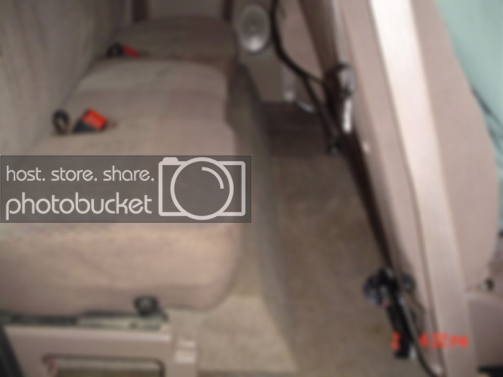

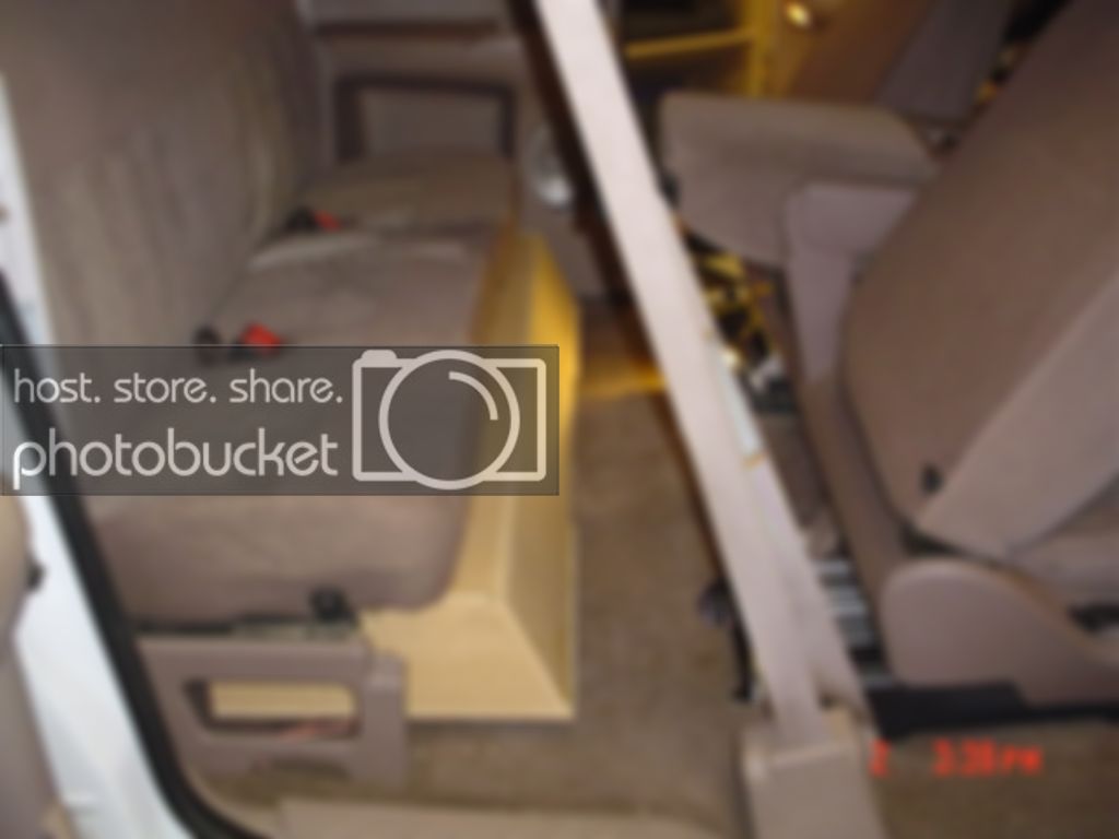

Not much room under these seats and it isn't like a chevy that has a "hanging" seat... It has a metal structure... Even if you lift them a little bit, there still isn't going to be a whole lot of depth. Factory depth (before 1.5 inch for mdf) is about 7 inches. So the 1.5 + room for the woofer to "breath" really makes it hard to get woofage under the seats. The best luck I have had is removing the jump seat on the driver side (i'm assuming it's the same in 99) and building a box that fits there while still maintaining the two seats beside it. I can get a picture of my one 10 tomorrow, but really it's not much to look at... but I did have a 3 10 box in the same space that worked decently well.

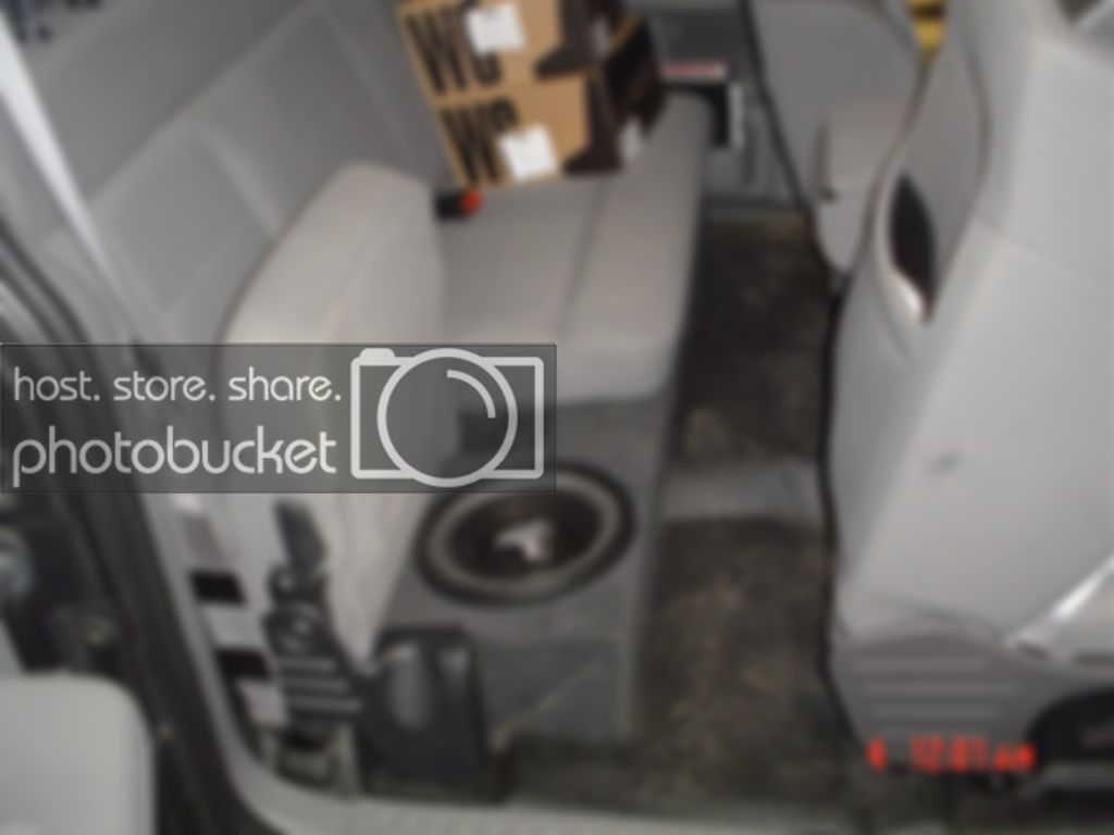

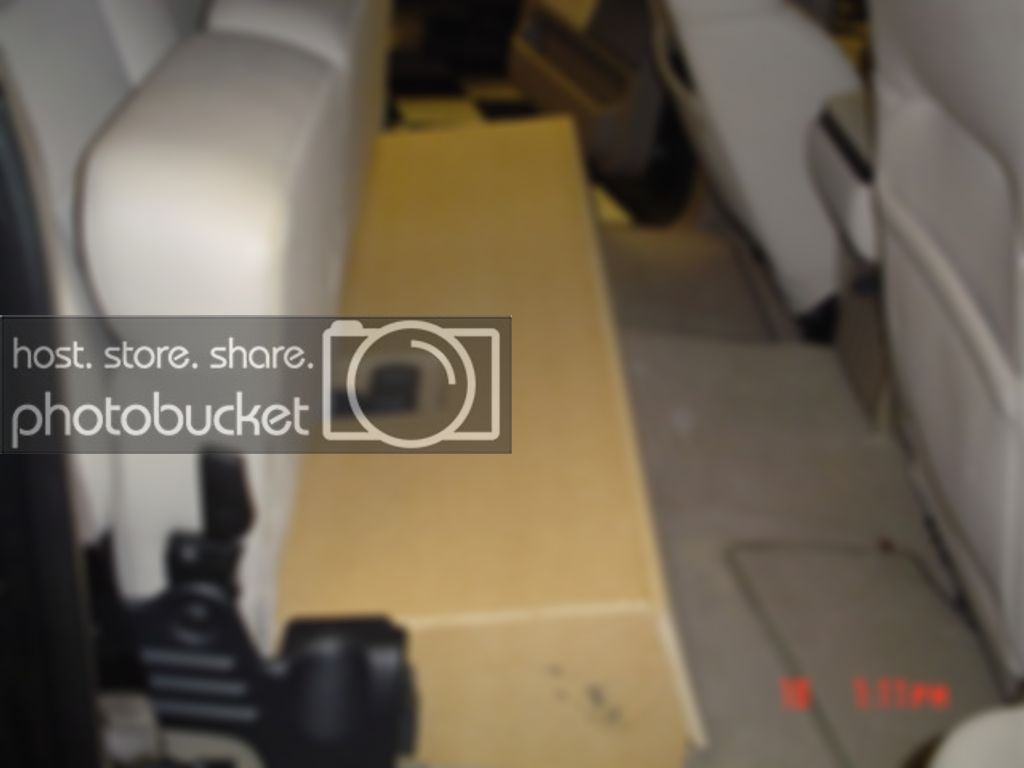

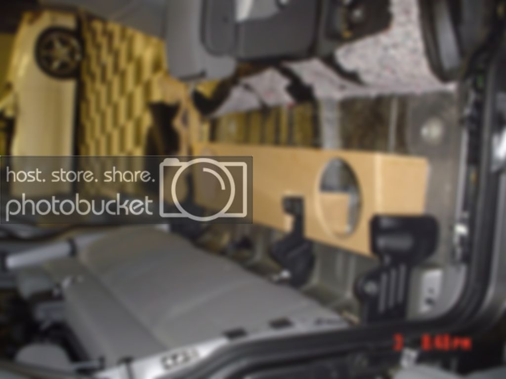

****, me likes... got any pics with the seat down?? It looks like you just removed the metal piece (does it not have a support cage?? Don't know with out being able to look at it)... Do you remember the mounting depth?? overall volume?? **** I like that! Where'd you go with the amps??
EDIT.. just noticed that is a 4 door... hmmm
