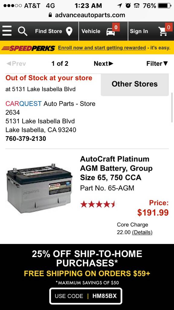

Well as long as you think it's cool and worth 100 bucks that's all that matters lol I am just jealous I didn't sell it to you ! As far as two agm batteries for 300 here you go , 191.98 each less 25% off and free shipping makes them 144.24 each x 2 is 288.48 at advanced auto parts .
