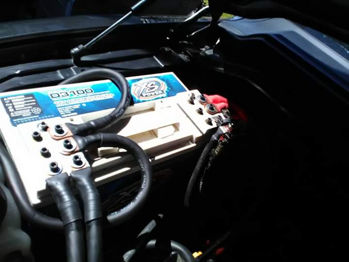

I'm still confused on what kind ofbattery. I was told my friend about kinetik or xs power ? I'm assuming those aren't ''agm''..And where is good place to buy alternators ?
XS and Kenetik are both AGM.
Just by Exide or East Penn Deka though
I've heard 55ah of battery per 1000watts, i've also heard to match max battery amperage output to rms wattage. I don't think there is really a formula to use to know how many batteries you're going to need. It's kind of a experience will tell you thing.
Amp hour is the amount of amperage the battery can put out before it discharges. Which deep cycles are great at bug have much lower discharge rates. I'd run a typical high cranking amp srarting battery unless your running the system with the car off..

XS Power D1200
Say it works 1500-3000 Watts. Will this suffice ??
You can get a Deka or Duracell group 31 AGM for the same price. They're twice as big and will obviously crank more, plus have tons more reserve.
