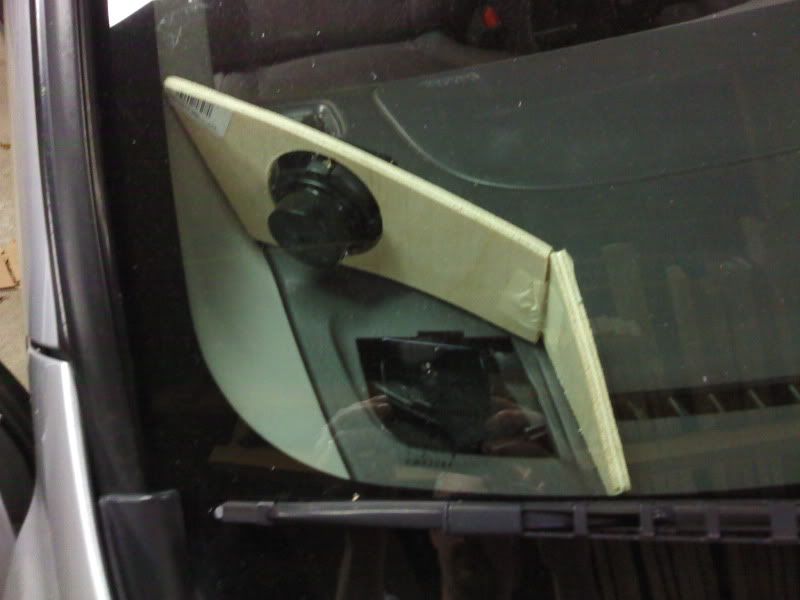

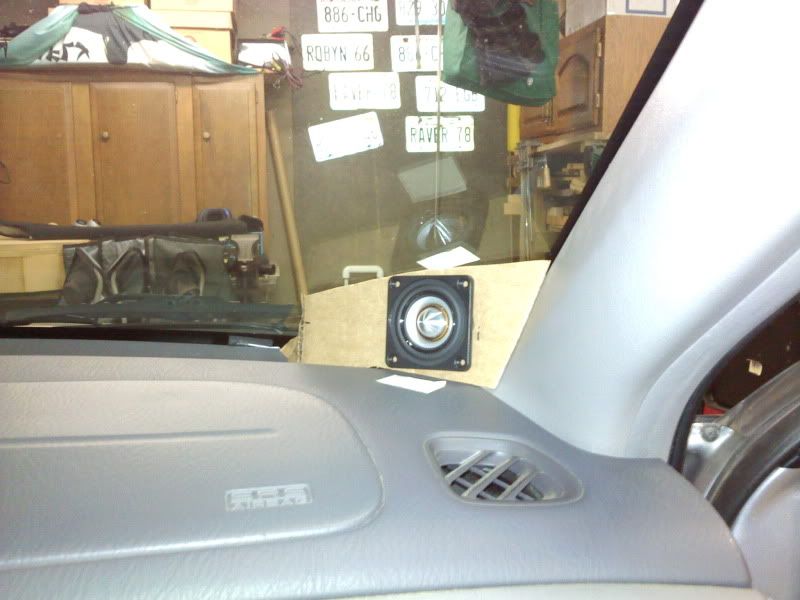

found pics of the tang band on-axis mockup. the final version will need to be much smaller than this and fiberglassed - i lost too much visibility. i'd glass the entire airspace and not leave the back open.

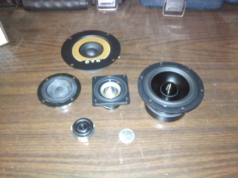

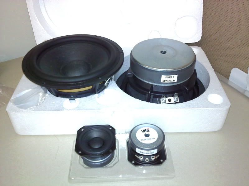

and some of the drivers i'll be playing with (two tweeters are for a refurb project)
so you had the mids on axis to the driver across the cabin? passenger side speaker to driver seat and vice versa?
how were the results? I'm looking to do pillars in my car and I have the 4" tang band bamboos and am looking for some ideas to try for aiming.
I haven't built a fully sealed mockup yet, so my tests were only partially useful. It is a promising concept. But I want the inside edge to be well rounded and much shorter. Also, glass is a terrible inside wall. //content.invisioncic.com/y282845/emoticons/smile.gif.1ebc41e1811405b213edfc4622c41e27.gif
