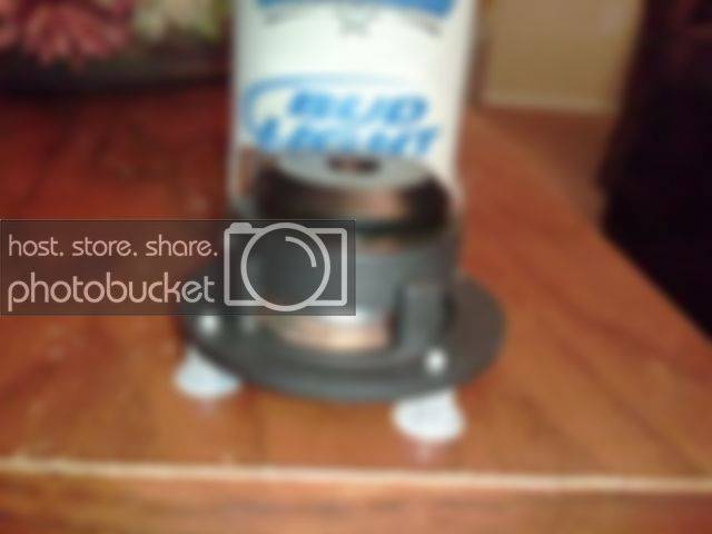

these are a 2" driver!!!....
sorry for the hair...

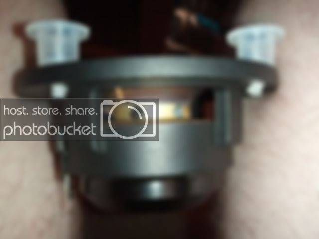

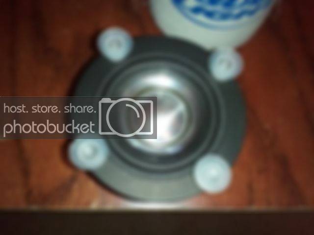

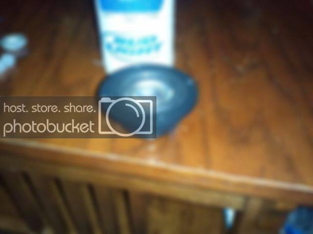

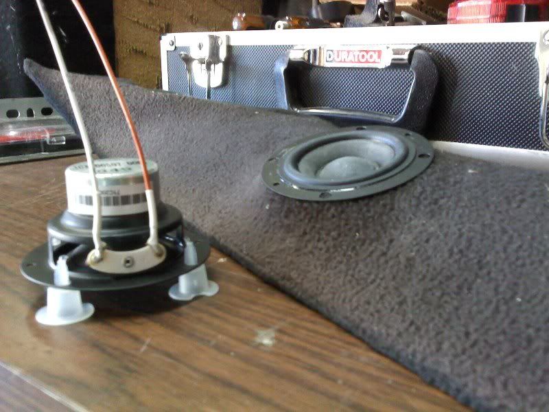

I just bought a set of H-Audio/Audible Physics AP3's. Same thing as the Fountek FR88ex driver, but with a more updated cone material to work out the quirks of the FR88ex. Should be here tomorrow.
Got my drivers yesterday. These things are tiny. They are the H-Audio/Audible Physics AP3's. They are very similar to the Trinity's and a step up from the famous Fountek FR88EX. Waiting on plots on DIYMA.

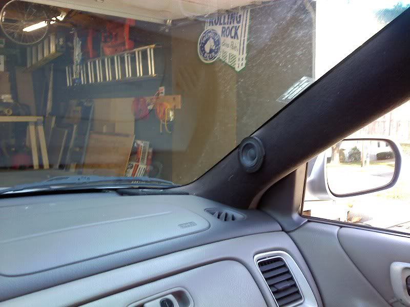

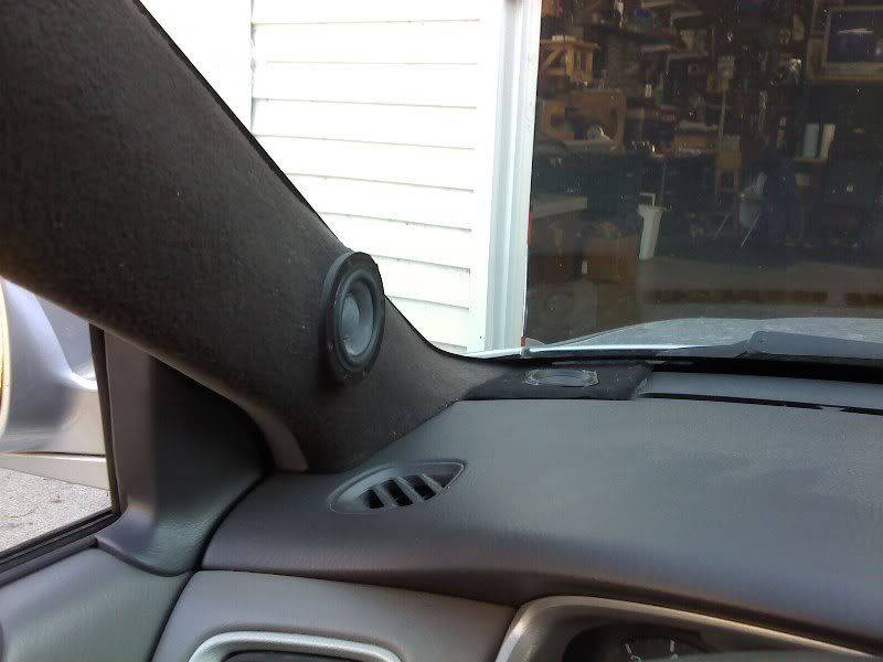

some of the configurations i tried - dash facing up vs apillar. i did a lot of AB comparisions. the focus was soundstage and not so much tonality since airspace wasn't fully controlled. no pics of the on-axis mock-ups.
