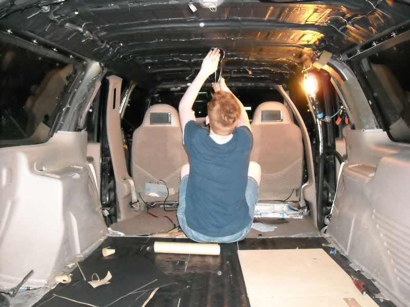

I have been working on some stuff for this weekend. If it works out like I have in my mind, it should make for some cool pics //content.invisioncic.com/y282845/emoticons/biggrin.gif.d71a5d36fcbab170f2364c9f2e3946cb.gif

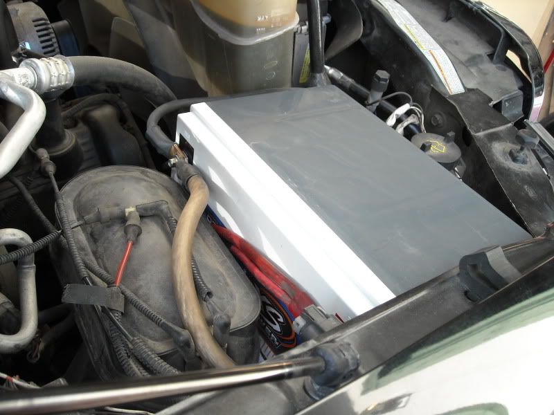

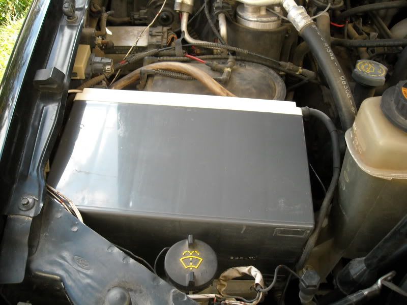

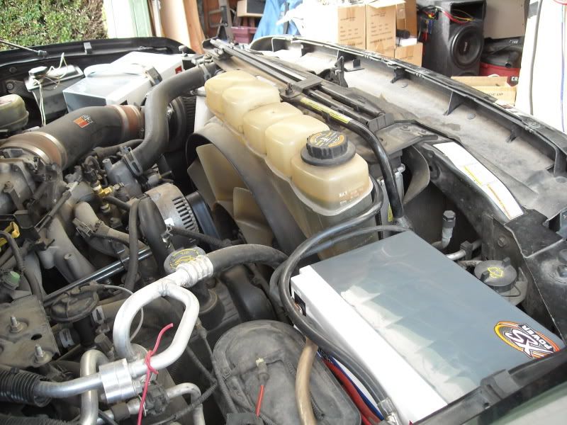

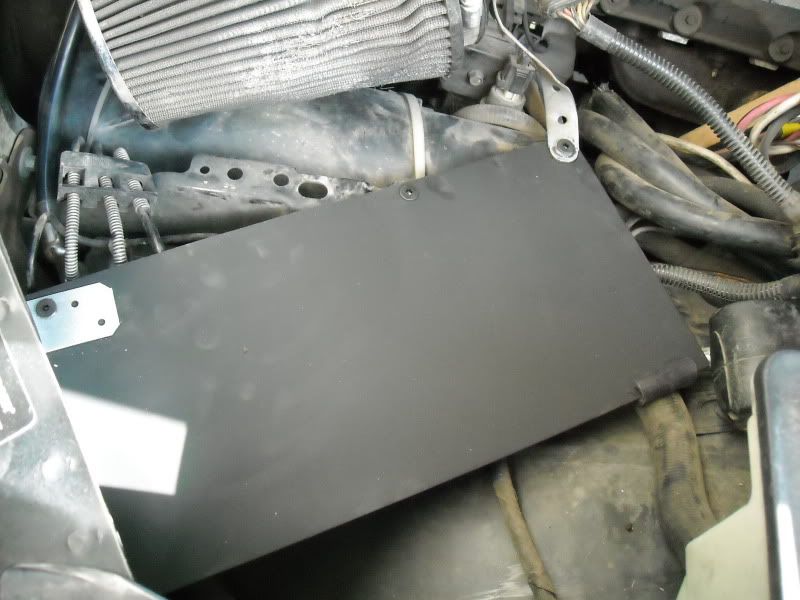

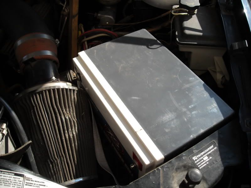

Got a few things done this week. I wasn't looking to do the battery swap up front, but once again Optima has let me down. I swear they are the worst batteries I have ever spent money on. When they die, they are dead.
The other great thing this week was that the memory camera took a dump so all the pics I had for y'all were for not. Oh well, here's a few of the after part. //content.invisioncic.com/y282845/emoticons/biggrin.gif.d71a5d36fcbab170f2364c9f2e3946cb.gif
I still have to fab up some tiedowns for the new batteries. I had to drop a good inch to get clearance. I think it's about as big as I can go up front //content.invisioncic.com/y282845/emoticons/biggrin.gif.d71a5d36fcbab170f2364c9f2e3946cb.gif

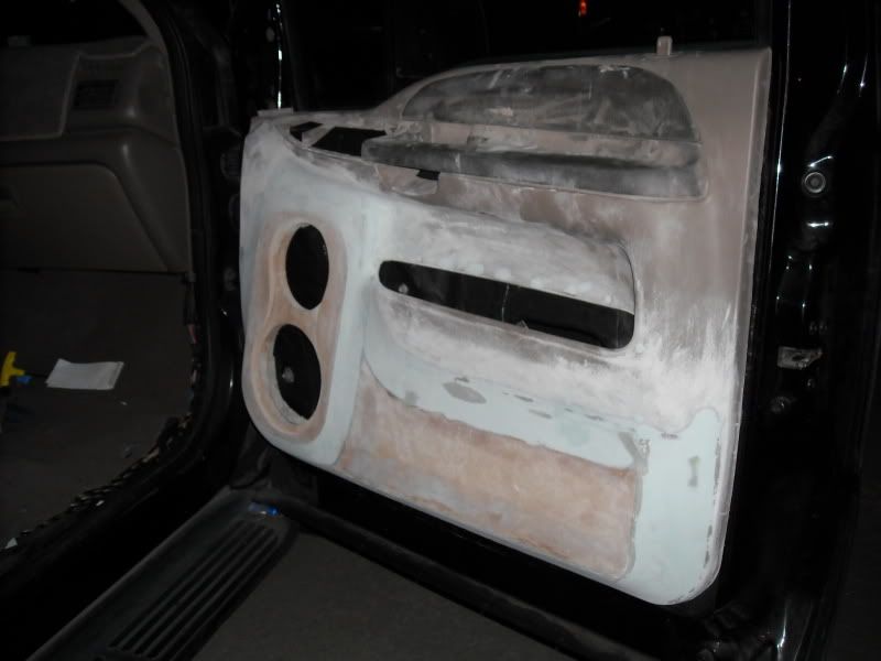

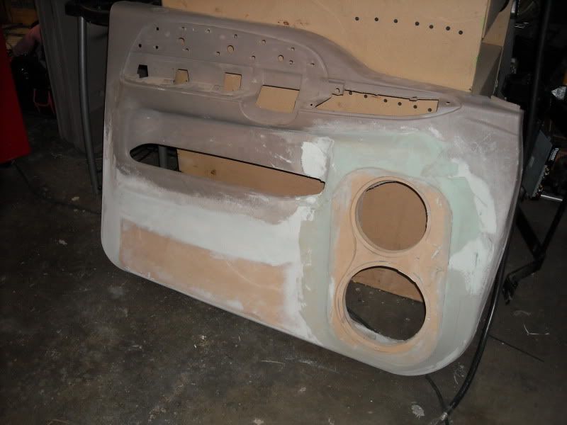

Oh yeah, I have some door panels in progress.
