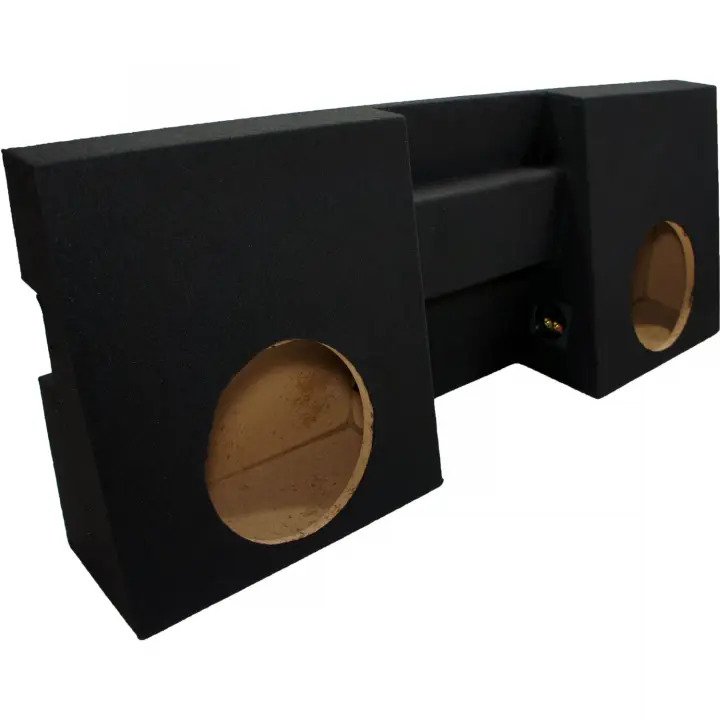

Yeah they make ugly *** enclosures like this
45927
for $144
for $144
