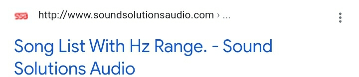

Name 5 songs you hear on the radio that contain 31hz material.
I don't give demos off the radio, do you? I hear plenty of sounds on the radio that get low. If you strictly play the radio then rock your 45 - 60 hz. I like the bass notes between 28 hz. and 40 hz. I have mids and tweets for the other frequencies. You treble rebels can rock your stunt walls and techno music if that's what you are into. I prefer this.
Here look it up. Why do I have to do your research?

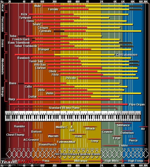

The 28 hz playing down to comes from the fact that it's the cut of point for the piano, I listen to musicals quite often (Les Misérables, wicked, etc,) and I have always loved the piano and would like to hear every part note from it. Not sure I'll get it :D but that's the aim :)

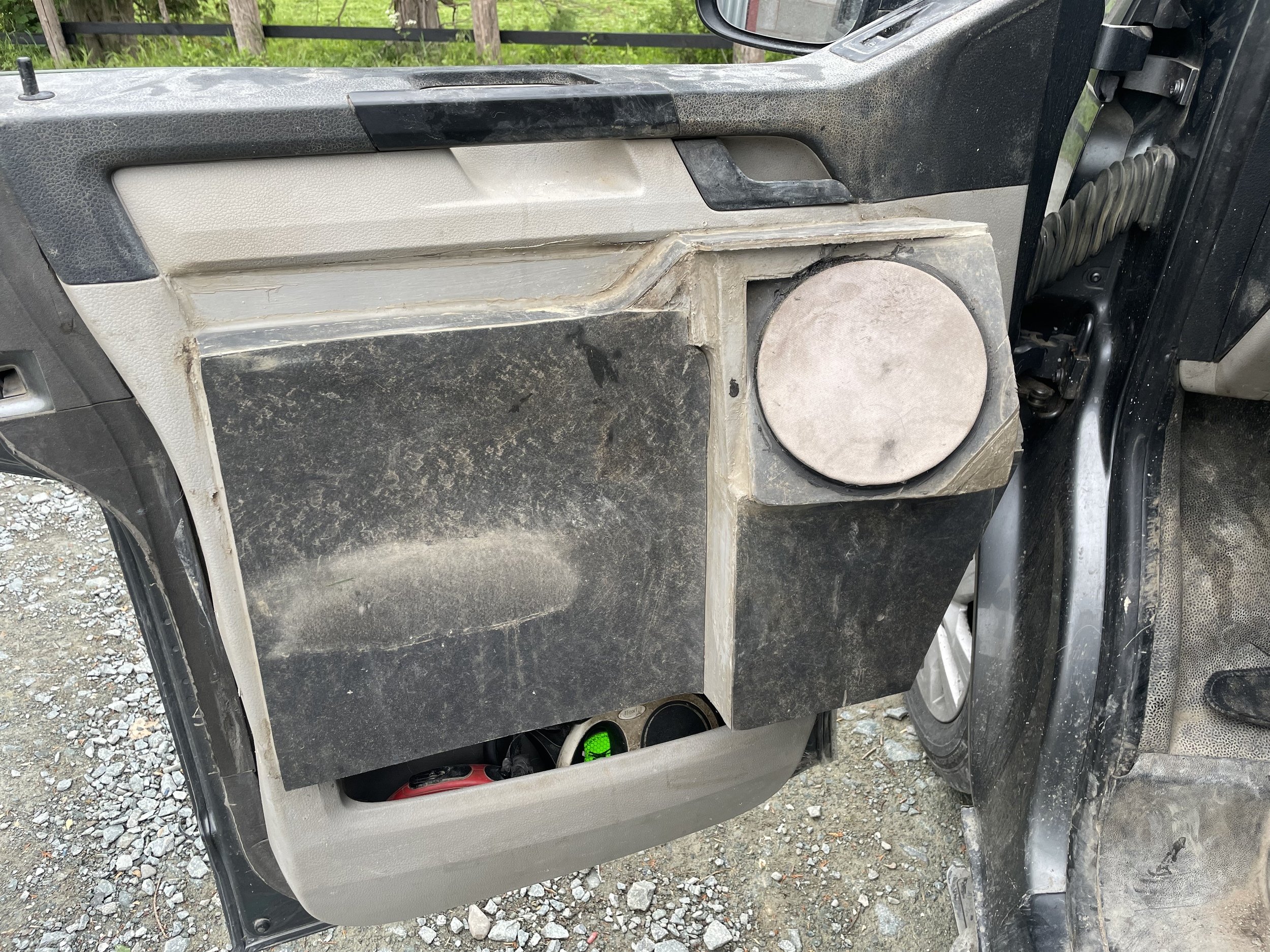

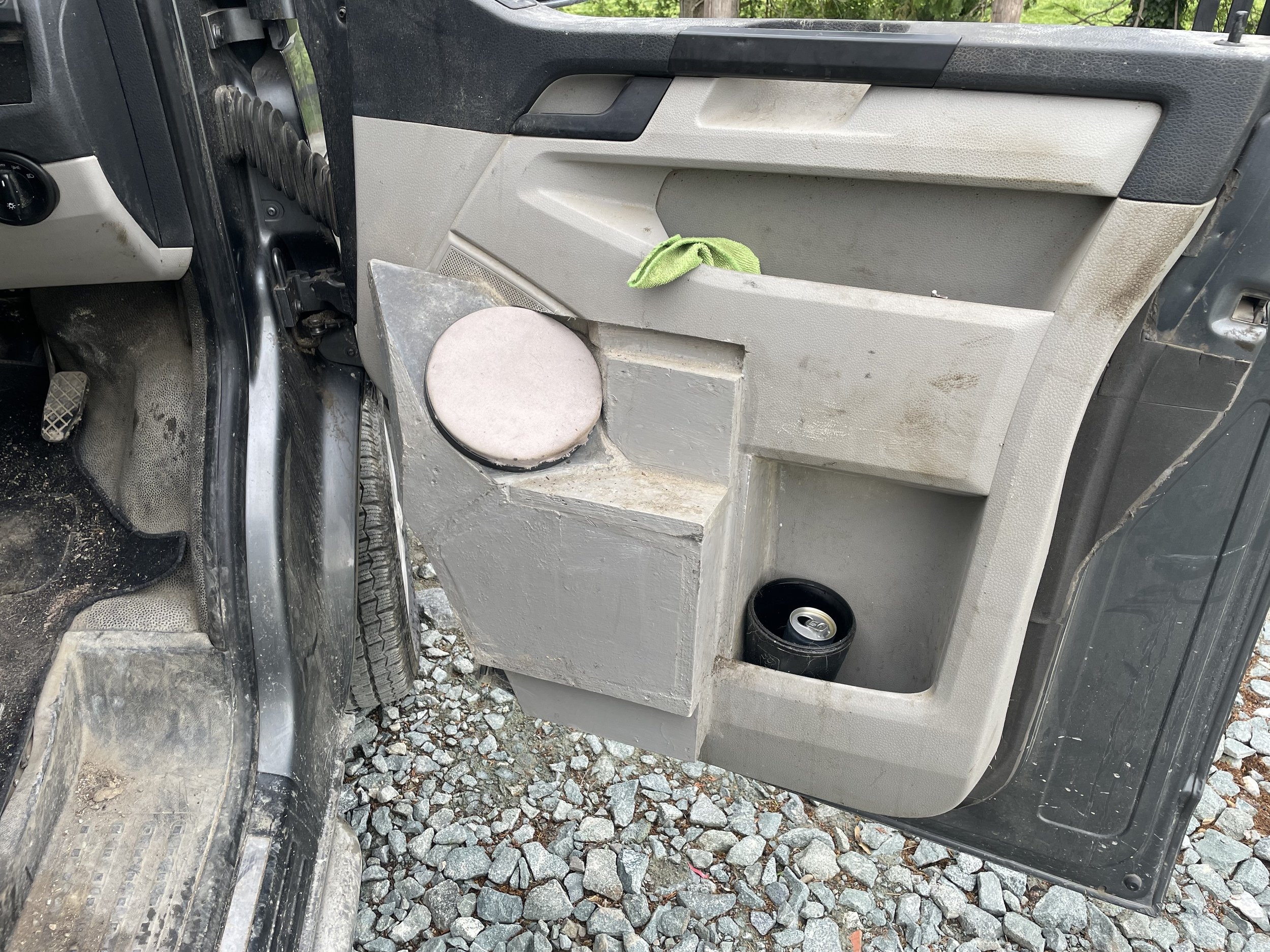

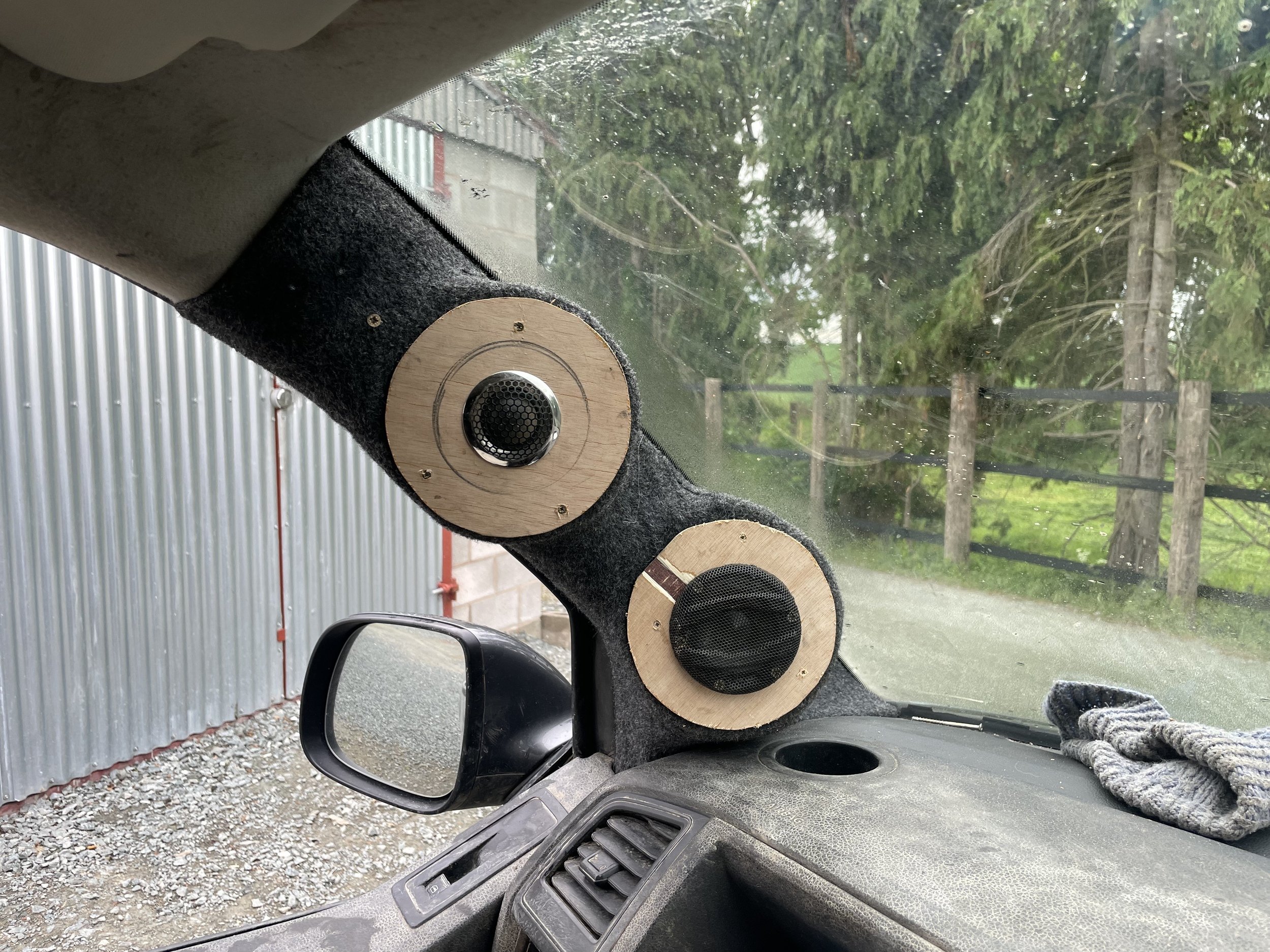

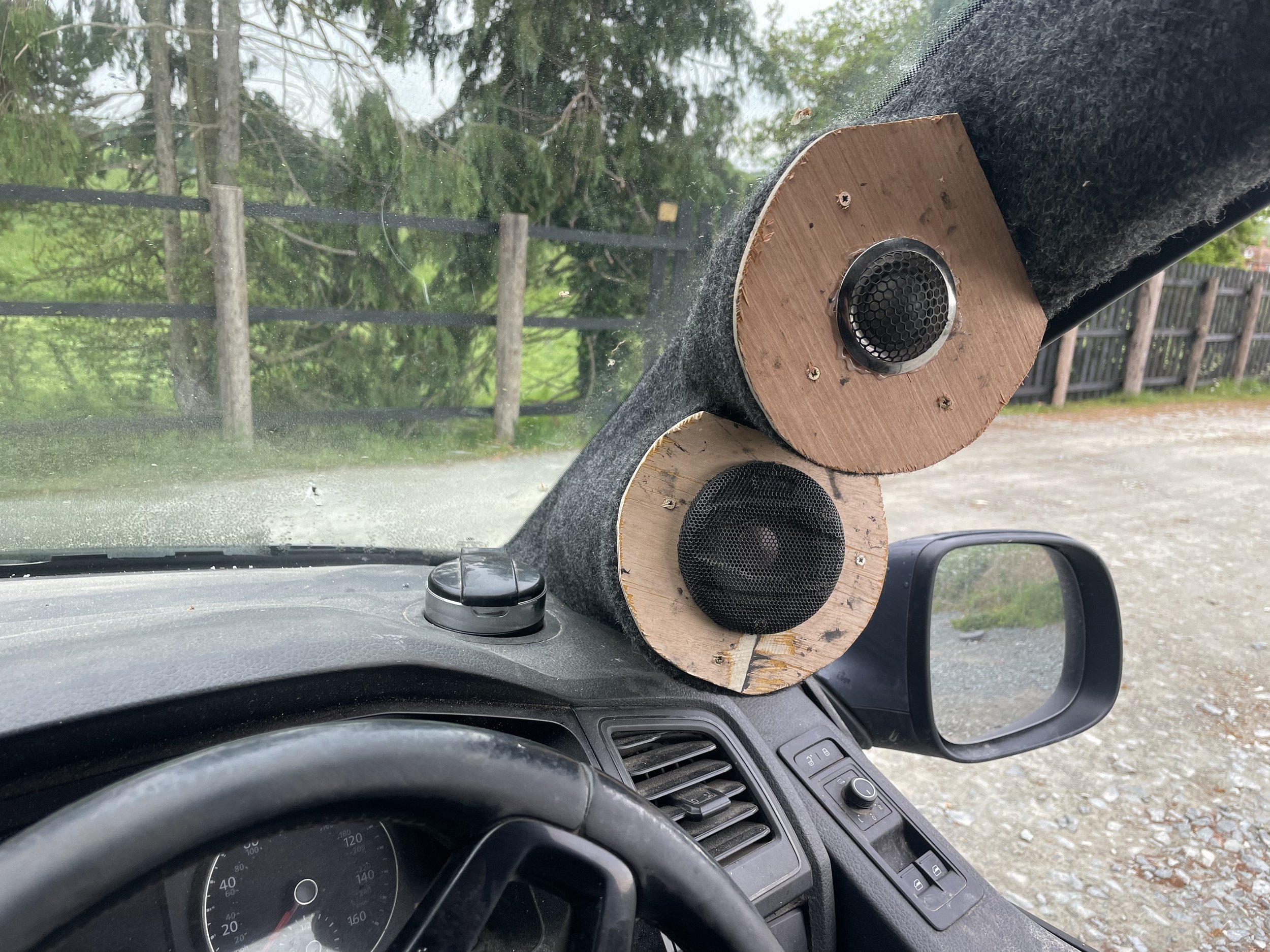

Put the A pillars back in yesterday (exposed plywood is because there holding temporary speakers till cabin is done)
got to redo the midbass now and change them from closed to vent box
