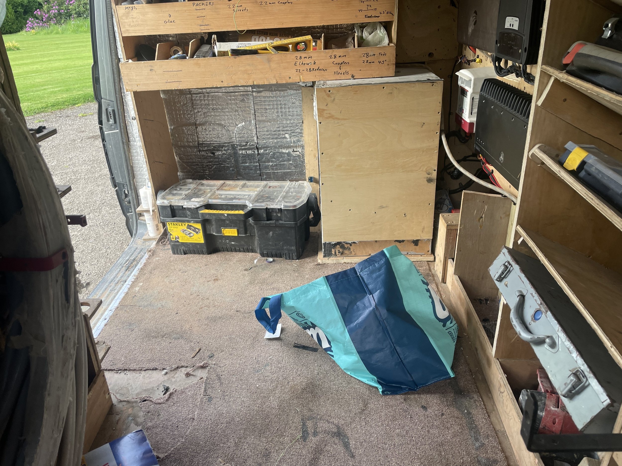

shape wise I’ll be going for a rectangular box as I have completely shifted the shelving around to allow for it.

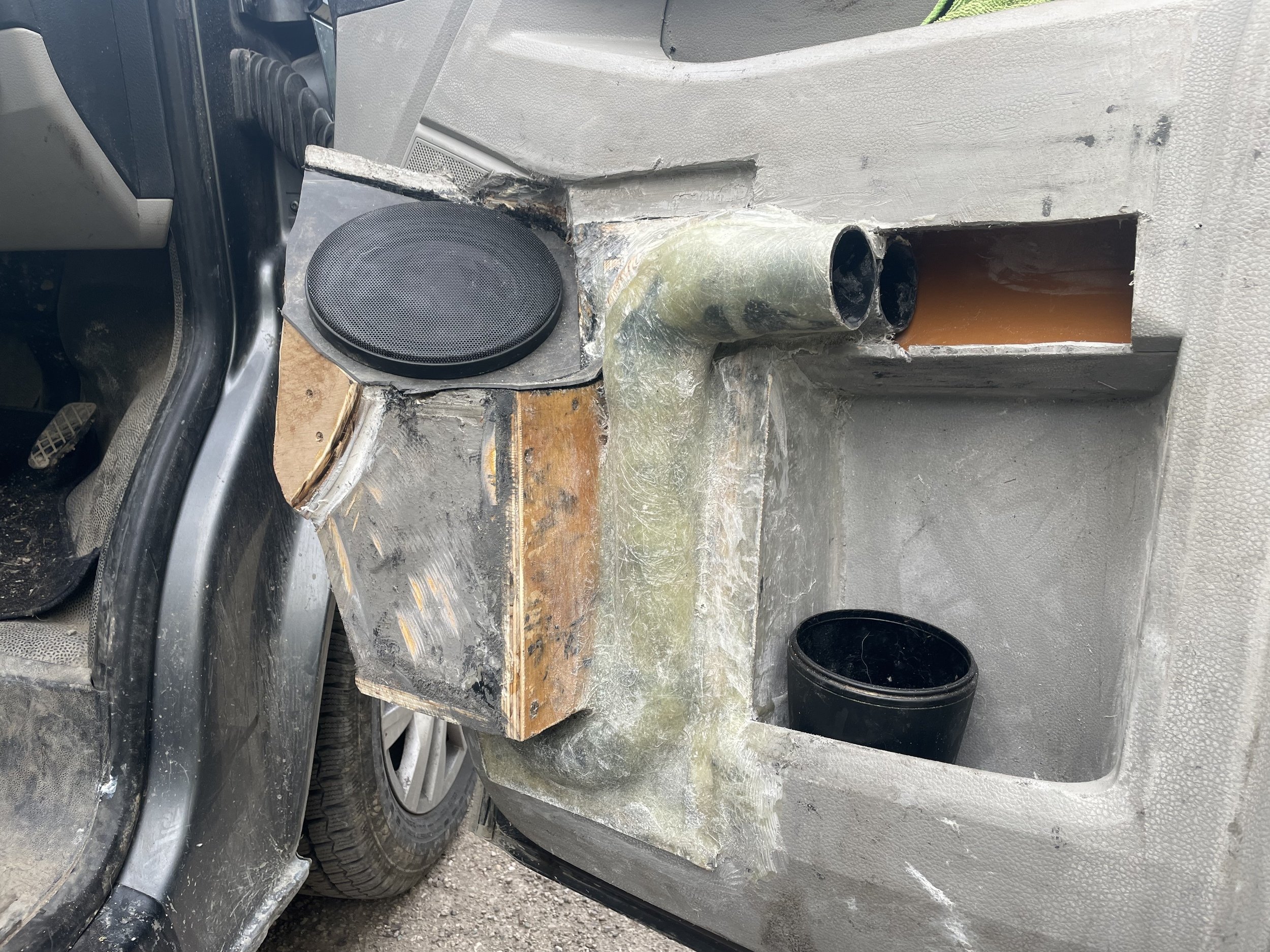

Frequency range coverage area of the sub is also now reduced as i have vent one midbass and plan to do the other today (not sure how to make pretty yet 🤣)

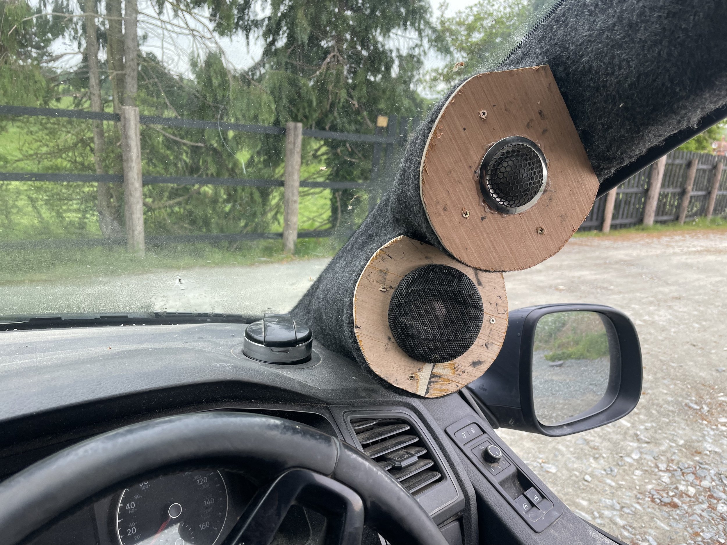

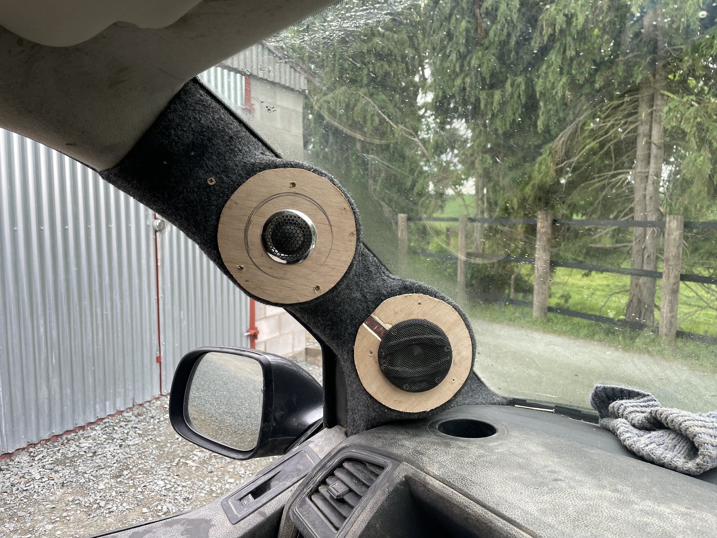

Where are you putting your mids and tweets?
What a huge difference redoing the front end has made, especially porting the mid bass enclosures. So much so that I could almost live without a sub now 😉. I have depth to the music is the only way I can describe it 🙂
Time finally now to work on the sub, both winisd and bassbox pro have recommended a super large box (winisd 6 cubic feet, bassbox pro 4.5 cubic feet). As bassbox pro has served so well on the mid bass, I’m going to follow that size.
Which makes the box roughly 1650 x 406 x409mm and an external vent very roughly of 2m at 55 inch area
