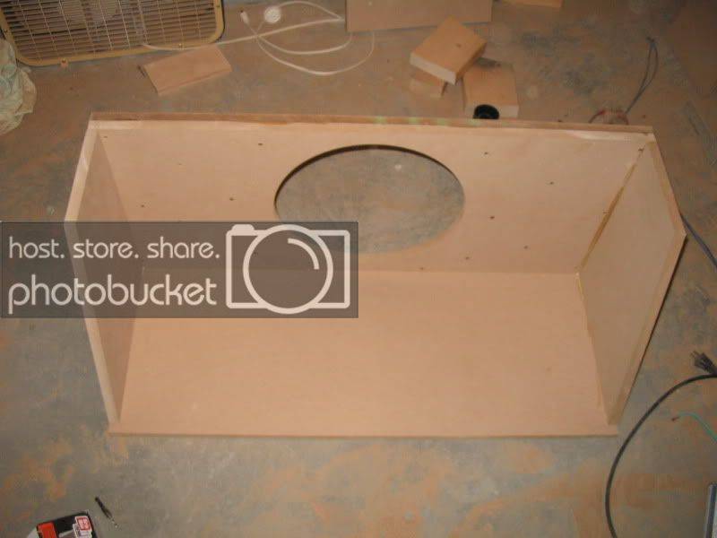

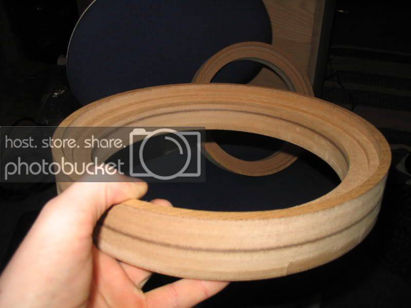

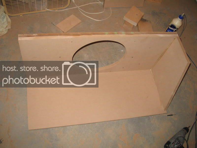

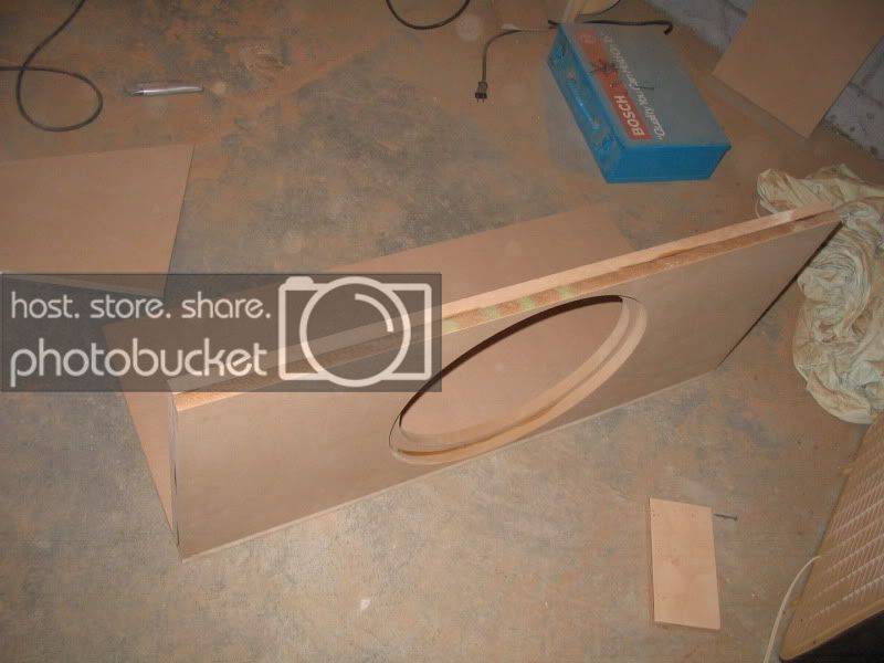

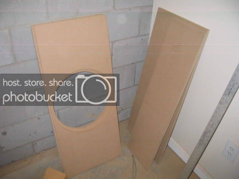

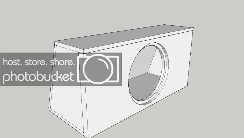

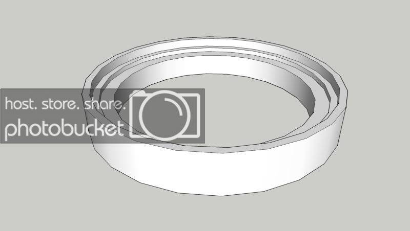

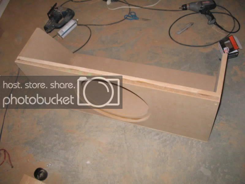

this enclosure is part of a trade he and i are doing. its for his custom PSI audiomobile mass 15. it is flush mounted and comes to 3.77 cubes before sub displacement. i am also doing a set of speaker baffle for some 8"s that i cut on the cnc router. here are the designs...
more to come so stay posted

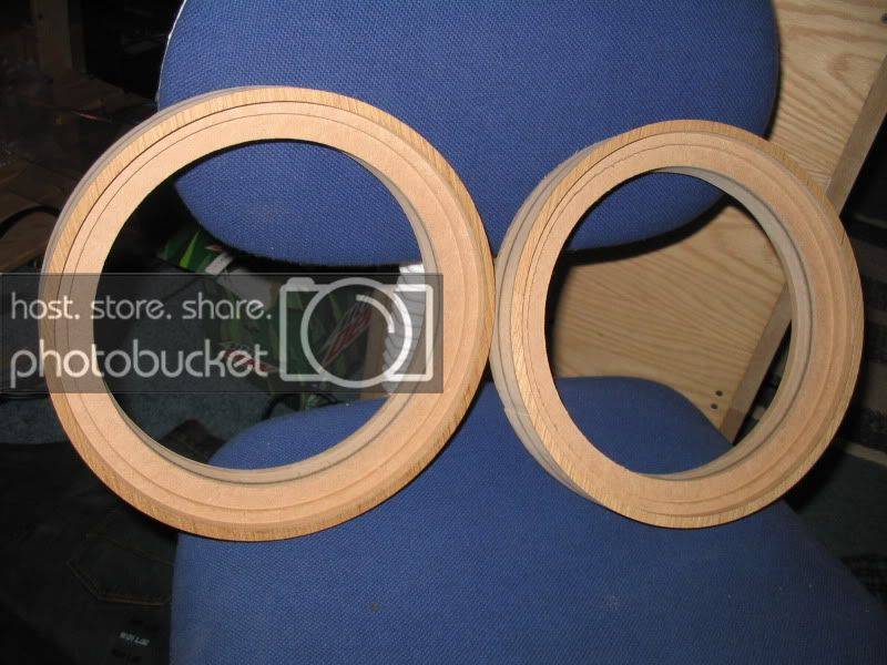

for this box I did it the old fashioned way. It really just depends on the work load for the router. right now were pretty backed up so I have to squeze your rings in today
**** i coulda cut it faster using my router lol. nice to have cnc tho.
meh idk about that. it took so long because i told the machine to pocket all the depth cuts and i put too many finish cuts where it only takes off .02 inches. try doing that with a hand held router lol.
I bet i can make some look exactly the same in less time with hand router //content.invisioncic.com/y282845/emoticons/smile.gif.1ebc41e1811405b213edfc4622c41e27.gif Wanna bet? ill record me doing some LMAO.. But i wish i had access to a CNC machine. Nice work man.
i bet it would look the same but it wouldnt be as accurate lol. idk id like to see you do it in 8 mins with the design i did. youd have to make multiple passes and change out the hole on the jasper jig. idk if you could do it in 8 mins but idk. but thanks. it was actually my teacher who said there wasnt a fater way
I was hoping something more fancy w/ the rings. Nothing a jasper jig on a plunge router can't do.
true ha i just didnt want to make the dust in my basement. i can get some pics of the much more complicated things ive done with it
