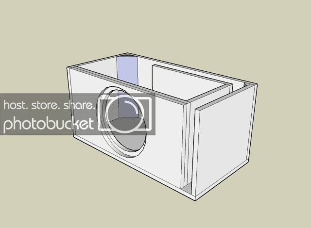

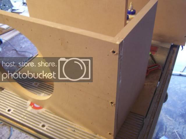

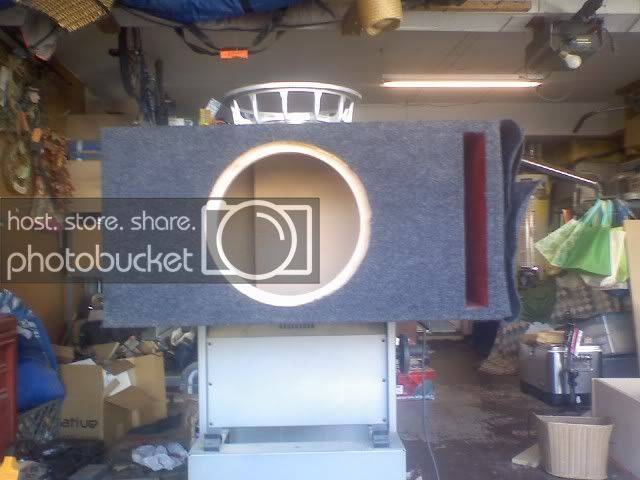

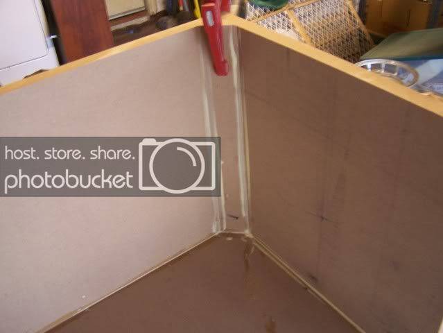

Alright box is for a 12" RF HX PUNCH 2212. great older driver with awesome ported box capabilities!
Was trying to achieve 2.5ft^3 but will settle for a little less.
Box is 2.2ft^3 @ 30hz after all displacement with 27in^2 of port //content.invisioncic.com/y282845/emoticons/cool.gif.3bcaf8f141236c00f8044d07150e34f7.gif
Design here:
build will start today and tom.

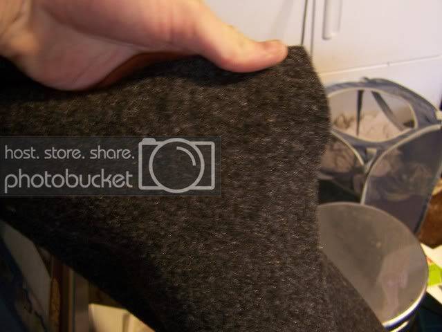

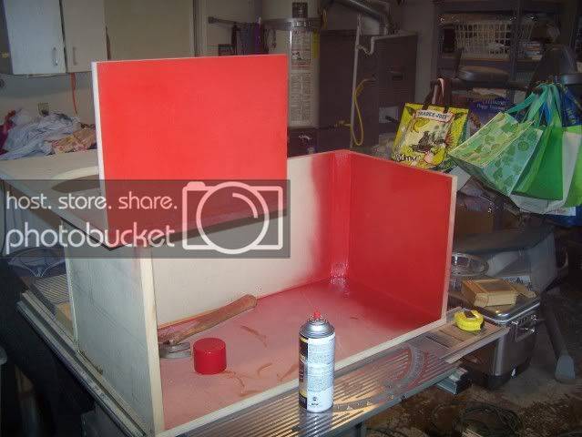

Charcoal Grey Carpet with a red port

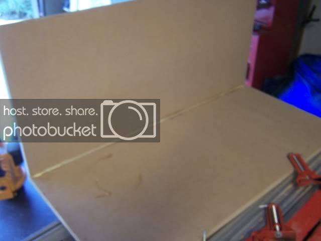

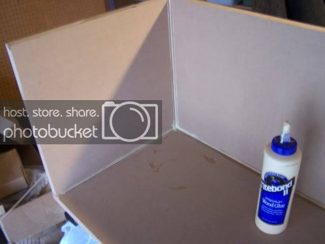

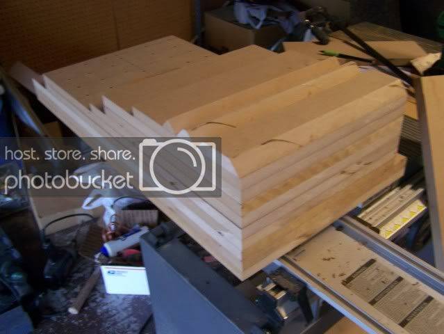

Pics:
new pics up. had to stop roof had a major leak i had to attend to //content.invisioncic.com/y282845/emoticons/crying.gif.ec0ebefe590df0251476573bc49e46d8.gif
