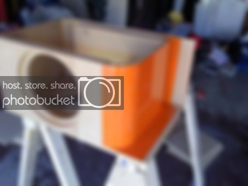

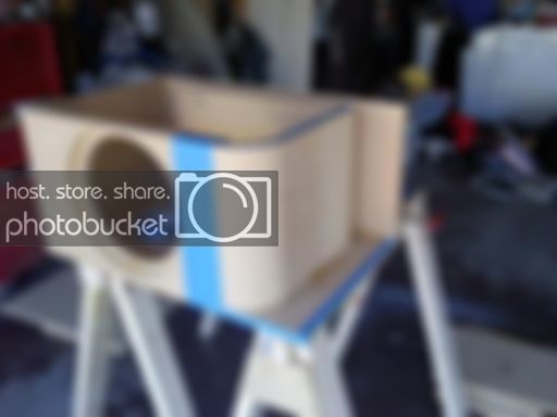

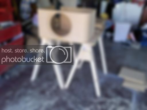

Box is for an eclipse 3hp. 2.25ft^3 @ 32hz with 32.5in^2 of port
Will be carpeted black. not to many pictures as well sorry lol
the back is on!
after sanding from 100, 200, 400, then 1000, primer then sand again then paint let dry a port should come out glossy like this:
more to come tom. finished up

nice sawhorses!//content.invisioncic.com/y282845/emoticons/wink.gif.608e3ea05f1a9f98611af0861652f8fb.gif
lol thanks. got tired of building on my table saw to went and snagged 4 studs and whipped them together. took like 40 minutes and all lol
