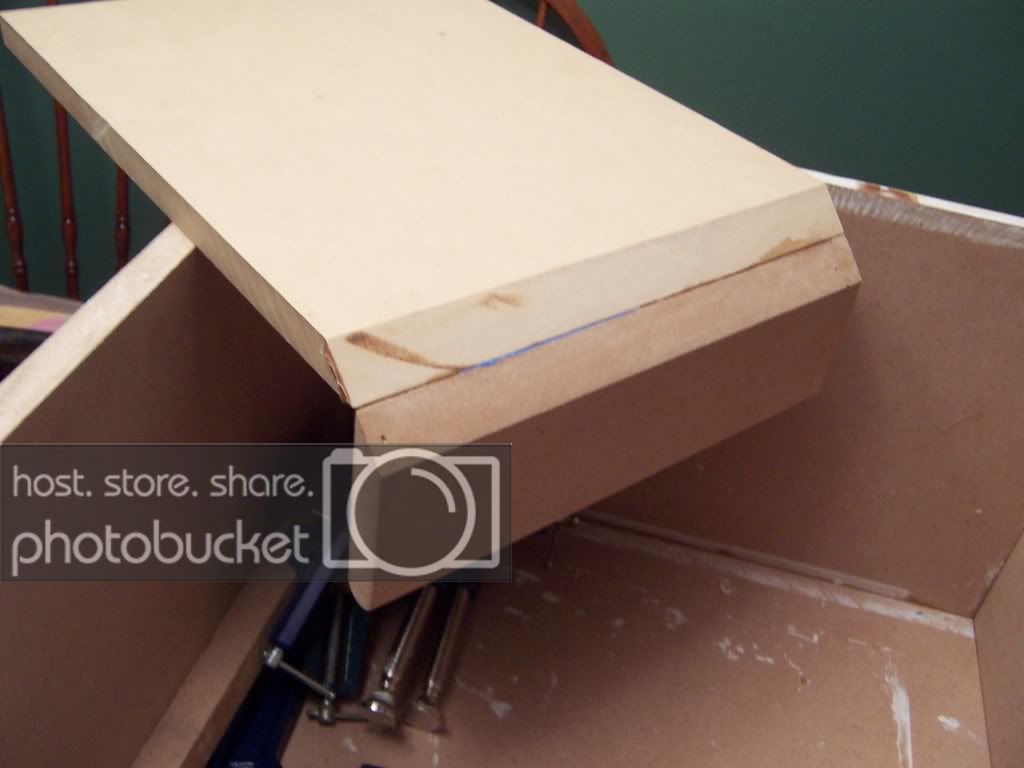

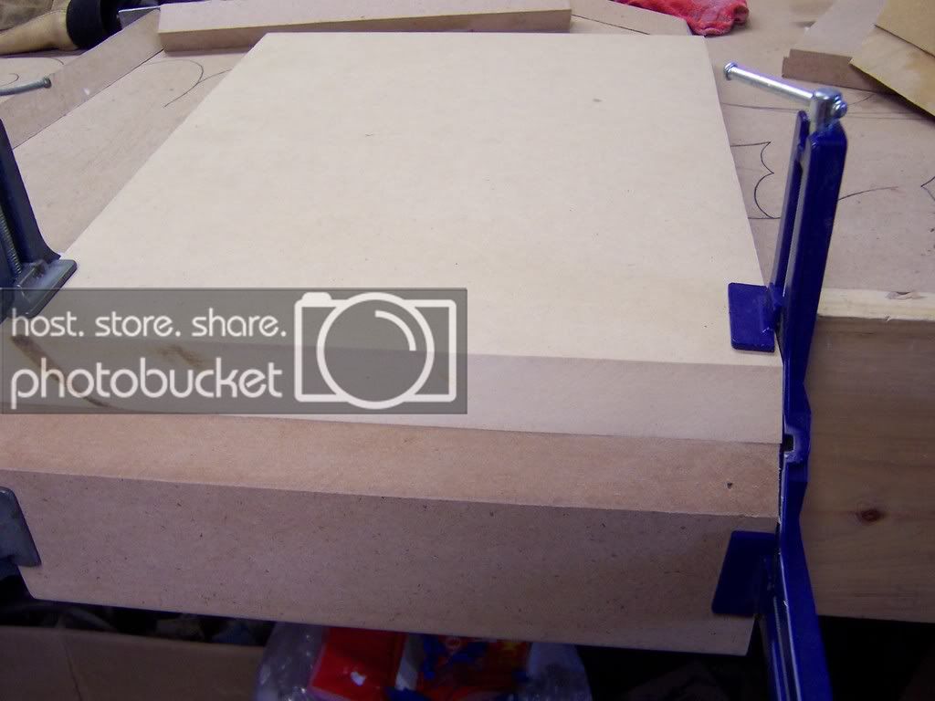

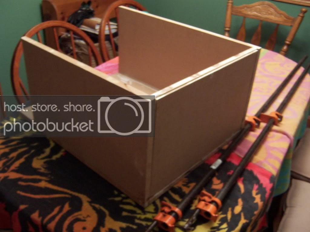

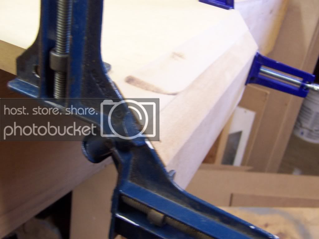

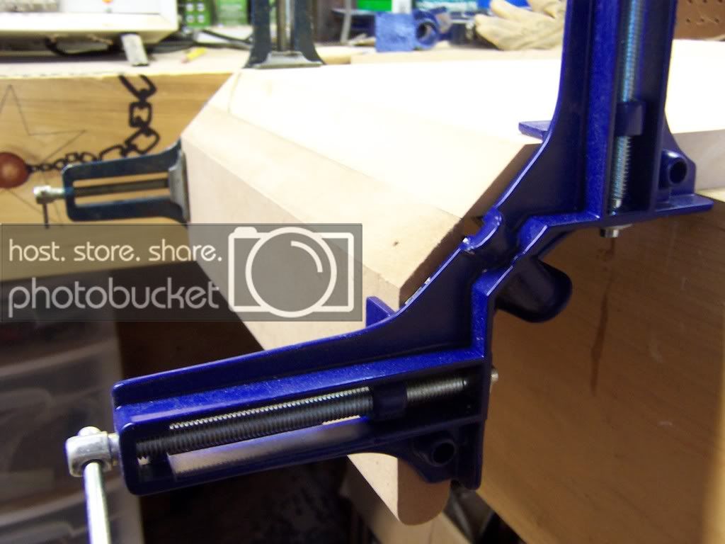

As explained below, screws and brads do nothing but hold the plates together while they dry. Hence the reason the clamps stay on overnight. Glue without screws is fine, screws without glue is fail. Believe me, the MDF is going to break/tear/split before the glue bond does. This has been explained many times, and on the previous page as well. It's a little frustrating to read comments like that not only when they have been explained already, but where this build is for a customer. If he didn't know better, this may cause him to question the quality of my work and/or the integrity of his box. I can assure, as many others will, the construction of this and my other boxes is plenty strong.
That being said, thank you very much for the compliments and I give you credit for working in the cold.. I'm assuming you don't have a heated workspace either?
Thats why he has all those clamps on the box. Theyre doing the same thing as the screws do until its dried.
Thanks for clearing that up.

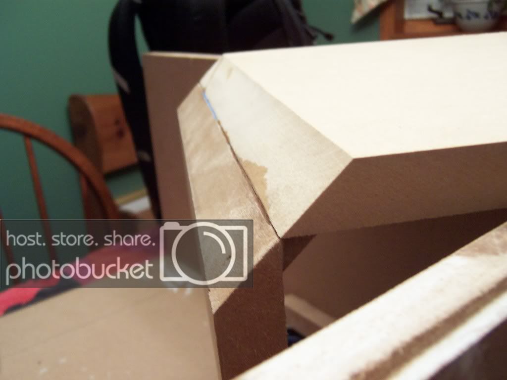

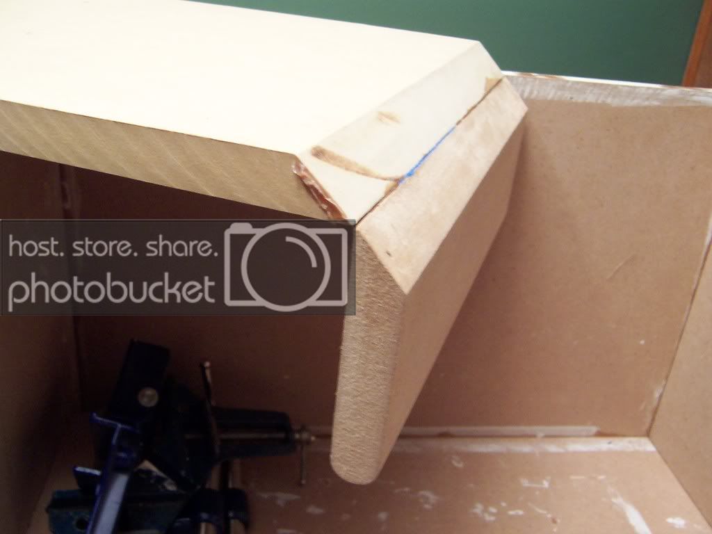

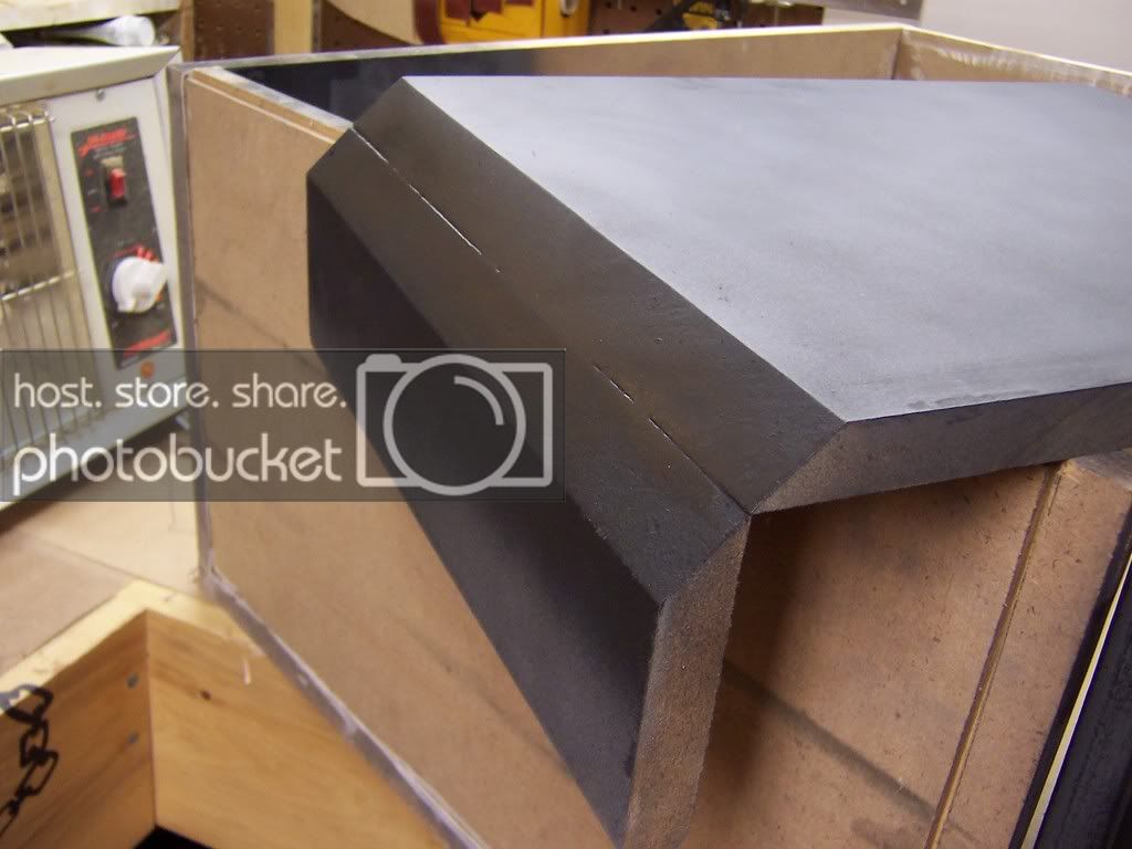

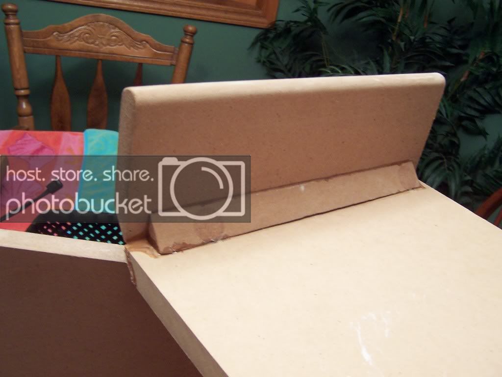

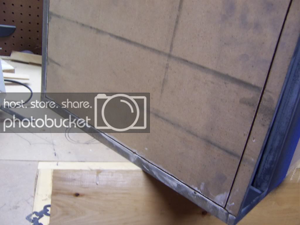

Here's a few more after she was de-clamped
Good work like always, Wasted.

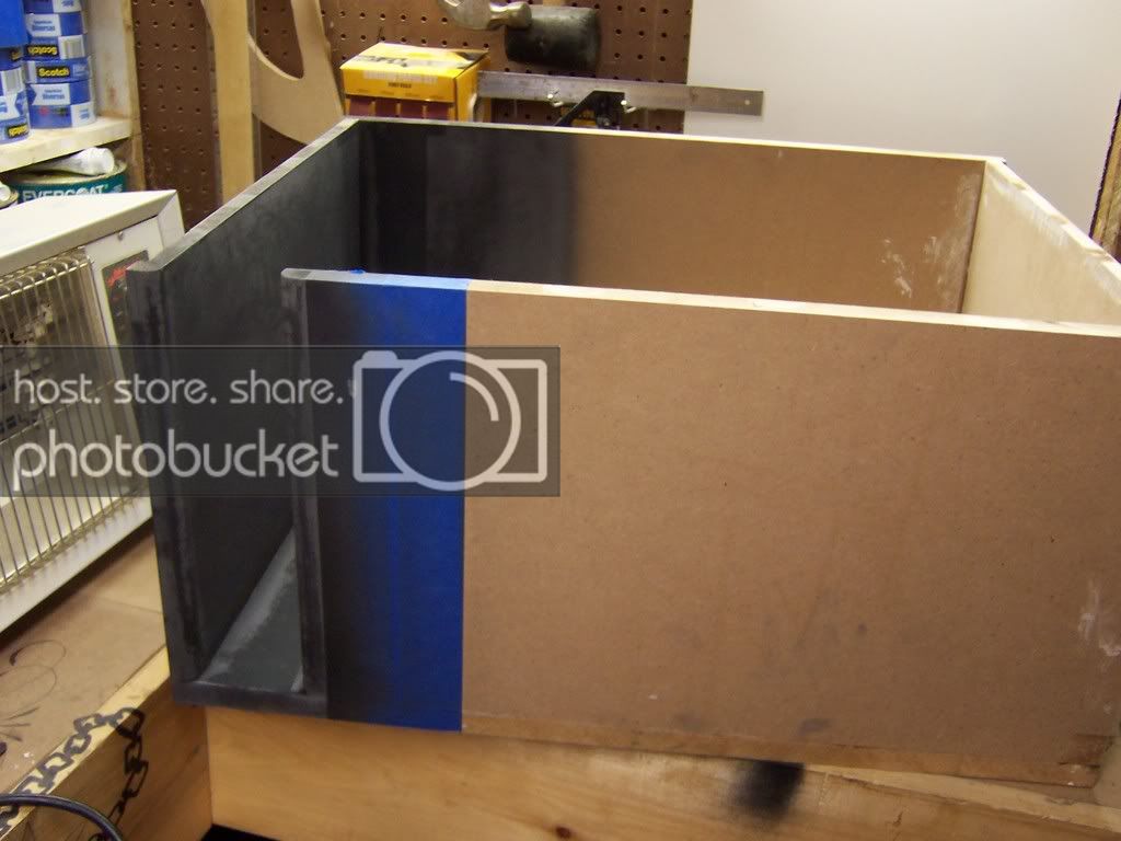

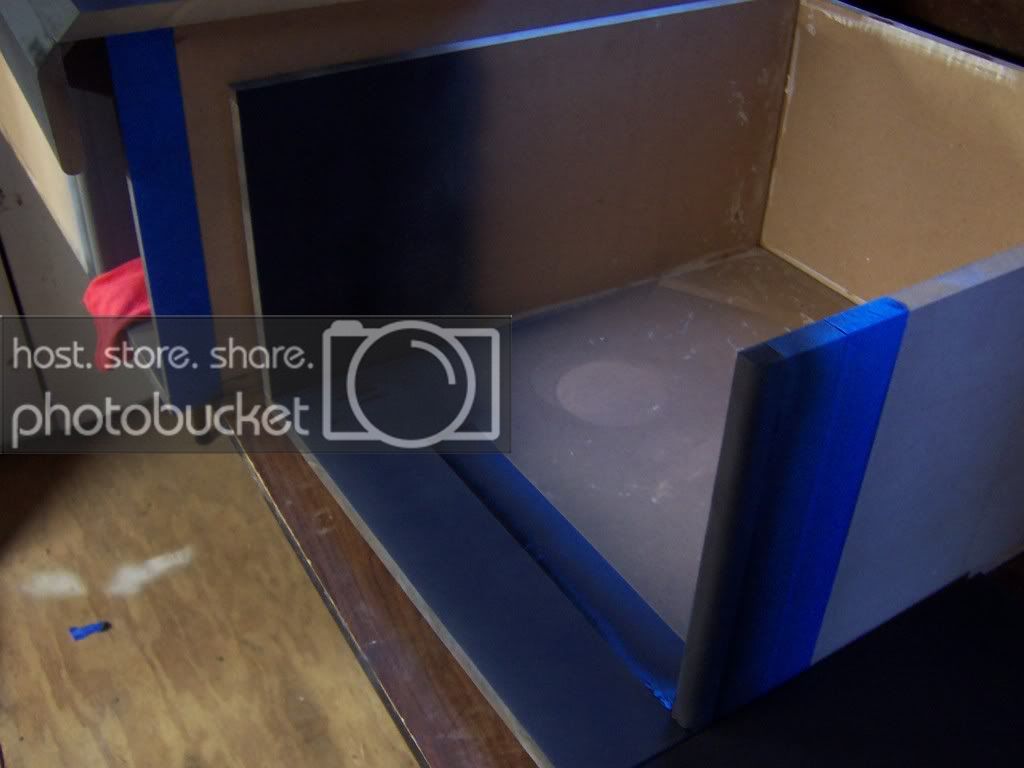

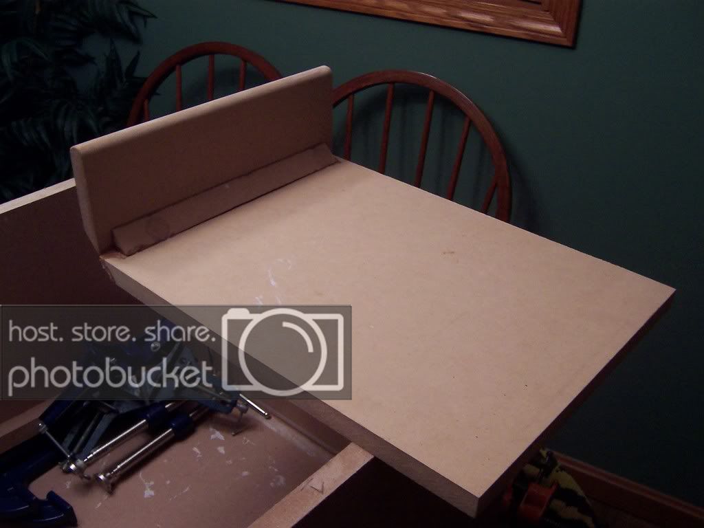

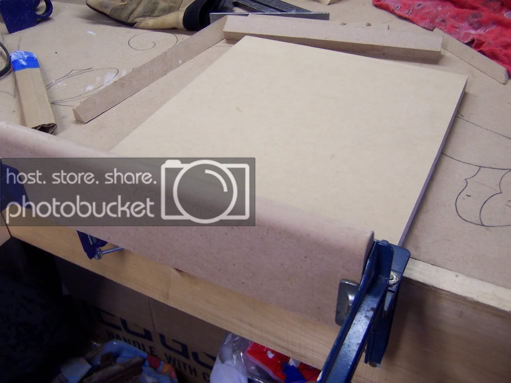

Got the port assembled.. It's now glued/clamped and drying, but my camera died so this is it for now. Sorry for the bad pics //content.invisioncic.com/y282845/emoticons/crap.gif.7f4dd41e3e9b23fbd170a1ee6f65cecc.gif
