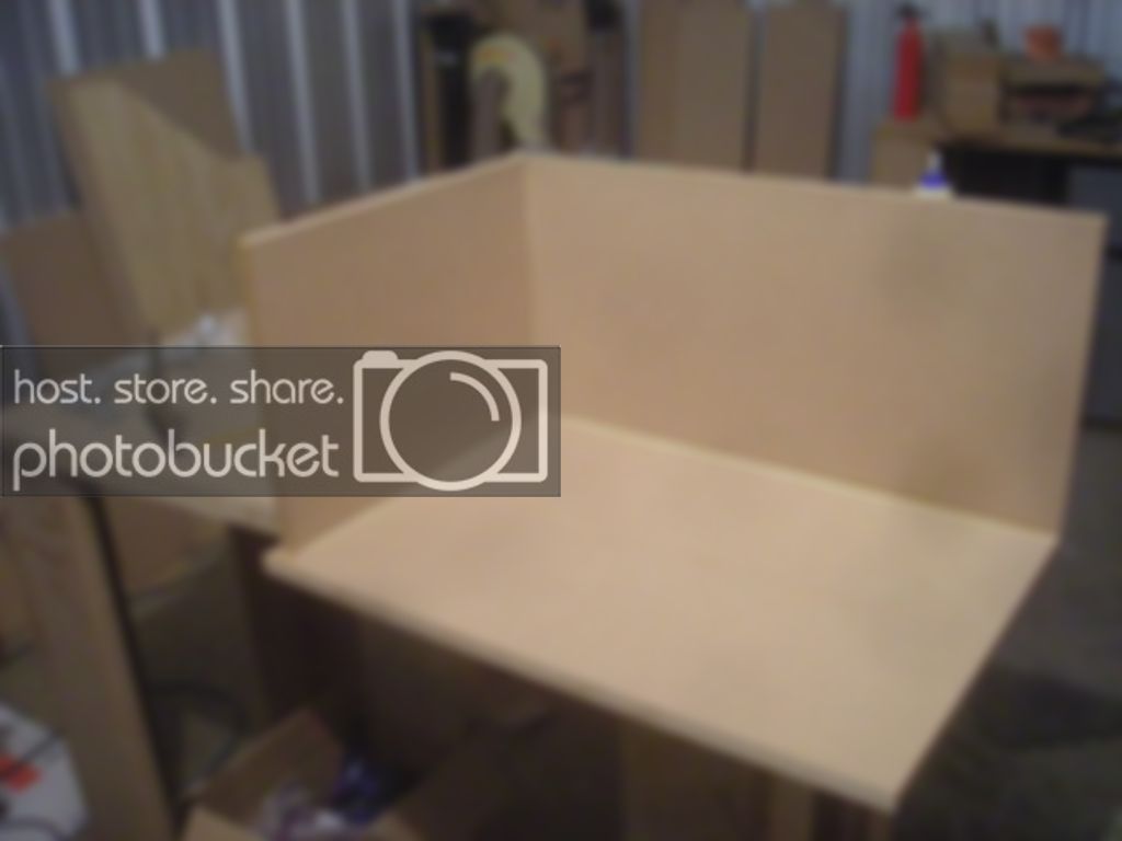

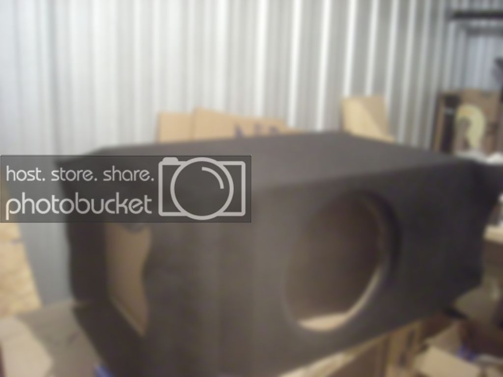

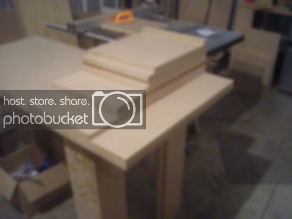

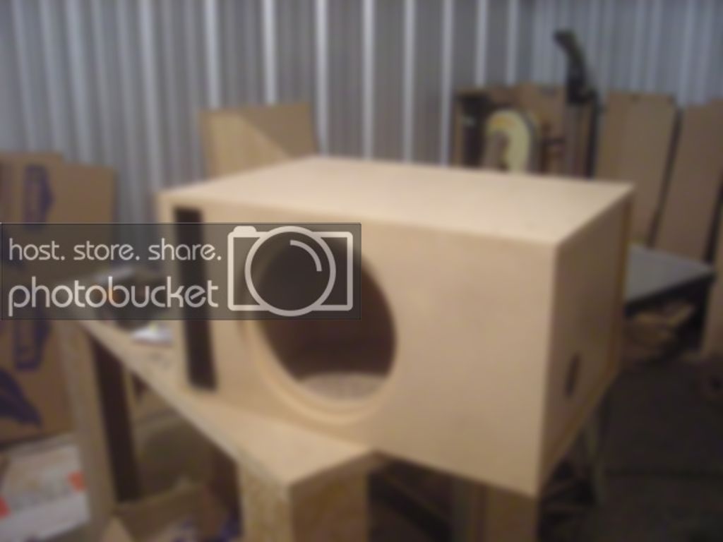

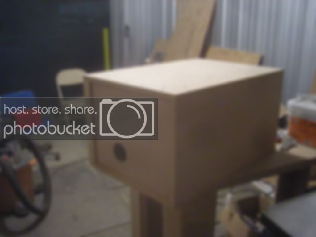

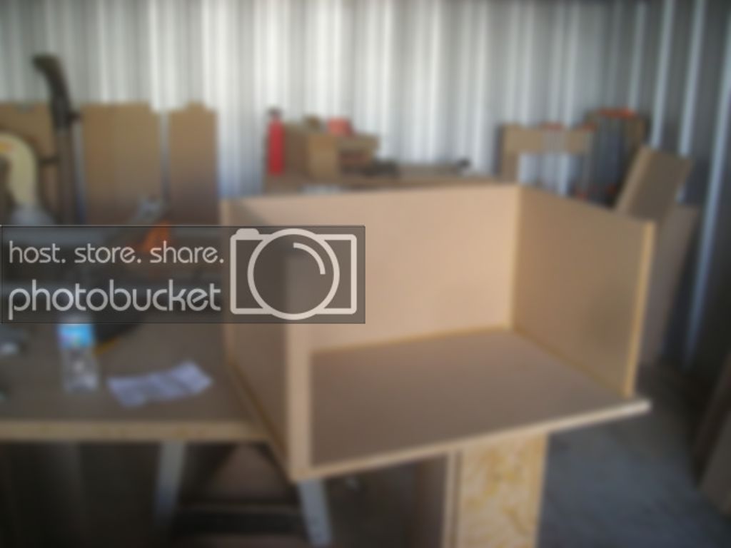

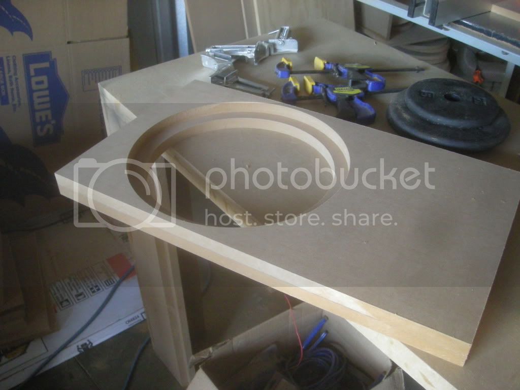

Alright, this enclosure will be for a local buddy's 12" SSD.
Specs come to:
-2.195 cubes net
-33.5hz tuning
-37.125 sq inches of port area
Getting started..
