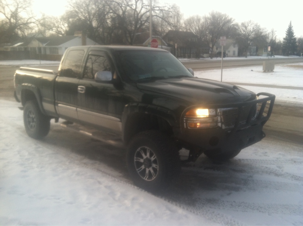

Vehicle in question is 04 GMC Sierra stock alt. knu 1/0 big 3 and single run to amp... Amp is orion xtr 2200 batt is xs power d3100 or 3400 can't remember picking truck up tomorrow from having ****** rebuilt

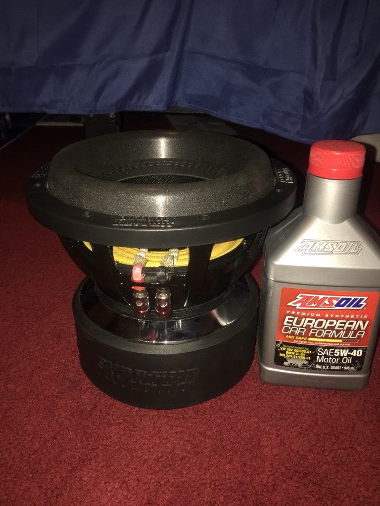

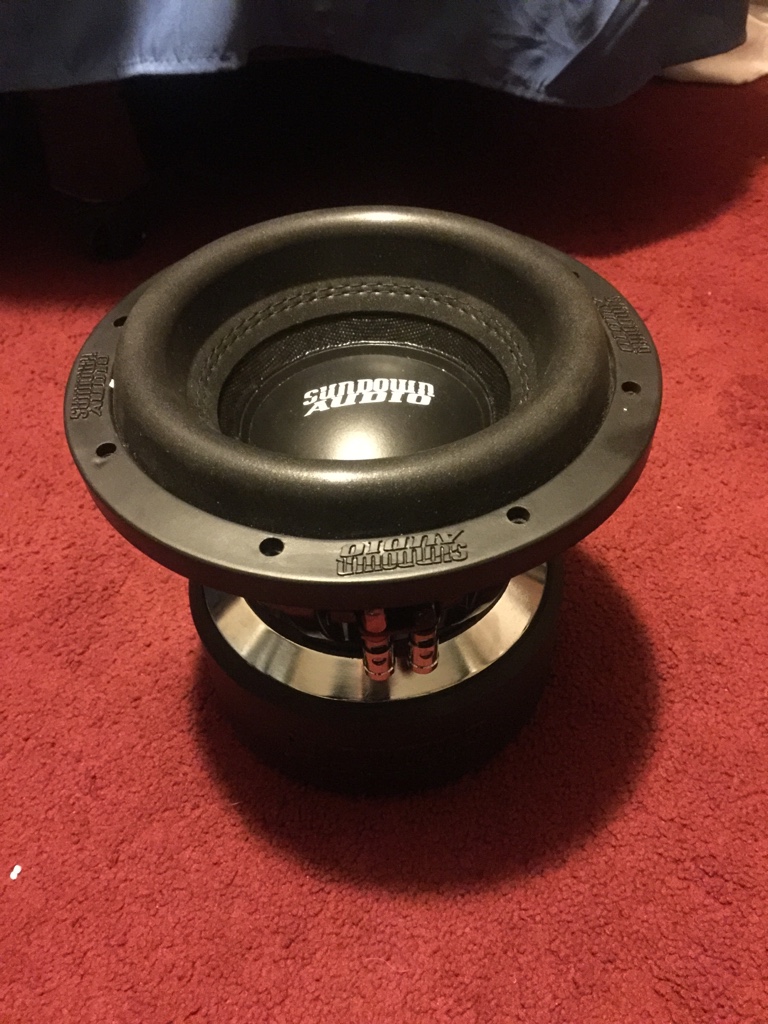

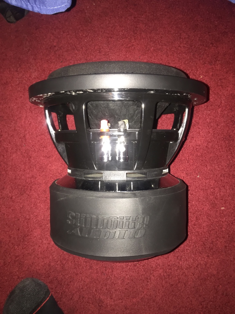

Had amp running 2 ohm around 1500rms par Orion's claims... Was getting some serious voltage drop even at speeds... Now those subs are gone with 2in seat lift soon to go in(if machinist has them done yet) gonna have stang custom build box for 2 sundown x 8's with Baltic and a etched plexi lid or side... intentions of running 1 ohm...
