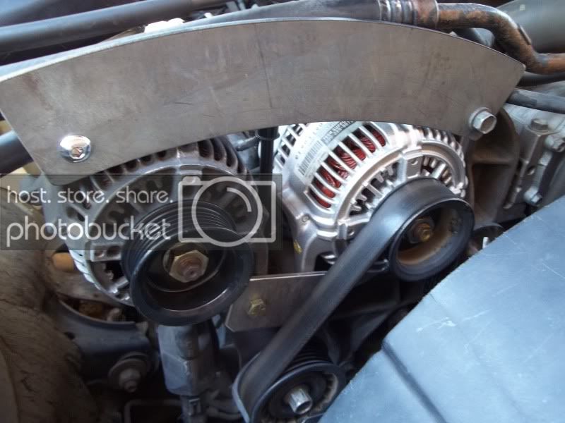

since im the tight *** that i am, instead of buying one high output alt i went ahead and bought a second standard 120 AMP alt for my 93 dakota. made brackets and have them both mounted, only problem now is that these things are externally regulated. and supposedly originally the one alternator is regulated through my computer? not one on my firewall... so what are my options with this second alt? any way to make in internally regulated, or can i buy a regulator and hook it up? only problem is they dont mention what voltage they regulate at, just say if it fits your vehicle or not. any suggestions to make this second alt work?

how did you make the brackets??
still have to paint them and what not. and have a couple modifications to make, but thats pretty much all they are...
