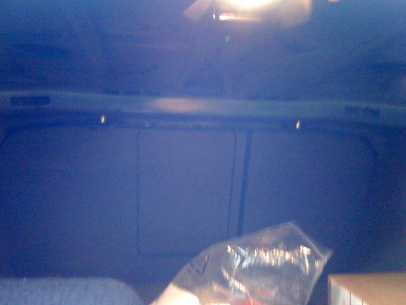

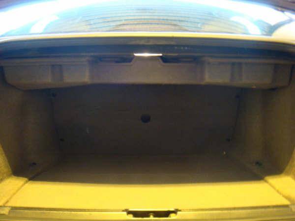

The trunk with stock subwoofer enclosure:
After I removed it:

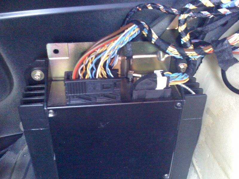

Stock DSP Amp:

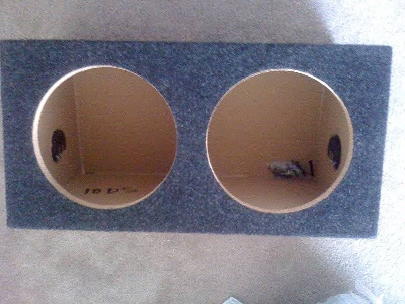

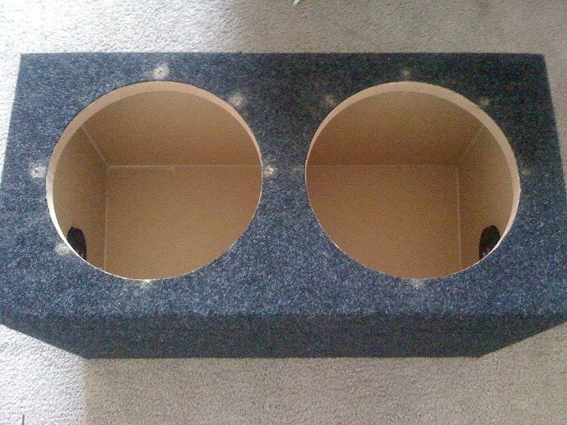

Box:
Drilled //content.invisioncic.com/y282845/emoticons/smile.gif.1ebc41e1811405b213edfc4622c41e27.gif :

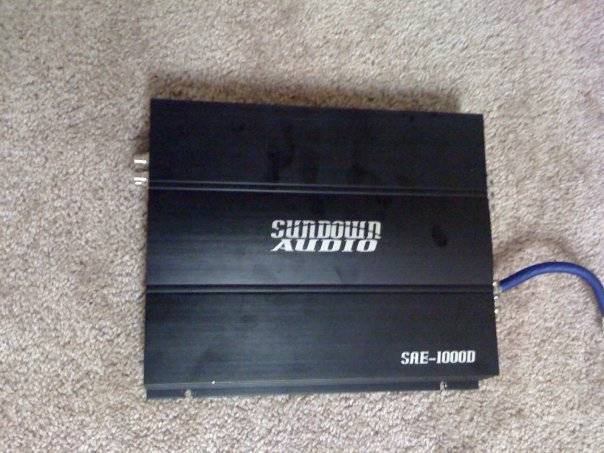

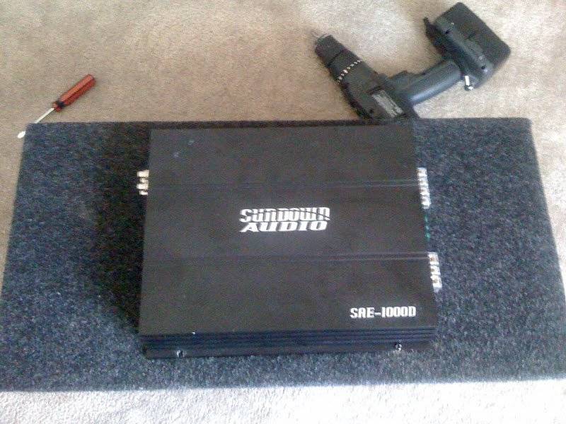

Amp Mounted:

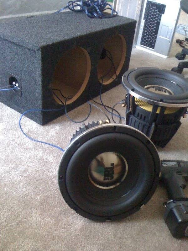

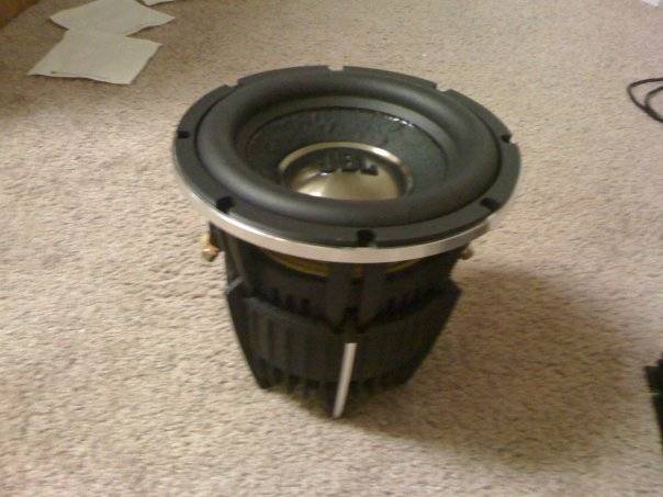

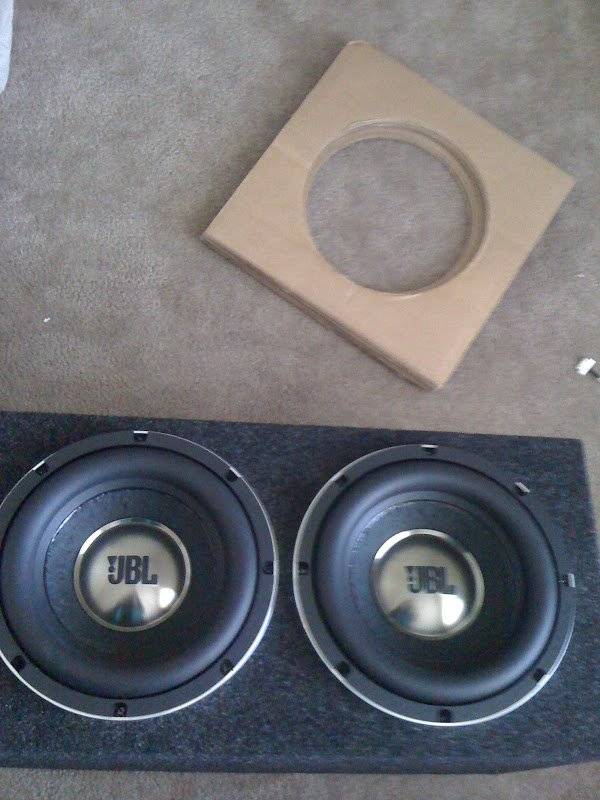

Subs Wired - In parallel to 1.5 ohm(They're dual 6):

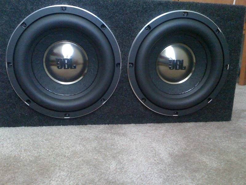

Both in:

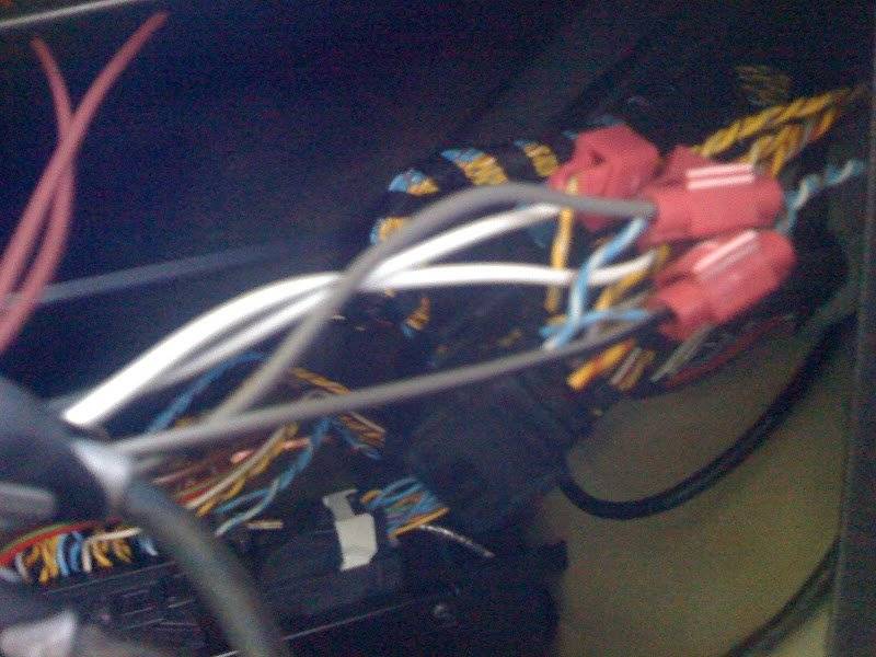

Tapped into the the wires from the harness that was disconnected from the stock subwoofers:

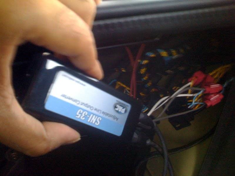

The LOC hooked up:

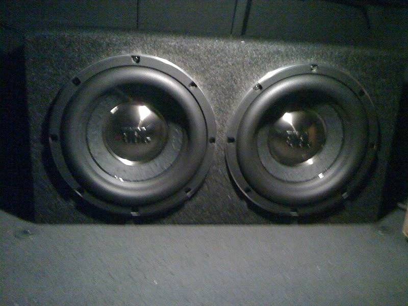

All finished and done. The subs look sexy //content.invisioncic.com/y282845/emoticons/cool.gif.3bcaf8f141236c00f8044d07150e34f7.gif :
I'll be posting up some vids tomorrow. They sound wonderful. The gain is set to 1/4 currently and I have ample bass. Will run some test tones tomorrow and set the gains properly. The lows are so good. Thank you JBL //content.invisioncic.com/y282845/emoticons/biggrin.gif.d71a5d36fcbab170f2364c9f2e3946cb.gif. I've been coveting these subs for quite some time and they did not disappoint me 1 bit.
