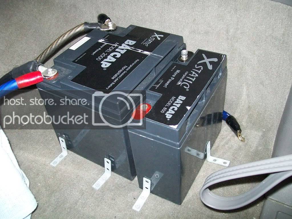

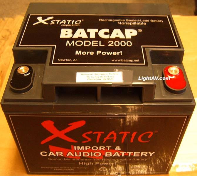

I have a couple of possible issues. The batcaps terminals are like set in, which means I would have to bend the bus bars to be able fit them down in the terminal. You see what I'm saying?
then use short 1/0 pieces. i'm not familiar at all w/ batcap
edit: yes. go with that.
hold up...
inset like this?
just turn them to face each other and bolt that shit up.
edit, that wouldn't work. they would be on opposite sides //content.invisioncic.com/y282845/emoticons/crap.gif.7f4dd41e3e9b23fbd170a1ee6f65cecc.gif
looking at that, could you not use a bit longer bolt with washers to compensate and just go right over the top of them?
like this:
bolt -> bus bar -> washers (to fill the gap) -> batcap.
like this:
Ya I guess I could. I just haven't messed around with it yet. I'm just thinking, it would be best to use copper materials, right?
