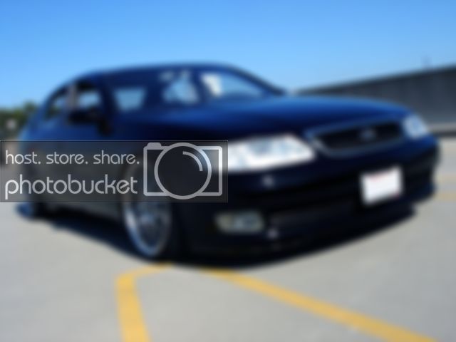

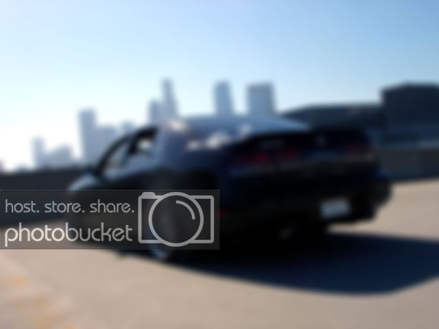

Just for kicks, this is an example of what your car SHOULD look like...
Wheel specs: 235/35 on 19x9.5 (w/ spacer) +24 & 245/35 on 19x10.5 +19
Little fender work can squeeze 265s or even 275s in the rear //content.invisioncic.com/y282845/emoticons/wink.gif.608e3ea05f1a9f98611af0861652f8fb.gif
and ah... how has the camber been corrected on that? or hasn't it been?
I'm sure its a modest amount...Camber wear isn't really as bad as people say it us SO LONG as your other alignment specs (specifically toe) are in order //content.invisioncic.com/y282845/emoticons/cool.gif.3bcaf8f141236c00f8044d07150e34f7.gif
that car, would have neg 3 degrees of camber, with the adjustment maxed out, and no traction whatsoever.
camber wear isn't the problem here... traction is...
It was only an example, a less aggressive offset could be used, be flush with the fender (in turn widening your track, hint hint), and still be at an acceptable camber (-1 to -2 is nothing). One point of running wheels that are flush is to use your car to its full potential, not just for looks. Think about it, why do you think a lot of professionally driven performance cars have fender flares? Example:
the camber isn't because of the width, or offsets, its because the car is dumped on its *** :s
There are a lot of adjustable after market parts that can correct camber problems easily, theres a lot more to suspension then just struts/springs and coilovers. You have a lot to learn my friend //content.invisioncic.com/y282845/emoticons/smile.gif.1ebc41e1811405b213edfc4622c41e27.gif
