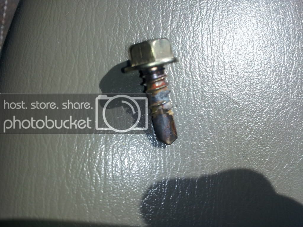

I think I found the culprit
Is this the result of a loose ground screw/low voltage? or high current pull
I replaced it with a longer screw, but I'm worried it still kind of moves when I try to move it, is there a way to make it more secure? be it redo it using loctite or finding a nut to fit the screw and try it that way or something.
