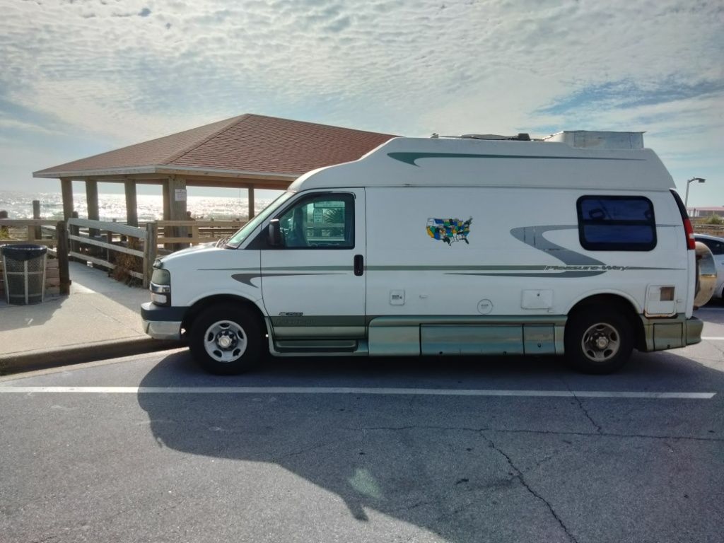

Oh, it is an RV. Well, if the radio inline switch does not work, then you will be on the hunt again.
technically it is a RV van however everything being disscussed here are all GM van related.
just bc the van has kitchen/bathroom plumbing ect. has virtualy nothing to do w/ this radio issue.

It should not, but sometimes it happens. I repaired an American Eagle motorhome that had battery drain/charging issues. It turned out the converter had gone bad and was using the starting battery as well. Owner bought a new converter charger and I repaired the computer in the battery compartment. TBH I have no idea how I figured it out since I had never fixed something like that.

this is a very cool vehicle it's like a small home on wheels.
yes it's an absolute to isolate the start from the house batterys.I recommend the victronics they are the best.
how it works is when the start batt. is at or above 12.3VDC then the vans alts sends a charge to the house batt. theres a keyed switch which must be on to 1.turn on house power an 2. allows alt to send charge to house.
eventually I'd like to have more than one house batt. and a 4th charge option DC to DC charger.
current charge options
1.alt.
2.shore power
3.genterator
4.DC to DC
problem is I don't use it as a RV just a 2nd vehicle & tow vehicle for my small yacht.
