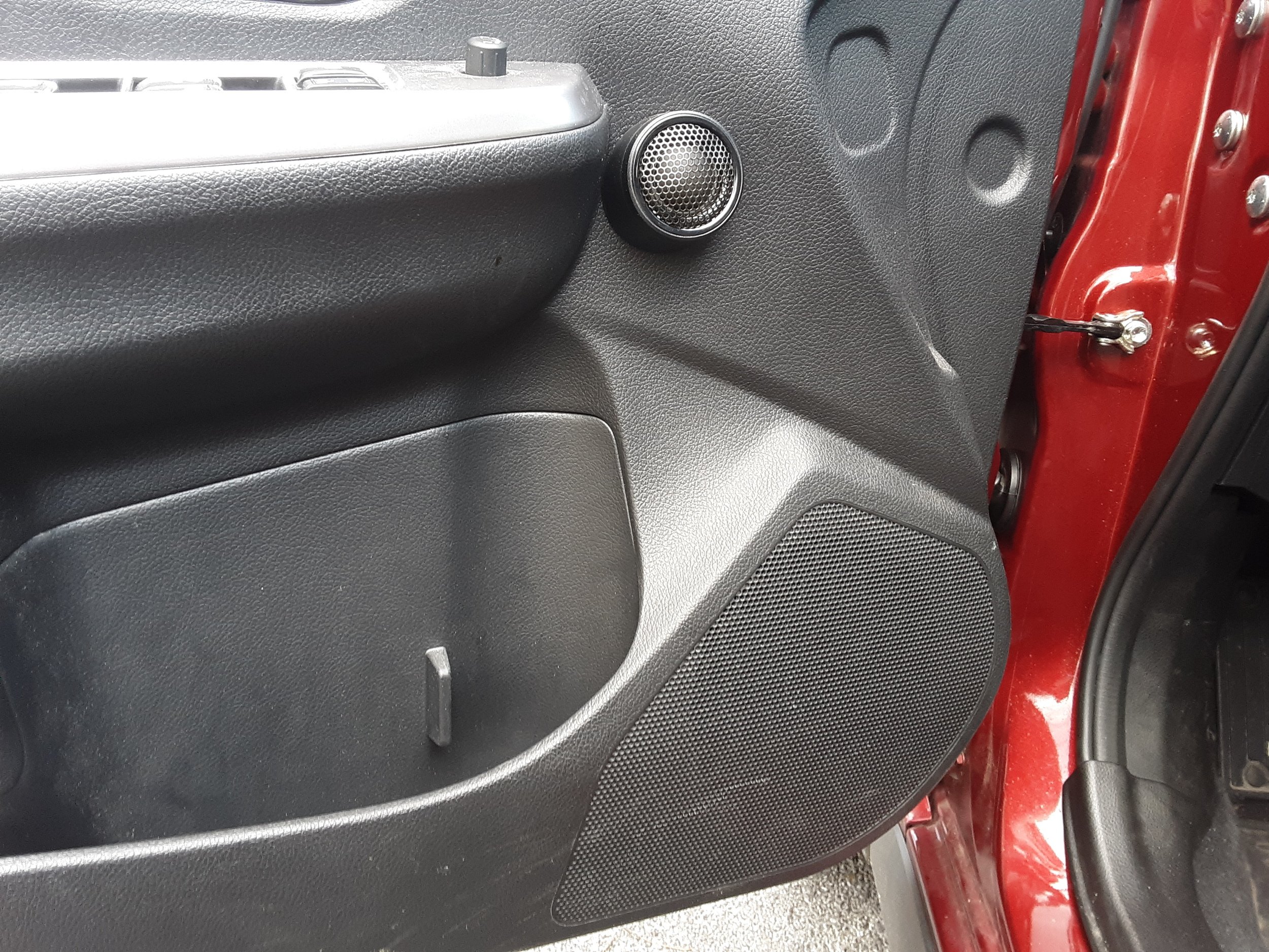

like that you went three way instead of cramming bullshit3.5’s in that dash Spot. Hopefully the distribution of midbass to that speaker isn’t so much that it rattles your front panel. If so I’m sure some sound treatment can fix it. Also 600 wattson deck for that sub is rad.

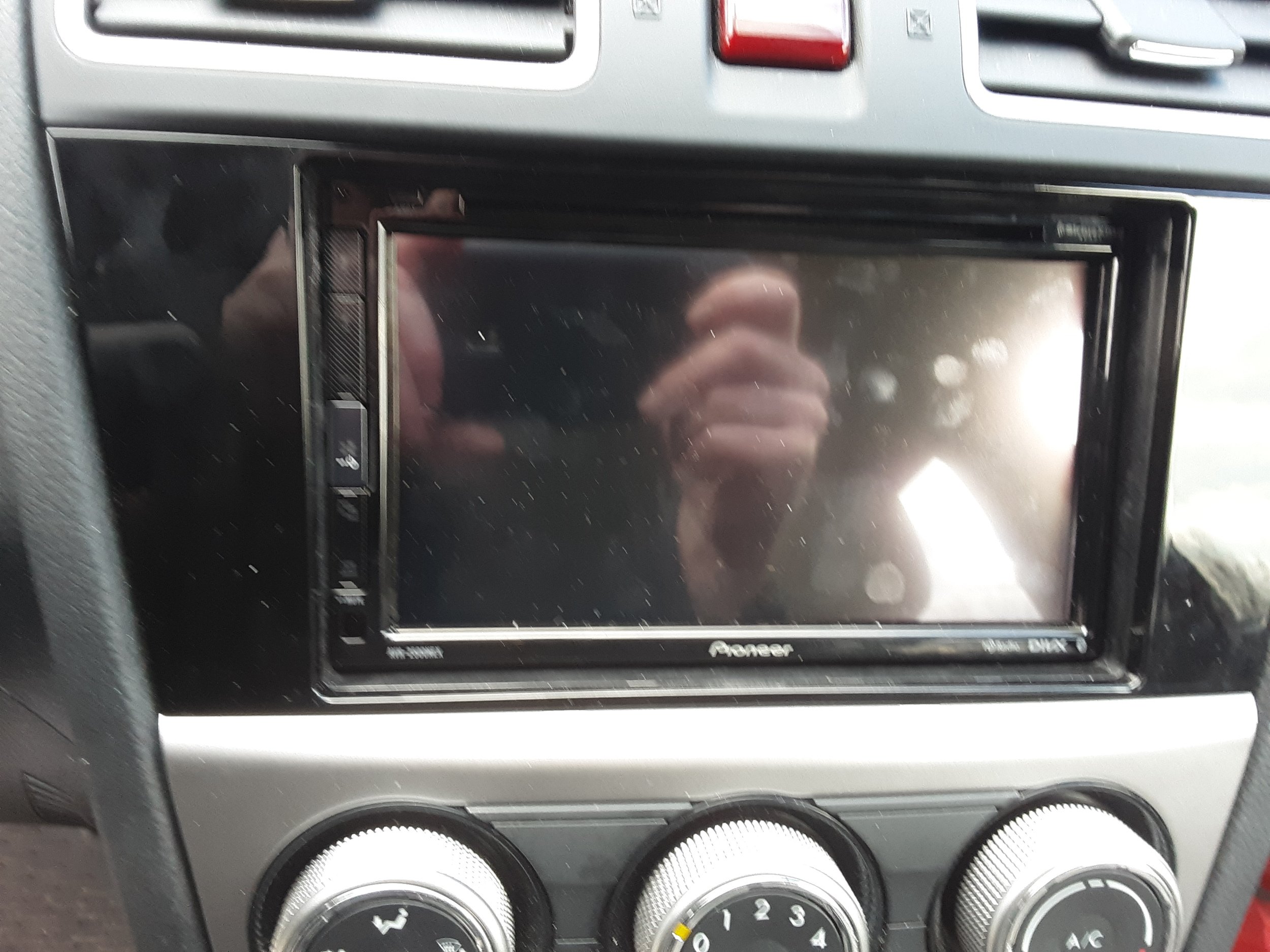

Also, gotta have the CD, I dont know where I dropped the ball on that one. I dont think I ever processed that the 2600 didnt have DVD until I was on the Pioneer website.

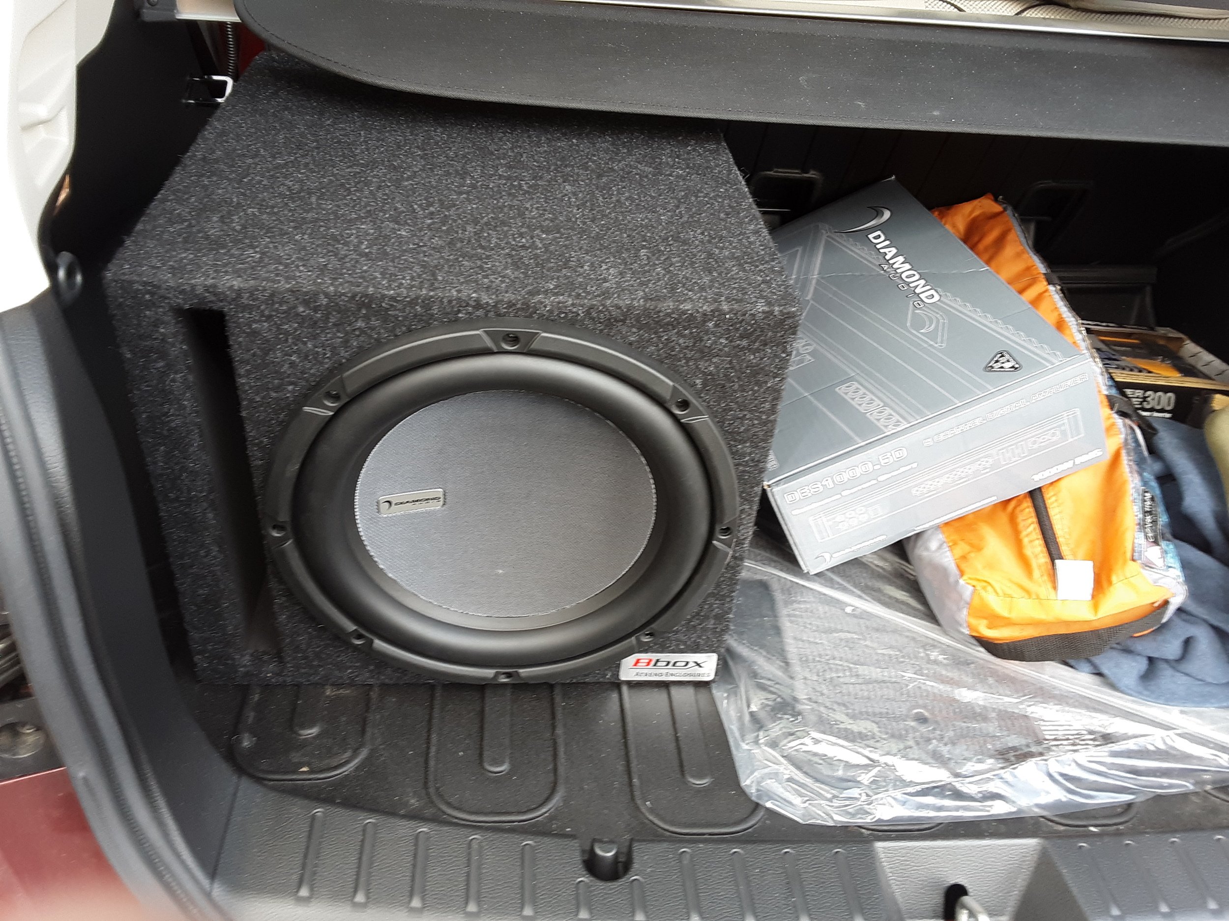

Keep the sub in the back, you’ll benefit from it firing off that back hatch then to you. Ask you installer to soundtreat your rear hatch door.

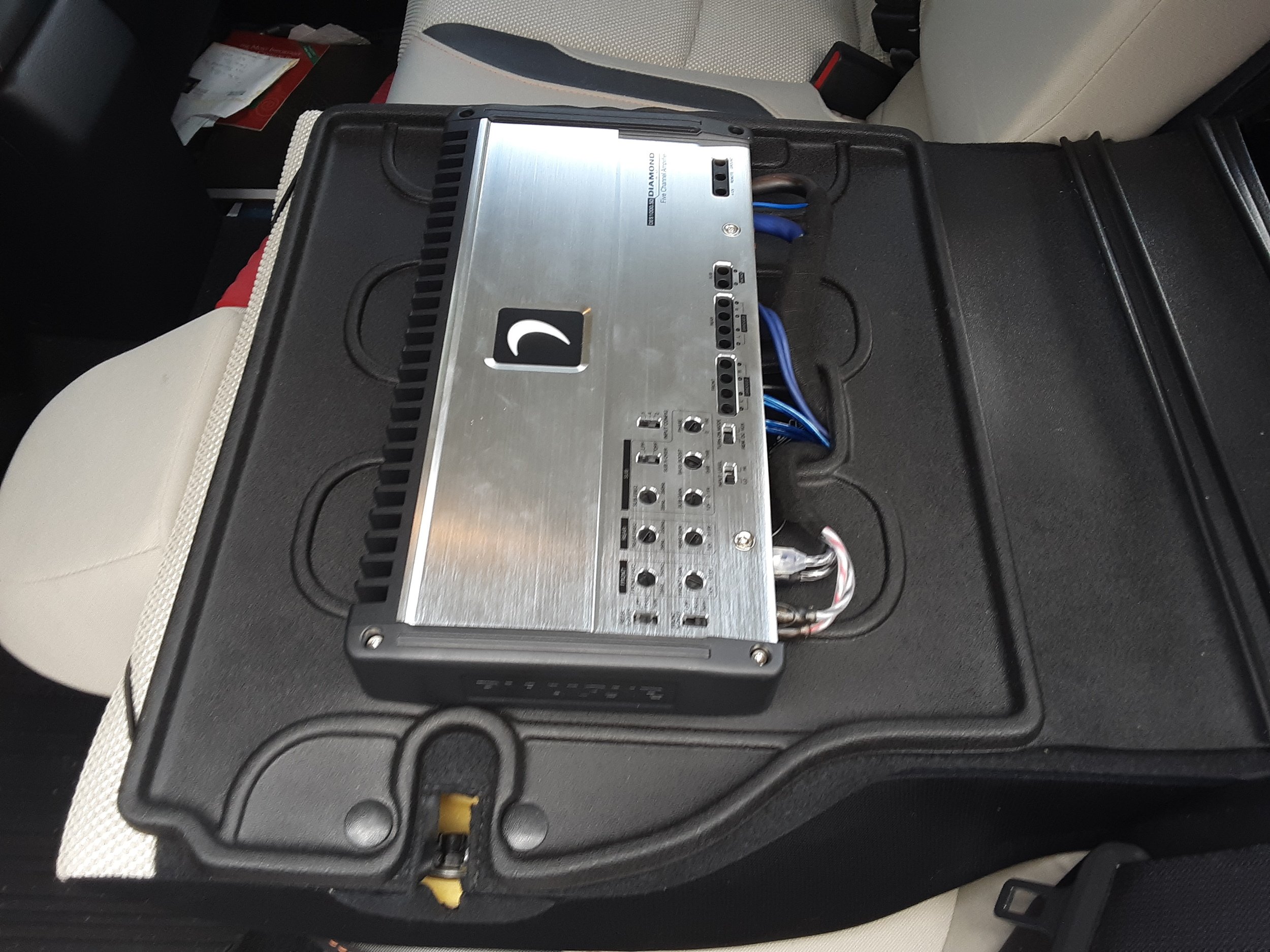

Hi folks, just an update, my system was installed yesterday. Very clean install, no buzzing or rattling anywhere.

Anyways, I dont remember all the model #s (they're in my last post here on the build), but:
HU: Pioneer 2500
Front/Dash: Sony 3-Way
Rear: Disconnected
Amp: Diamond
Sub: Diamond

Oh and it sounds great. It can pump well more bass then I prefer personally, has a cool bass knob to adjust without having to navigate to the EQ. Even when bass is very loud, the mids and highs are not distorted and clear.

Yes, do away with the 3.5 in the dash. Mount your tweeter from your comp set in its place or have him put it in the sail panel or a pillar. Do away with the rear door speakers, save your money and who cares what your back seaters hear!!! Moving that tweeter higher up than the bottom of the door(coax) will significantly help your front stage. You can get an amazing sound with a comp set up front with plenty of power and a decent sub set up. If, in the future, you decide you want a little rear fill buy some coax and run them off your deck.
