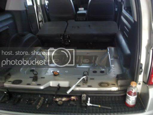

This is what I plan to put in my Explorer. 2 18" Fi BL's. Box is 44w x 44.75d x 20.5h. Approximately 6.5 cubic feet per chamber (thanks ram), tuned to 28 hz. 2 ports are 20.5 x 4.
That should KILL the lows. I'd love to meet up with ya and hear this! Too bad I'm ~3 1/2 hours away... But maybe someday I'll come toward that way. //content.invisioncic.com/y282845/emoticons/smile.gif.1ebc41e1811405b213edfc4622c41e27.gif and damn, wish I could get that kinda of deal on 2 18s!
what year is your explorer, because I had a design drawn up for a single 18" that fit over the wheel wells of a 96-01, and would look clean as a mug
