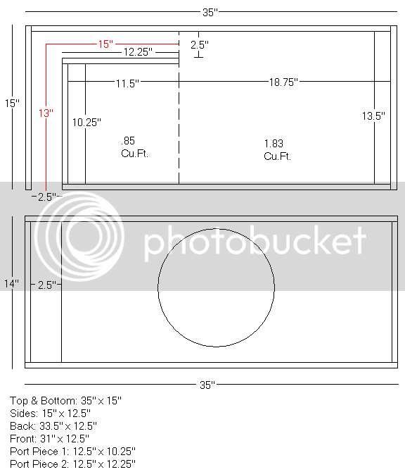

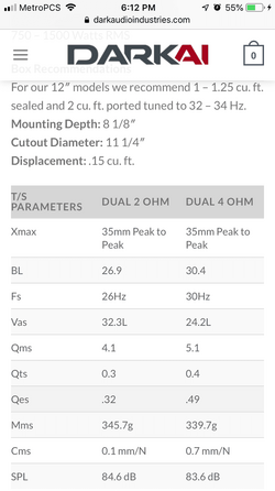

Hi I need a box design for a dark audio dki 12 tuned to 32hz. It will be going in a focus hatchback and I have 37Wx14Hx16D to work with and for now I have a Skar rp800.1 until I get my car 1500.1 dz to power it. Any help would be much appreciated thanks !

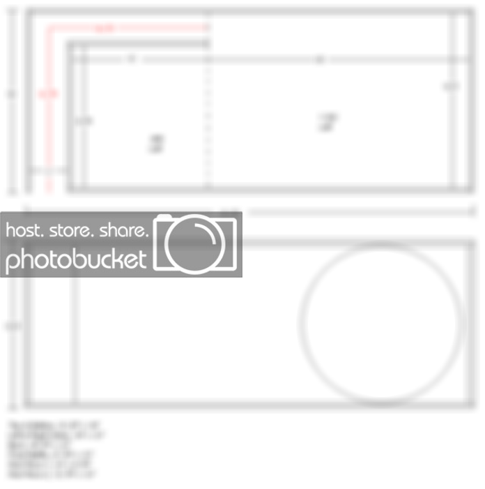

These are free box designs, so they may or may not specifically tailored for your car or sub but should work well enough still and be pretty close in performance.
 this is 2 cubes at 32hz
This is 2.6 cubes at 32hz.
