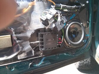

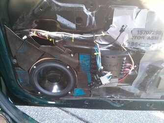

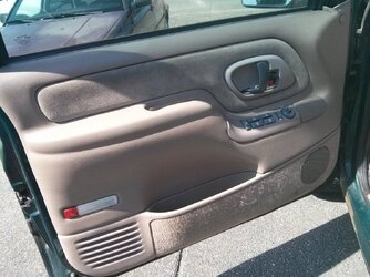

Sounds like your lacking midbass but I would not put 6x9 in the front factory door location. Your talking about more modification than what's needed. Find a good set of 6.5's instead. I replaced my aging CDT comps with Polk Audio comp set for my Tahoe front doors...
And still maintained a factory look.
