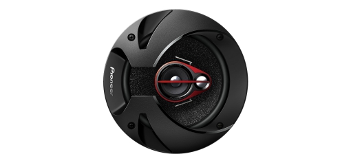

PIONEER TS-R1750S is 40 W RMS (it seems a bit higher frequency sound)

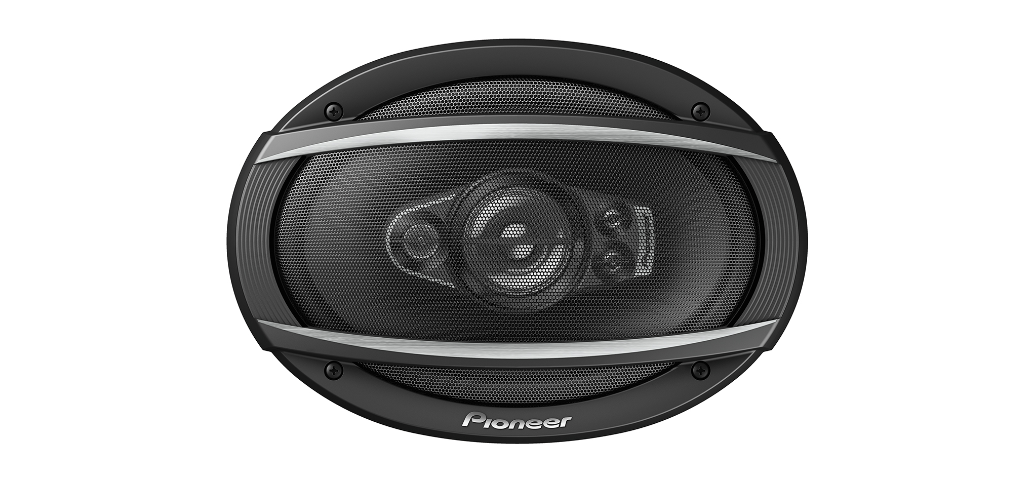

PIONEER TS-A6990F is 120 W RMS (more natural or louder frecuency sound)

But speakers are coaxial, so would crossover be useful in this case? I think I can't separate frecuencies with this kind of speakers, but I don't know.
PIONEER TS-R1750S: 36 Hz – 31,000 Hz
PIONEER TS-A6990F: 22 Hz – 25,000 Hz
I think it shouldn't be a problem of pushing hard, because without amp my head unit is 4 x 22 RMS, and PIONEER TS-A6990F is 120 W RMS and PIONEER TS-R1750S is 40 W RMS, but I don't know, I'm newbie in car audio (previous head unit is Belson sh*t 4 x 7 RMS 17 € with OEM paper-style speakers, Rover 25)
What you'll want to block out is the low frequencies. You will use "HPF/High Pass Filter" somewhere around 40-60hz should protect those speakers if they are reaching their mechanical limits.
