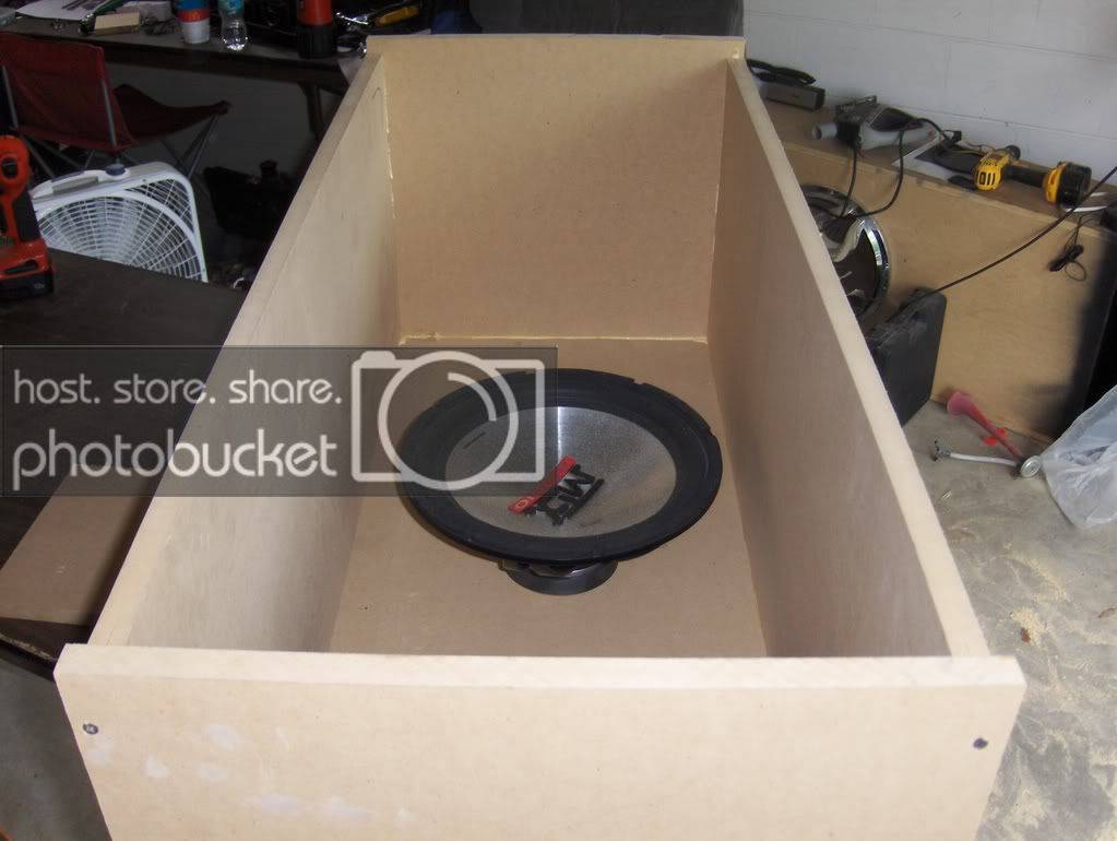

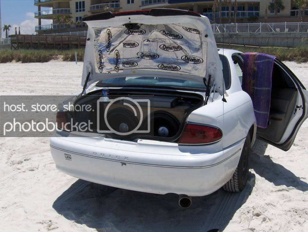

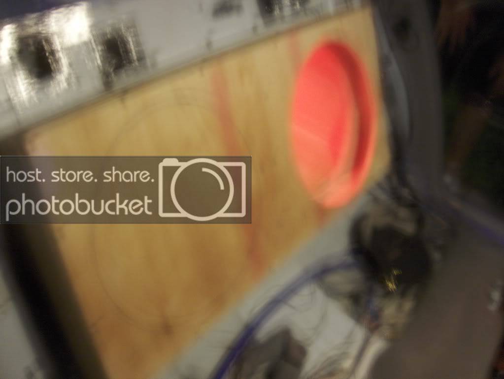

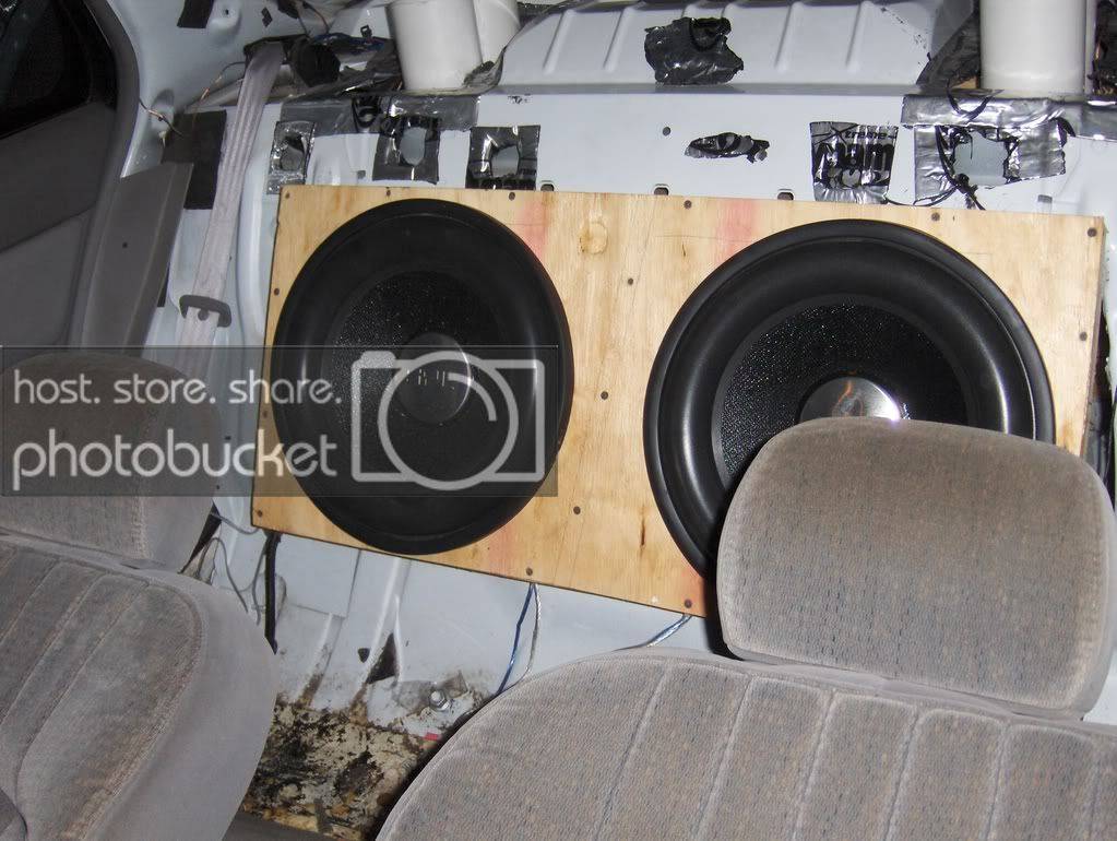

Here is a pic of his last box that i built, 5.0cf tuned to 30hz, was originally for his Type R 12"s (which were loud as shit in it, he should of kept them)... its kinda small for the 15"s

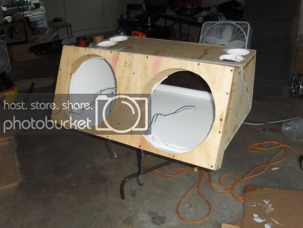

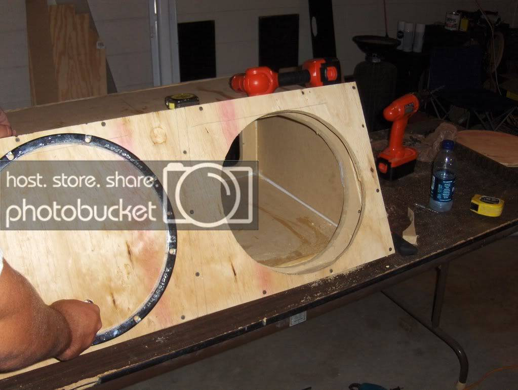

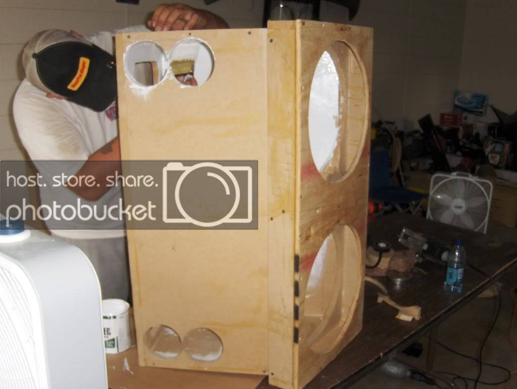

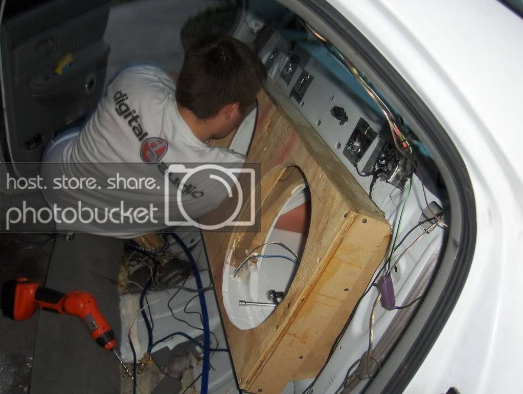

and here are some of the build were doing now, it will be right around 10 cubes ported probably using 4 4" PVC ports. The subs will be firing into the cabin. apparently he doesnt want the back seat at all anymore, but i have other ideas, pics will follow when that happens...

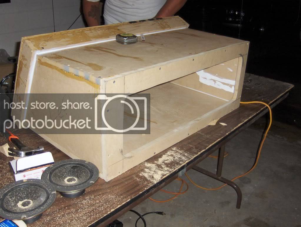

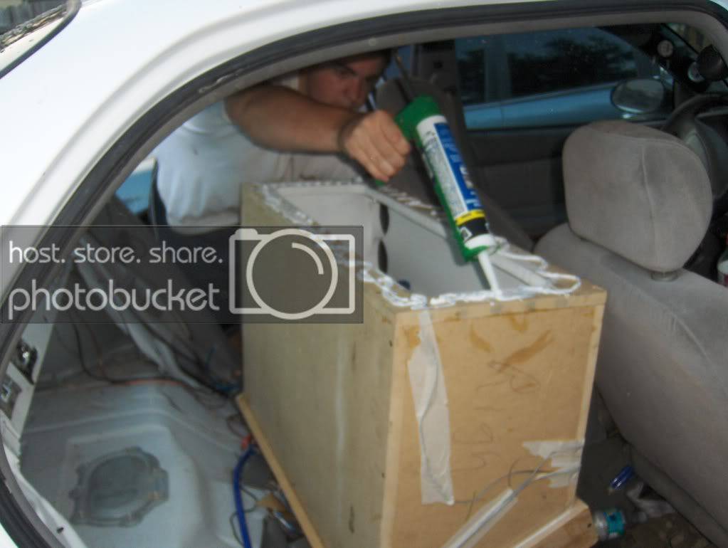

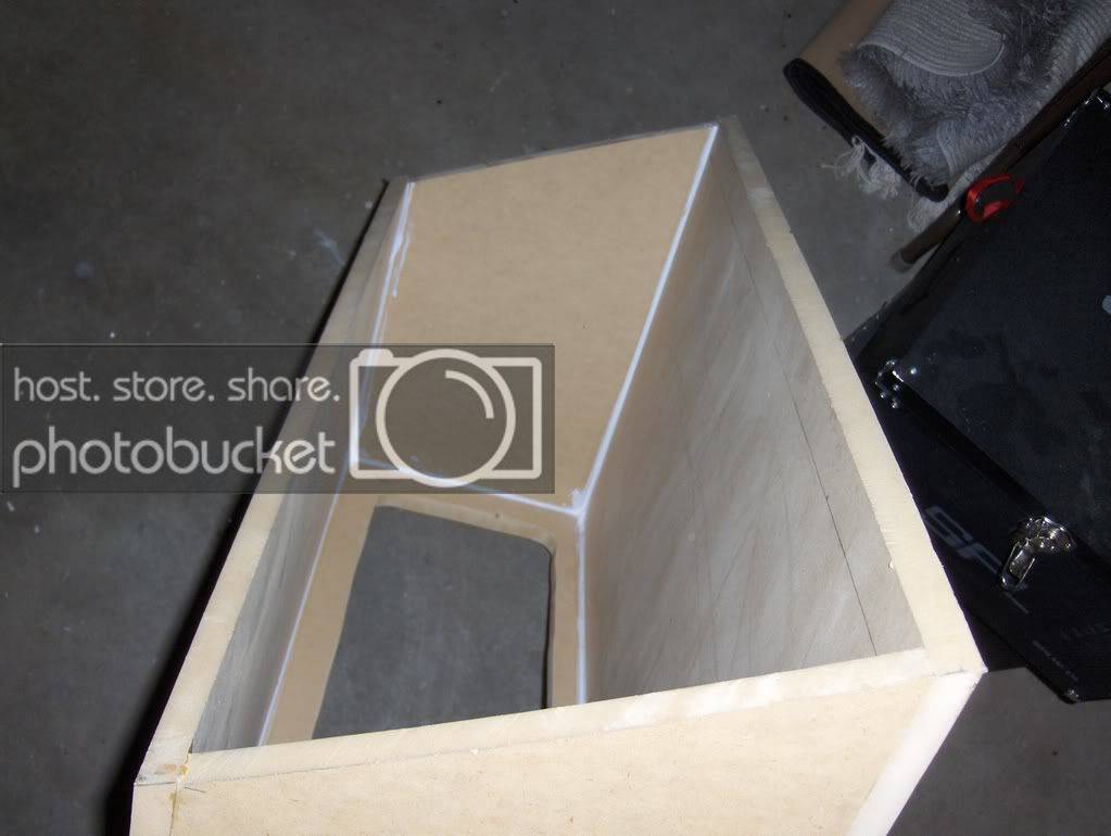

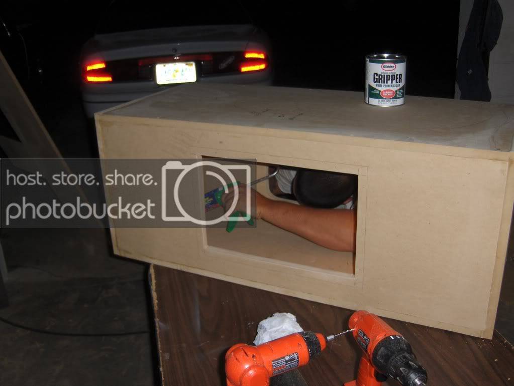

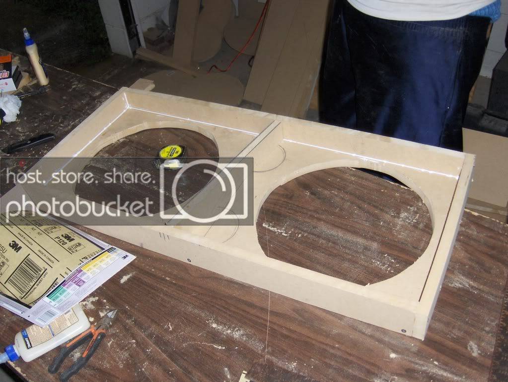

This box will be built in two parts to fit better in the trunk, they will be siliconed and bolted together when he puts both boxes in the trunk. only leaving about 2 - 3" of MDF on the inside for the bolts/silicone to connect the boxes.

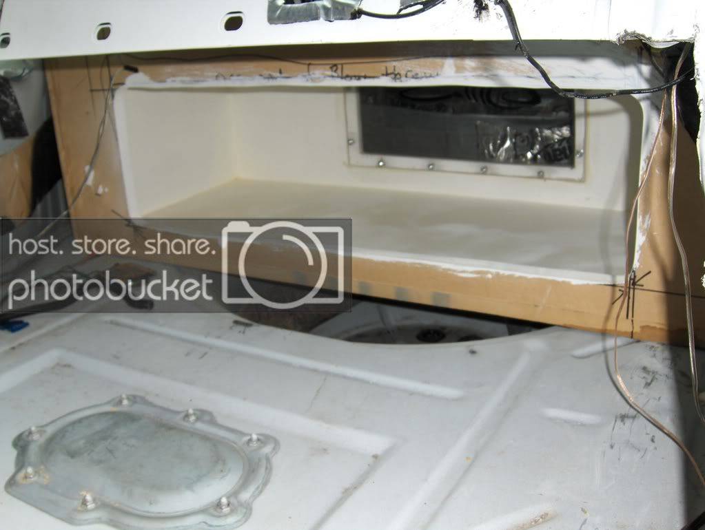

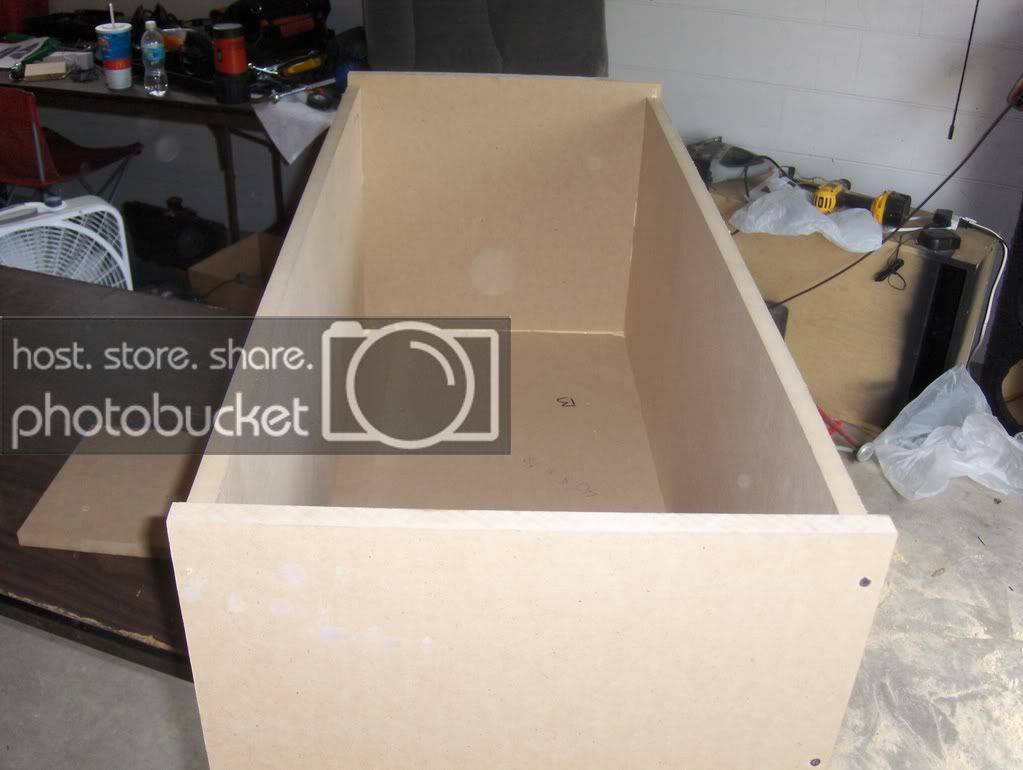

back half of new box:

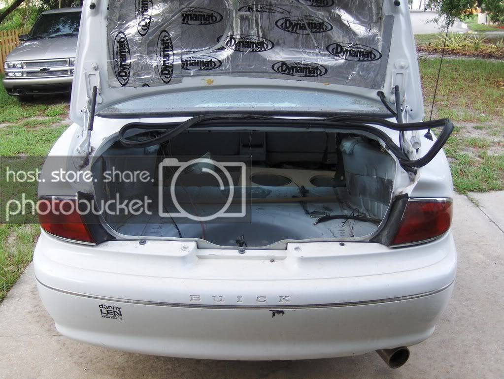

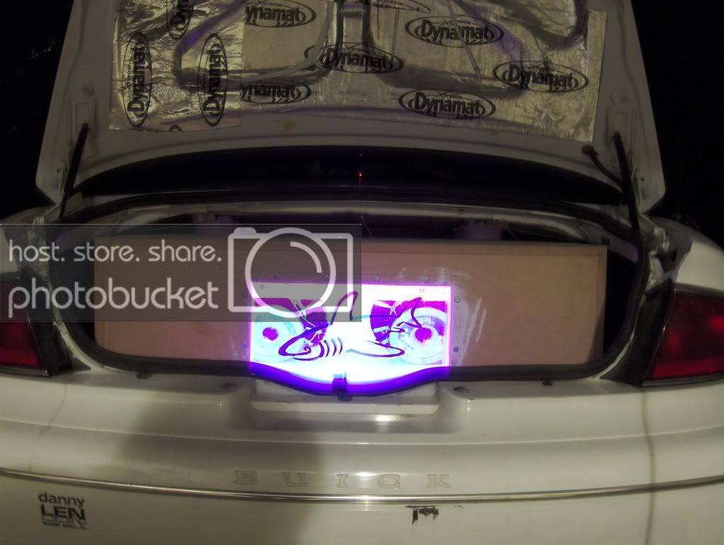

pic of empty trunk (with my sexy truck to the left //content.invisioncic.com/y282845/emoticons/cool.gif.3bcaf8f141236c00f8044d07150e34f7.gif )

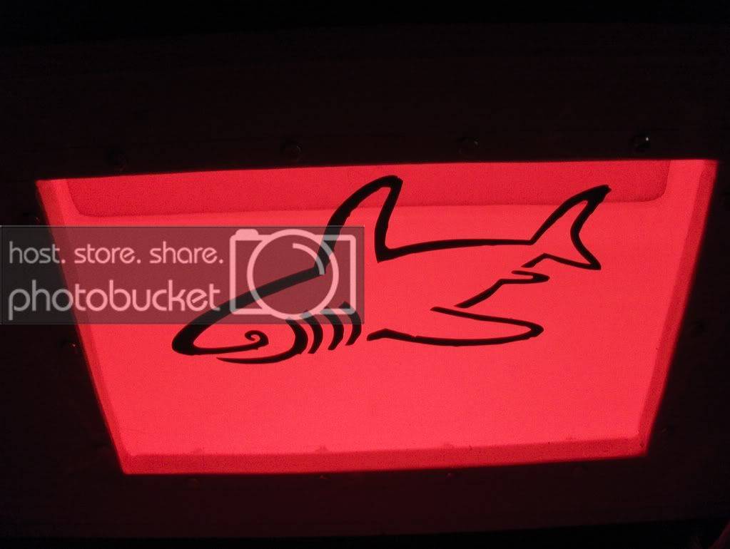

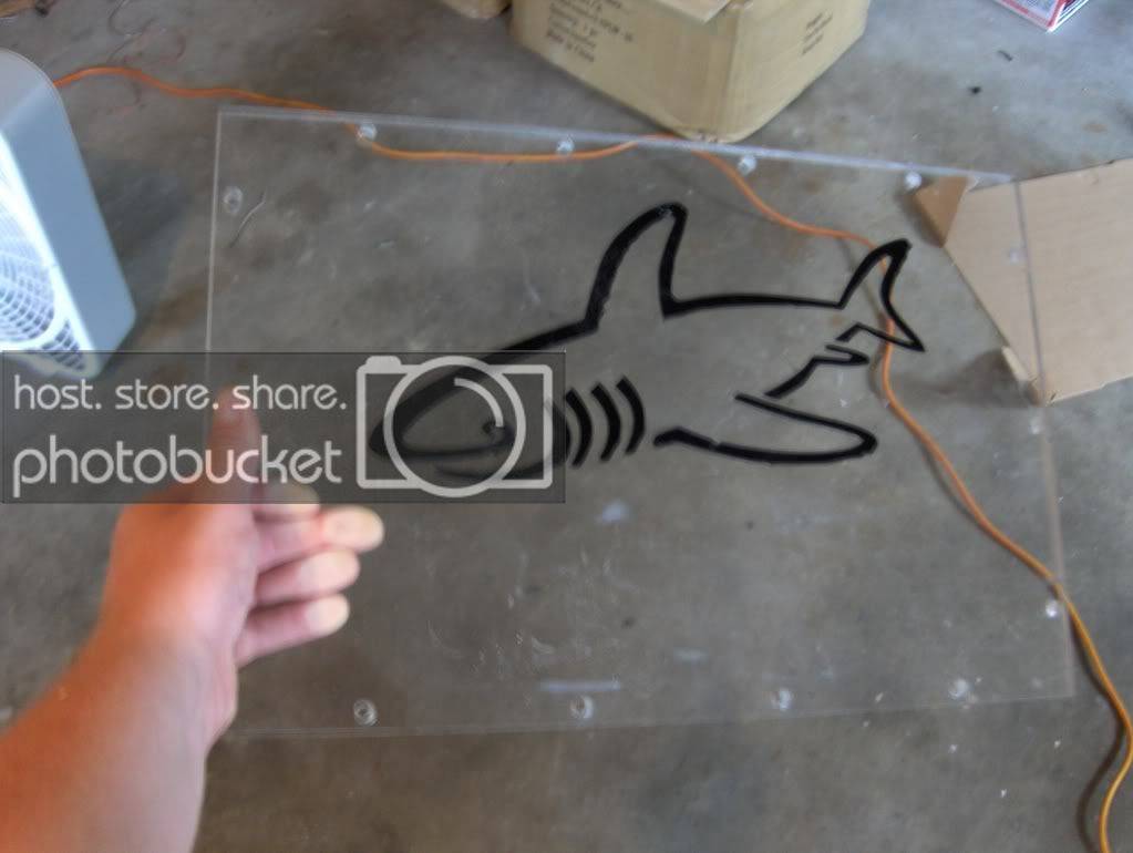

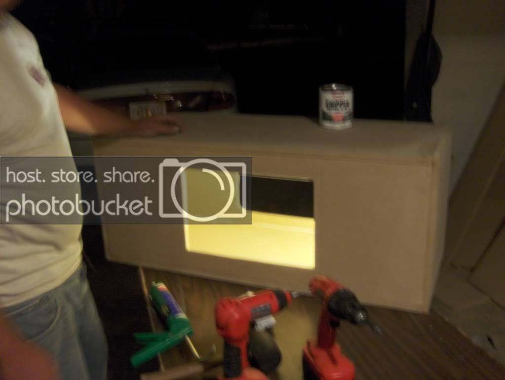

plexi for the back part of box

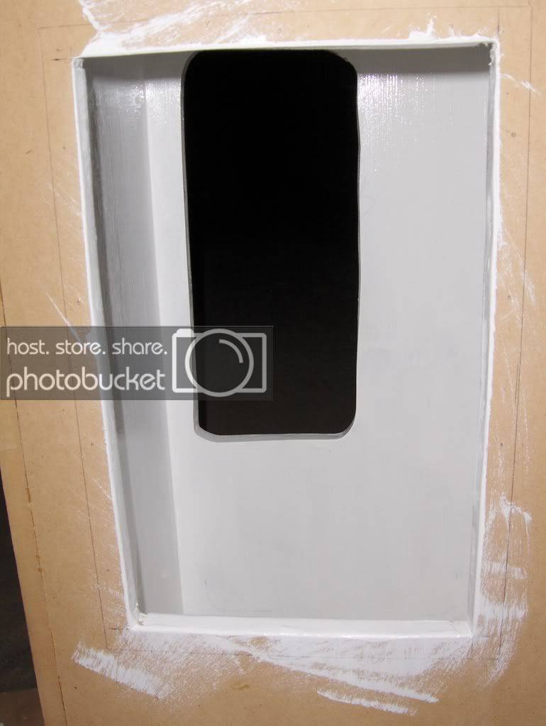

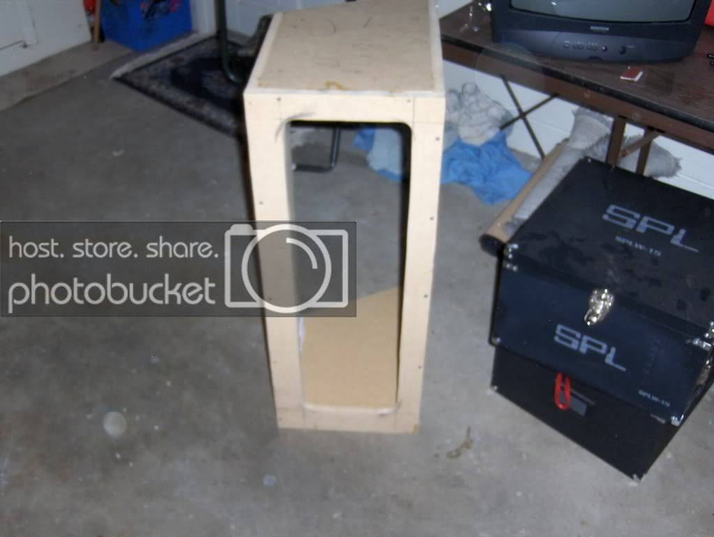

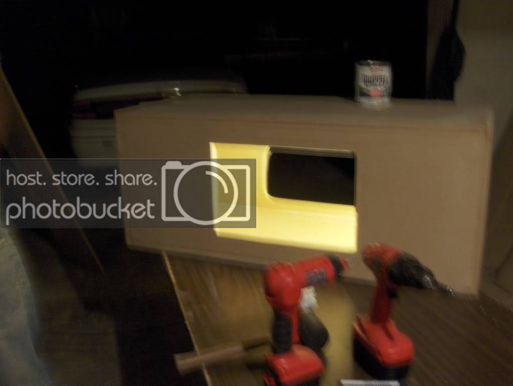

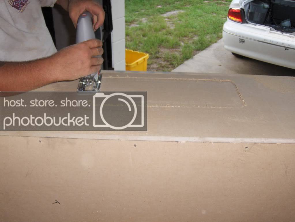

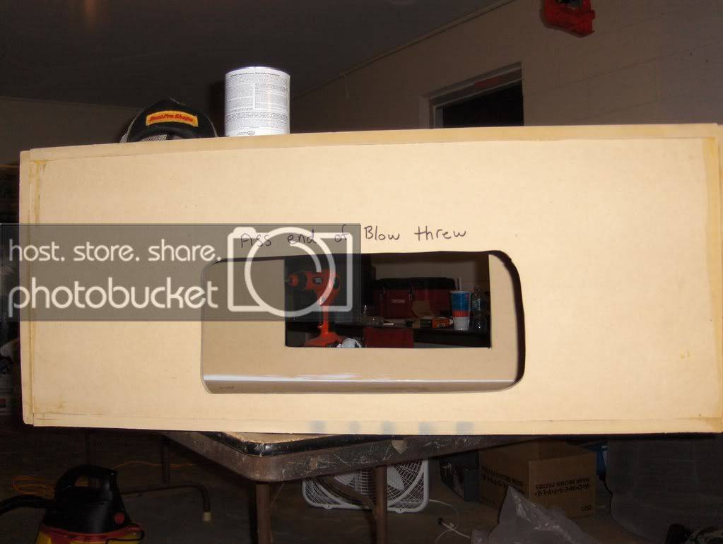

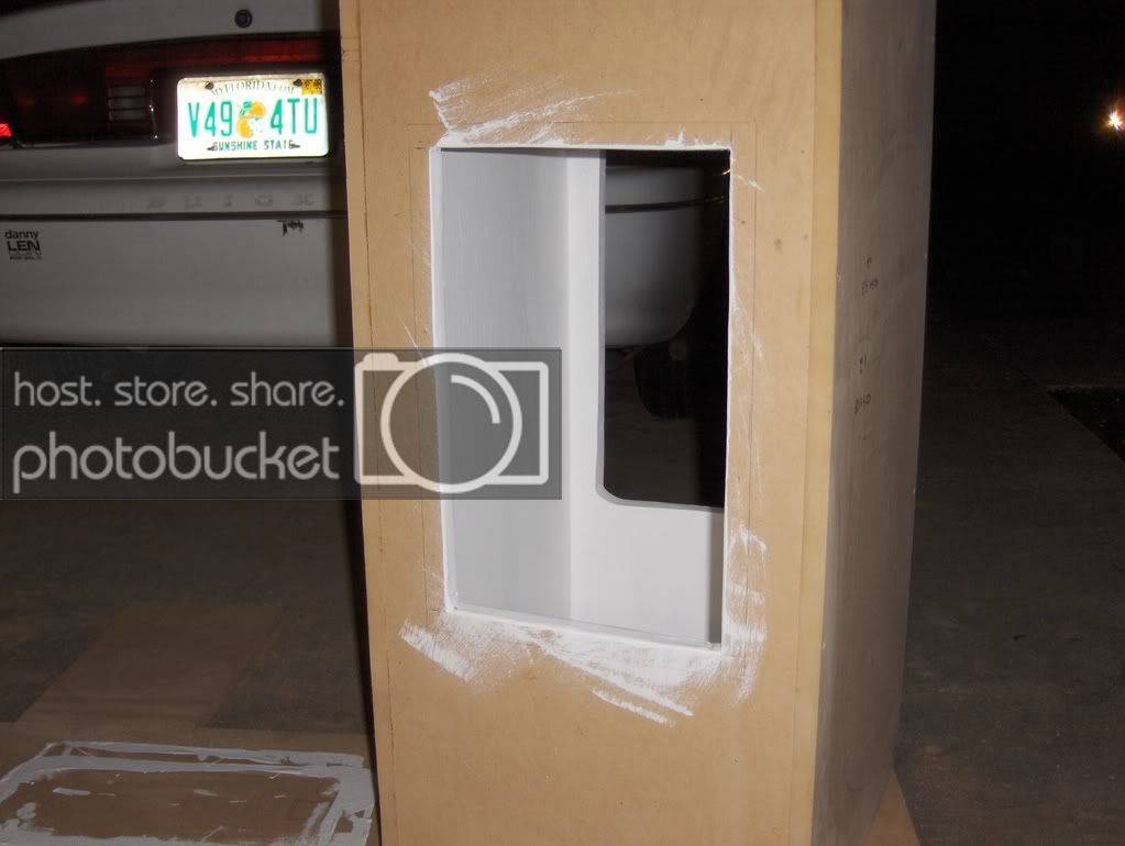

this is the cut through that will go into the front half of box:
painted with something similar to Killz to prime and seal:

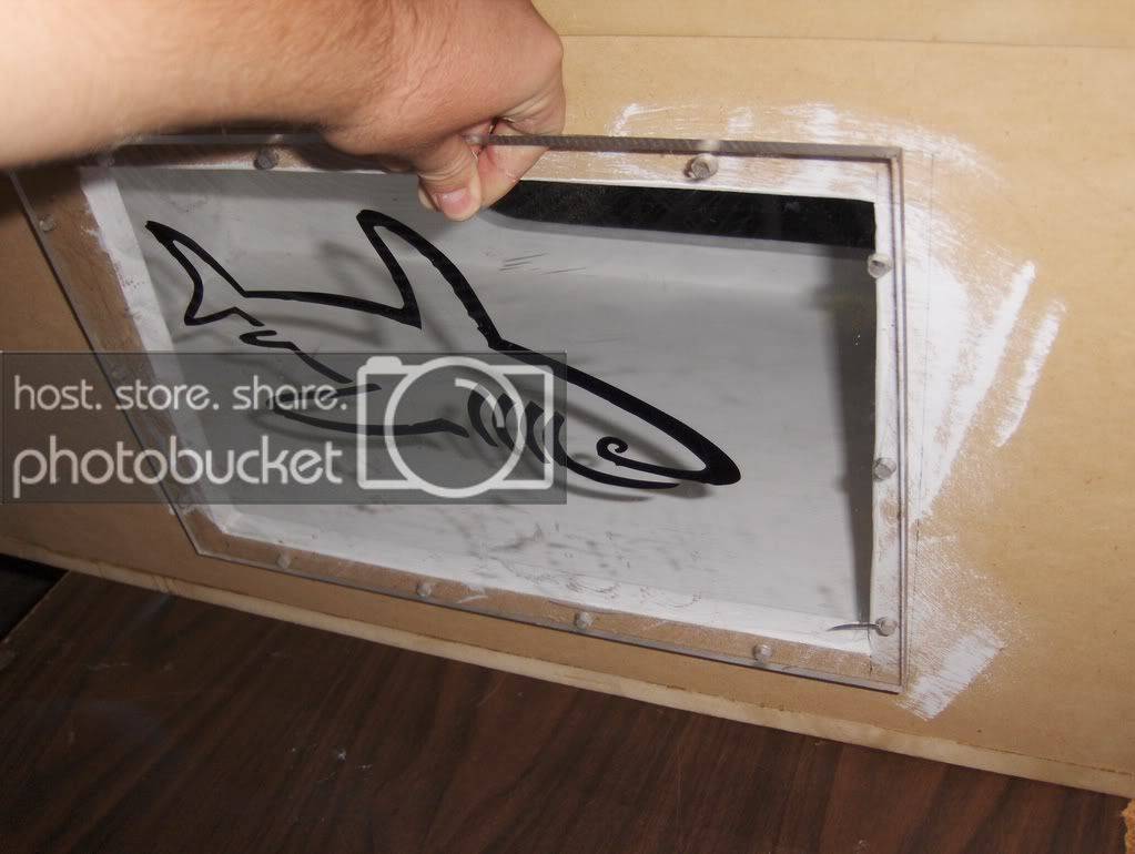

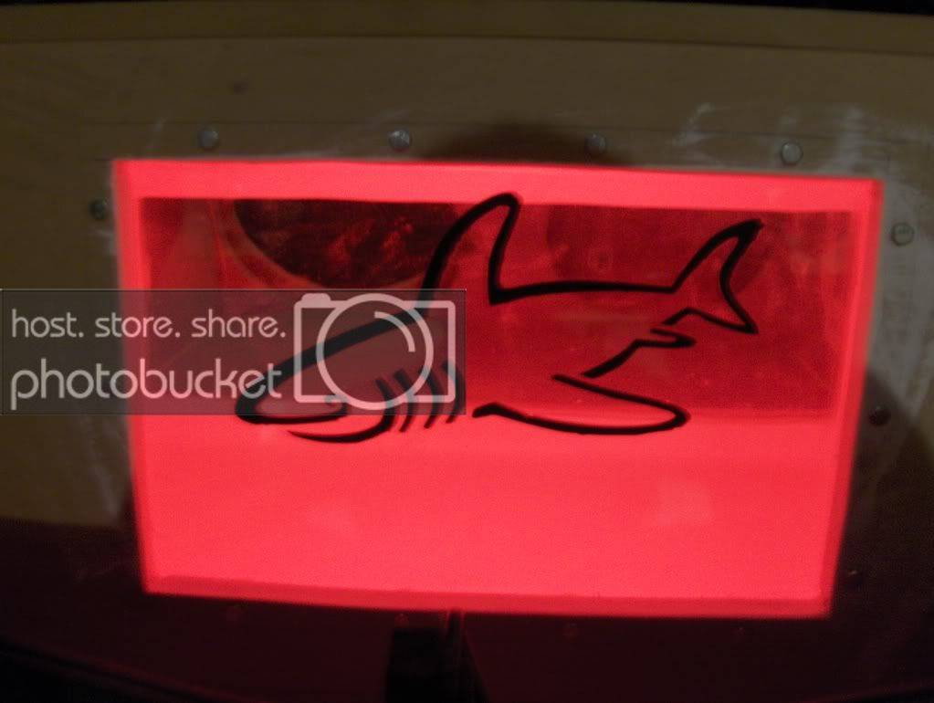

the plexi will be bolted on the inside of the MDF with probably neons or some sh!t in it... it originally came from a sh!tty band-pass box that he had.
rough cuts for now, i tried to sand them down after he made it look like a wave with the jig saw... but its his not mine, i would have to make mine almost perfect. it should come out well though.
let me know what you think / or suggestions, i have only built a hand full of boxes myself, this is his second or third box, so we are not pro's
I think his exhaust is pointing the wrong direction
yeah... this car sounds like hell coming down the road, straight pipe with only a cherry bomb (basically a straight pipe) all the way to the back. loud as hell.
this is a guy coming from imports that thinks crooked exhaust tips are teh coolness.

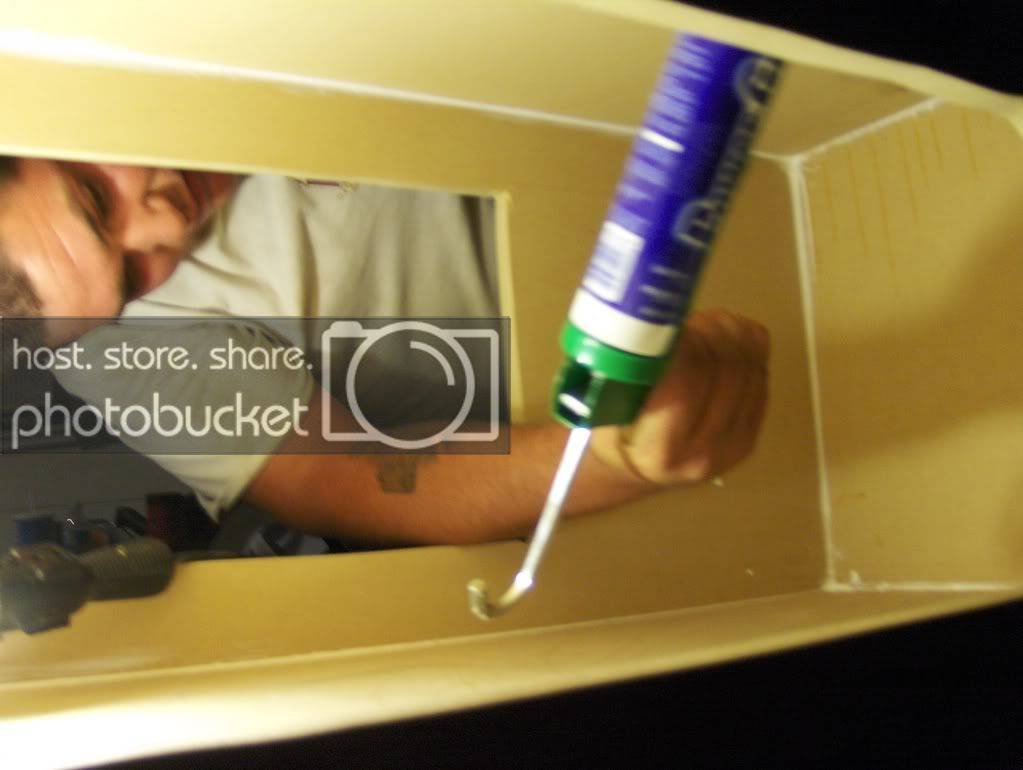

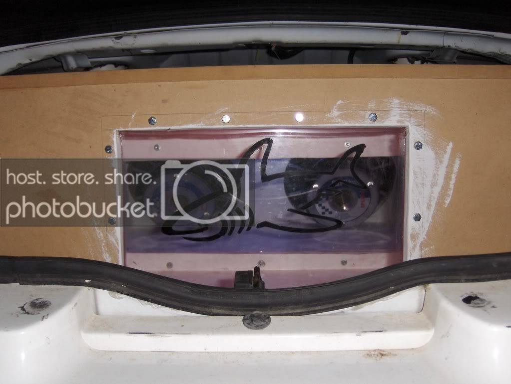

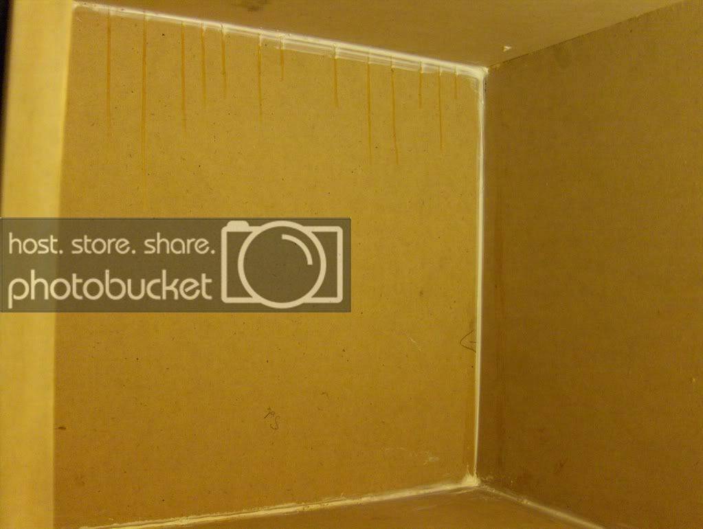

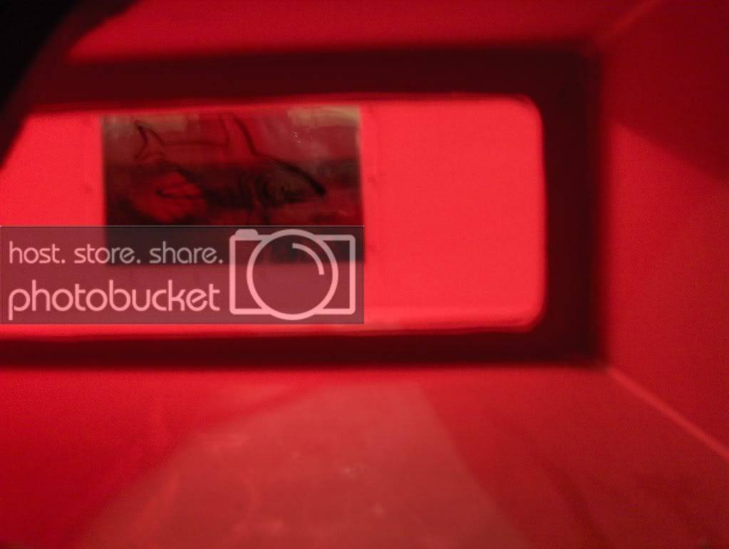

mounted the plexi loctite'd and siliconed

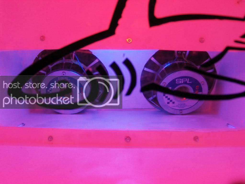

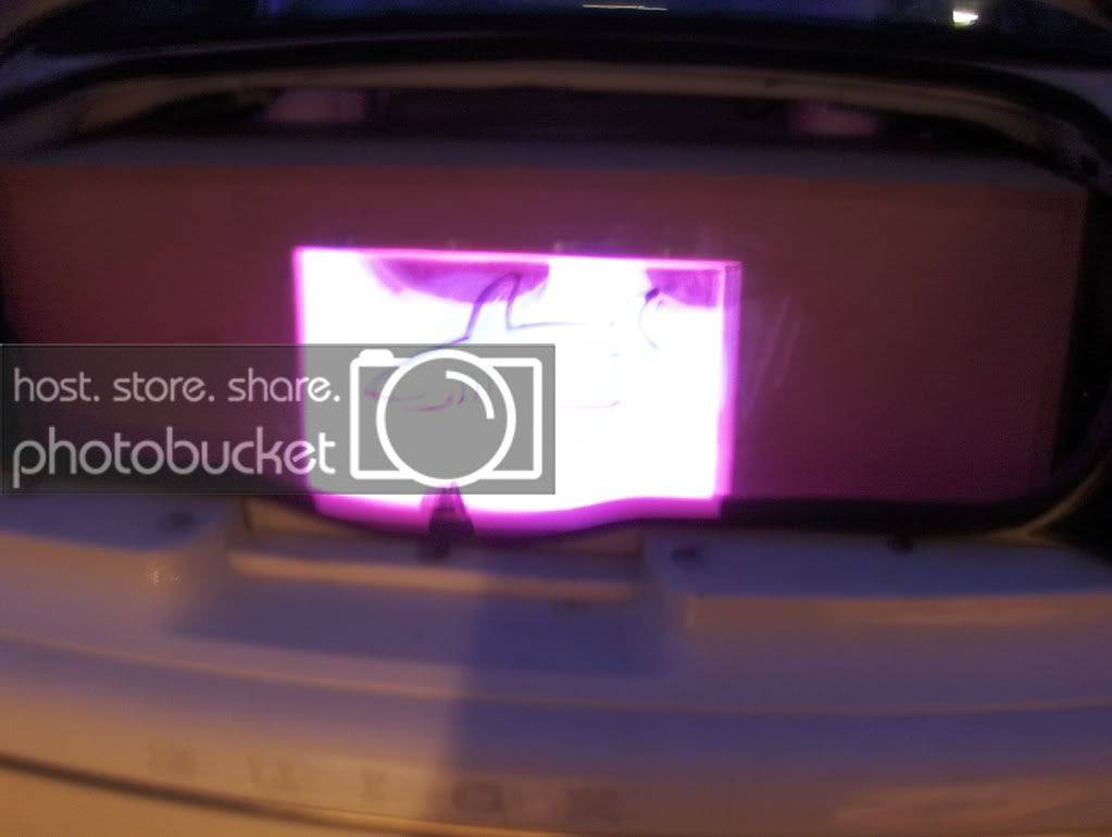

trying out some light, just a basic red neon, might change the color later...
test fitting the front box.. still need to mount the braces and cut through to the back box

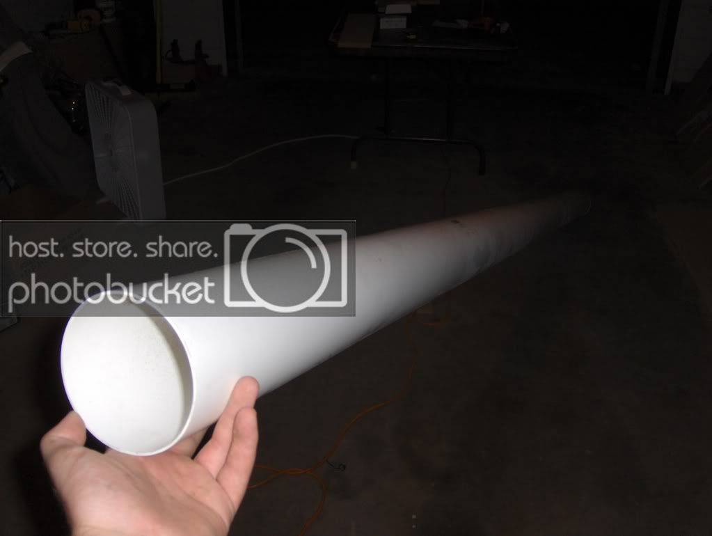

port material... 4" (x4)
9.75 cubes before port displacement is figured out.

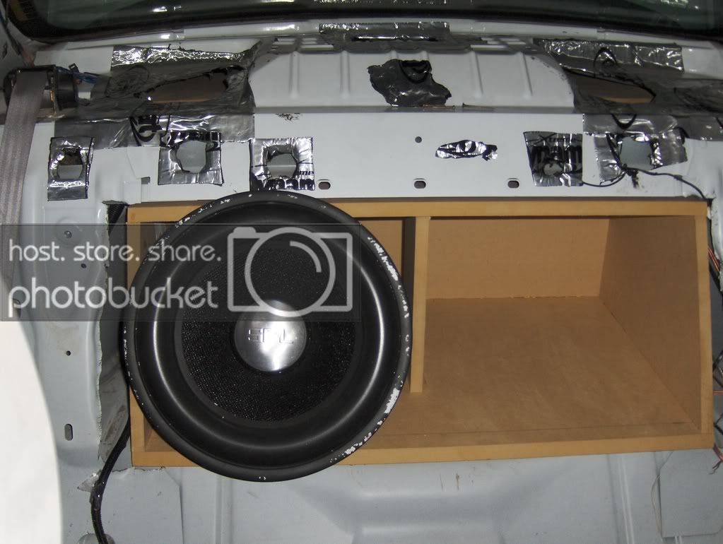

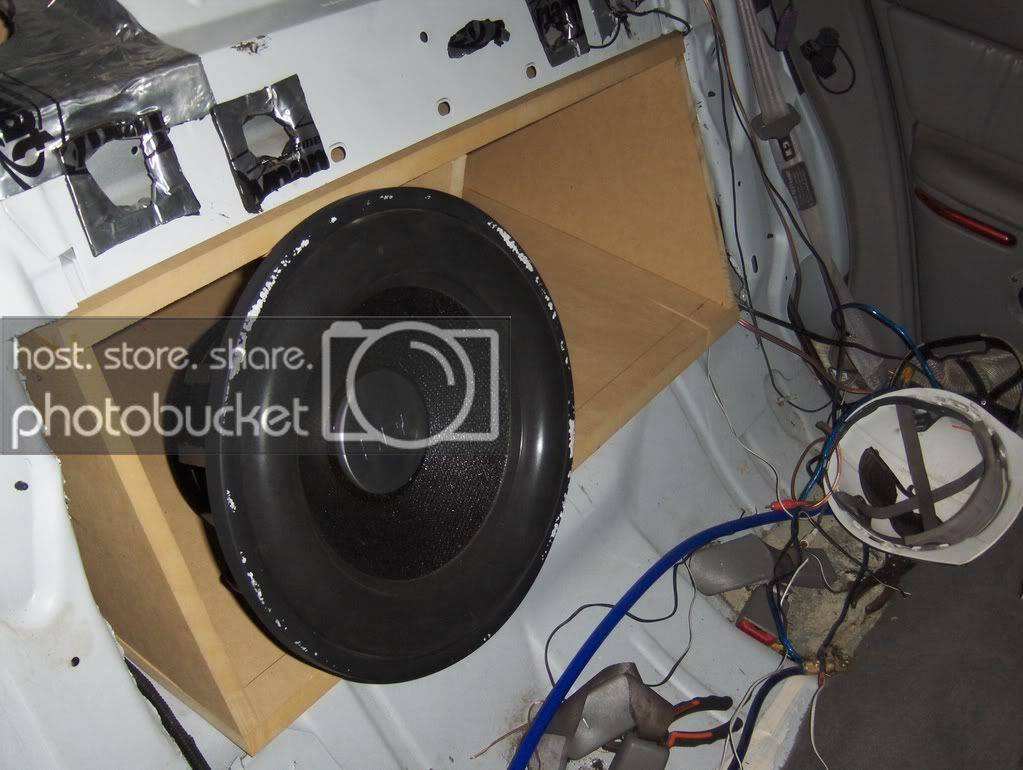

well, when the SPL's sound like sh!t, i'll convince him to buy something better, after all this work in this box... it will NOT go to waste. I have ideas for the backseat, it should come out pretty well. Got a little more done tonight, heres some pics:

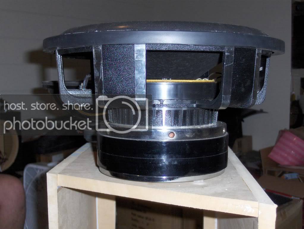

here is one of the SPL's:

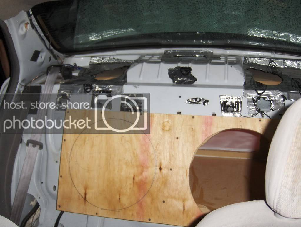

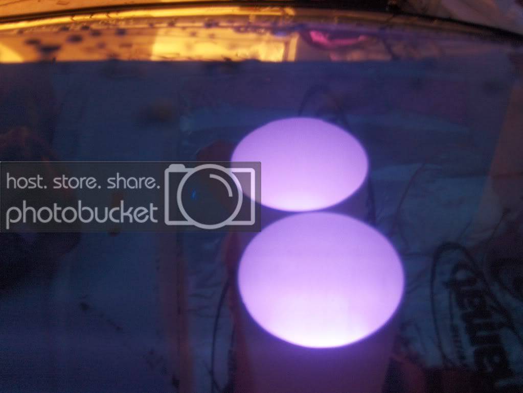

one question.. does anyone have any advise for port placement? I'm wanting to put all four 4" ports firing straight up through the back dash towards the back window (through the stock 6x9 holes already there. will this sound OK?

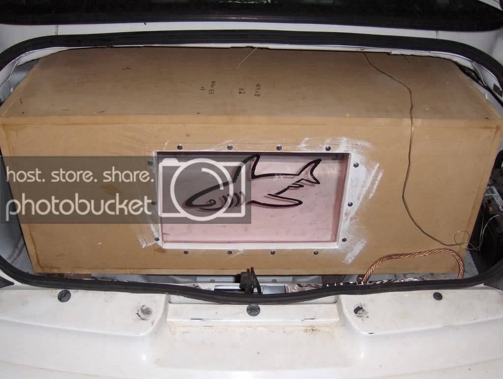

mostly finished with the box now.. just need to let the loc-tite and silicone dry for the night, and install the amp tomorrow and tune...
heres some pics:
Box lit up with red and blue neons before the subs were installed:
pics of the ports coming up through the back dash... a lot brighter than i anticipated:
