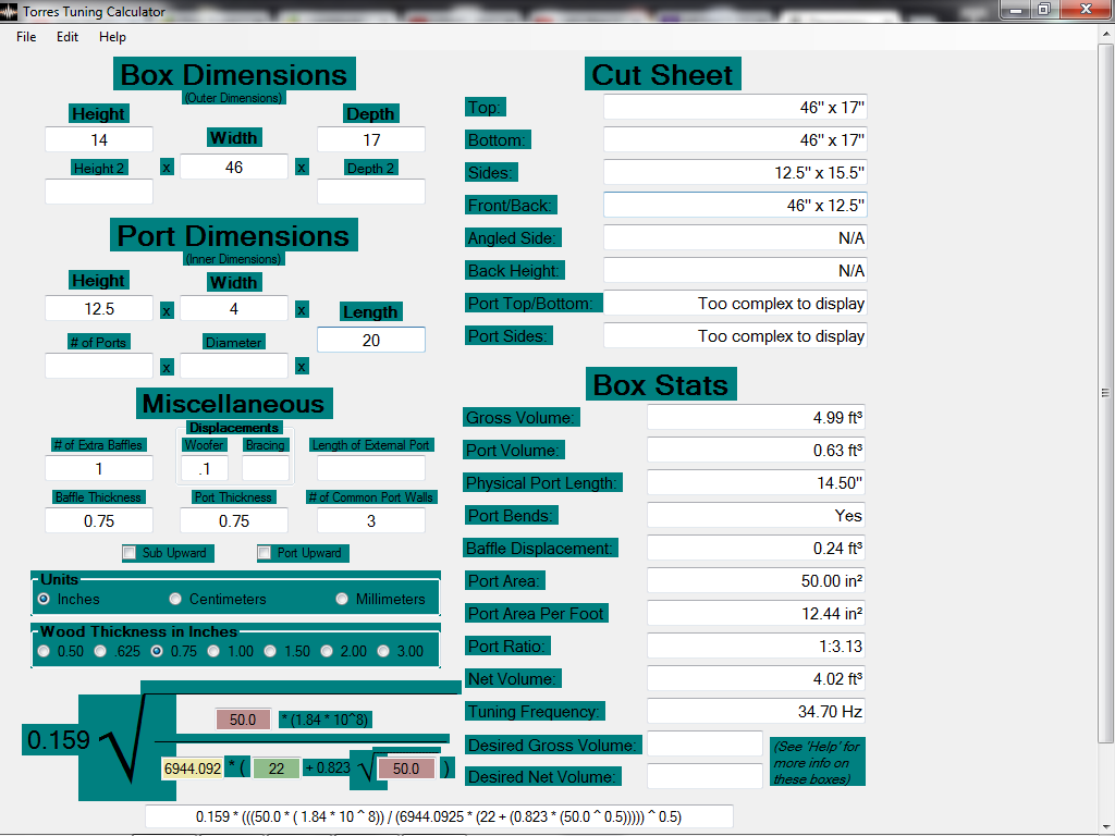

so from what kicker recommends, they recommend a 2 cubic feet 40hz tuned box with 12.5 port area per cubic feet which is kinda high with the tuning. I'd say build box and leave the port unglued so you can adjust the lengths to how you prefer your music to sound like. we'll start you off at a safe zone of 34/35hz. You can subtract the length and get a higher tuning or add to the length to get a lower tuning and get deeper bass.
12" port length will be = 40hz
16" will be tuned to 37hz
21" will be 34hz
26" will be 32hz
Thanks. So like I said I've never done a ported box. I'm guessing the subs share the main chamber and the port would exit on the side of the box? Or would it sound better with the port coming out on the face with the speakers or.the rear?
You want the port and sub firing the same location and the port firing backwards towards the trunk. It'll be an L port yes Its a very flexible box with its tuning. If you dont like how it sounds just raise or lower the port length so hold off on wood gluing and screwing down the port, Use some silicone or liquid nails for a seal and temporary hold and test it out and adjust as needed.
