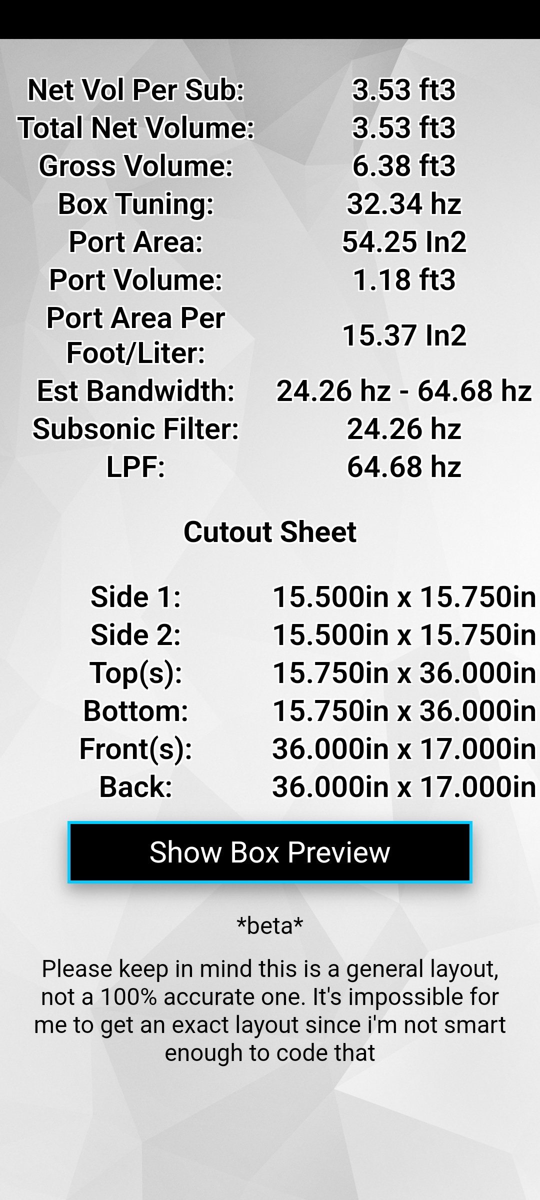

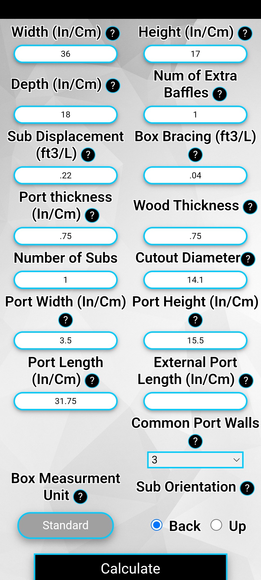

Can anyone verify that everythong looks ok here before I invest time and money building this box. I want this to be my first properly built & tuned box.
It's going in the ext cab of a 09' Silverado running off a RF 1200.1.
Also is there any reason why I shouldn't use a straight side slot port vs a front L slot port?
I will be extremely grateful for any input.

Not sure if this is reliable but trying to figure it all out on my own at this point. Does this look good?
