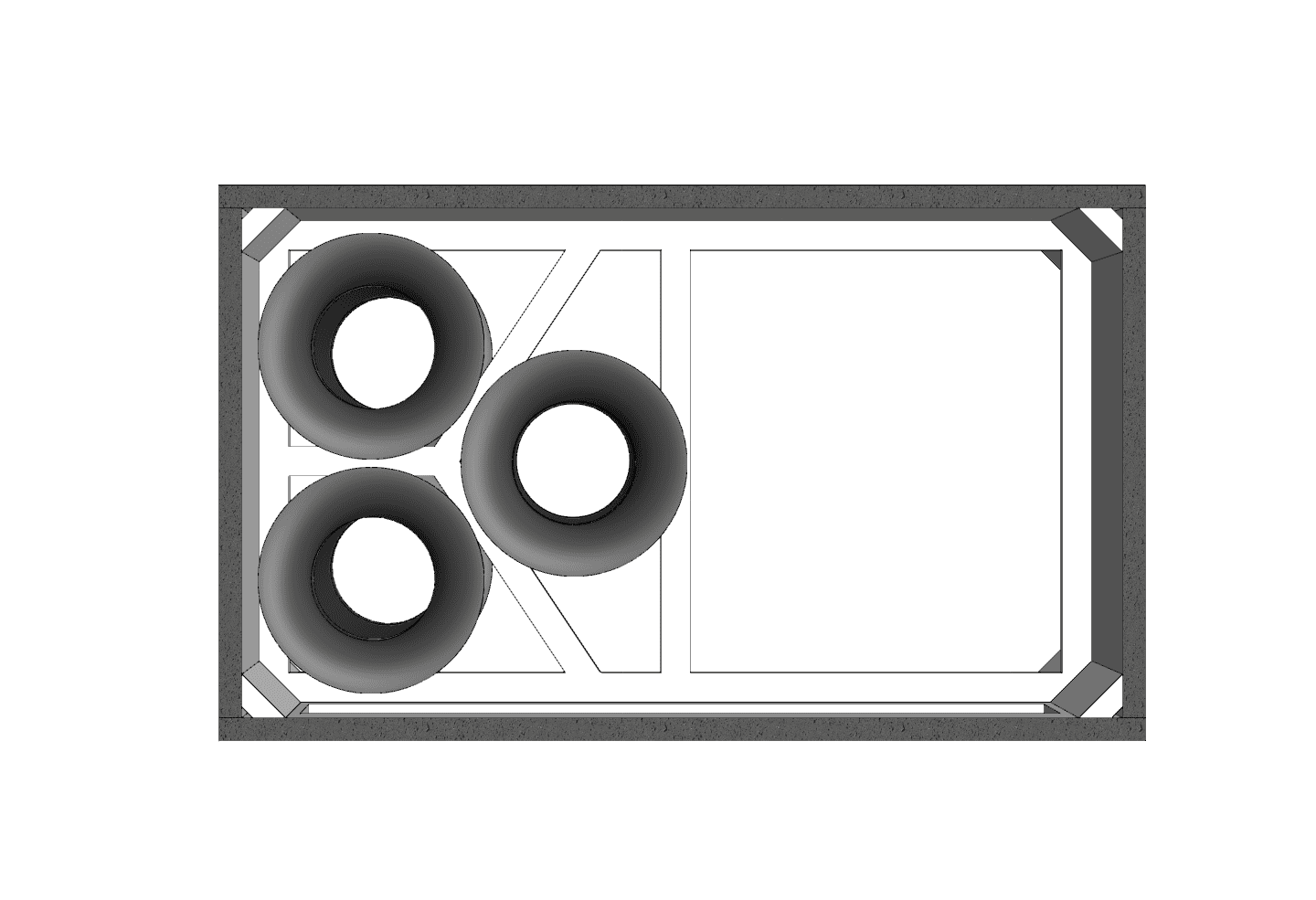

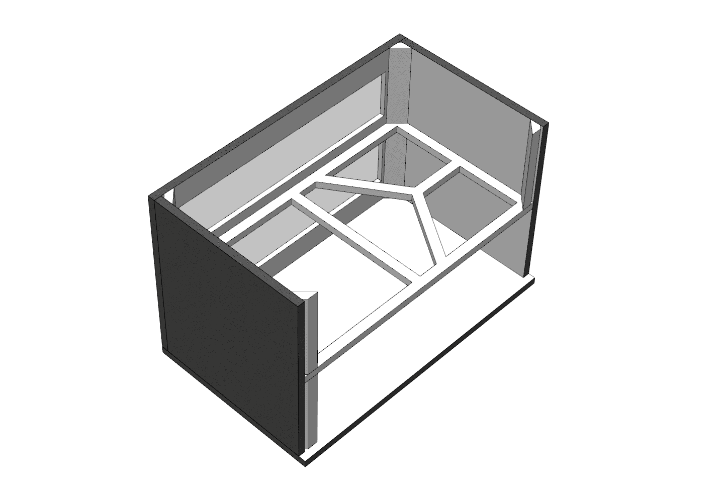

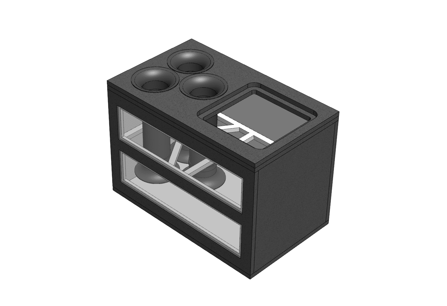

Box is 30 x 20 x 18 netting ~5ft3
Ports: .38ft3
Sub: .12ft3
so sub sees a little less than 4.5 cubes
three 4" ports tuned to ~34hz

He should burp 150's easy, given that everything works out right.
He's got 4.5 cubes tuned to 33hz with a 6" aero
this is 4.5 cubes tuned to 34hz with three 4" ports, so it has about 25% more port area than the other box, not a guarantee that it's gonna make it louder, but theoretically, it should.
---------- Post added at 07:28 PM ---------- Previous post was at 07:27 PM ----------
How long are those ports?
17" exactly gives it about 34.5hz tune
This is sick!
thanks maaaayne
thanks maaaayne
Not only that, but you have to think about how much more flare there is a well. There is probably 60% more flare, which would help a ton as well.
Having flares is almost like increasing the diameter of the port.
I just assumed that the flares were solely for reducing port noise, simply because no matter how much port you have, it's still a 4" tube, learn somthin everyday.
