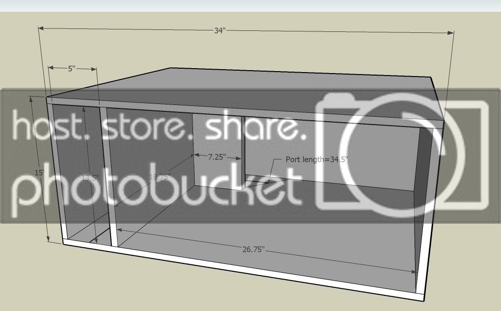

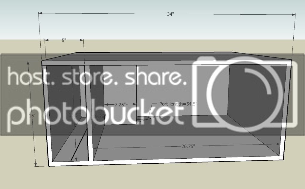

How's this look? //content.invisioncic.com/y282845/emoticons/biggrin.gif.d71a5d36fcbab170f2364c9f2e3946cb.gif
That will bring you to 4.75 cubic feet before you drop in the subs...and tuned to 31Hz, with 67.5 sq inches of port area....they should sound pretty darn good in it as long as it's solid.
I could make it for you as well if you'd like..//content.invisioncic.com/y282845/emoticons/smile.gif.1ebc41e1811405b213edfc4622c41e27.gif
