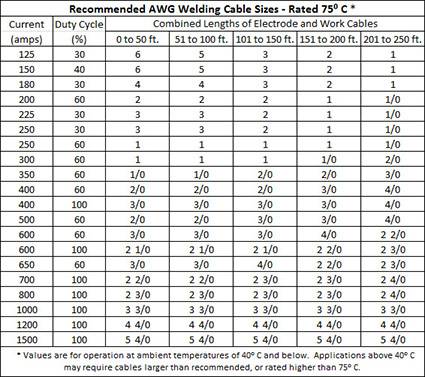

A lot of times the rating for Welding cable is for much longer runs than you would actually use. And car audio cable usually rates their cable for shorter runs that are seen in car audio. Here is a good chart to go off for just welding cable.
Interesting. And welding cable is the same as OFC right? It's 100% copper, or is it somewhere between CCA and OFC?
Its 100% copper
Good to know.
Now if I were to start using it though...Would it be more beneficial to switch all my wiring to the 1/0 welding wire? Or is it fine to have the Welding cable and CCA mixed in the system?
Its ok, not ideal but ok. The Welding Cable can handle more amperage than the CCA
