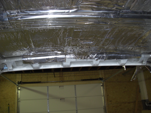

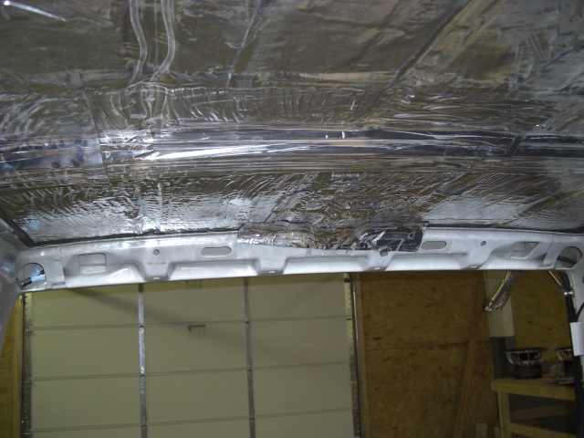

I'd rather have the flexibility of experimenting with multiple layers in different spots with the regular Damplifier.
I had two more small rectangles of deadener left from my pack:
* Before
* After, see on either side of the piece that was sticking out farther

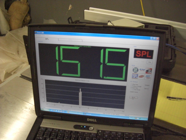

GAIN - 151.5 dB
0.4 dB gain so far with a single bulk pack
So... I need to concentrate on the back I think. This is where my woofer fires, right at the ceiling in the back.
Indeed //content.invisioncic.com/y282845/emoticons/smile.gif.1ebc41e1811405b213edfc4622c41e27.gif The sides and doors will ****.
