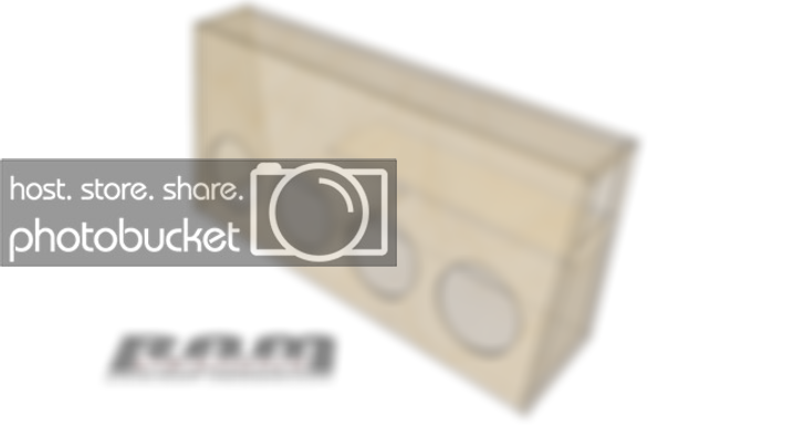

I see you have a Dodge single cab...you should have a lot of room in there. I actually have plans for a ported box for 4 10's that'll fit in a '03 single cab...should be very similar to yours. The box is 51" wide x 24" tall with 8" top and 13" bottom depth. The box is 4.25ft^3 with a 30hz tuning.
