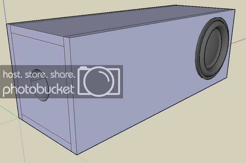

this is what I plan on it looking like. Just with an aeroport instead of a straight hole lol. I made it long that way I can use a different port to tune to 32 hz as well since that one had to be like 17 or some odd inches long lol.
