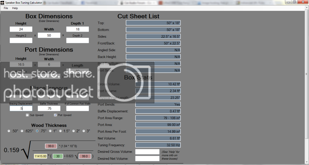

so Ive been informed that my rear jump seats have to be in for mwspl... well that takes away a lot of room back their so I am going to have to rethink what I want to do for mwspl... maybe 2 12s or something. but I did redesign the daily box. and here it is-
should just get nasty in the ranger... especially on the 3500... and maybe 2 3500s in the future lol. subs forward port up and center.
What you gonna do for mids/highs. love seeing ranger builds.
still havent decided... Im not planning on competing anymore with this vehicle simply because It will be too difficult to do what I want and stay within the rules... so even though I will have quite the substage I would like to keep some form of sql... so Im thinking either 1 or 2 sets of the lanzar opti's which I have heard nothing but good about... not to mention you cant beat the price lol. and then I'll probably run a decent set of tweets... but Idk which ones yet lol
