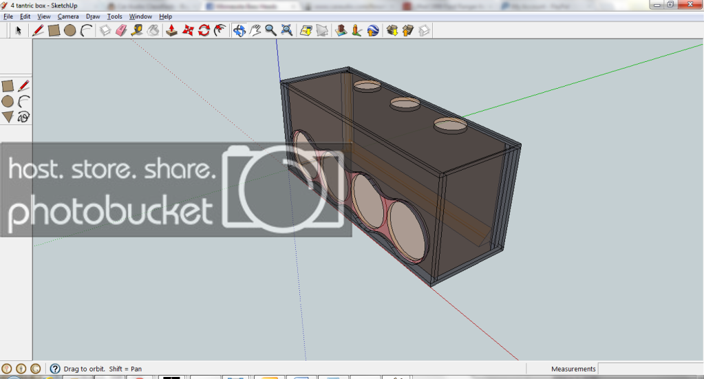

I've been thinking and designing, and testing and blah. I finally settled on 4 tantric md 12's -thanks @TaylorFade ; I figured I would try out the tantrics being that people are getting loud with them, they're something new, and they get down for daily subs as well. Enclosure wise was a little on the difficult side... being that the ranger has a few odd dimensions to it and their is not a lot of room... I finally settled on 7.6 cu ft tuned to 35 with 3 6" aero's. here's a pic-

im going to build this design... but I had a few people tell me that I should do an upward center slot port, 3 cu ft per chamber, subs forward, 16 sq inches of port per cu ft. so I wil try this one as well and see which one meters better.

the design posted above is going to be one of my daily boxes... not a numbers box at all. I really just wanted to some decent low extension but still be able to get loud. my burp box will be totally different...
