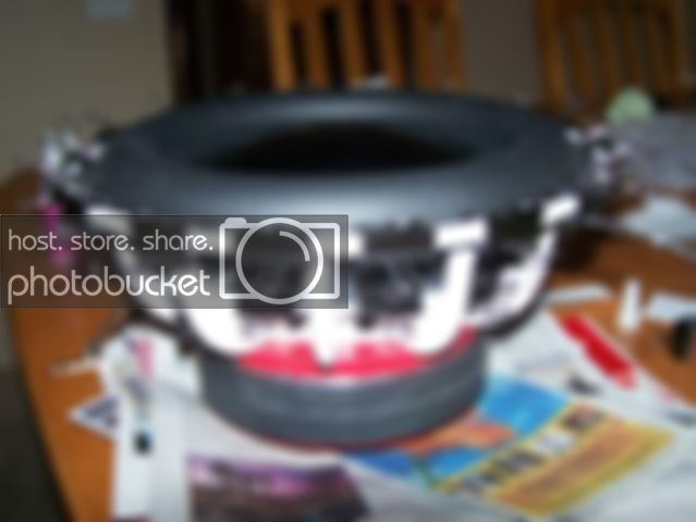

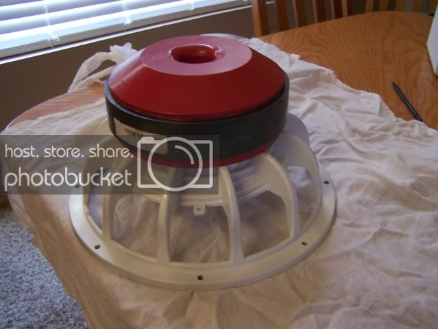

Started out with a plain old Grey tc9 motor. has a hint of rust. was cleaned off with gun cleaner and sand paper. then painted red. basket was painted white.

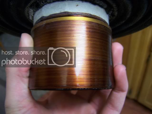

D2 8 layer flatwound coil, two medium stiffness spiders with spacer, paper pulp cone with medium roll rubber surround, dual leads, large black aluminum dust cap. THANKS SCOTT!

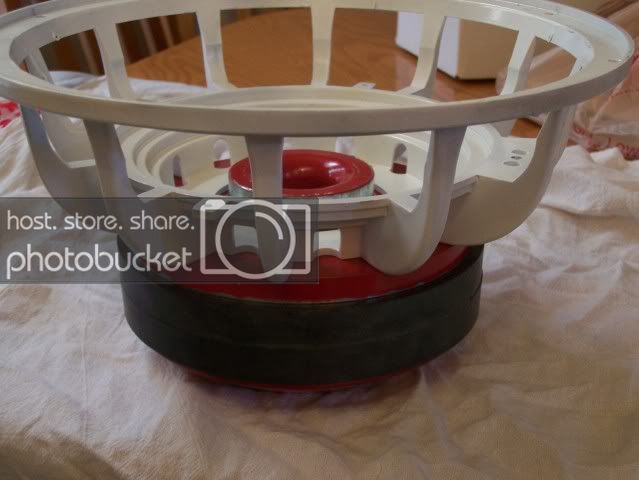

dry fit pic scott sent me:

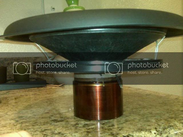

finished up pic scott sent me

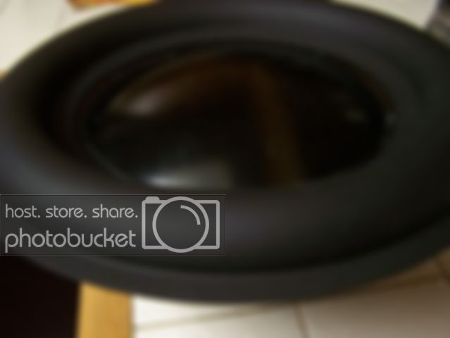

IN MY HANDS! YES!

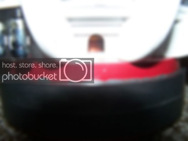

dustcap

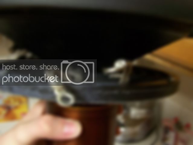

mmmm leads!

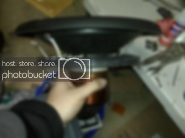

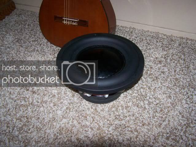

re-cone time!

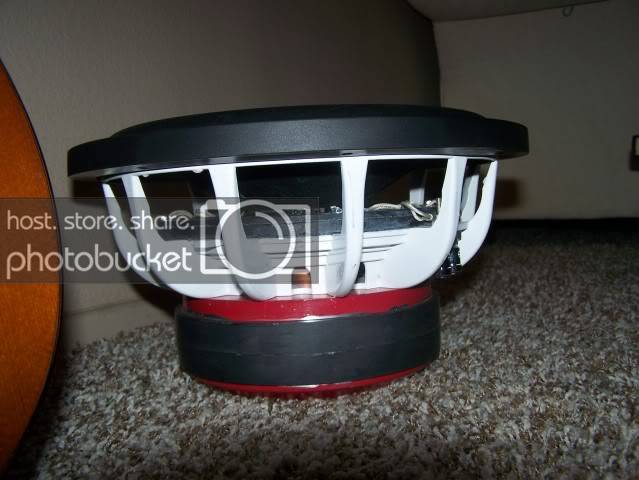

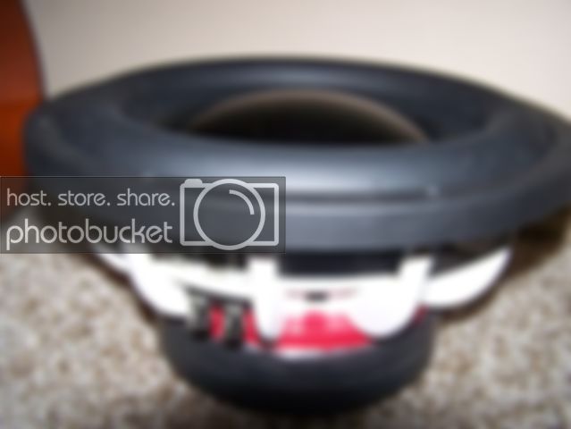

finished product:
hahah thats a really awsome woofer! i have a tc9 motor that just sits around i was going to do something simular to this but dont have the time or money!
